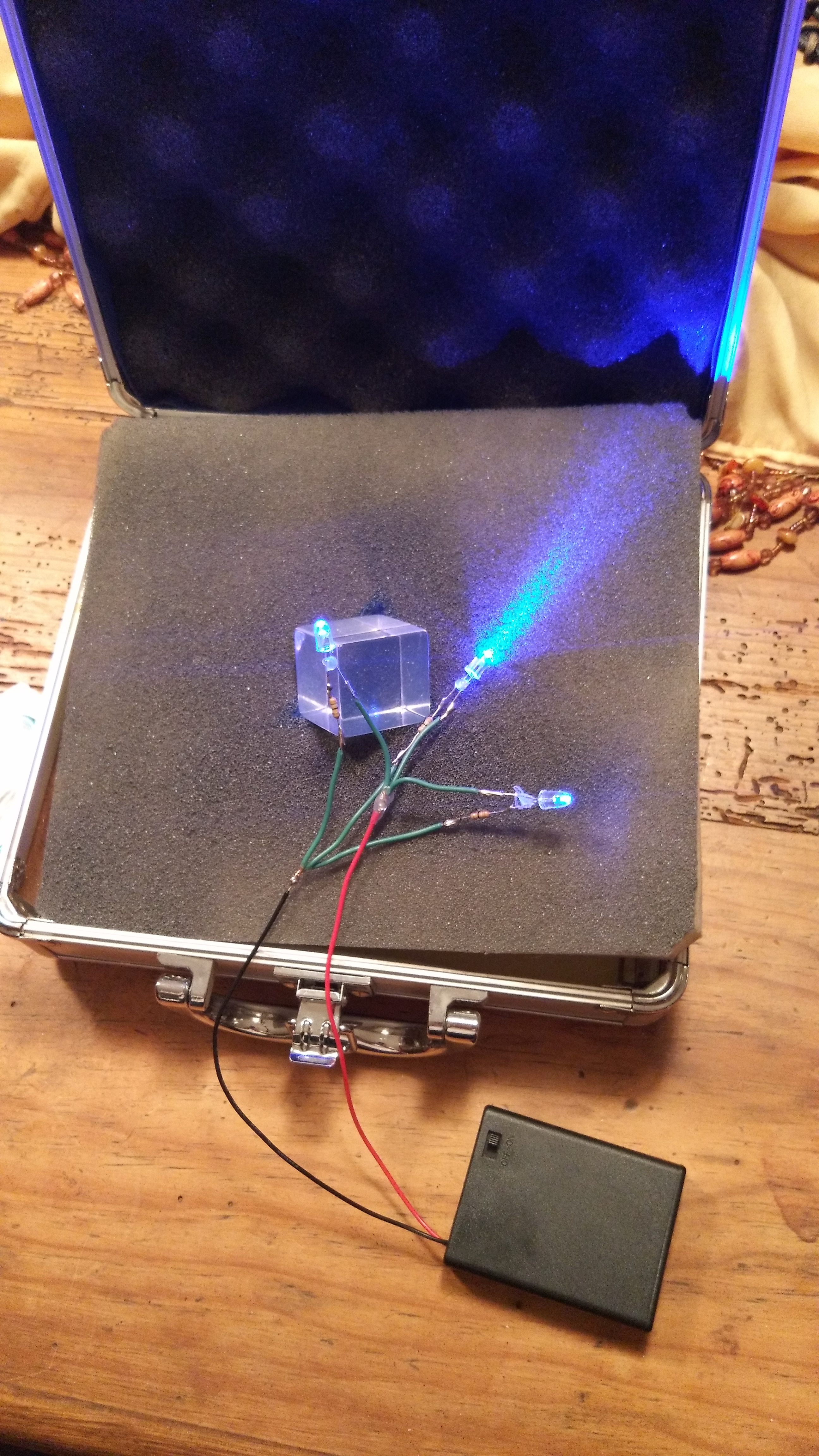

Well $50 at Radio Shack and now I am an "expert". I had to buy an entire combo pack of resistors to get the three 39 ohm's I needed.
I am starting to get it. You just use a LED calc program which tells you exactly what to do.

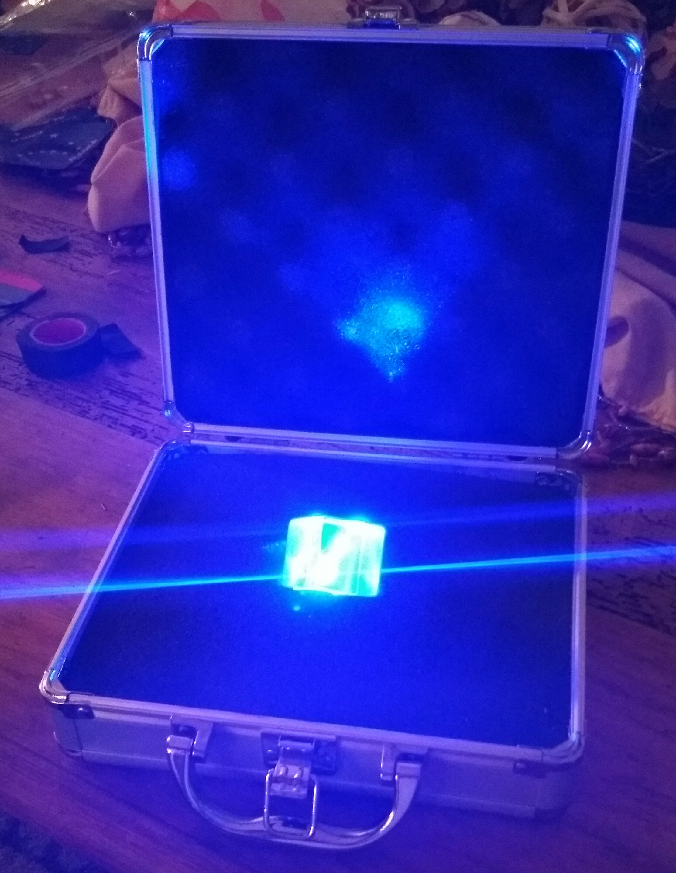

4 AAA batteries, 3 5w blue LEDS, 3 39OHM resistors. A new solder gun....
View attachment 695025View attachment 695026
Nice work! And more importantly, you now have this knowledge in your brain :)
If you plan on doing this more, you might consider picking up some 500ohm trim pots that act as variable resistors and can be set to any value between 0-500ohms. They're too wimpy for very high power LEDs, but are plenty good for little 5mm guys like that.
There are also a plethora of smaller power options available. Adafruit has a little board that holds a single AA and boosts it to 5V, and they also have a plethora of small LiPo batteries and combo charger/booster circuits.
