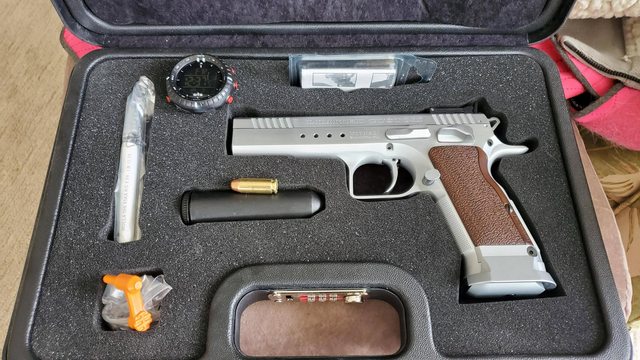

I havent made a mold in decades. I need to make a silicone? mold of a handgun for a holster maker. I need a custom holster for a handgun and the maker needs a resin copy of the gun to work off of. So Im gonna make a resin cast of my gun.
Soooooo, what is a good off the shelf kit that is popular these days? Links would be appreciated.

Brundle, Yup. The holster maker just needs someting to form the leather over as every handgun is different. He has hundreds of molds for different handguns but no Tanfolgio Witness Elite Limited. Thats when I suggested making a cast of the gun off of mine and sending it to him.
Rob, Thats exactly what i was looking for....easy peasy. Yea Ill do a box mold, clay up one side, pour silicone mixture then flip over and do the other side. Ill figure out a way to imbed an aluminum rod inside the trigger guard when I pour the resin for strength.
