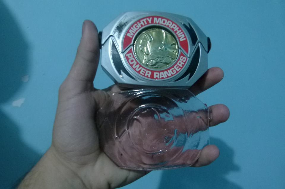

Does polyester resin on a silicon caulk mold melt it? i wonder it, because last time it was hard to replicate the original one, i did a pvc mold by vacuum forming but i was looking forward for this kind of 'cheap solution'
