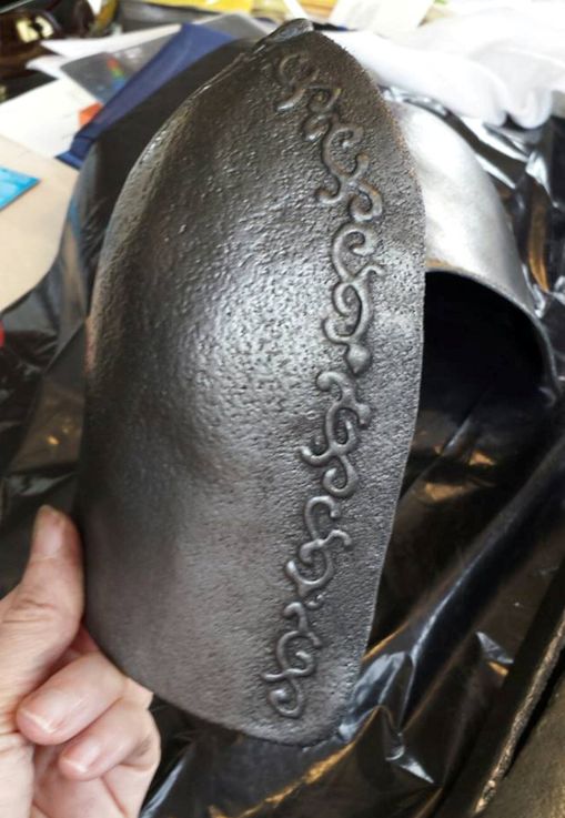

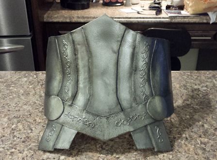

Still waiting for my package from the States, I opted to tackle the armor again today. Got a few coats of primer onto the shield and started weathering on the pieces I've already painted. So far, I've got the lower breastplate, the backplate, the bracers, and the shoulders to a decent stage; I haven't started the top breastplate yet:
pauldron_weather_wip_rs.jpgbackplate_weather_wip_rs.jpglower_breastplate_weather_wip_rs.jpg
I've been using a black-brown acrylic wash, then following with a black acrylic wash. In the cracks and crevasses, I took a fine, wet brush with black paint and then used a dry brush to help soften it and spread it around. I made sure to dab the dry brush into some dark brown paint and worked most of it off before using it to fan out the black. It adds a bit more dimension to the color, and is closer to what I see in the high res photos I'm using for reference. I'm learning, too, that I need to go a little further than I think I do if I want the effects to show up well on camera. At the same time, I don't want to ruin the piece by over-doing it, either. A fine line.

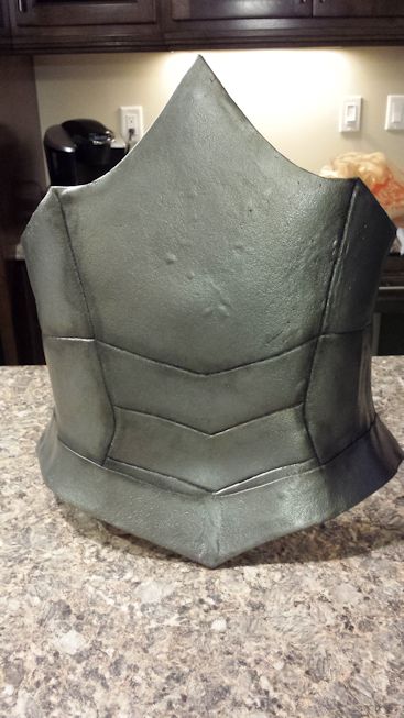

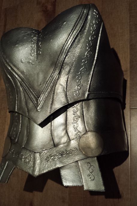

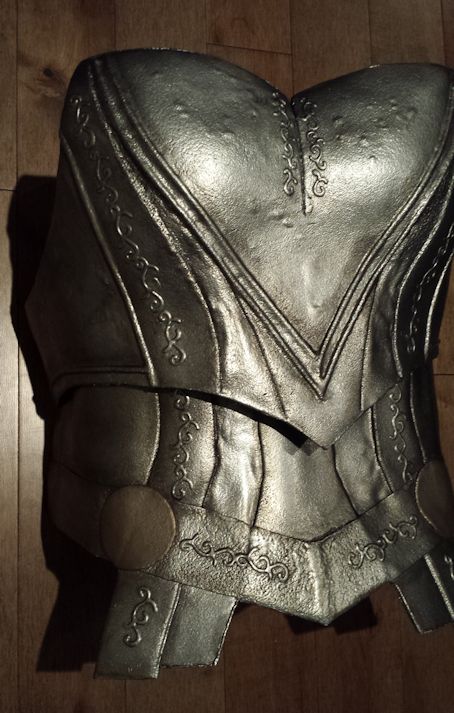

I think I've finished with the upper and lower breastplate, the backplate, pauldrons, and bracers. Still have to paint the shield; touch up the sword; and make the wierd little collar pieces, from fab to paint. A couple of shots of the armor so far -- with apologies for the lighting and cellphone camera:
The bubbles still show up, but I'm learning to live with them. Too late to completely redo everything now, anyway! Looking forward to getting the red leather onto the inset portions, to break up the silver and help set off some of the weathering a bit. Overall, though, I'm fairly happy, as it's shiny, but not overly so, and the texture has helped with the weathering process. If I have time tomorrow, I might bust out the DSLR and take some pics to see how it looks with a real camera.

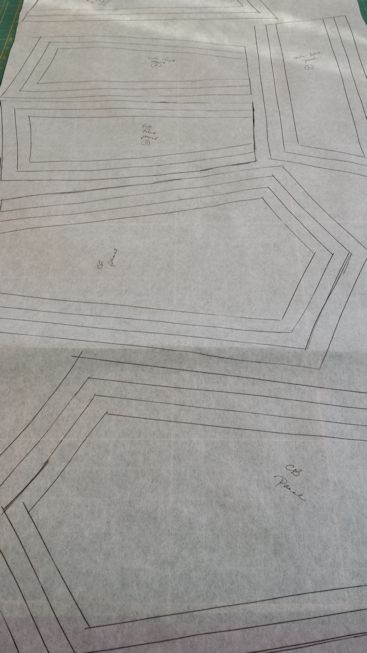

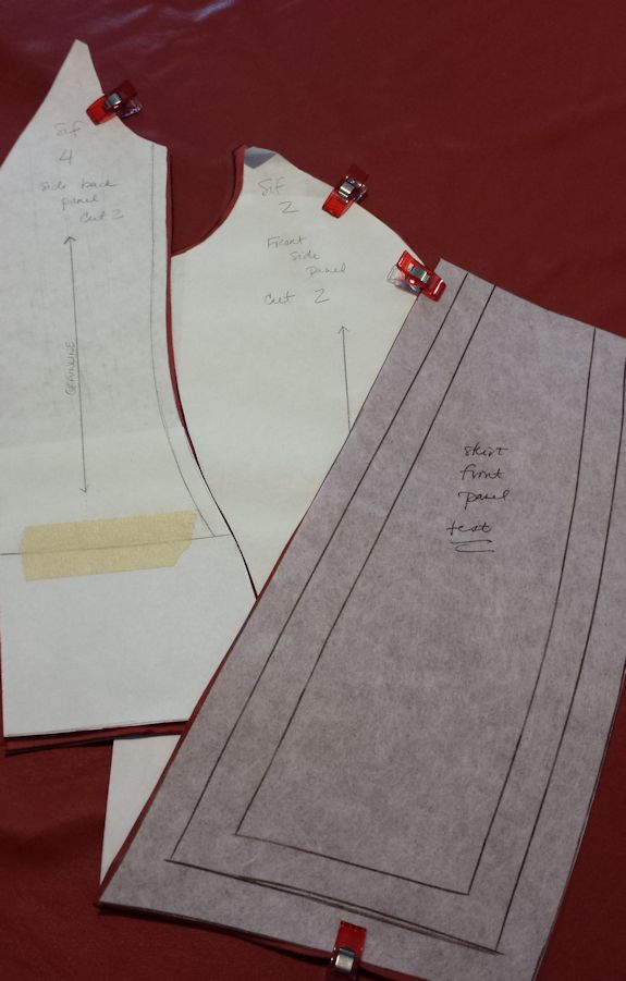

So I actually broke down and started cutting fabric -- and leather -- for the bodice and skirt today. I realized that, in order to figure out what leather I had left for the straps and insets, I needed to cut the rest of the pieces first. Logistics! Who knew?! =D I started with the interlining/lining for the bodice and skirt, then finally shifted over to the leather later this evening:
The leather you see there is the one slightly off-color hide I have, which has the tiniest bit more orange in the coloring (in daylight) than the other hides. I'm trying to save them for the larger, more visible pieces, so I cut the side panels for front and back from this hide, as they'll likely be less visible under the armor. And, because this is (sadly) also the largest hide, I opted to cut a test panel for the skirt from this bit as well.
Most patterns annotate placement of buttonholes, pockets, or embellishments. And, most of the time, when using patterns that have such things, I mark them in chalk or disappearing ink. Unfortunately, as I lack the lovely disappearing leather marker Tandy makes, I can't do the same for the finished side of the leather; I've had to come up with an alternate solution. Since I'll need to use some sort of stabilizer anyway, I opted to trace the stitching guides onto tear-away stabilizer. I can put that on top of the leather, giving me guidelines to sew over and helping the leather feed properly through the feed dogs:
I'm still not sure if I'm going to do the embellishment. I'd really like to be done with everything so I can do a test fit on Sunday; Monday at the latest. If I do the corded stitching, that will probably add two days onto the construction process (at least). I'll be able to better judge the time sink -- and the construction method -- after I work on the test panel tomorrow. The muslin tests were okay, but I never did manage to get the cording threaded through the stitching. And of course I forgot the cording foot back in Houston. Meh.

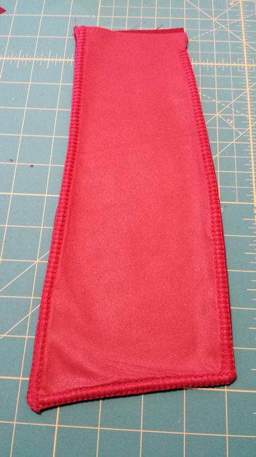

So while I'd intended to spend the day working with the leather bits, I ended up working with the "chainmail" bits instead. I drafted a skirt pattern, cut it, and stitched it all today. Nothing fancy, and I think I would have preferred some different finishing techniques but the material was kind of a PITA to work with. Easier than I thought it would be, yes, but still difficult. It'll work fine as a base layer:
It wasn't until after dinner that I finally turned my attention to the leather. First thing I discovered was that this leather is so lightweight that I cannot start too close to the edge, else everything gets sucked down into the feed dogs. The second thing I discovered is that, also because the leather is lightweight enough, I don't necessarily need the teflon foot when sewing with the right sides together, and the "suede" side out. It stitches very nicely and, with the press cloth, presses fairly well, too.
That out of the way, I started playing with the skirt test panel. I found it was necessary to have the stabilizer with the leather to get the machine to feed the project through, though it didn't matter if the stabilizer was on top or bottom. I used a knitting "finishing needle" to thread the 1/8" cording through the stitching. A bit of finagling, but it did finally work. I actually realized about half way through the process that the whole thing really was going to work and it was going to look pretty darn cool:
The whole process, however, took a little over an hour. Add in room for error, and it clocks in somewhere around the hour and fifteen mark. Multiply that by 8 panels, and you end up with about ten hours -- just to assemble the skirt panels, and not even the skirt itself. That also doesn't take into consideration that each panel really has at least 2 rows of corded stitching; both the center front and center back have three. If I had gotten my press cloth on Thursday or Friday of last week, I think it would be possible. At this point, however, I think I'm going to have to forego the decorations and just go with plain skirt panels... which totally bums me out because it does work and it does look really awesome. I just don't have the time. =(

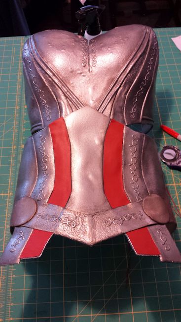

A late start in the sewing room today meant I didn't get nearly as much done as I would have liked. Still, I managed to get the bodice and the skirt cut out of the leather hides and start fitting the insets for the leather. I'll start construction tomorrow, I think... after I decide whether or not I'm going to interface or interline the bodice.
I'm rather pleased with the way the insets are shaping up. I only got the lower half fitted, as the top insets are going to be much more fiddly and require more fine-tuning. Nothing is glued in place yet, but I'm definitely getting excited about seeing the whole thing together!
