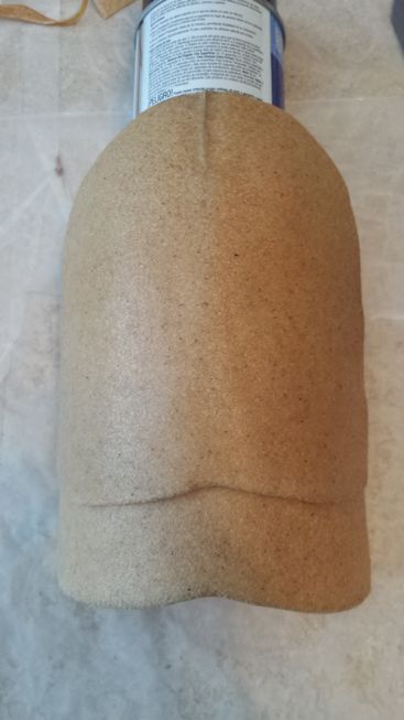

And now off in search of a properly-sized sphere for shaping the pauldrons...

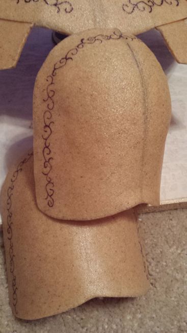

Did a little bit more prep work today, as I sat watching bad movies (Breaking Dawn, anyone?). Made my stencils for the scrollwork and got the designs traced onto most of the armor:
I also found a lovely 5" styrofoam ball at Michael's, which I then used to better shape the shoulders:

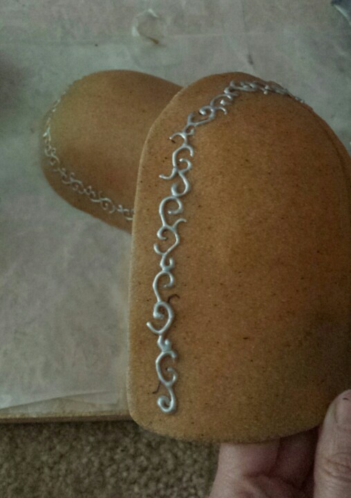

Today, started adding the puffy paint to the scrollwork:

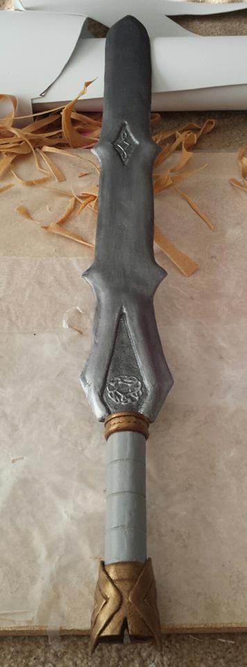

And started detail painting on the sword:
Still needs more dry brushing to add the right textures and highlights, and the red leather wrapped grip, but I'm pretty happy with the progress. Yet another learning curve on a new project. There are days I feel like I'm chiseling away at a redwood to make a toothpick...

Stellar puffy paint work. Do you use anything special for a tip? Or just the standard bottle. This looks very precise.
Re: Sif (The Dark World) - WIP
Thank you -- another case of slow and steady winning the race. Just sat back with "A Good Day to Die Hard" on in the background, and went to work. =)
What you see was accomplished using the small bottles of Scribbles fabric paint (iridescent silver). It has a finer point than the small-bottle Tulip metallic paints, which surprised me, given that the Scribbles is the "cheaper" option. I used Tulip on the sword and had a harder time controlling the flow, even with steady pressure -- maybe a combination of the viscosity and the point. The Scribbles paint went on much easier and I like the results better. I'll be curious to see how much the paint contracts as it dries, in comparison to the other.

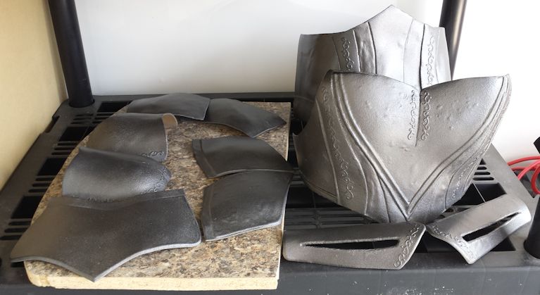

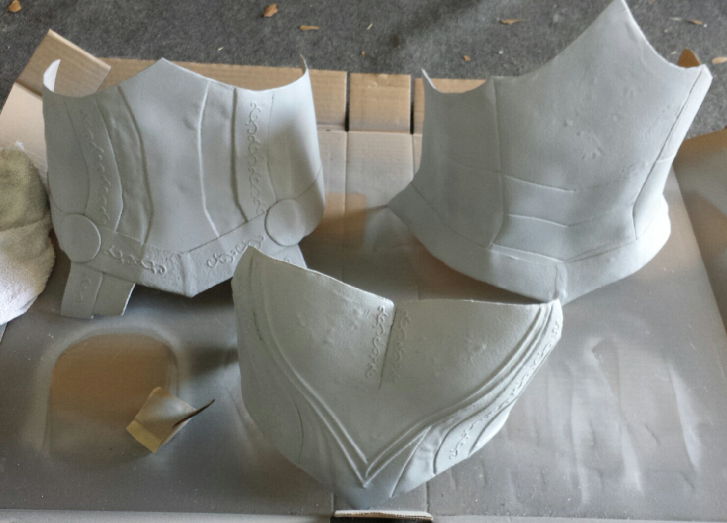

Started the primer coats on the smaller pieces today -- the back "skirt" plates, and the front hip plates. I'm currently using the Rustoleum Filler Primer, as I've had pretty good results with it on the sword. Given that I likely won't be sanding the area too close to the scrollwork, and that her armor has a bit of texture to it as well, I'm contemplating switching to some regular gray primer. Just have to see how the skirt plates and hip plates turn out with a couple of coats.
Still have to wrap the grip on my sword and finish the detail painting on the blade. Going to try and get that done this weekend. Got a trip down to Galveston, though, to stock up as the (in)famous Colonel Bubbie's is going out of business at the end of the summer. Might have to see if we can get some of the stuff for a TFA Cap (DH wants to do one).
So I probably should have just used regular old gray primer... The filler hasn't been a total catastrophy, but is requiring a quite a bit of sanding prior to the base coat of color, as it has completely changed the texture of the worbla. The primer is also bringing out all these lovely flaws that I thought had been better blended and shaped. Ugh. Still, not too bad:

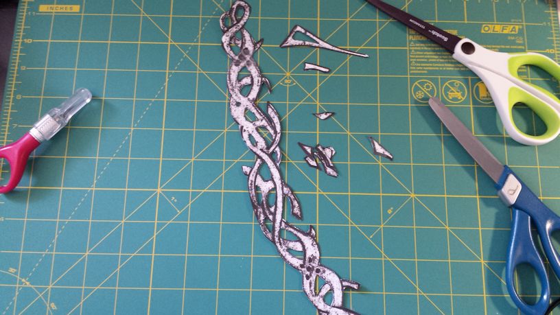

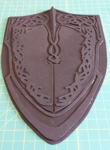

So after a great "date day" with DH (Guardians rocked, BTW, in case you were wondering), I came home and got cracking on the shield. Basically, I started with a good reference image that I scaled up to the approximate size I needed, then washed through the "find edges" function in PaintShop. I then printed it out over several sheets of paper, piecing it all back into one larger whole. I trimmed it down to just shield-size, then taped it down onto a portion of easel/art paper. I added 1/4" all the way around, and cut it out, giving me a template for the leather backing. In this case, I expect to use some sealed and painted craft foam.
I started to trace the more detailed designs out on scrap paper, but then realized that I could just as easily copy it on the scanner, print it out, and take some of the work out. Duh. I think I need more sleep! What I get for playing Diablo III until 2 AM, I guess...
This is what it looked like before I turned off the lights in the sewing room for the night:

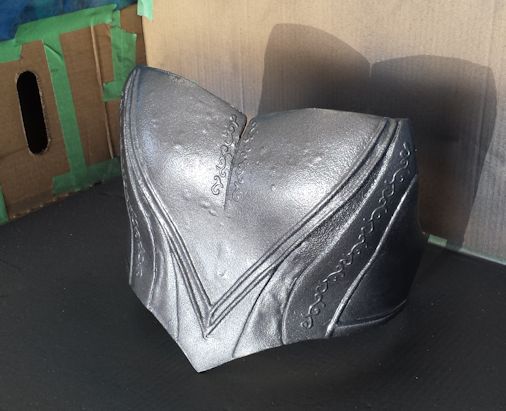

Looking at the picture, it appeared that the paint had not quite layered up so well on the front portion of the breastplate. There were two factors in this -- the spattering paint issue, and the fact that the lovely coastal breezes kept sweeping into the garage, blowing paint in the wrong direction. I moved the breastplate into the makeshift paint hood (I'd been painting the larger pieces on a big piece of cardboard), and recoated it. It looks much better now (worbla bubbles aside ::sigh:: ):
The texture turned out okay -- hers is not entirely smooth, and this is a close approximation -- I'll still be going over it with some steel wool to soften it slightly prior to sealing and adding the leather insets. The top coat of color will be "dark steel" (slightly lighter than the "soft iron"), after which I'll add highlights and weathering.

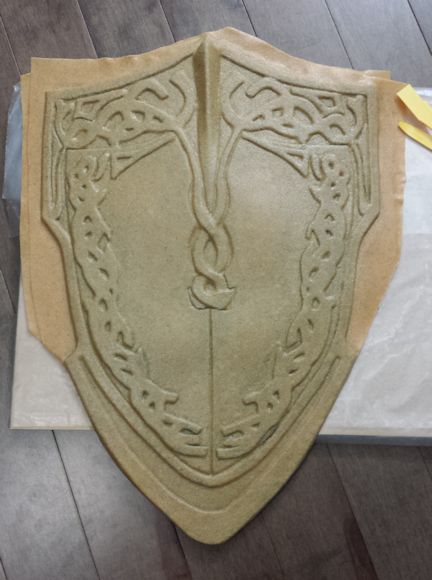

Shield -- ready for worbla. Yay!
The very back layer will eventually be red and resemble leather. I'll likely use puff paint to add in the infinity knot-style details at the bottom and on the raised piece. That will allow me to better shape and scale the design to the available space.

I took a couple of days off to work on my Jedi tunic, and swung back around to Sif this evening, after dinner. As per my previous post, I'd glued down the bits and detail for the shield, only needing to sandwich it between the worbla. What a lot of work! Three-ish hours and I finally got everything laid out and the worbla shaped over all the nooks and crannies:
It's still "open" across the top, so I've not yet trimmed it all the way around; I'm slowly making my way up from the bottom. Try as hard as I liked, and despite going very slowly from the center, there are still a few air bubbles on the left side, closer to the knotwork detail. I worked most of them out or down, so I'm not sure how much will show. Larger pieces like this are definitely harder to work with than the bracers I did last year! Hoping to finish sealing it up and trimming off the excess worbla tomorrow. There's a bit of rain in the forecast, so painting is up in the air. I'm fairly well protected in the garage, so we'll see. If nothing else, maybe I can start getting the fastenings in place on the inside of the pieces -- industrial strength velcro, some leather straps, and some D-rings, just to name a few.
And on a related note -- does any one have any experience using adhesives with worbla? I've been contemplating the best way to attach the red "leather" to the shield once I have it done, and I'm not sure what adhesive might be best suited. I have contact cement and E6000 spray handy at the moment. Might have to conduct a little experiment tomorrow to see which way to take it.
Doing a large piece like that completely bubble free and smooth = total PITA. I bet you're glad that part is done. You can use a fine needle to poke bubbles then heat lightly and press them out. (You probably already know that trick I'm guessing.)
As for adhering I've found the best thing that sticks to worbla is hot glue. That may not help since you have a lot of space to cover. I'm guessing contact cement may, I haven't tried it. I do know that Super 77 (spray adhesive) and quick setting epoxy don't work.
