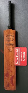

Quick rundown on the build
The bat was originally white with red and blue graphics, so I stripped and sanded the entire bat.
I rubbed the bat with linseed oil and walnut brown express strain to get the aged warm finish.
The graphic was next on the list. The original was stamped or burned into the bat based on some pictures I found of vintage bats from the same manufactor.
I decided that I did not have the time, skill, or tools to burn or stamp the graphic, so I opted to transfer the graphic using a laser (toner) copy and Acrylic Gel Medium.
Here is the graphic I created based on the vintage bat and screen caps.
Once transfered, I distressed the graphic with a brass wire brush. Then used black athletic tape on the handle and splashed on some red acrylic paint for blood.

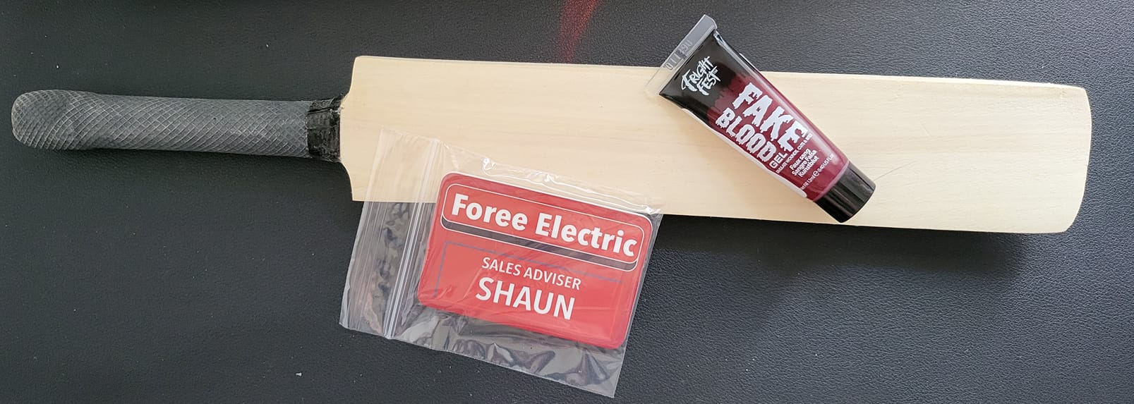

Just got an amazing boxset on 4K and wanted to do a little display....so found this 15" bat (made for autographs) and hoping to recreate...
The only issue I have is no printer so might try hand drawing the graphics
