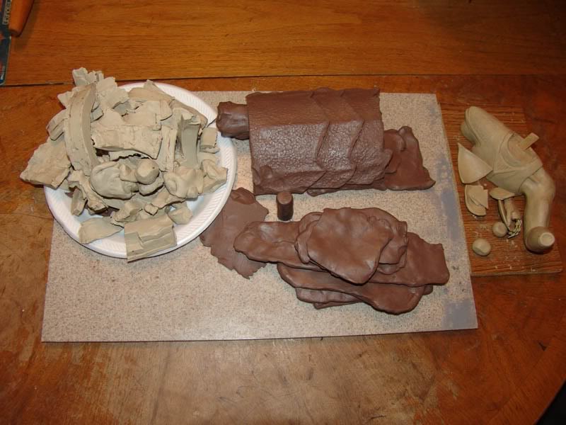

The clays I use. Kleen Klay regular I use mostly for mold making these days, Classic Clay medium for general use and Classic Clay hard for the small detailed work.
I also use different size boards mostly Corian for the base of most of my flatter sculpts

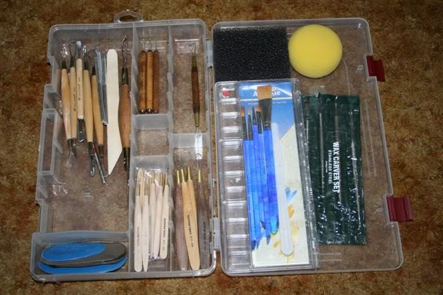

The full set of tools from Michaels. Good starter set. I had to sharpen a few of the pieces to make them work better but I like this set.

General tools I've used. flat edges, sharp blades, pointy sticks, plastic back for nonstick, spoon for outside rounding, pizza cutter for cutting thin flat pieces, punches are different diameters for different size channel type details.

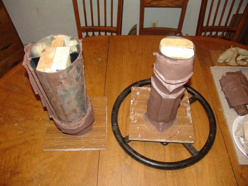

My leg armatures. 2x4's screwed to a square board. Each one is wrapped with a galvanized sheet to size it larger. They can be screwed to the swivel from a broken bar stool seat.

geez! your tools are so nice and clean!
Yeah they havent all been used yet and I try to clean them off good between use. Especially since I use some of them on oil and water clay. This isnt even all my tools I have calipers and what not too.
