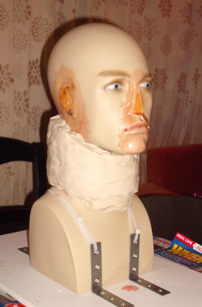

Hi, my wife is just about to try her hand at sculpting her first pred mask, but a few things are puzzling us at the moment -
When you've got the shape blocked out, how do you keep track of exactly where the eyes are? With the constant refining/reshaping, could we end up with the eyes out of place?
Can the sculpt be used first to make a silicone mould for casting resin, then used to make a plaster mould for latex casting?
Usurper - you mentioned in your journey thread that you cut the ears and nose off the mannequin head to make it easier to get the head out at the end. We thought that the 2 part mould would come away, leaving the clay to be peeled off the mannequin head.

The eye are soemthing that really do not change location ( unless you screw up badly )
Yes you can take a silicone mould from the sculpt to make resin copies, prior to making a plaster mould for latex ( or simpler, you could just make latex copies from the silicone mould, you would need to dry the layers or it would take a fair bit longer than a stone mould to cure though )
With chavant it sticks really good to the mannequin head i use, and as the clay and head will not just come out on one peice on a stone mould, not having ears to dig clay out from behind makes it easier to dig the clay out of the mould then remove the head , with the nose, i remove it incase the nose is not very deep in the sculpt, i would not want it to push down and possibly damage any detail in the mould ( again plaster, silicone would not take any damage )

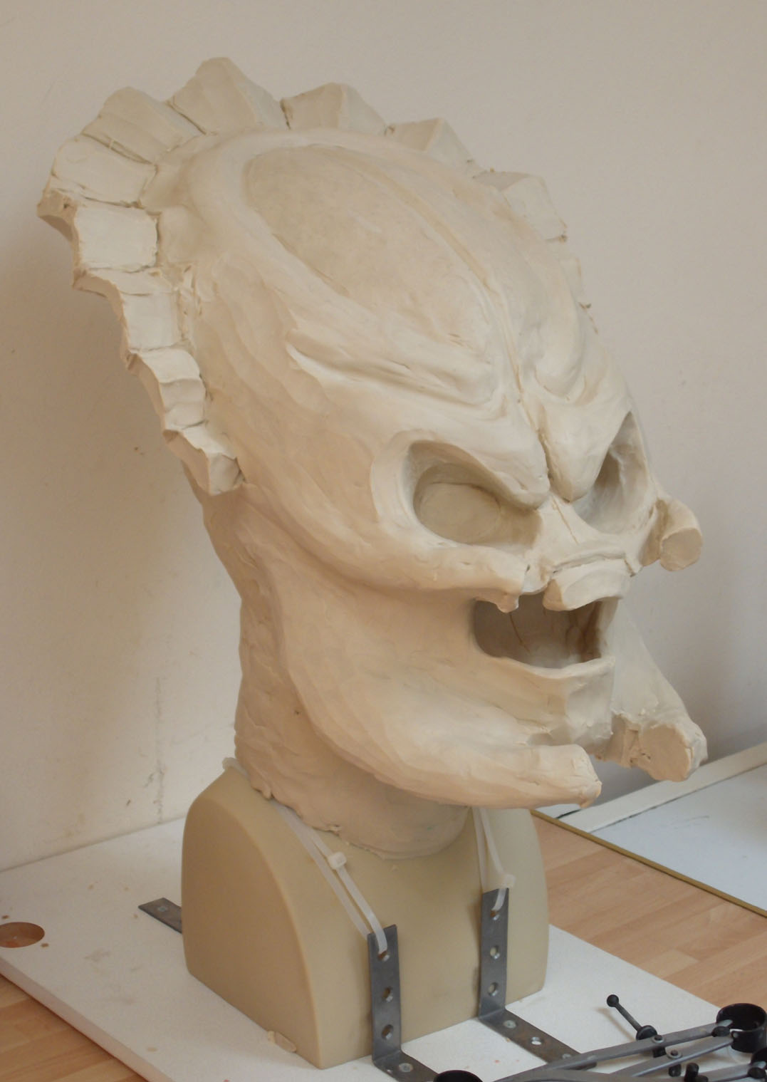

I finally got around to stating to block the shape out, I couldn't post pics from the very beginning my internet slowed right down, I couldn't do anything with it, it seems to be ok now, so here goes - first thing was to fill the neck out to about 20 inches
Then I started to block the shape out, I'm using my P1 mask as a rough guide to the size
I had left the eyes uncovered to give me a reference point, but I discovered now that this was a big mistake; I couldn't get the proportions to look right, I eventually worked out I had to fill the eyes in to a fair depth, otherwise the eventual mask would have been rubbing against my eyes! this simple mistake caused a fair bit of frustration, but once sorted, this pushed everything forward and it all seemed to click into place.
I now decided to start work on the bony fringe, I cut some slots in purely as markers, stuck the clay on to the rough shape, since this pic was taken, I've filled in the slots.
That's as far as I've got for now, hoping to do some more over this weekend, any thoughts/suggestions so far?

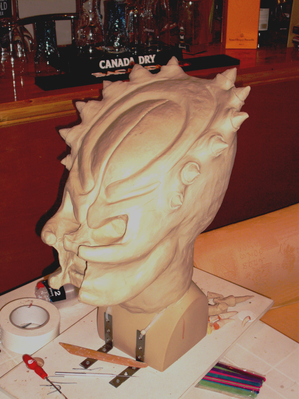

After much looking at reference pics and staring at the sculpt, I finally realised what was bugging me about it, I hadn't tapered the sides of the head down towards the front, so it was throwing everything out of proportion; so I trimmed the temples down and angled the bony fringe down. Next I reshaped the eyes and starte work on the mandibles - now it feels like I'm finally getting somewhere. I was going to have the second bony fringe like P2, but at the moment I've just put my own design in, I'm still not sure yet whether to go for an elder look, but I think I'll try and make the bony fringe look like exposed bone, any suggestions/comments?

I've finally had some time to get on with this, we've had visitors staying over for a few days. I've thinned the lower jaw by quite a bit and tried to even everything out a bit. The mandibles and teeth are just rough for now just to check how it will finally look.
I'm more or less happy with the shape of the head now, but I'm not sure about the bony fringe - I want it to look like exposed bone, I think it looks ok on the top of the head, but I'm not so sure about on the inside where it'll be just above the dreads. Maybe it'll look better when it's painted up? What do you guys think - any ideas/comments?

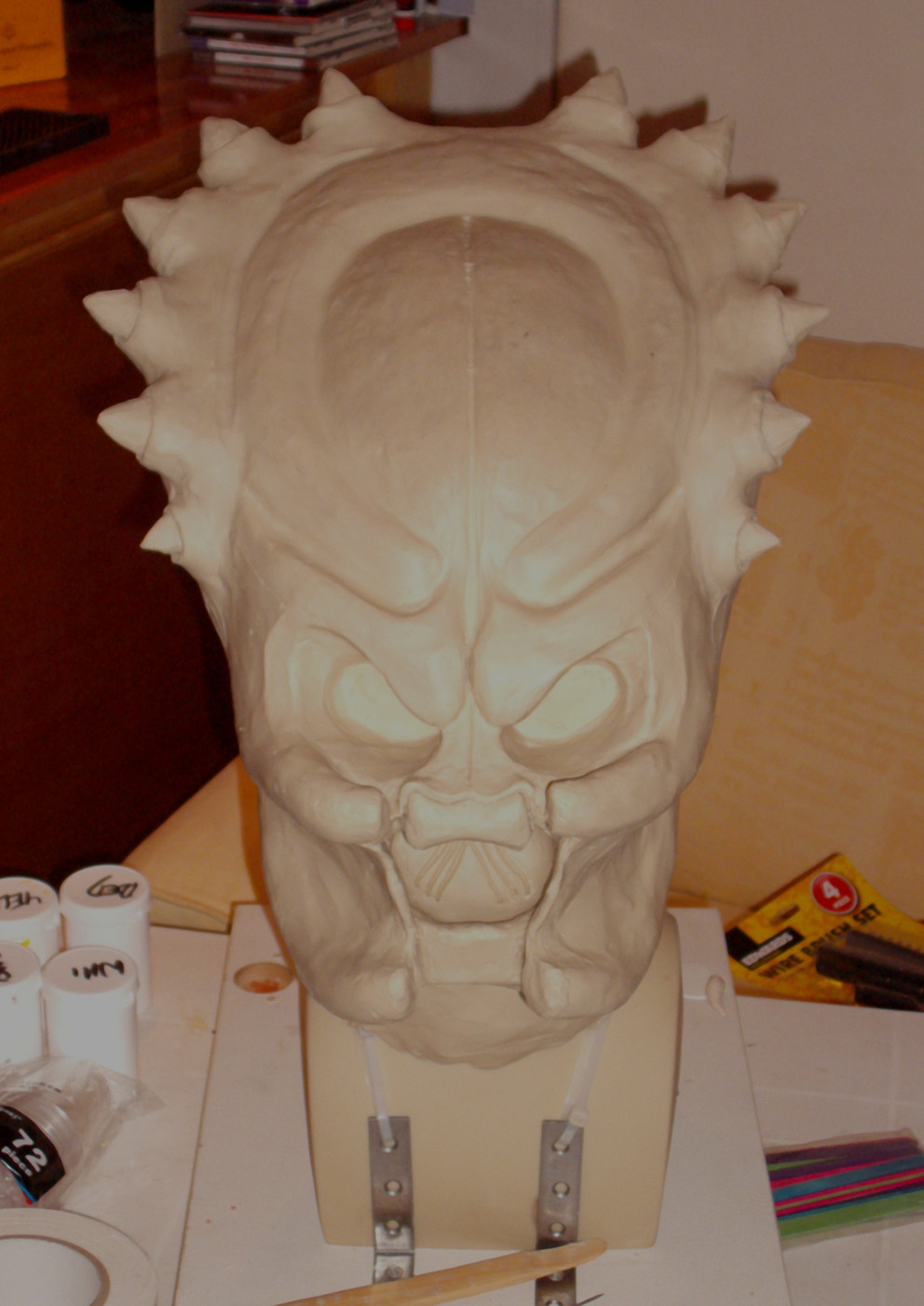

I've changed my mind about the bony fringe, I just couldn't get it to look right, so now i'm thinking of two rows of spikes which I've roughed out at the moment on one side;
My questions are - if I make the spines in clay, will it be difficult to clean the mould where the spines are and would they be difficult to cast without air holes?
I was thinking of casting the spines, tusks and teeth in resin and just making the holes for them on the sculpt. Any help would be greatly appreciated, I feel a bit stuck at the moment, thanks guys

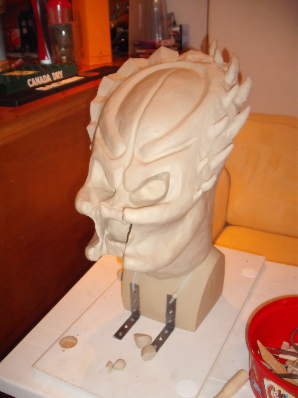

I changed my mind yet again, I was watching a program about dinosaurs and that gave me the idea for the bones/horns I've done, I think I'm finally happy with the design, maybe now I can finally get on with some smoothing and start to shape some of the details.
