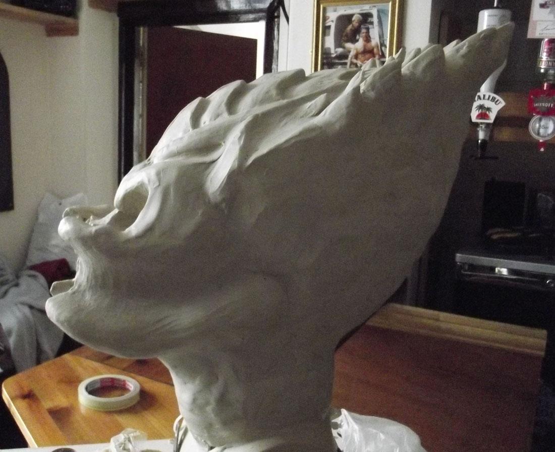

Not a big update, I've started working on the mouth area, the teeth are just temporary to give me something to work around, I still need to make the top 2 teeth yet.
Next is inside the mouth and cheeks.
I've been enjoying doing this so far, I have learnt though to just walk away and come back later if it isn't going right, which has happened a lot so far.

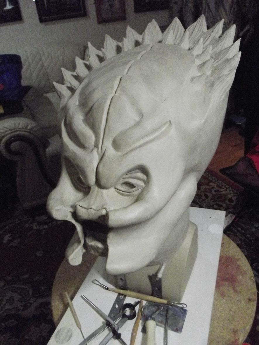

Giles
Looks good.  My only suggestion is to maybe blend some of the eye area a bit with the surrounding.  It looks awesome on the "face-on" photo although the side angles makes it look like a pred wearing Magneto's helmet around the eyes.  It probably looks totally different in the flesh mind you, so feel free to ignore me.  Just my two pennies worth.
Untamed
Looking good! I'm at the same stage as you and its a blast! is it me or does the forehead look almost indented? may change the look of the mouth and location of the mandibles once you figure out the eyes and forehead. I had the mouth looking good on my sculpt then i switched back to shaping the forehead and shape of the head made me want to change the location of the upper mandibles. Don't listen to me though, as long as you're happy with it, i am in no way a guide in this lol. Nice job!
Thanks Giles, you're right, the pics do make it look like Magneto's helmet, but I think the flash made it look worse, once the texturing is done I think it'll soften it, if not, maybe I'll have the first mutant pred? :p
Thanks, not too sure exactly where you mean is indented, any advice is welcome though.

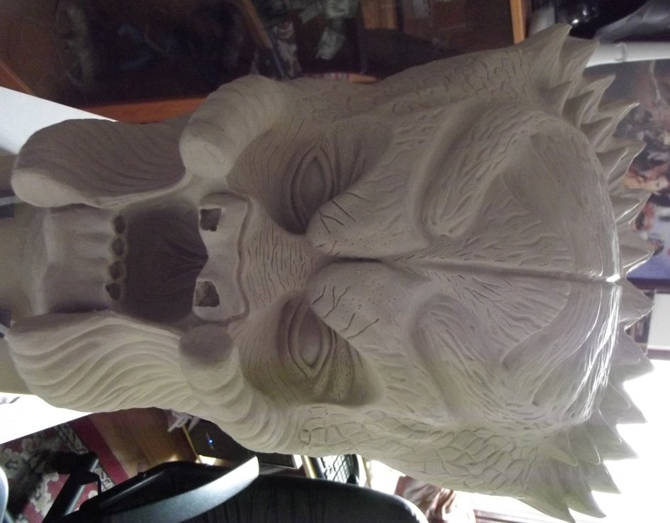

Now that I'm more or less happy with the basic shape I thought I would have a go at some of the finer details, so I've started adding texture around the eyes and done most of the inside of the mouth.
I also had to reshape the back of the eye sockets, I never realised I'd sculpted them flat, so the eyelid area looked totally wrong.
I still need to make some proper top fangs to finish off the locating holes for them, once they're done I'll finish shaping the nose? properly.
Any advice/suggestions gratefully received, thanks.

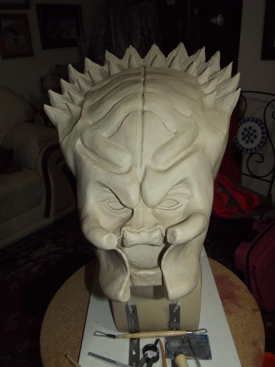

Had some time to do a bit more work on this,got some more texture work done and started on the dread holes as well.
Still a fair way to go, but I'm pretty happy with the way it's going so far, I've already got the metal plates in hand for the mould line, I'm sure I'll have some questions about the moulding process later.
Giles
It looks fantastic, detail is looking good.  You have certainly softened everything up.  What are your plans with the teeth/Tusks?
troggs
Thanks Giles, I'm not too sure about the tusks yet, I'm thinking of nothing too big, maybe fairly short like Wolf's. I'm going for 4 small teeth like P1.
