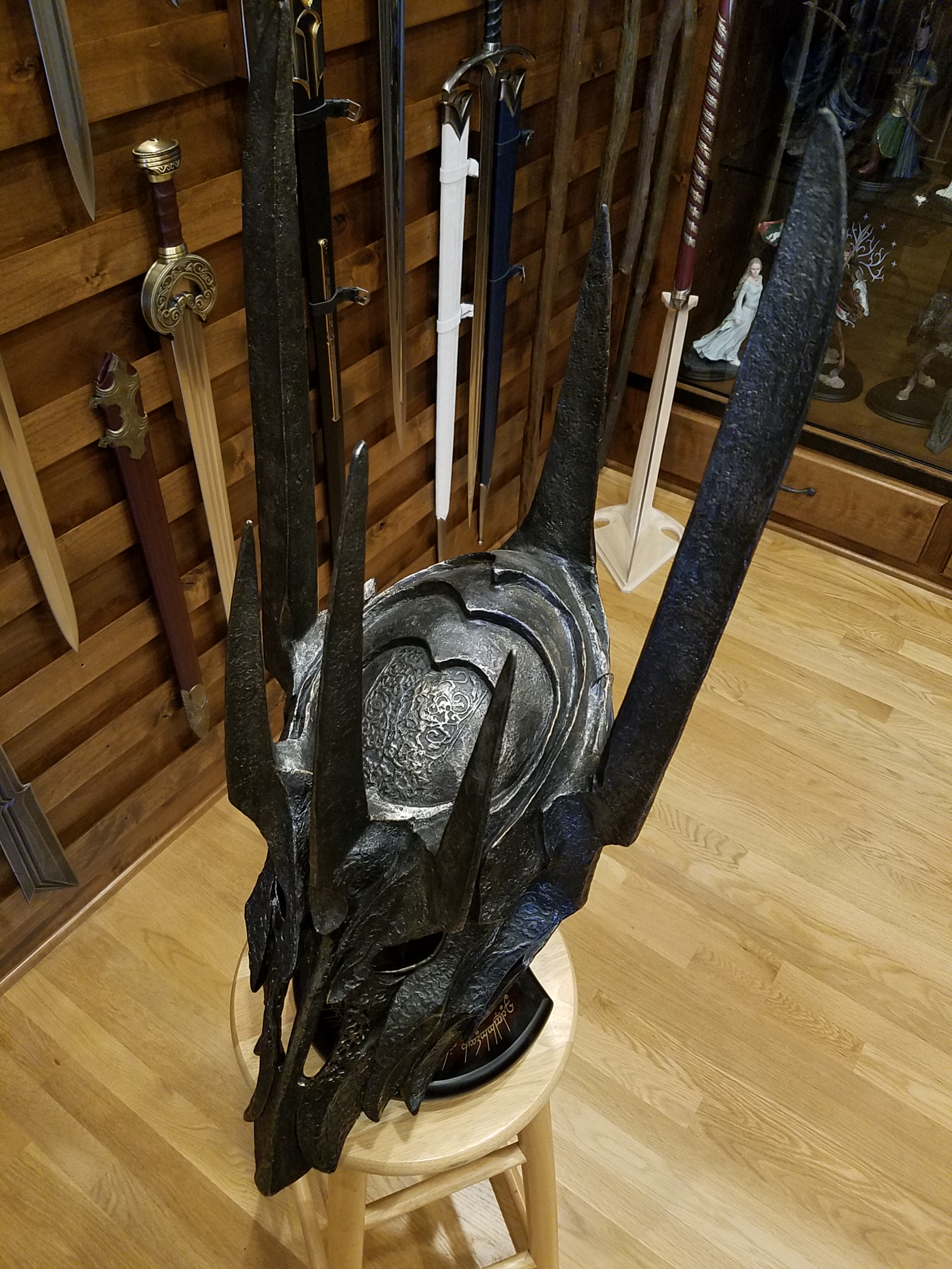

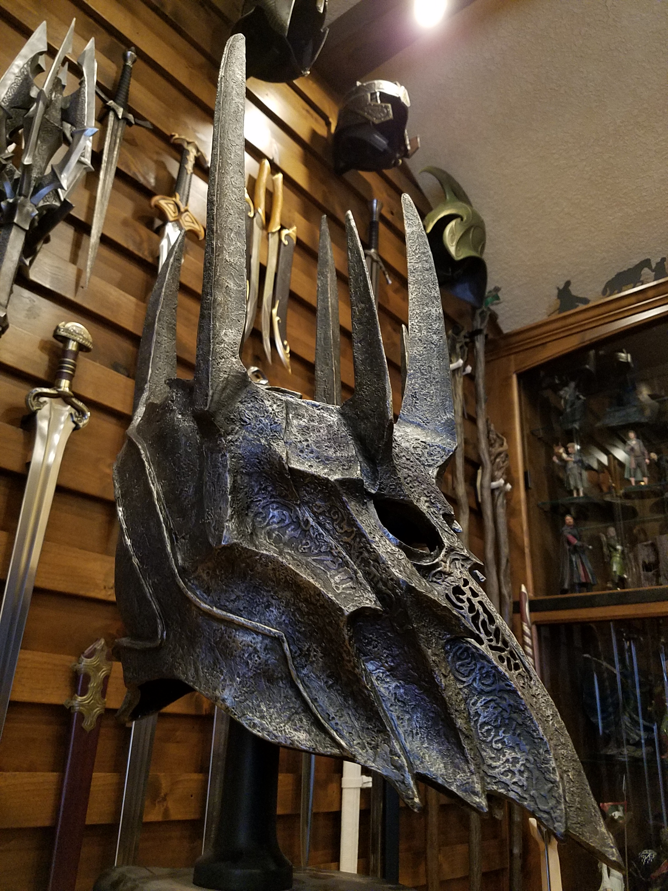

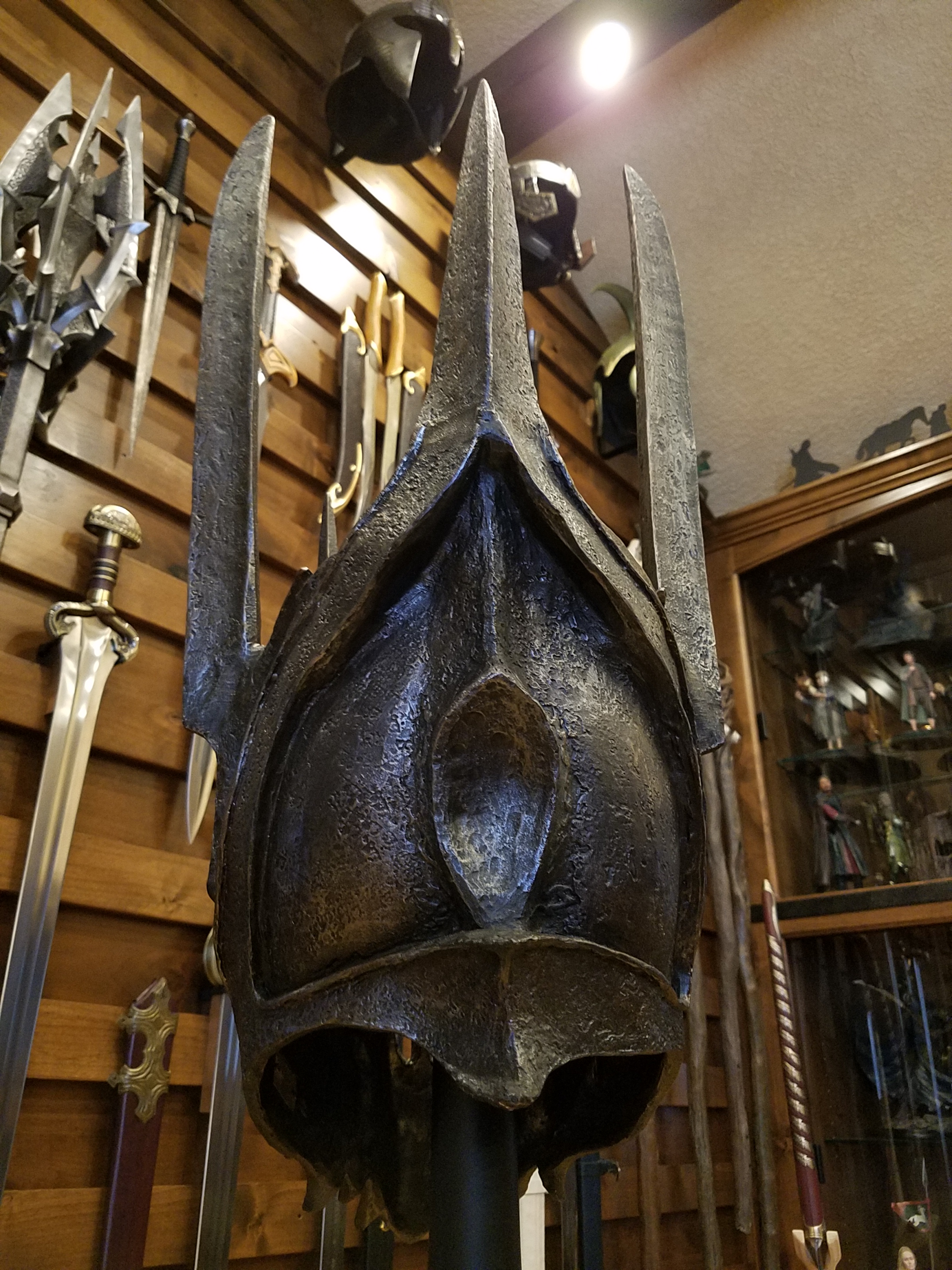

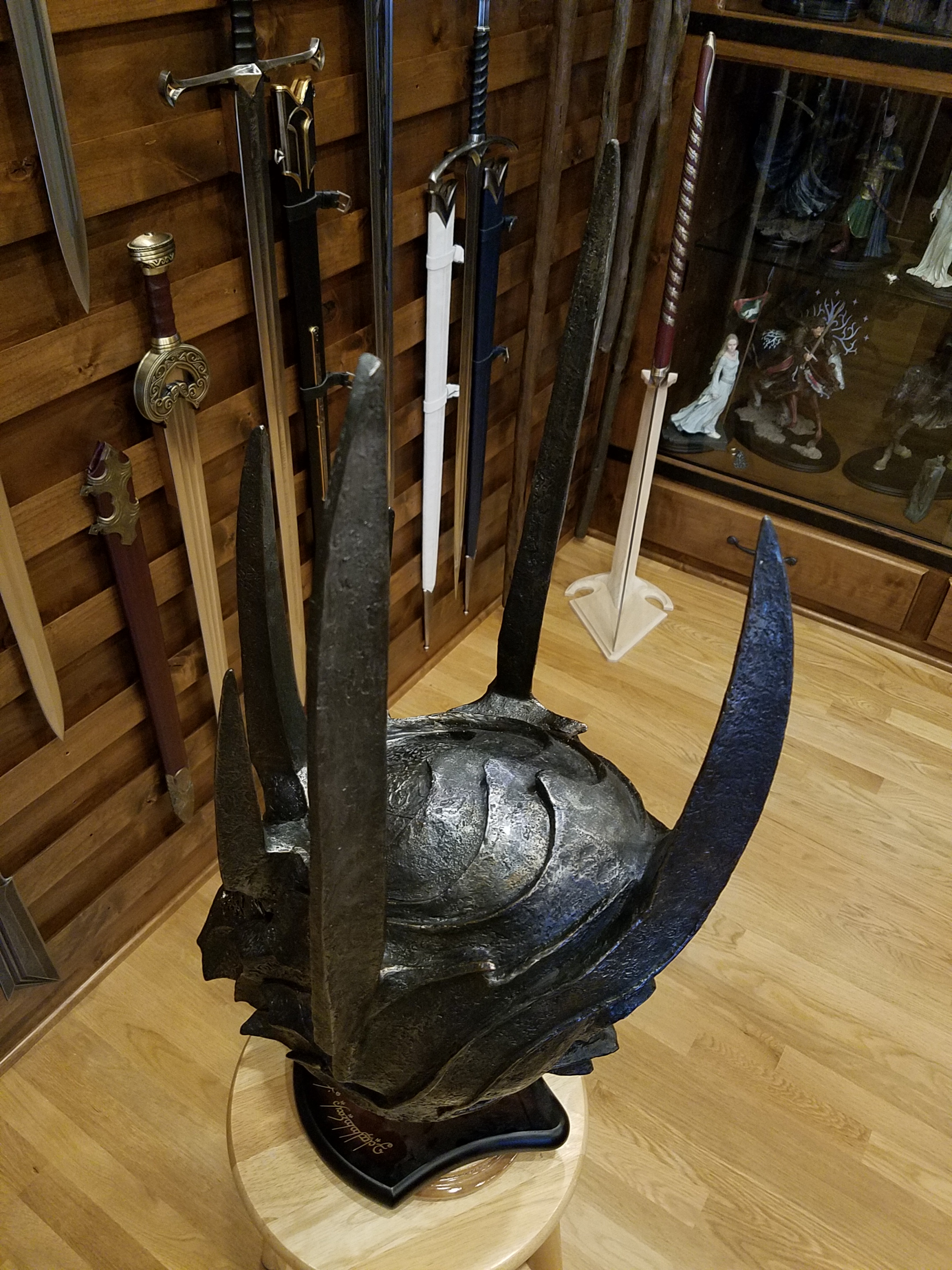

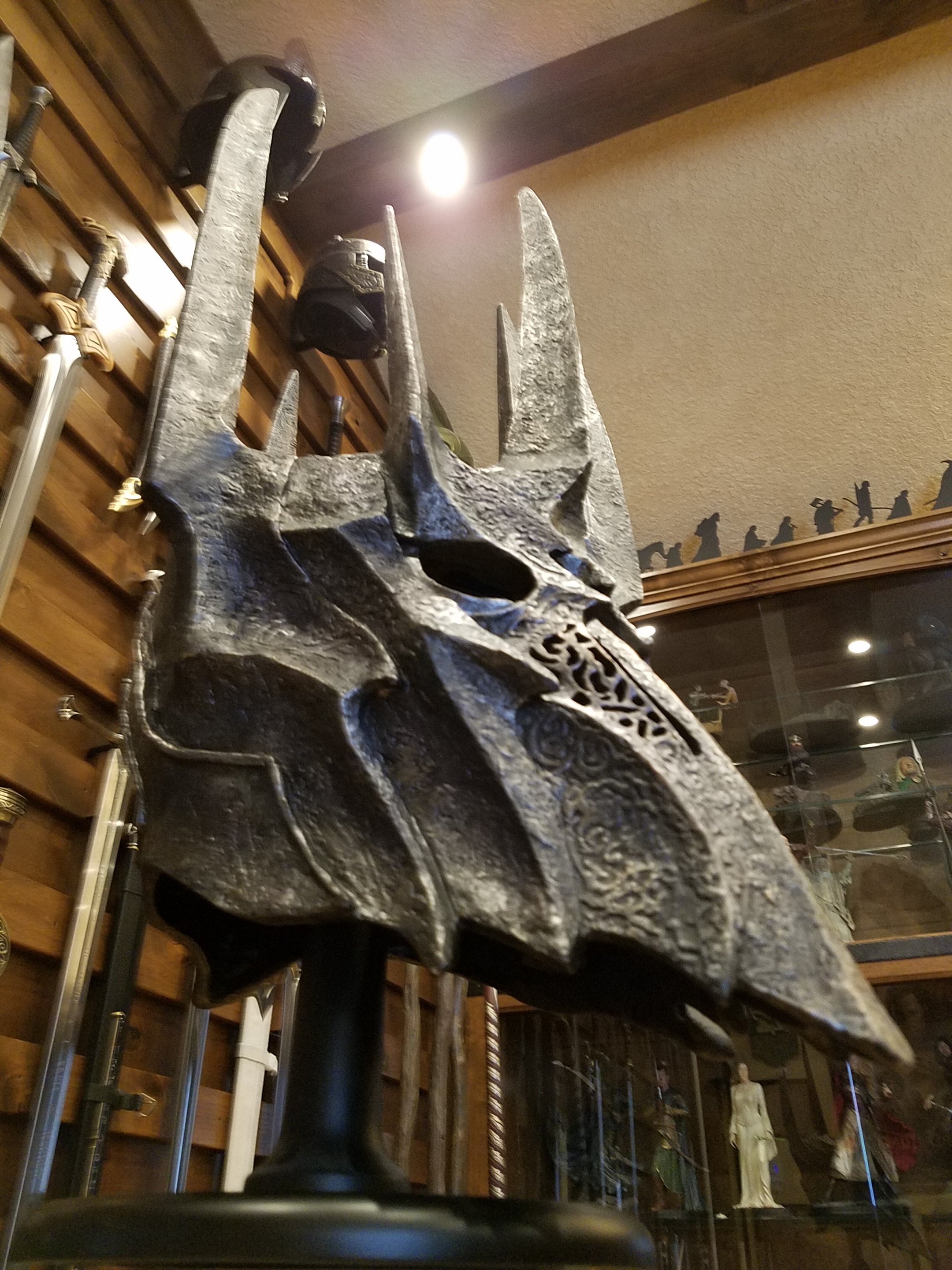

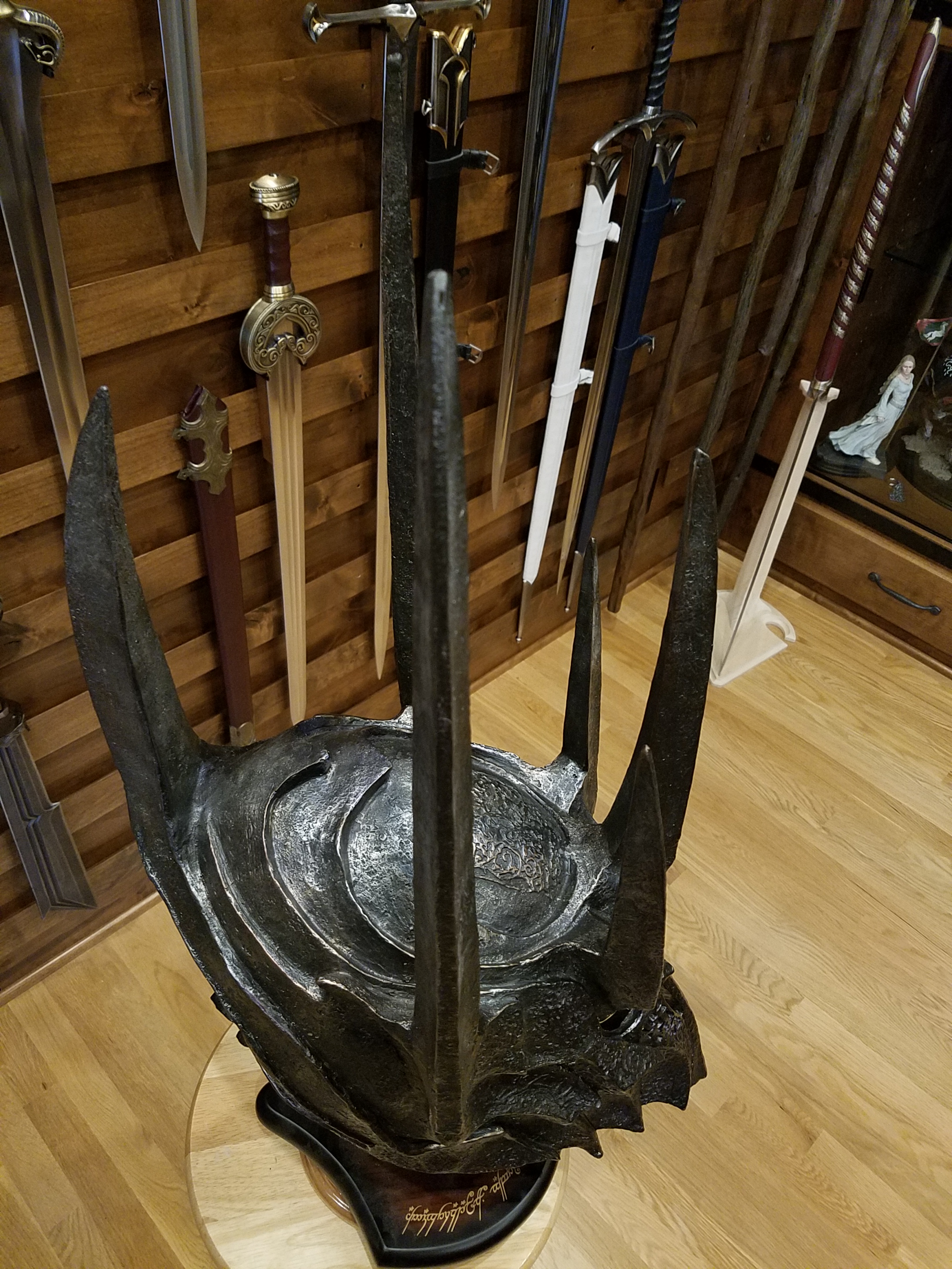

WOW, those images are fantastic, those will help a lot.
Thank you!
And you can clearly see that the United Cutlery patterns are very accurate.
Thank you!

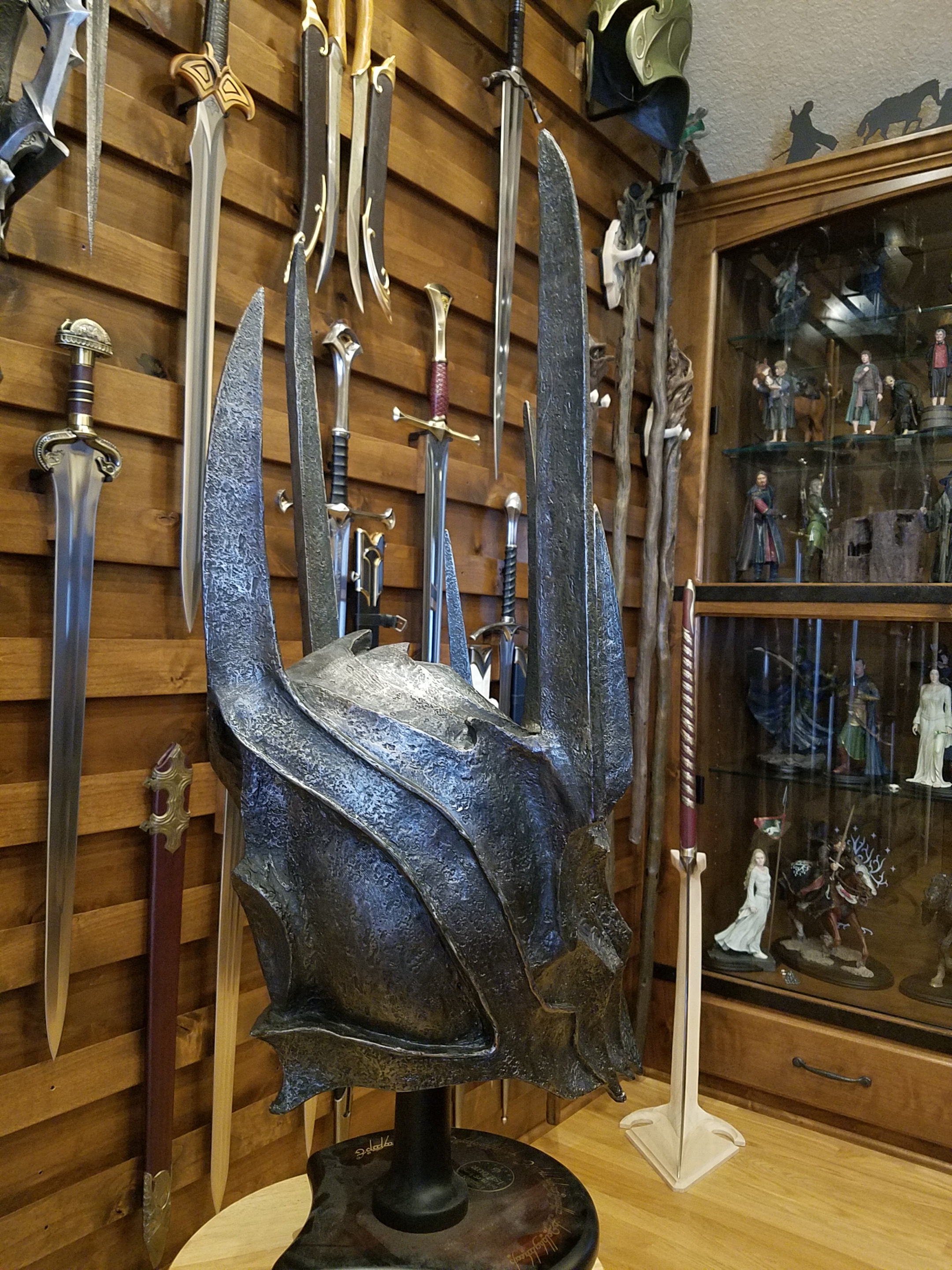

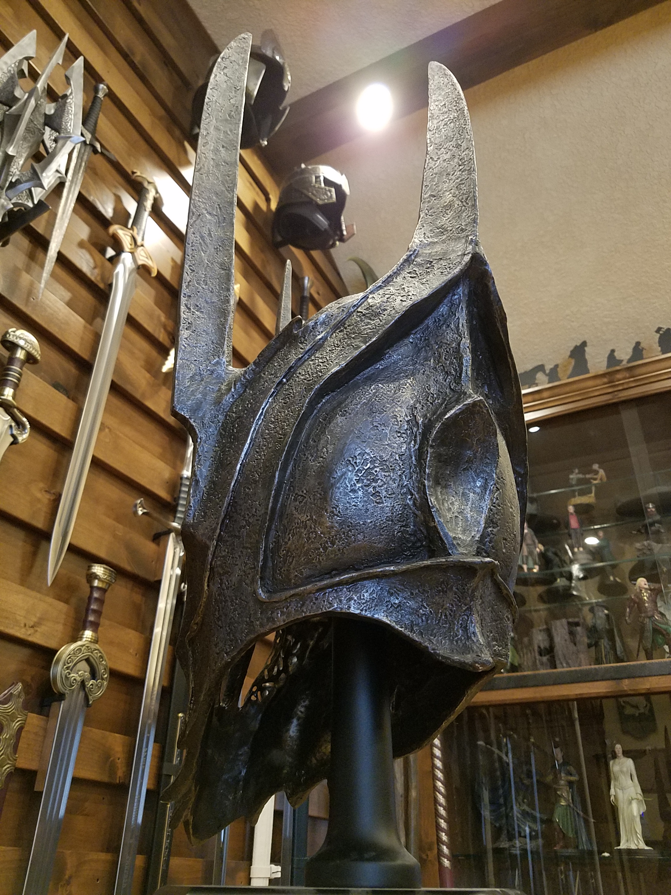

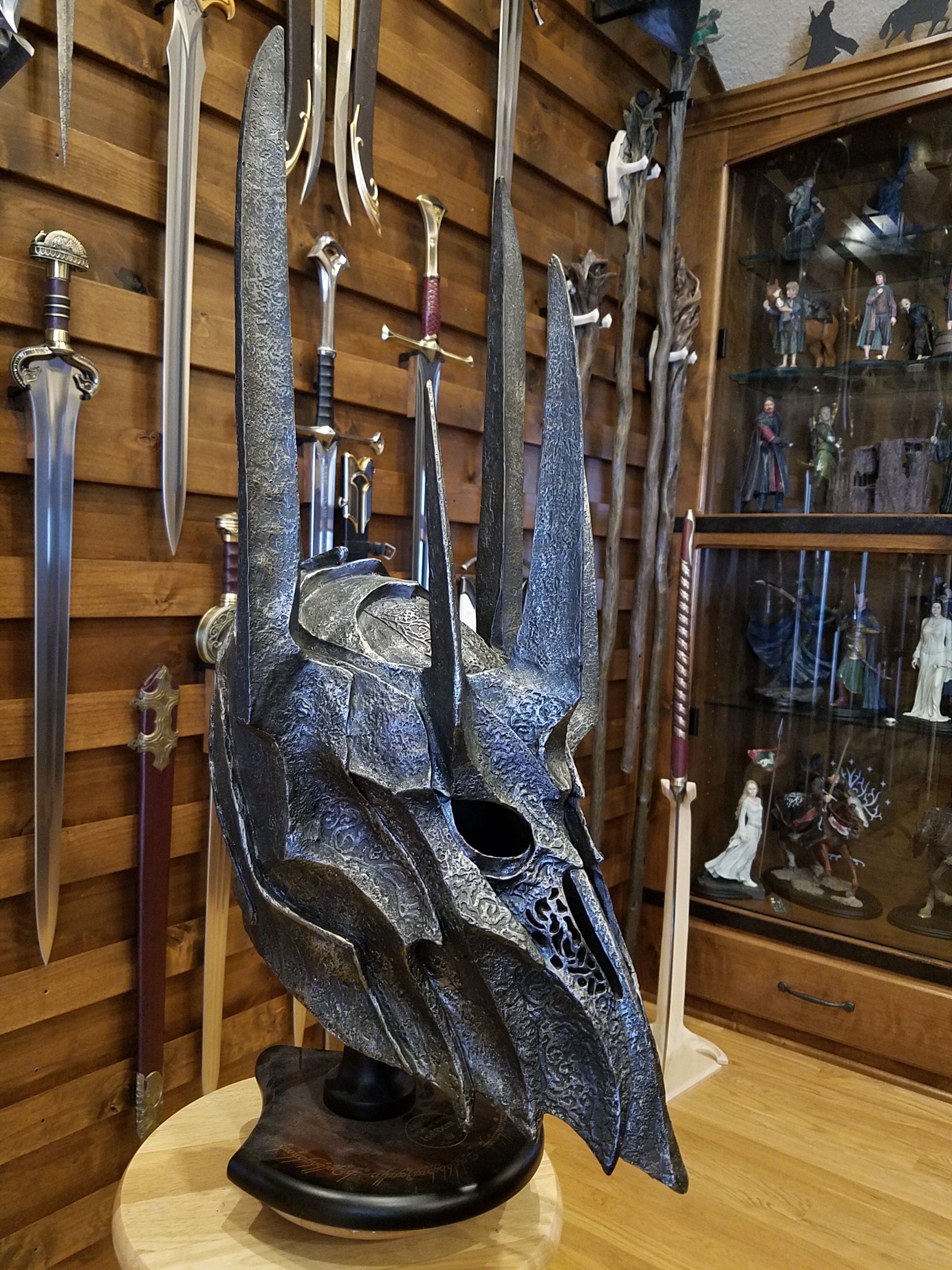

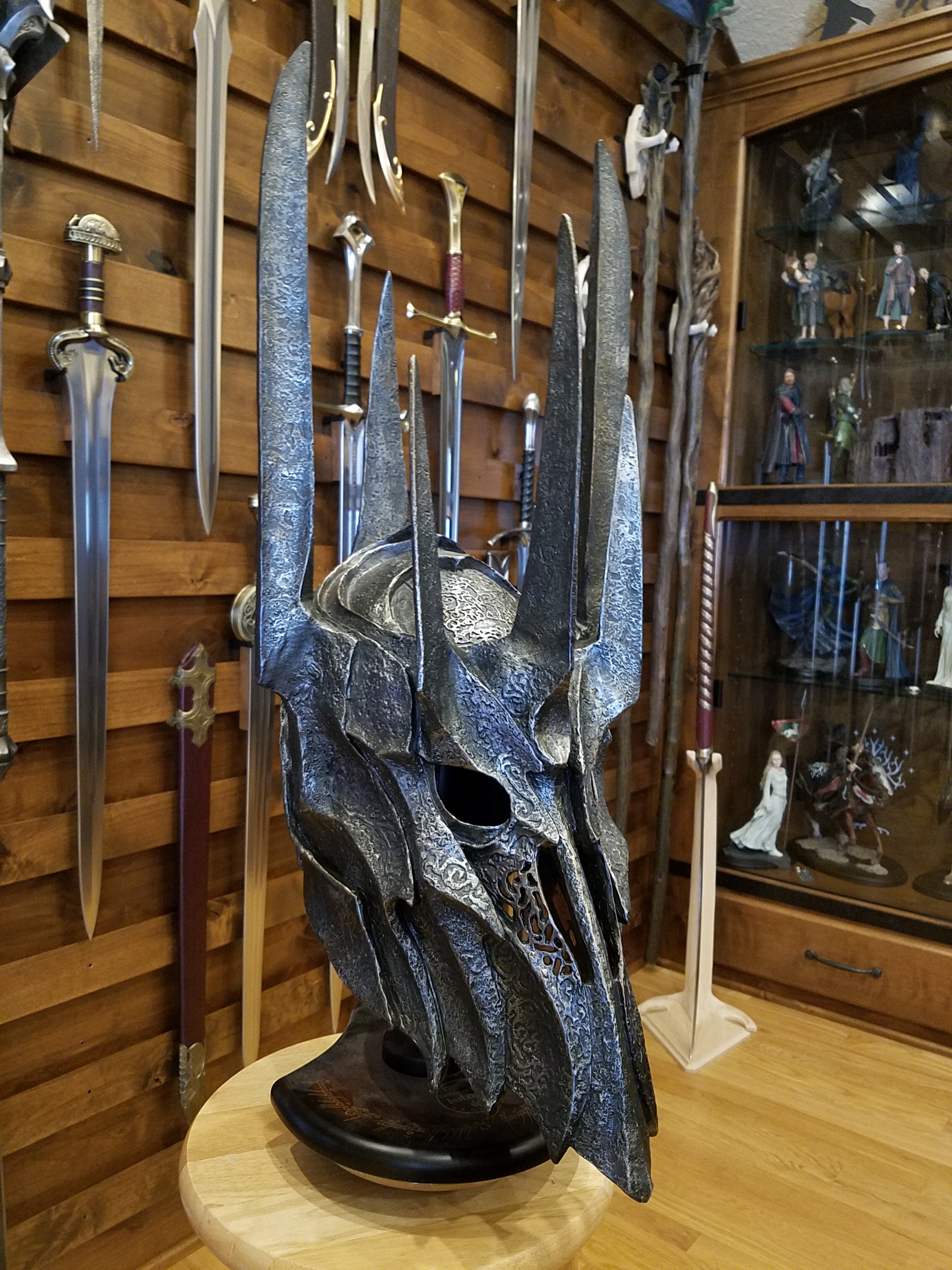

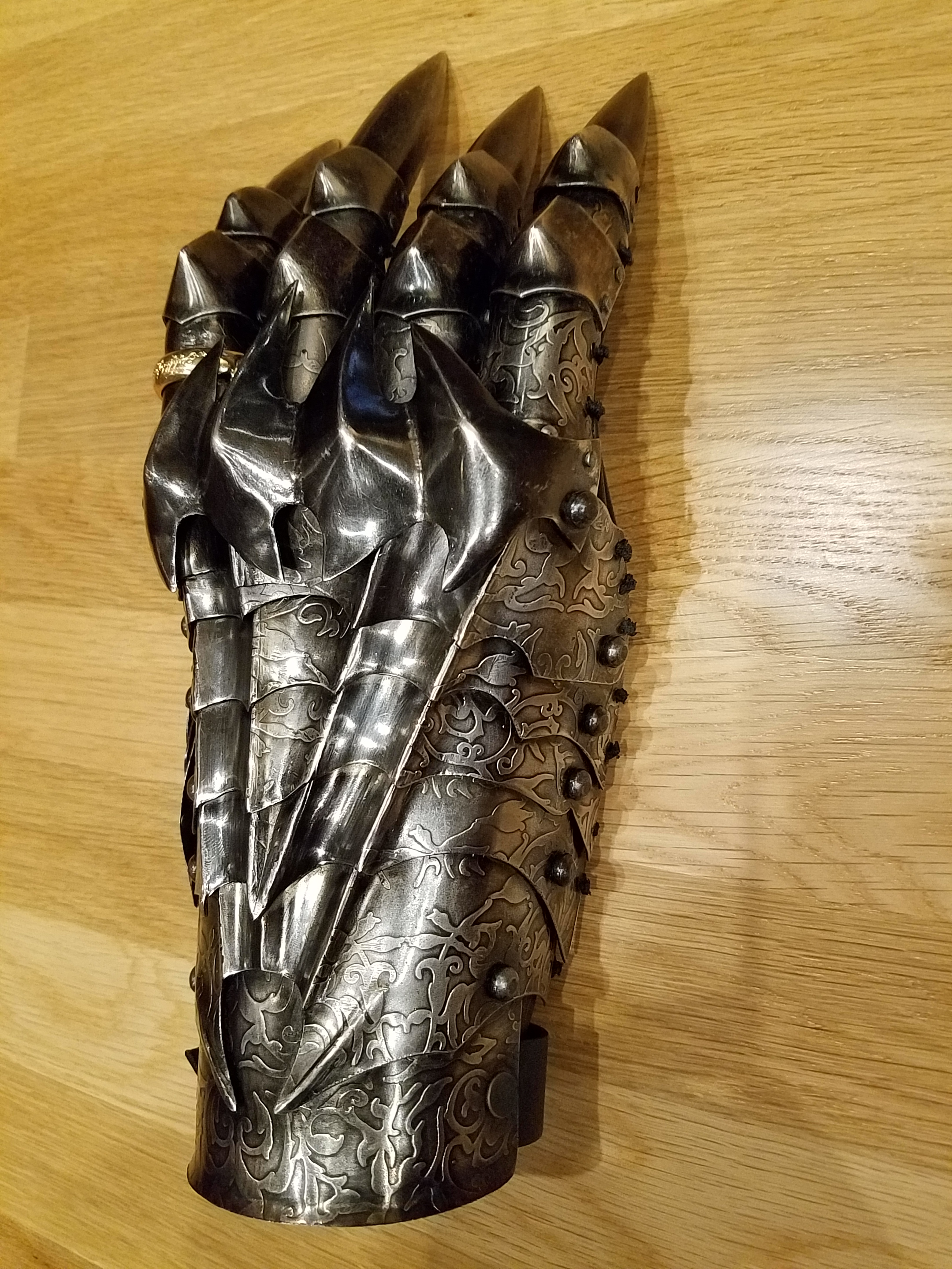

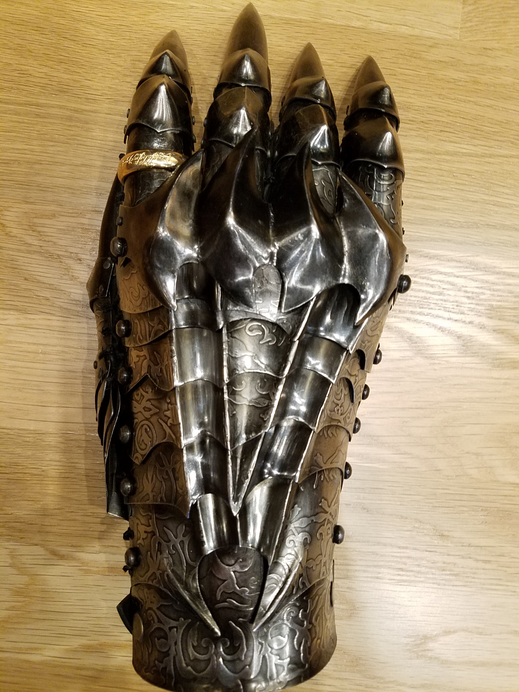

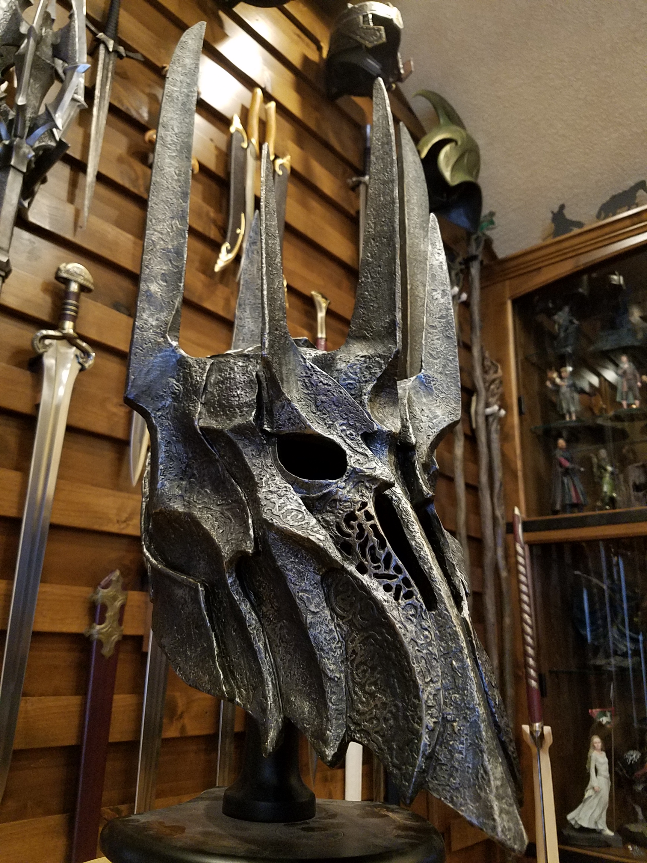

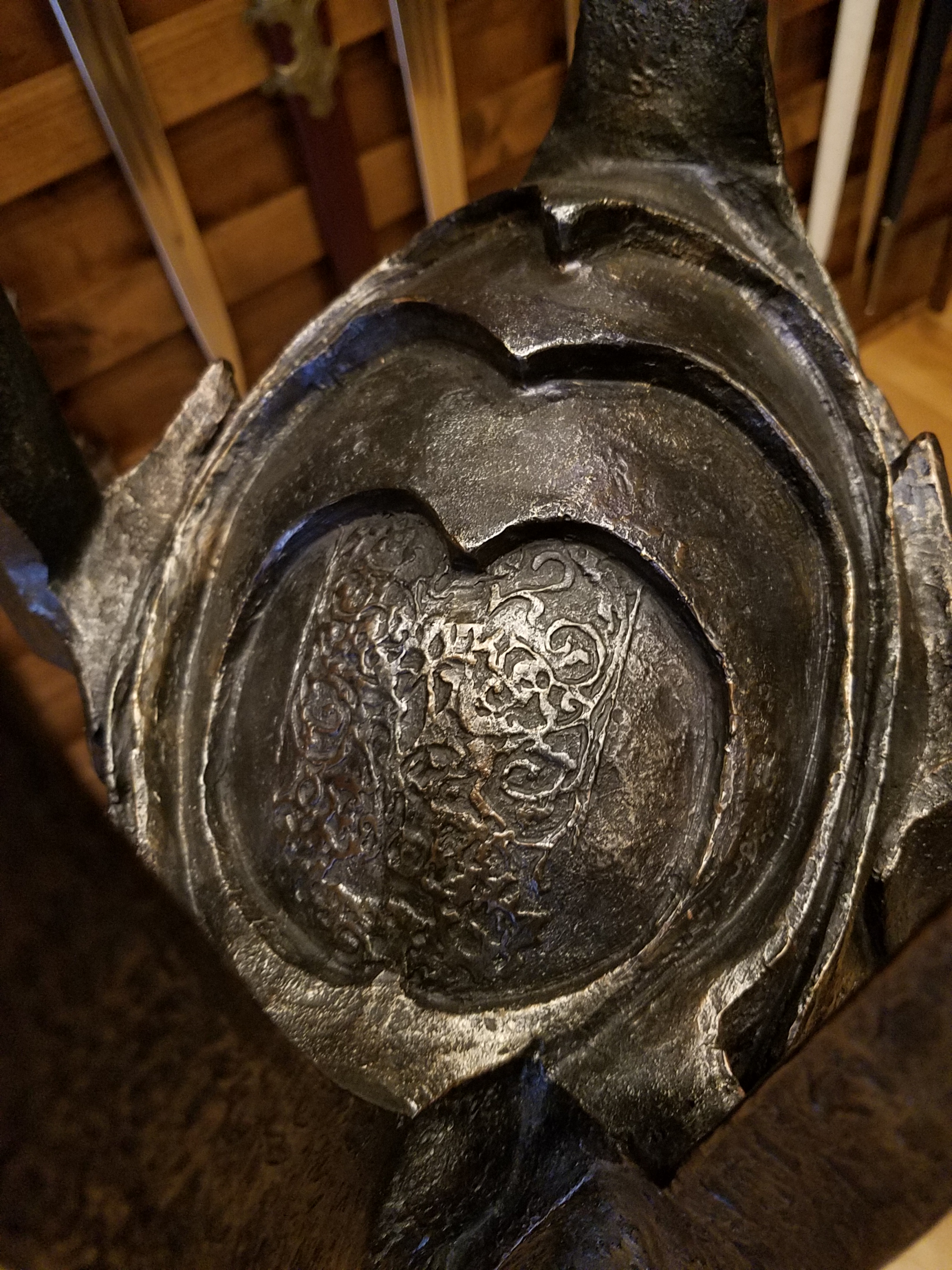

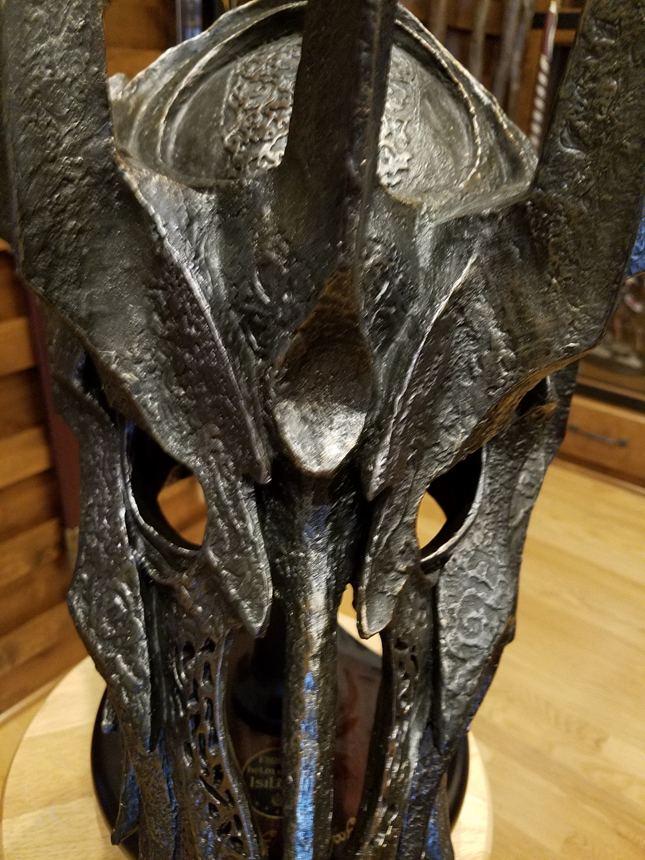

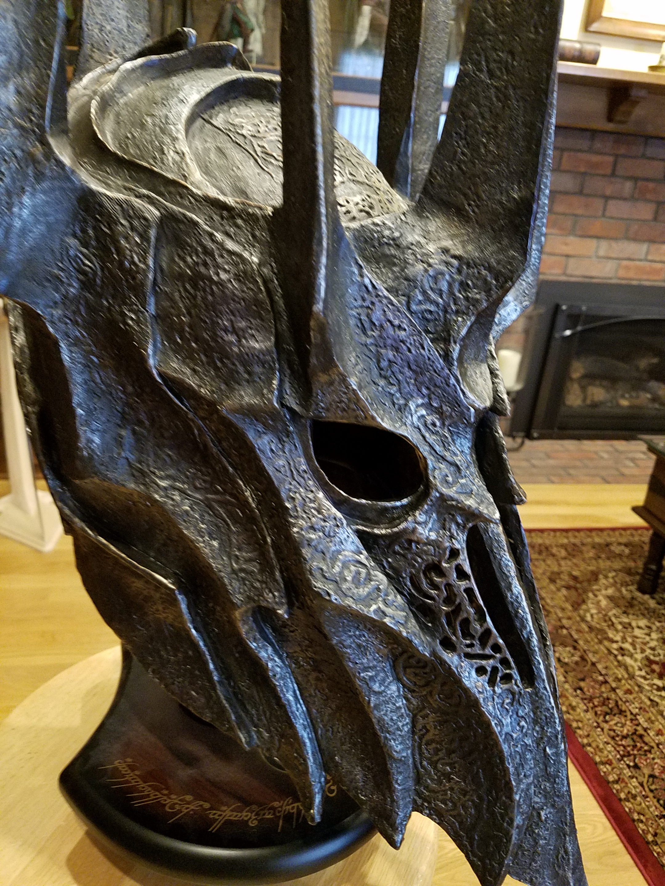

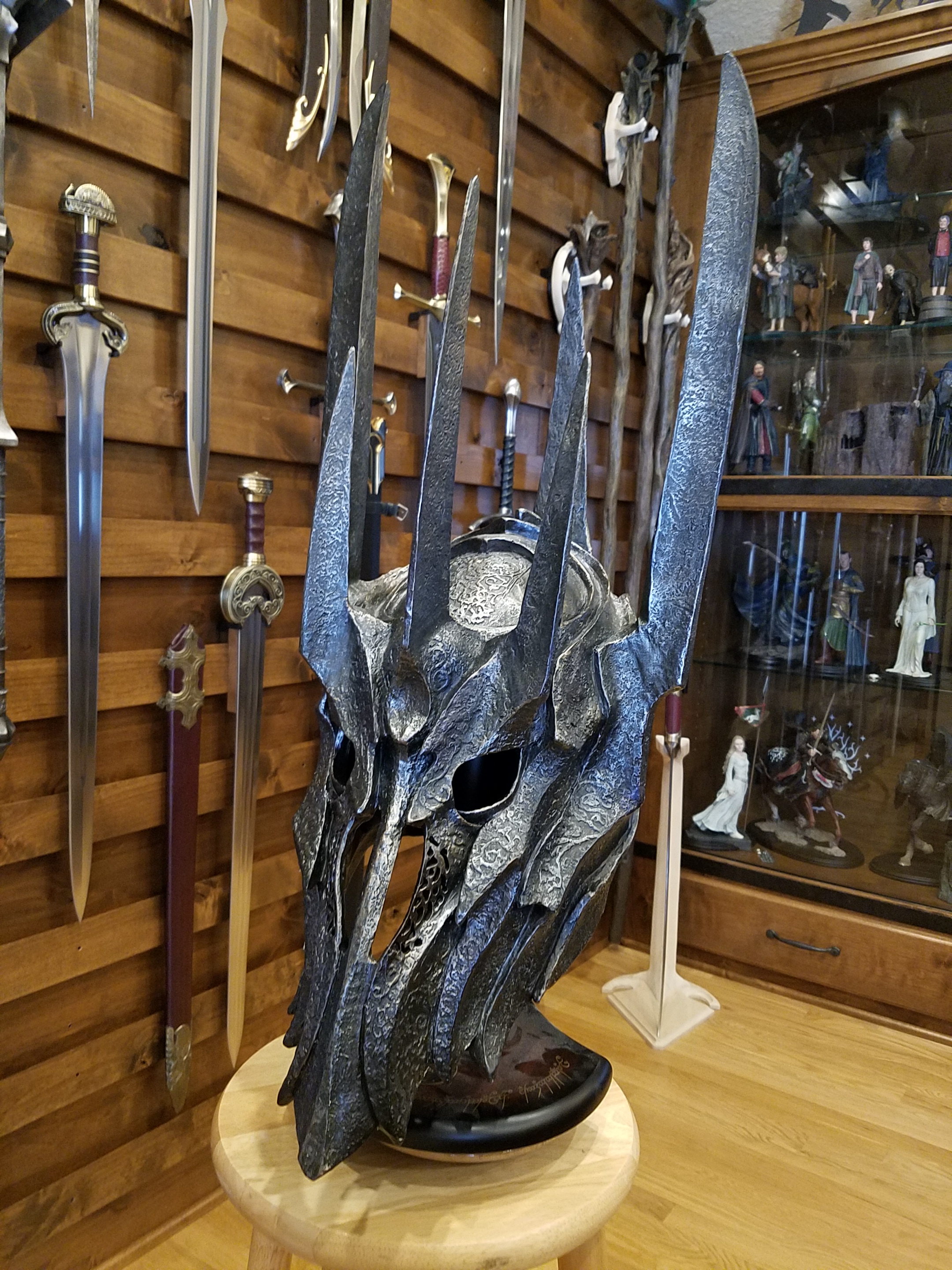

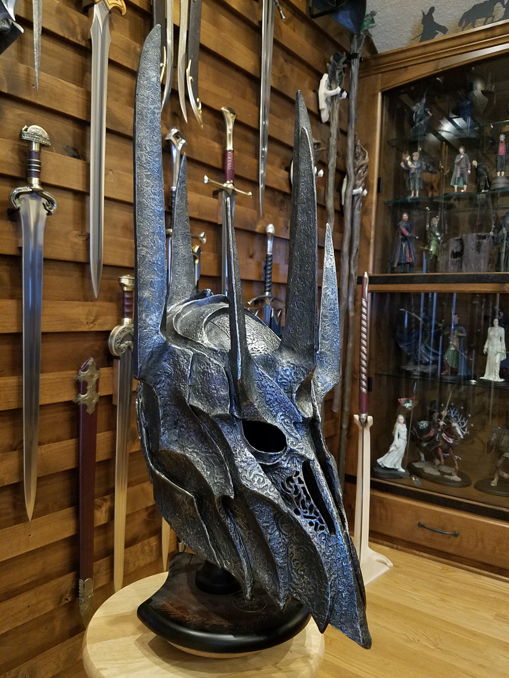

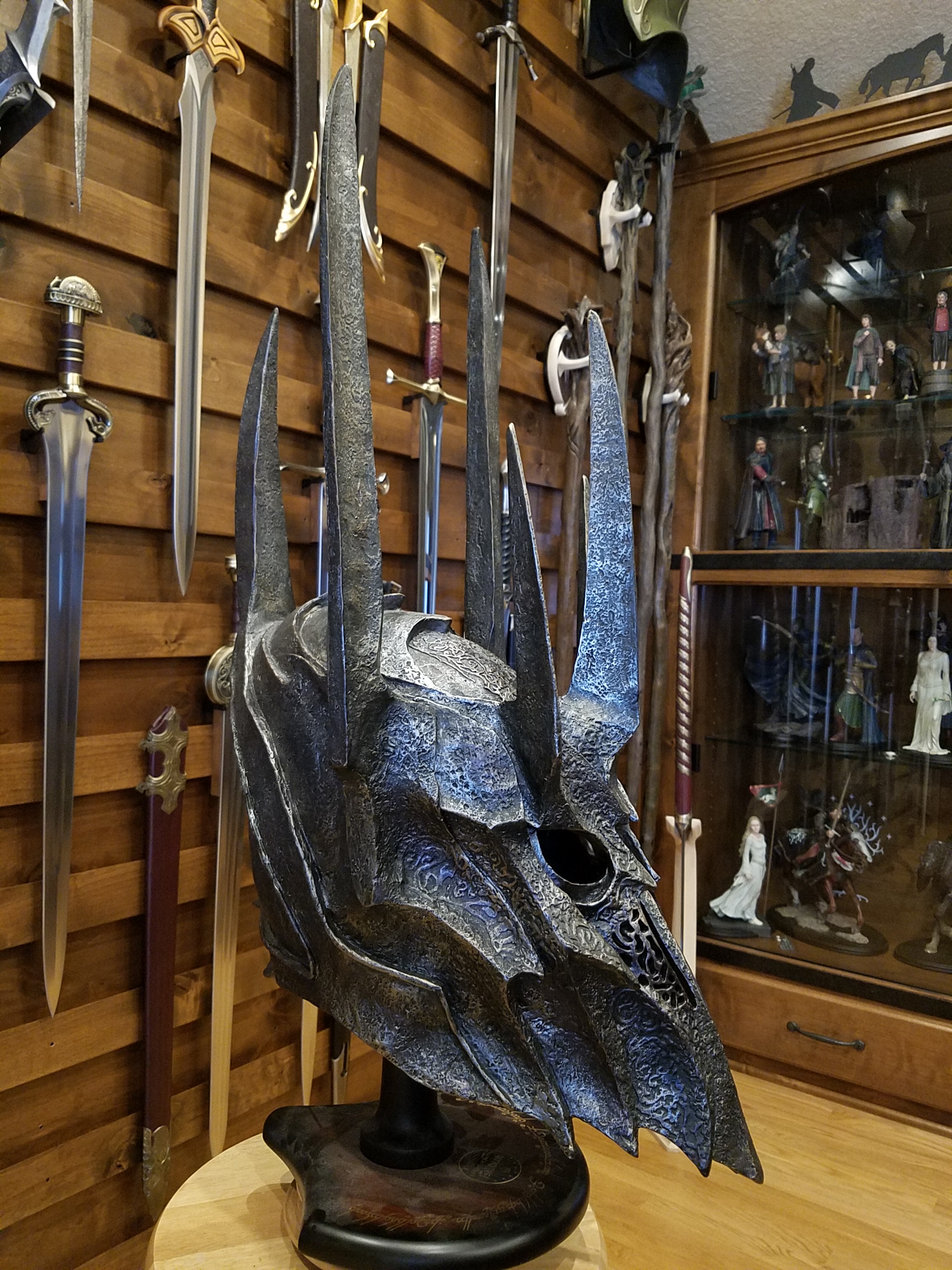

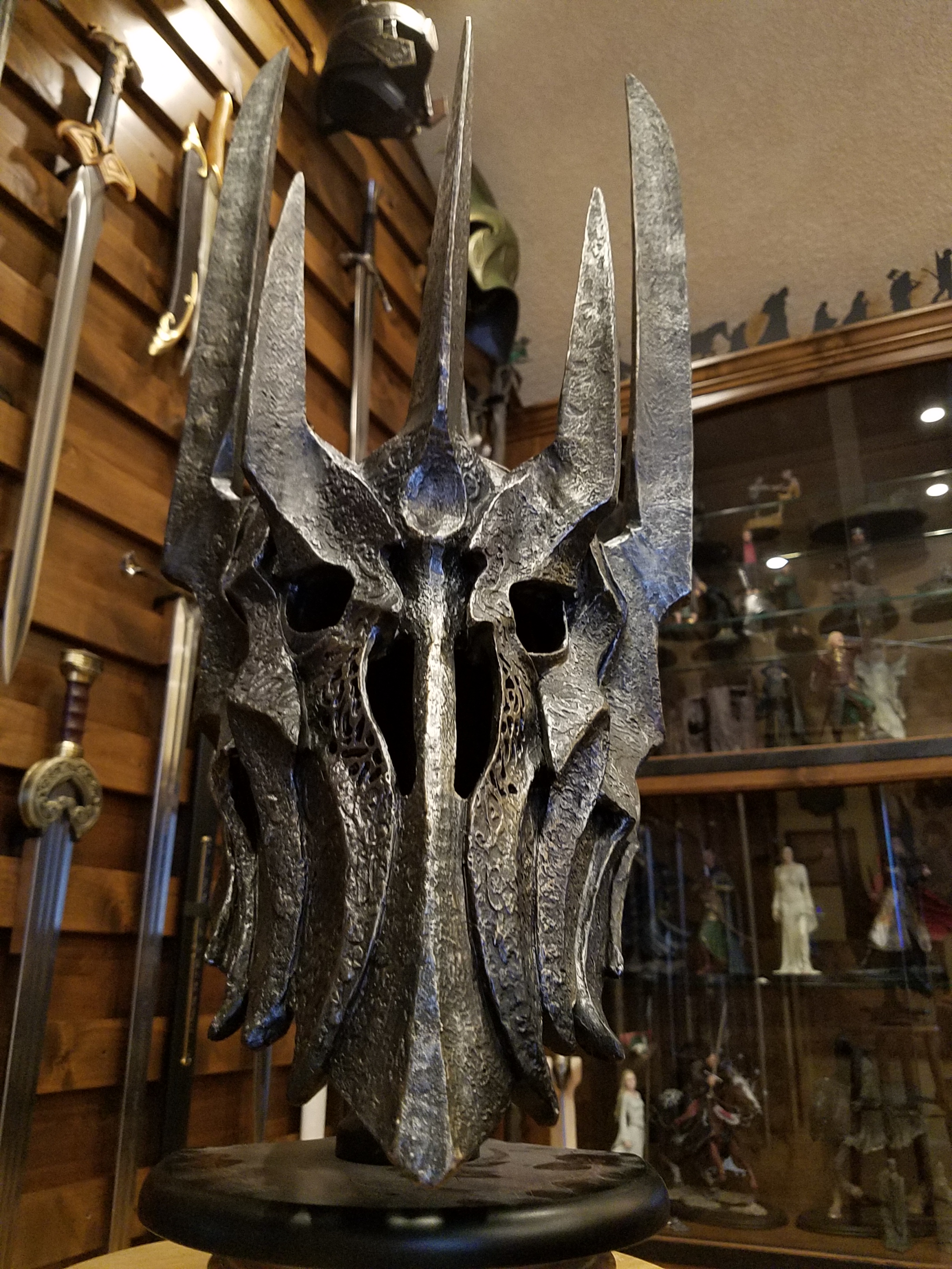

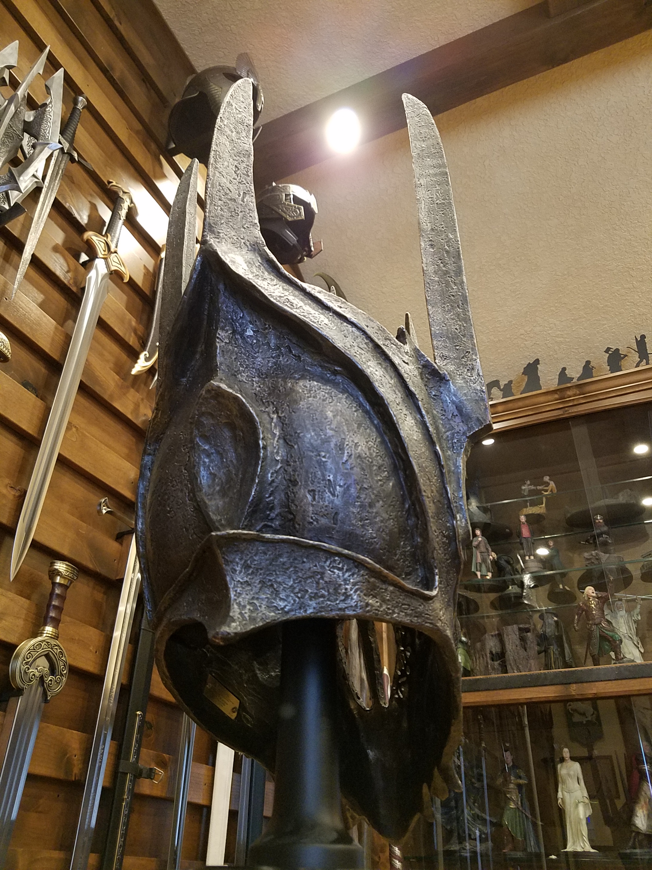

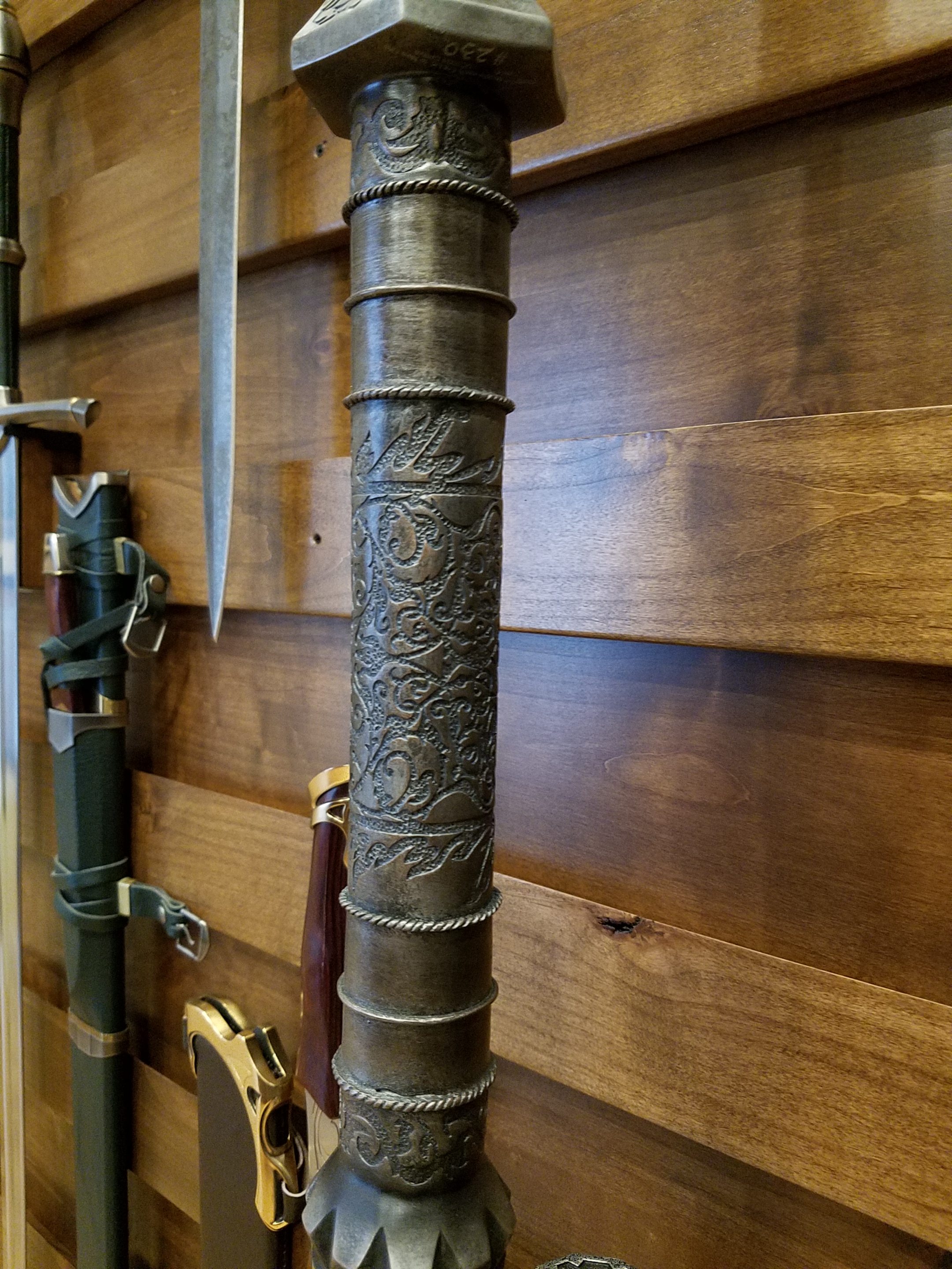

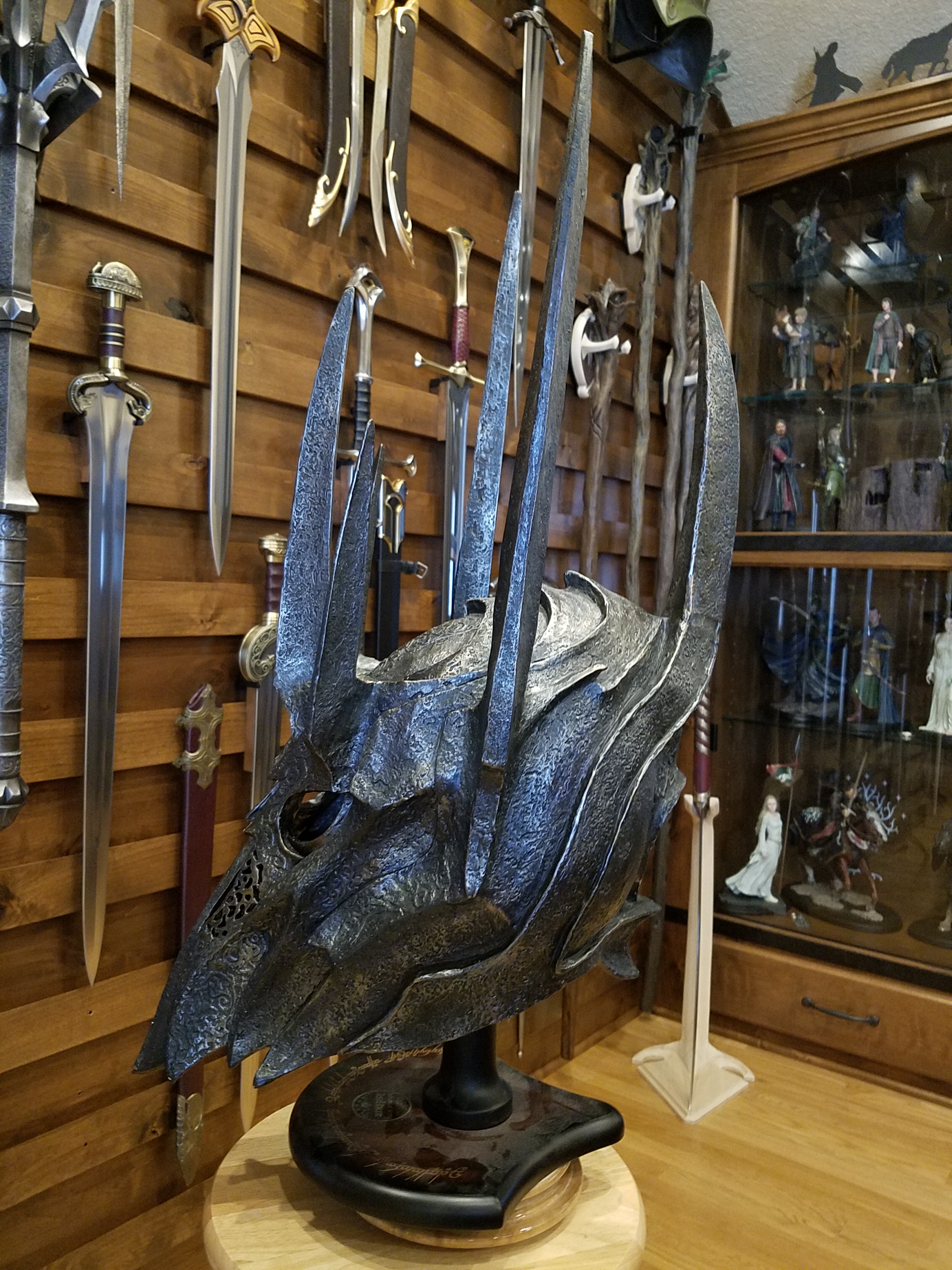

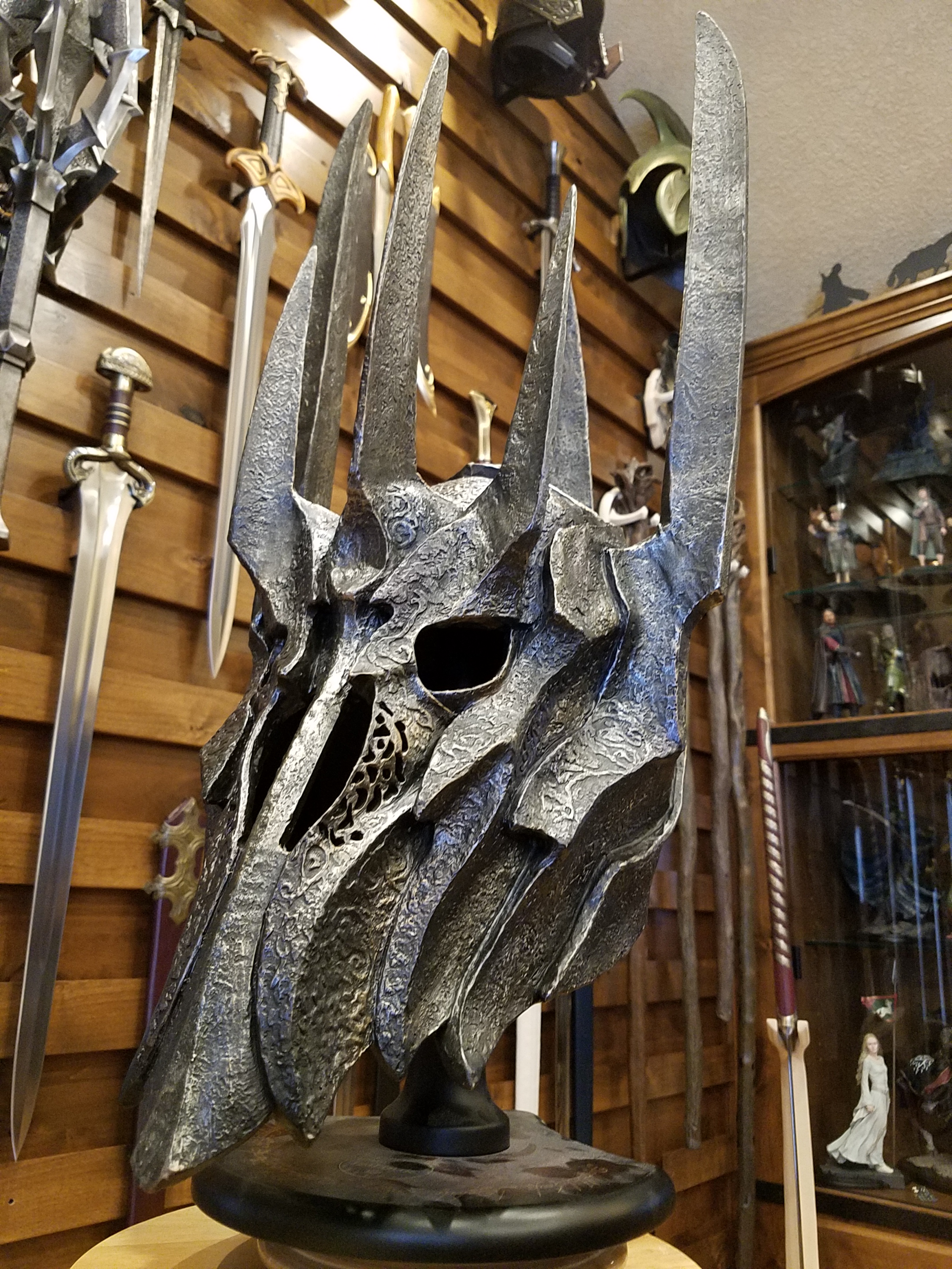

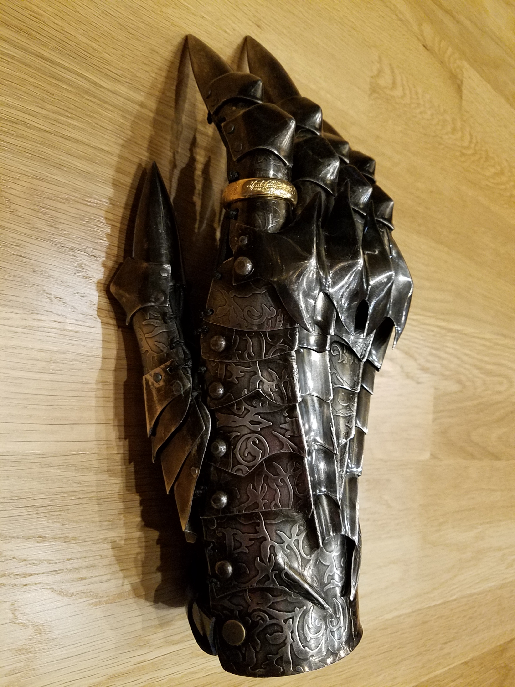

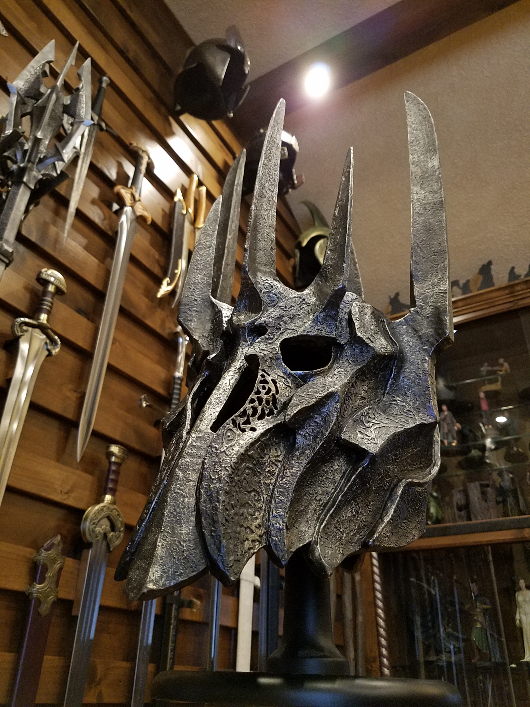

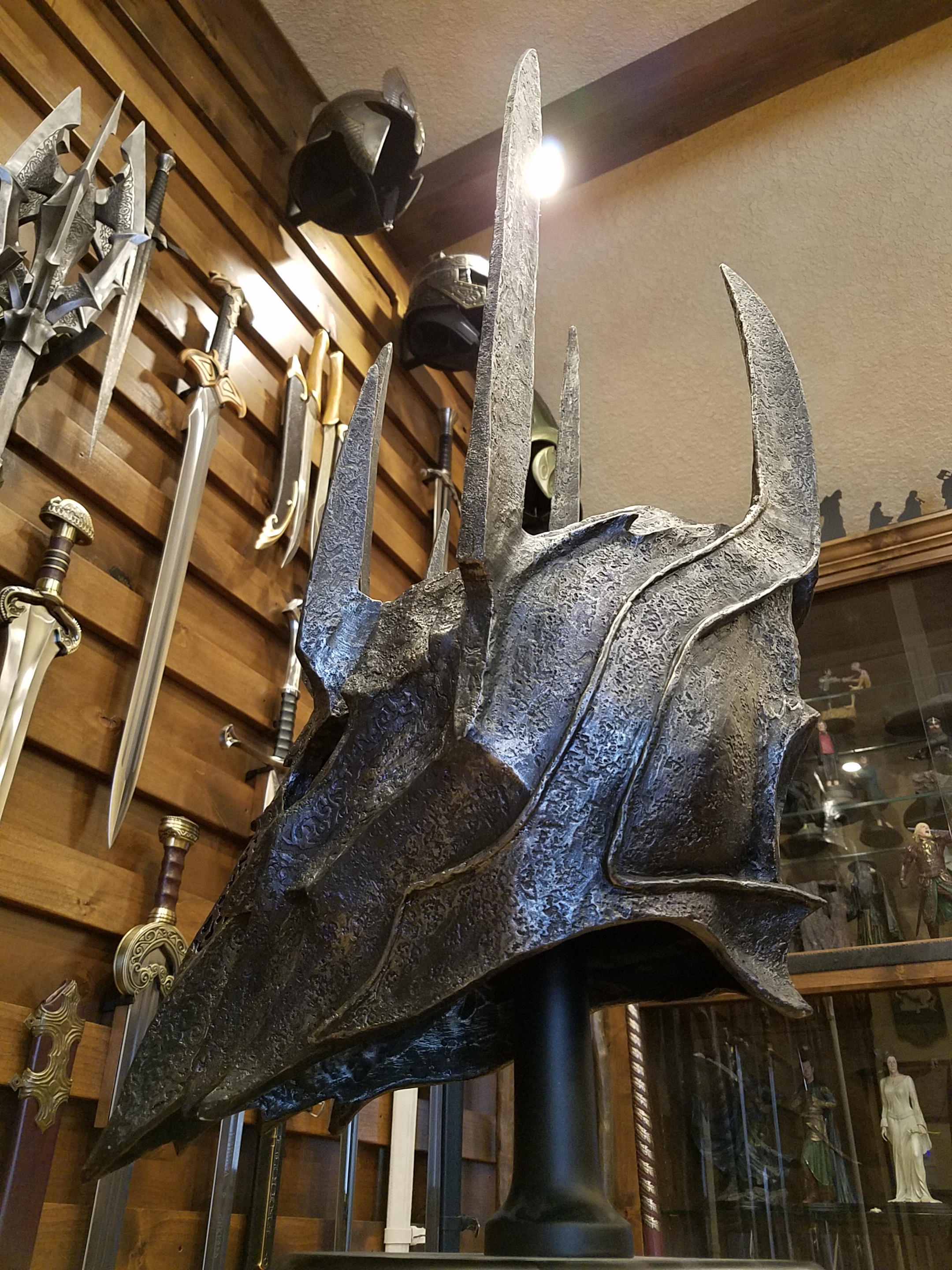

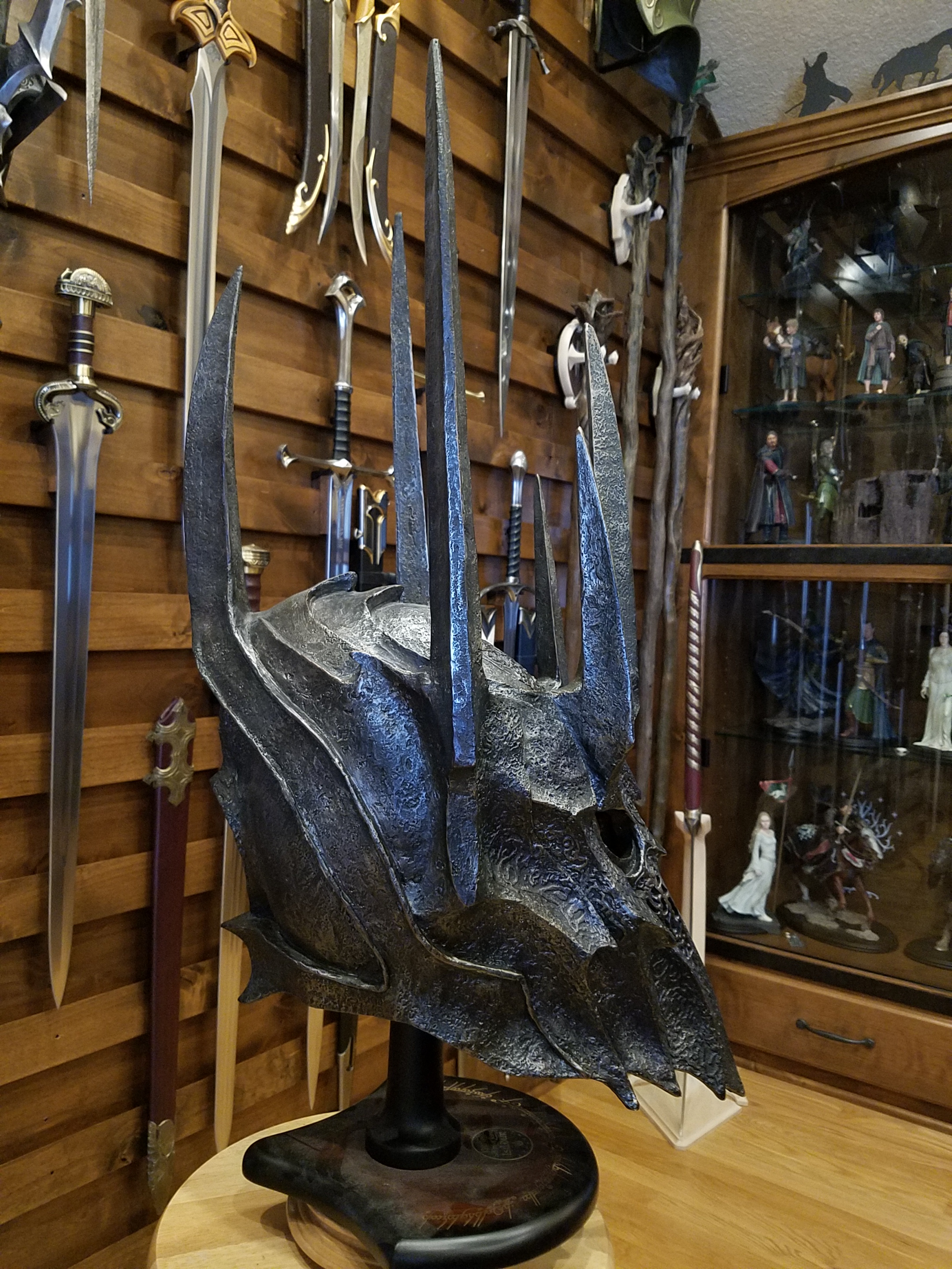

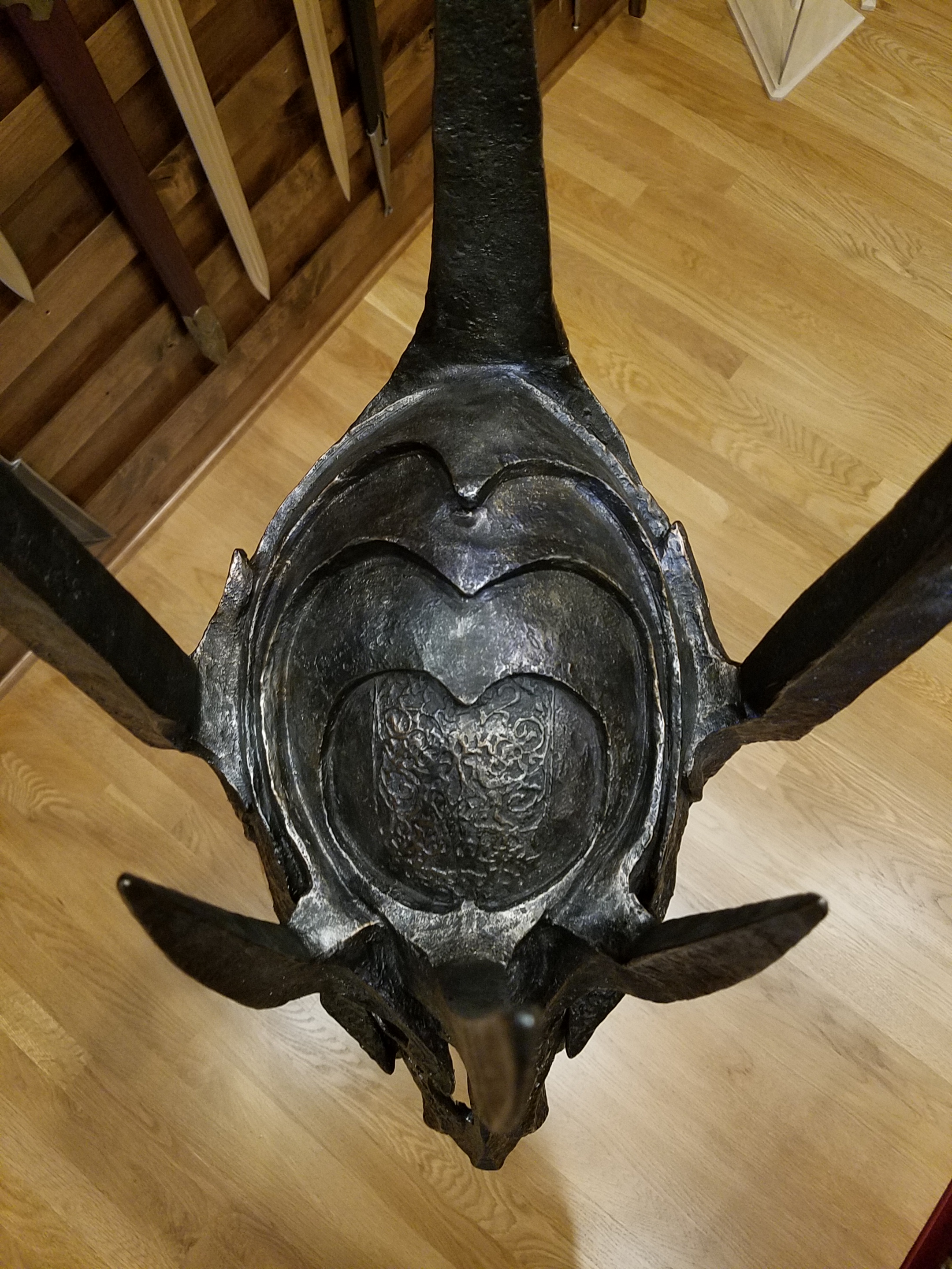

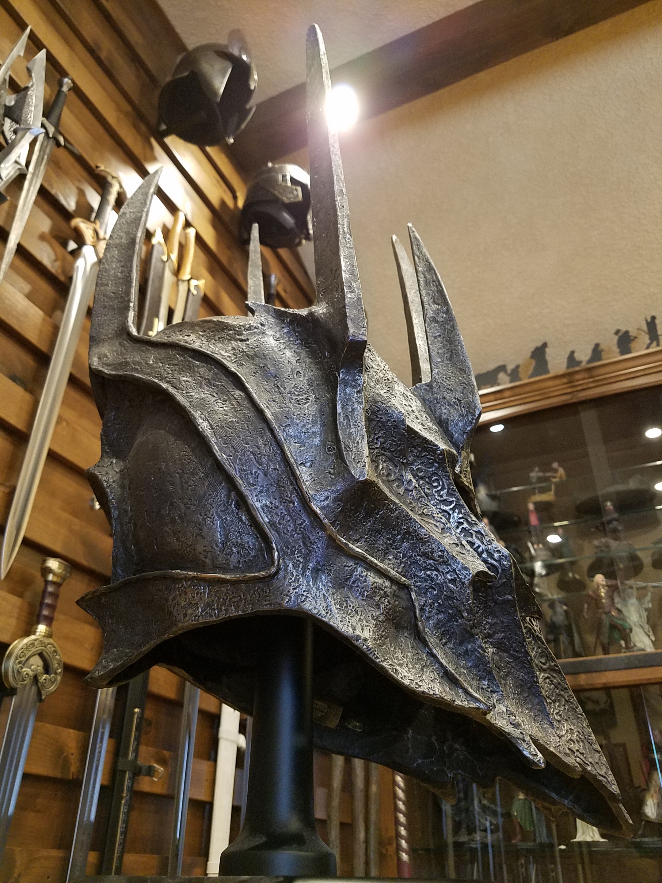

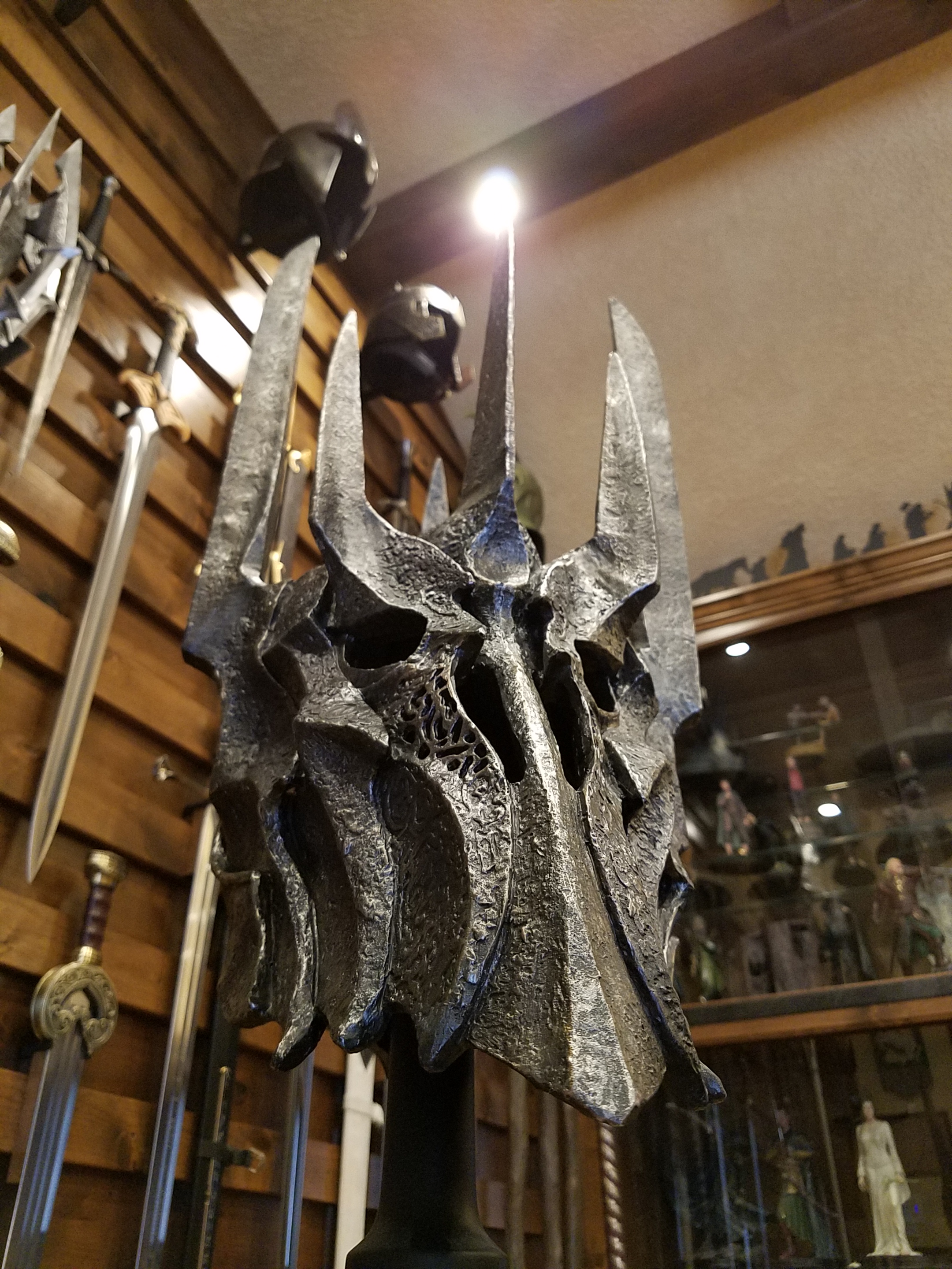

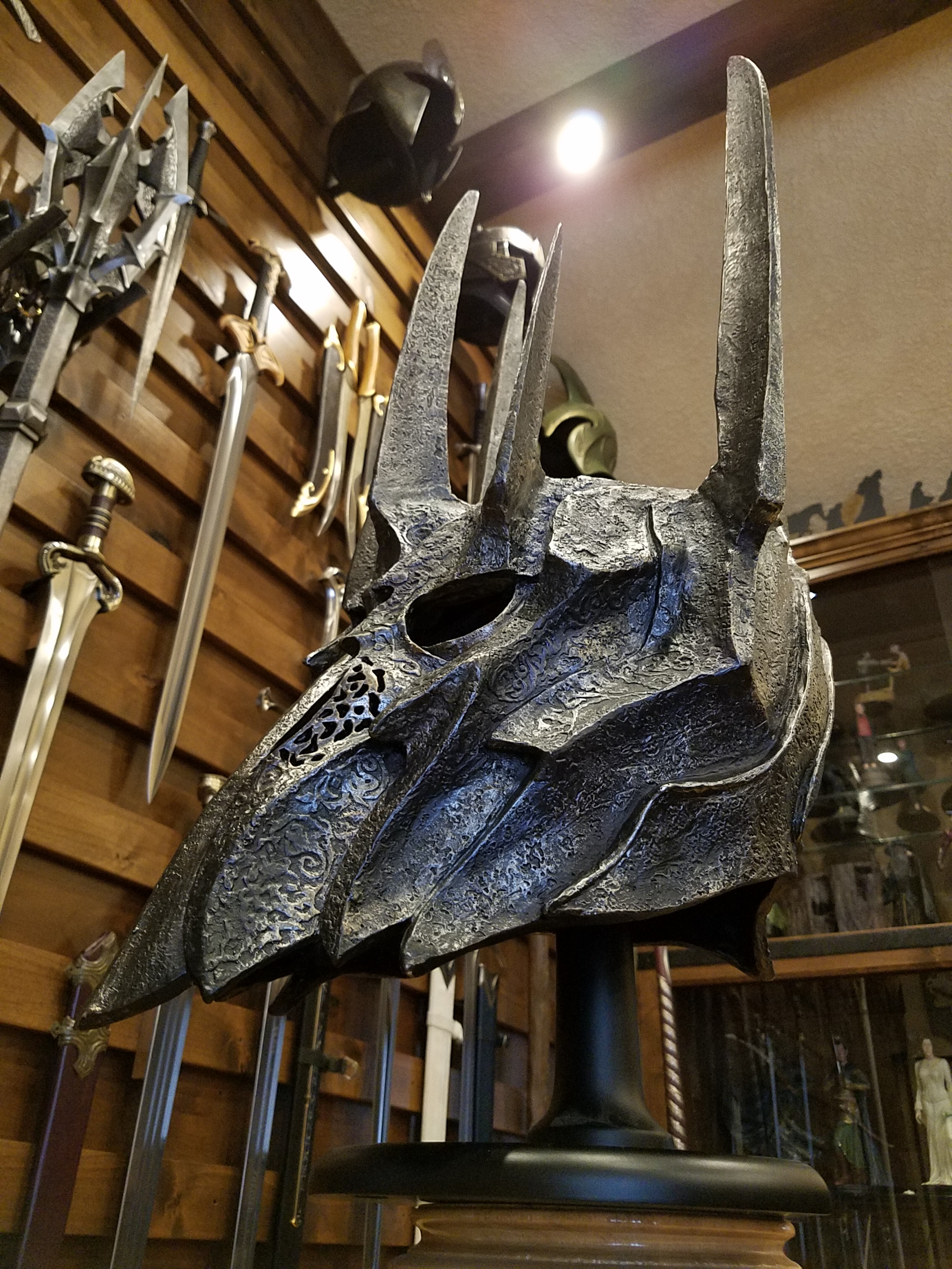

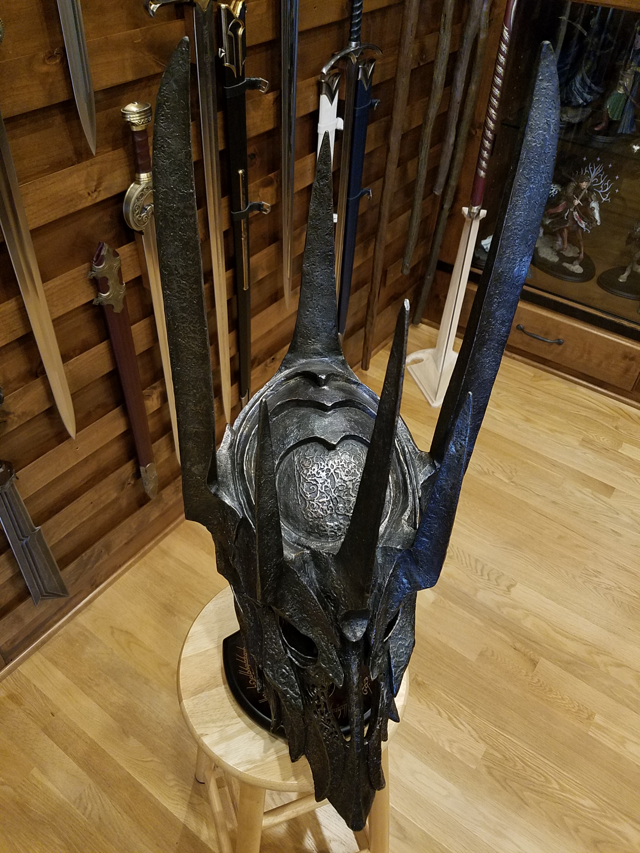

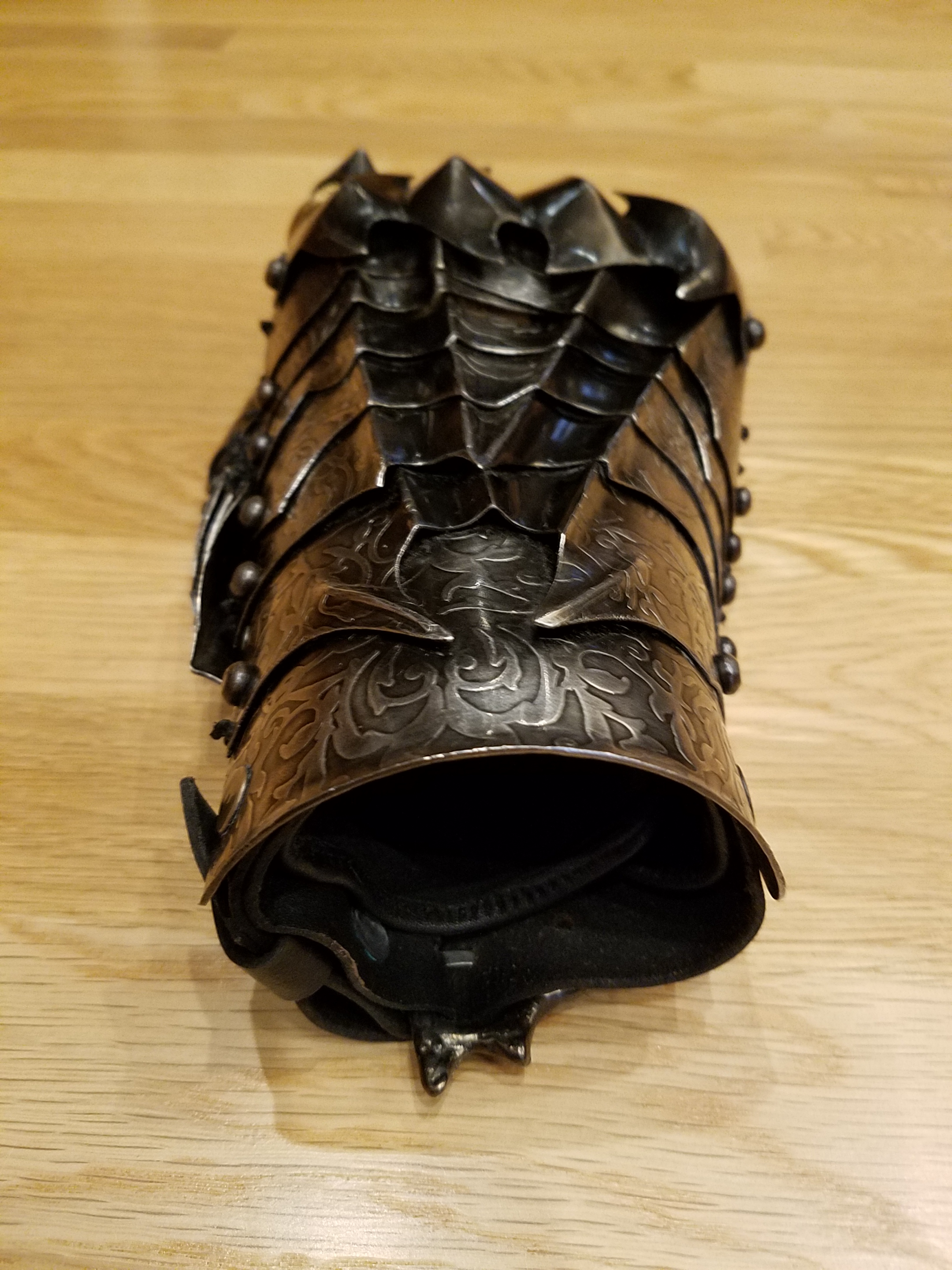

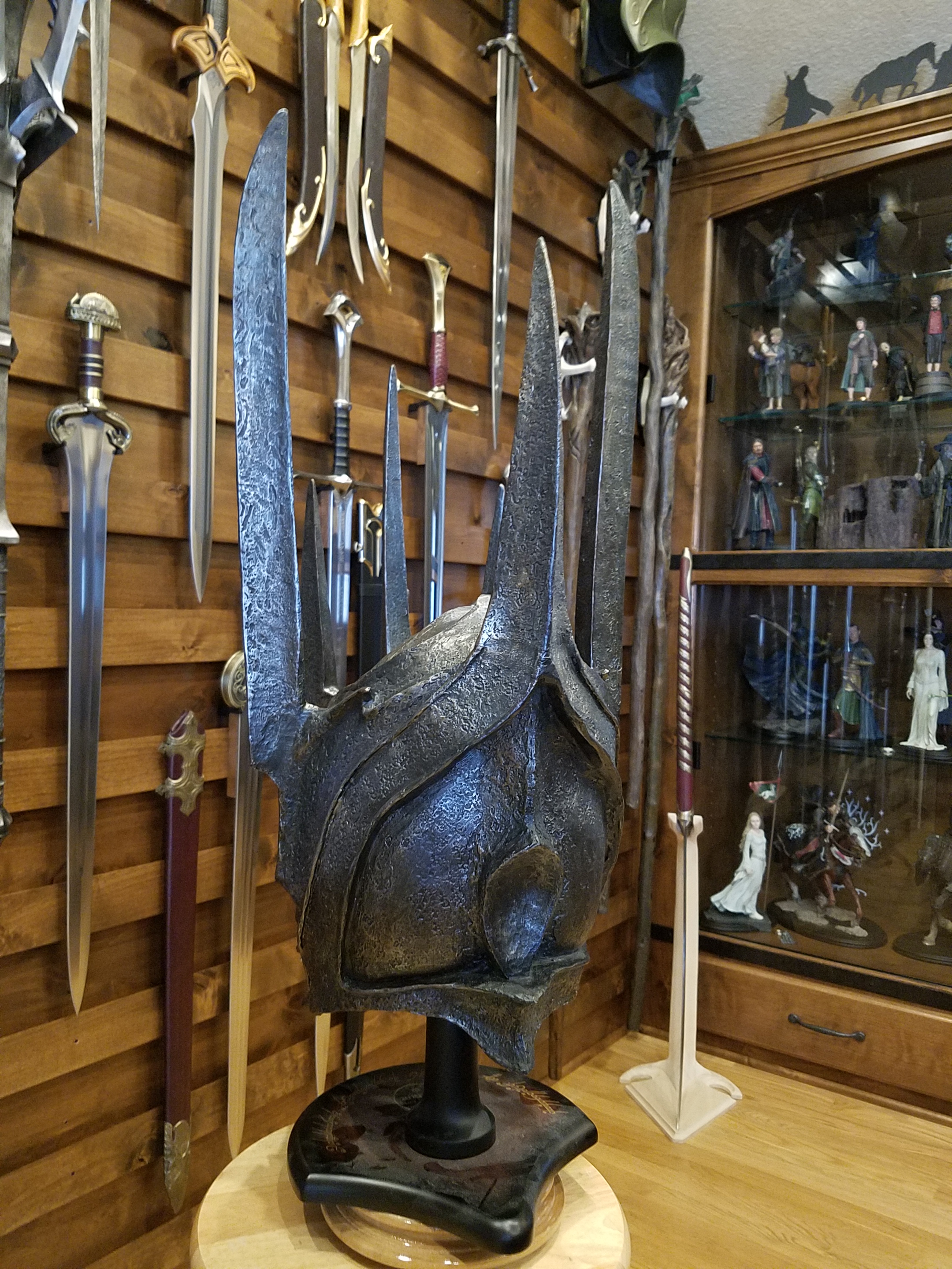

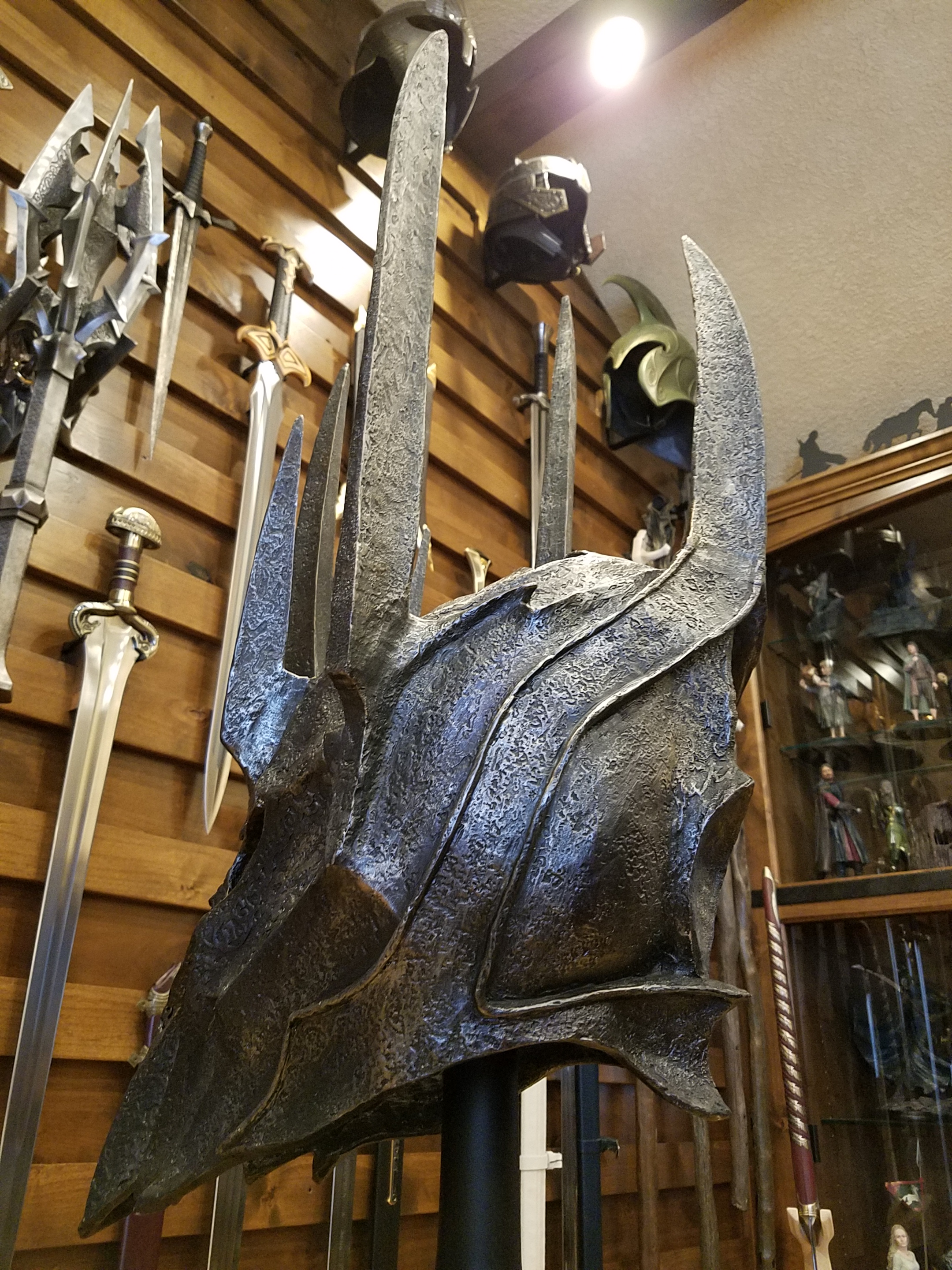

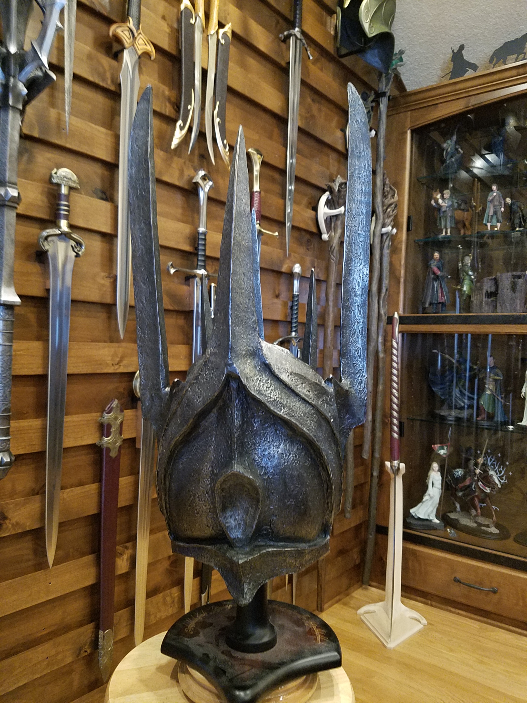

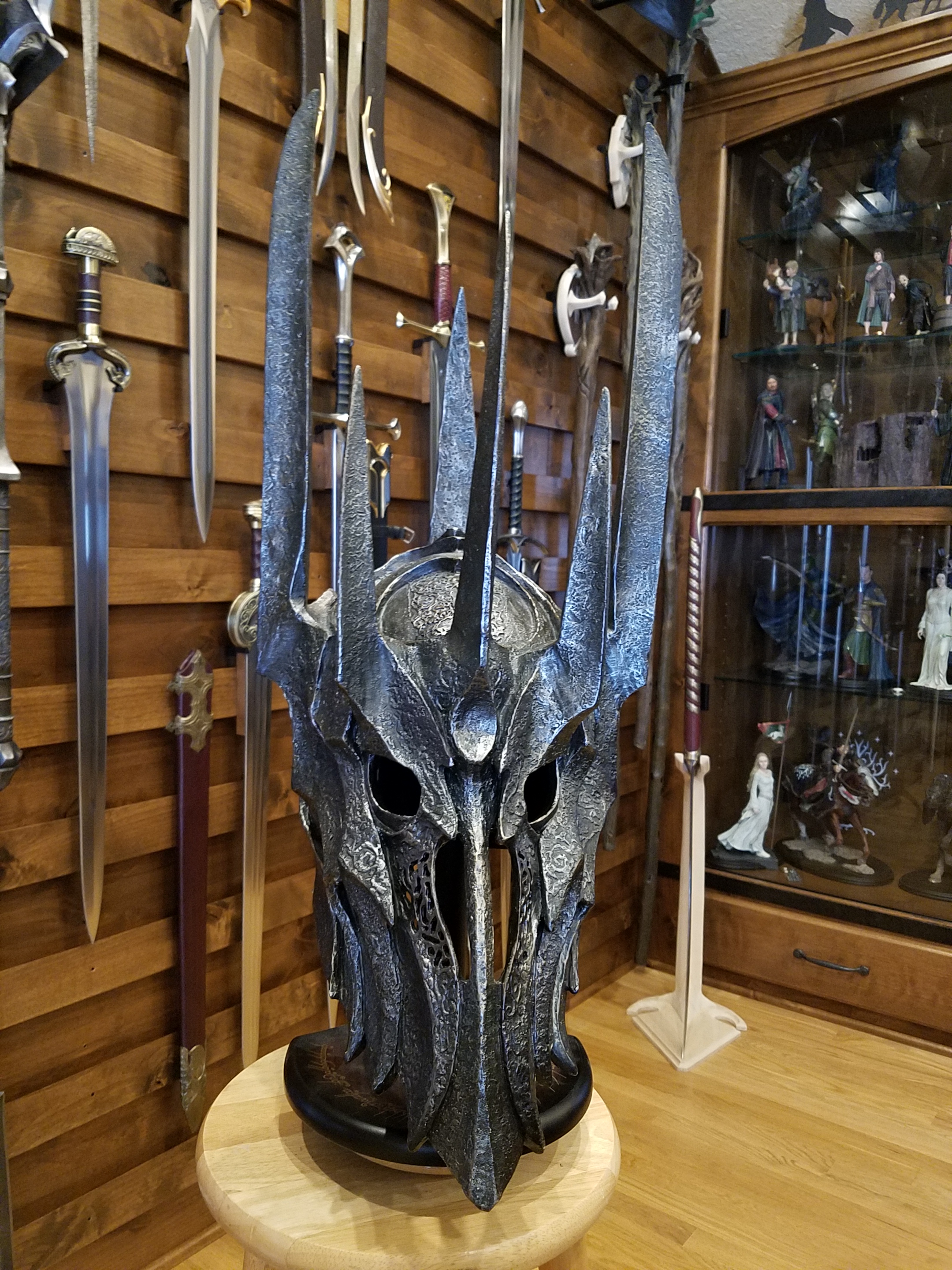

Yes they are, I have all 3 UC Sauron pieces (Helm, Mace, and gauntlet) if you need any additional pictures or measurements.

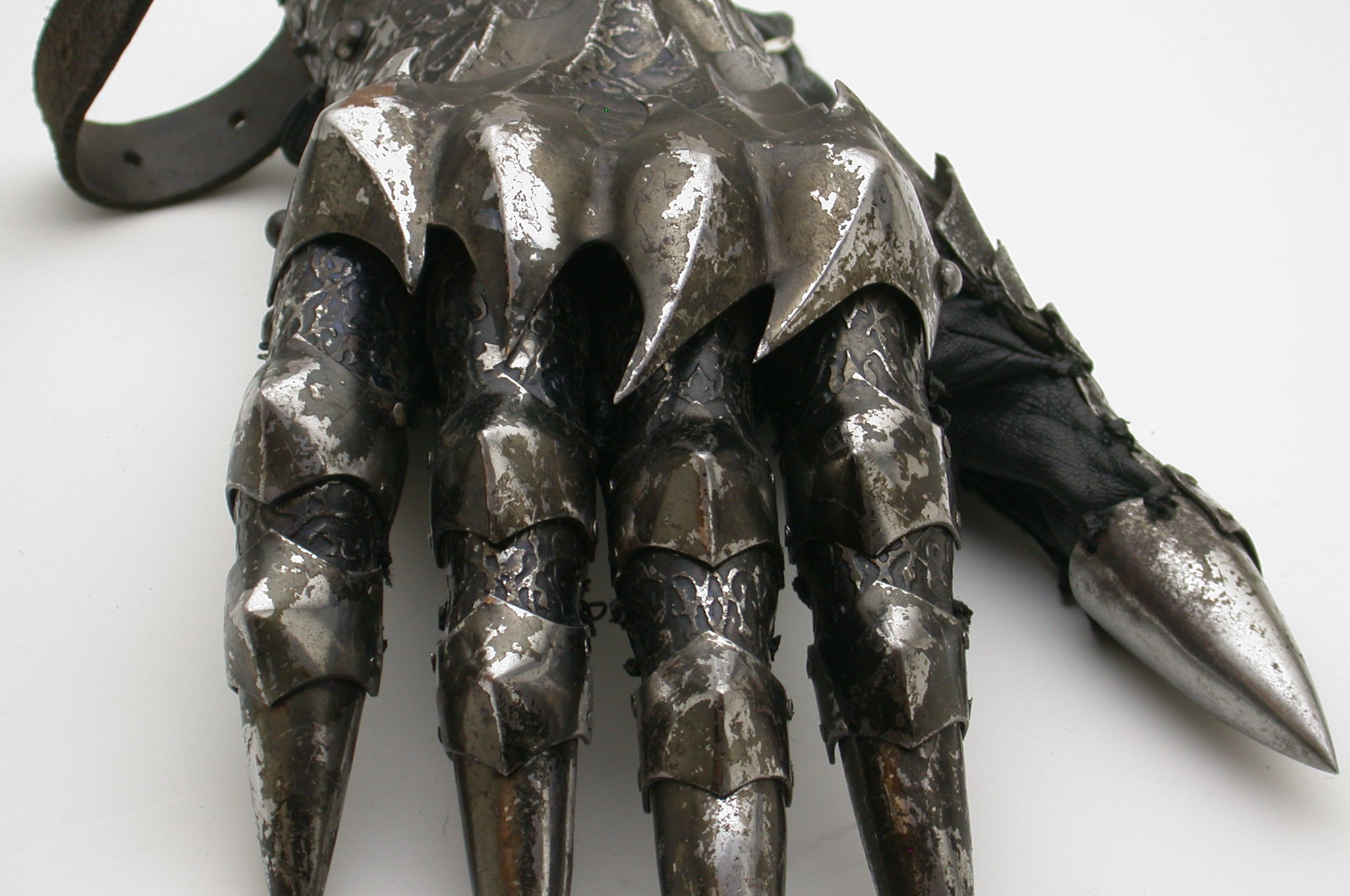

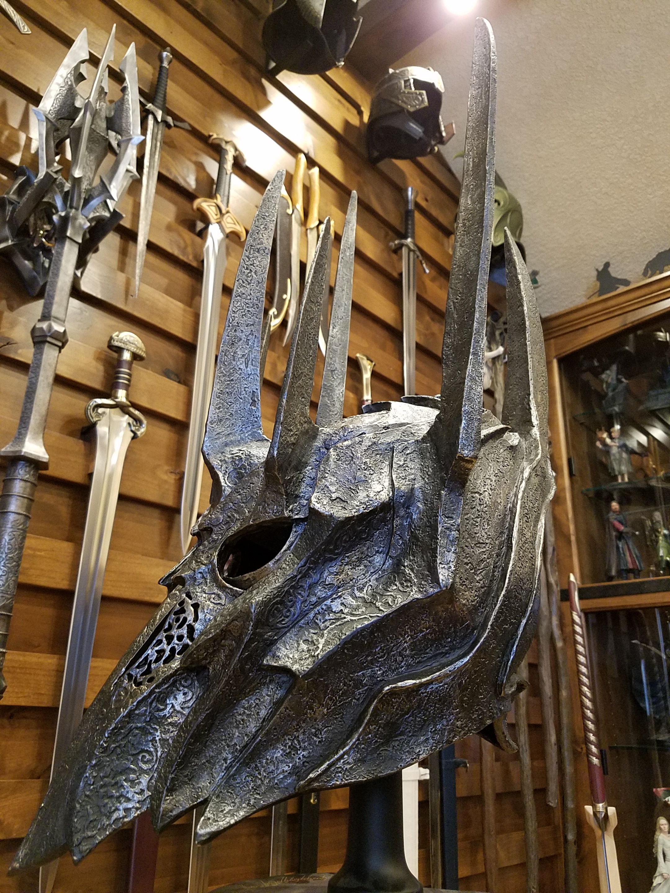

I will definitely take you up on that. What i would really need is the several shots from different angles of the decorations (the more straight the better) so then i can stitch those together and build that. Secondly would be to a shot of the gauntlet straight from above (to get backhand plats right).
If your feeling really brave we could photo-scan the helmet properly, but that's a lot more effort. But its a great tool.
Is the software free to do the photo-scan? If so do you have a link? Maybe something I can try when I have some time.

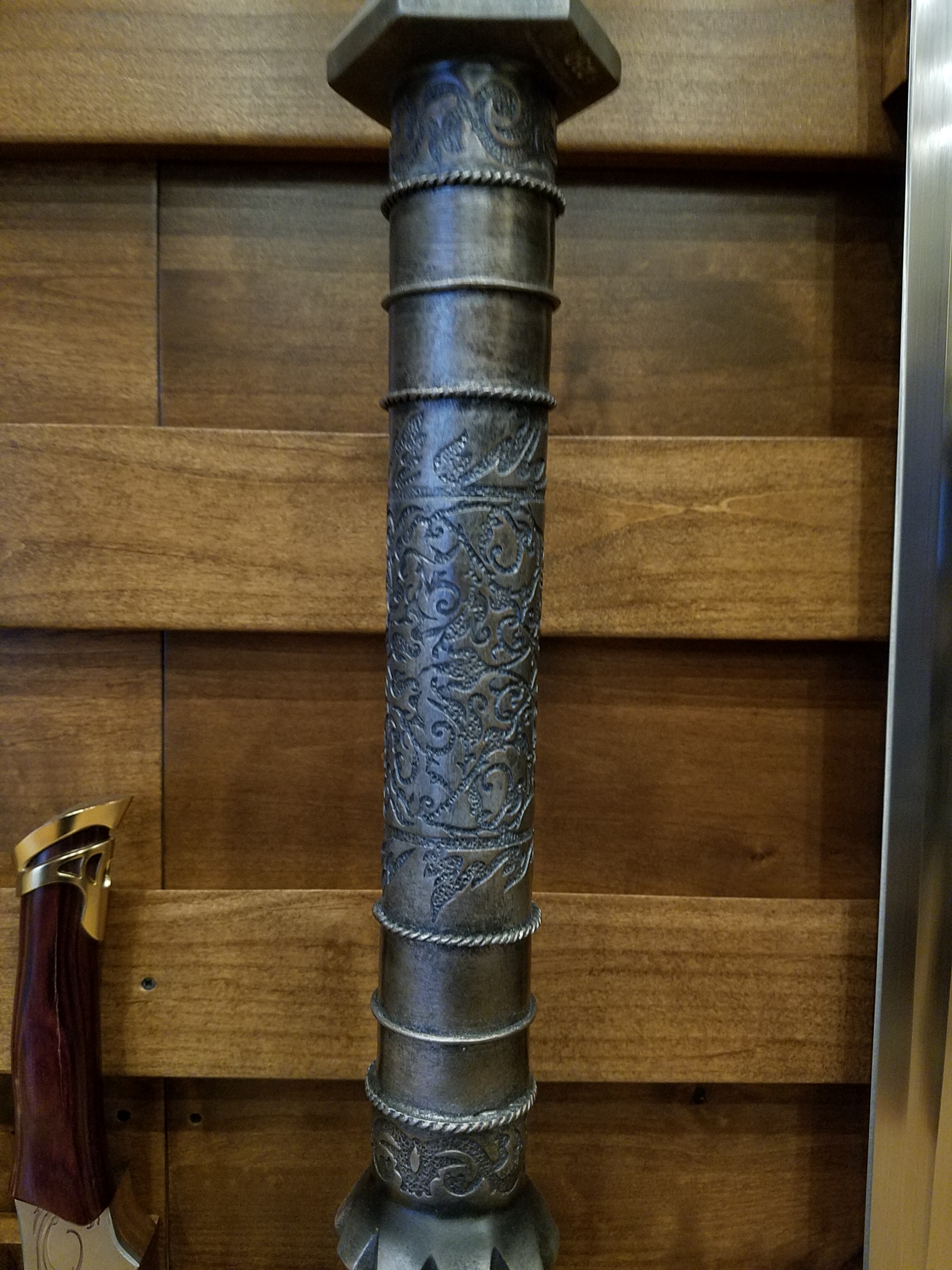

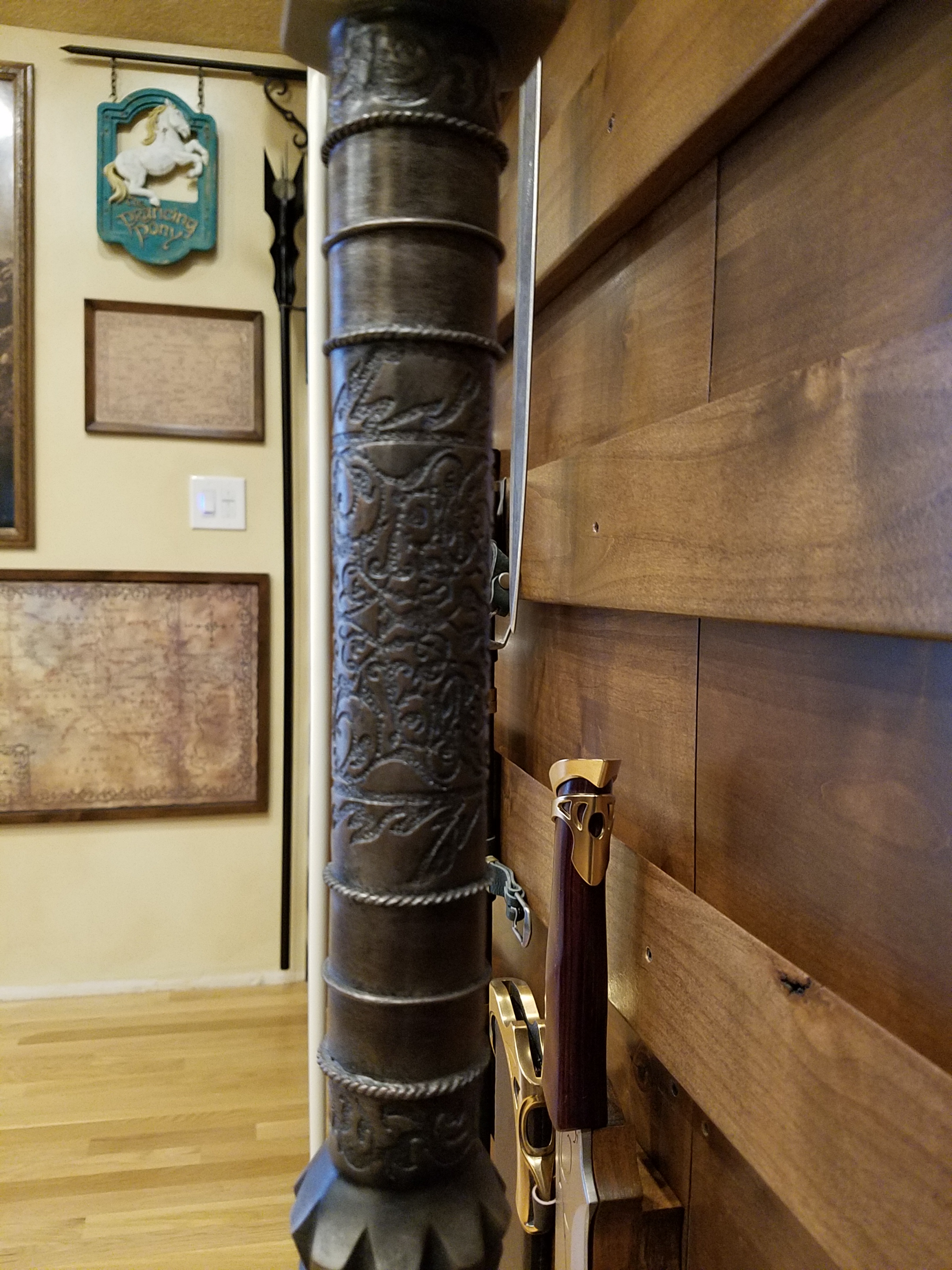

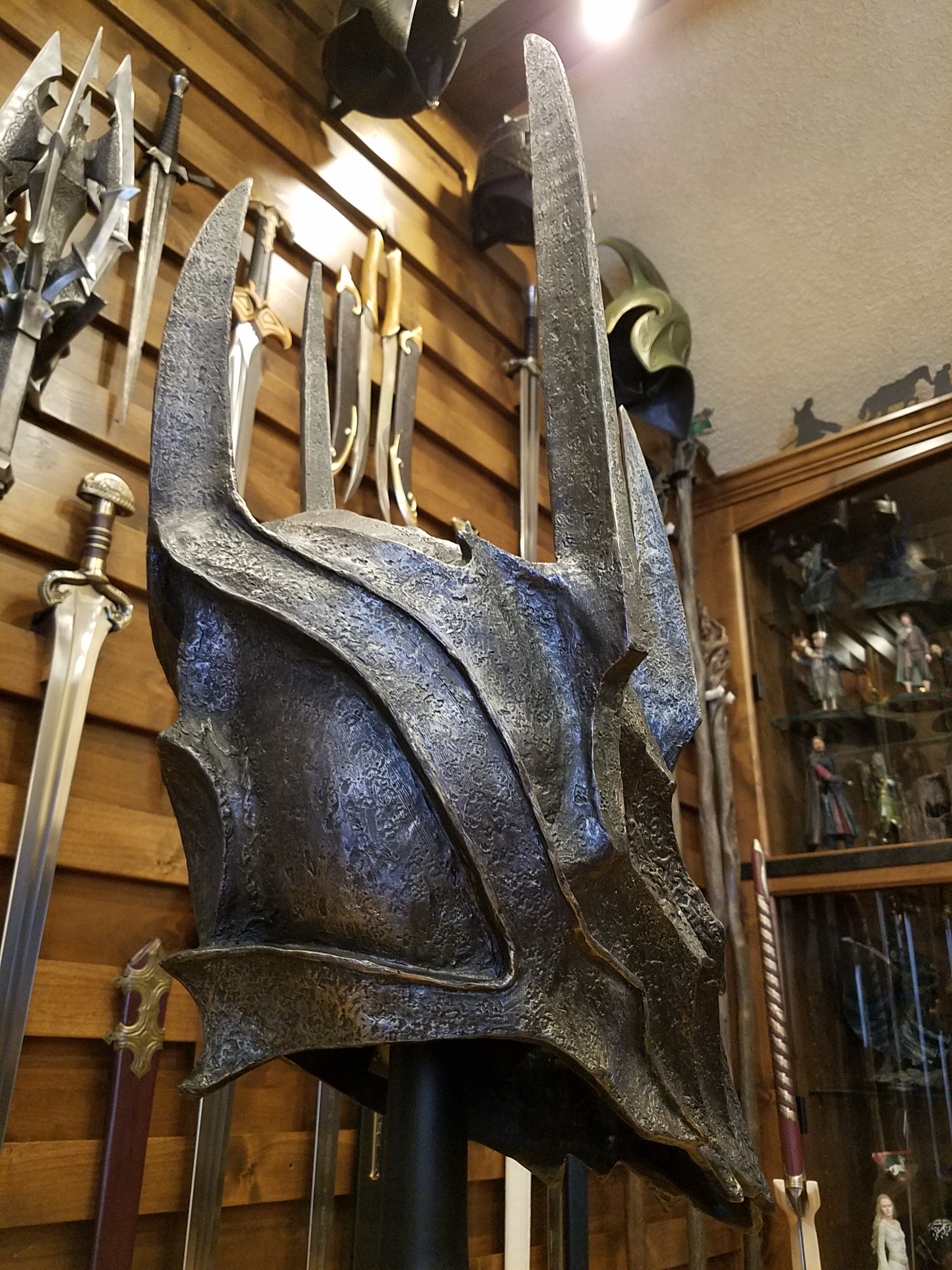

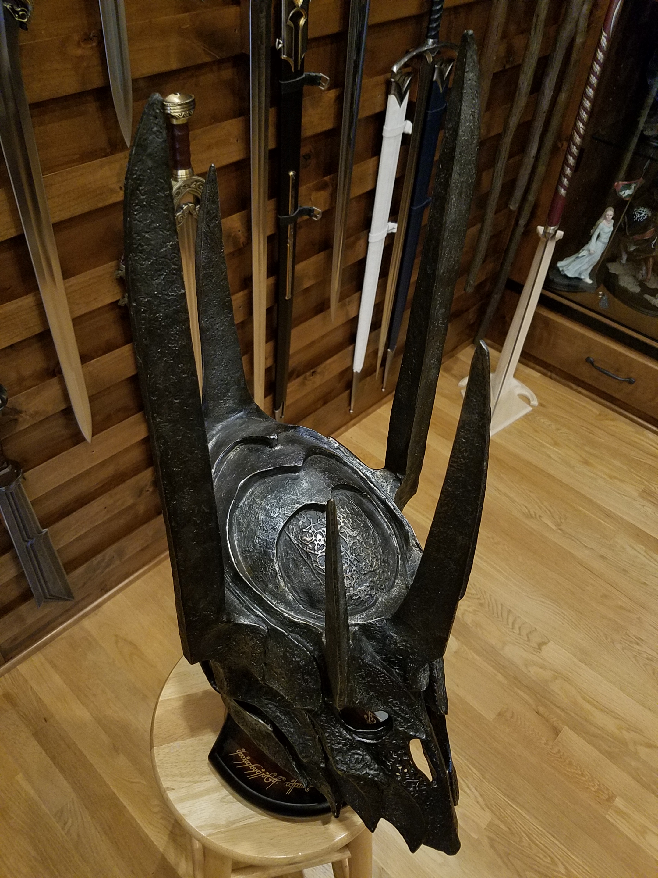

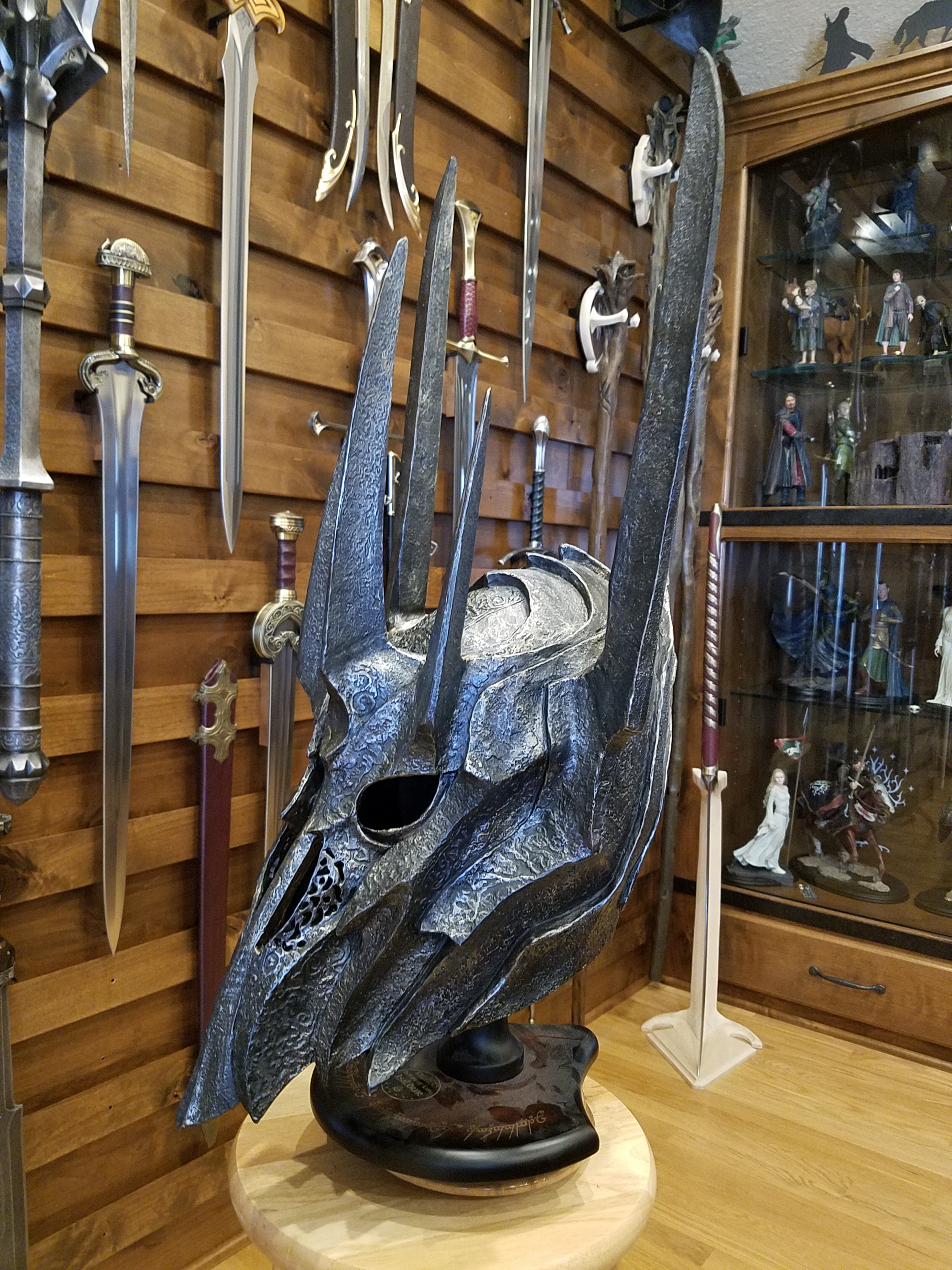

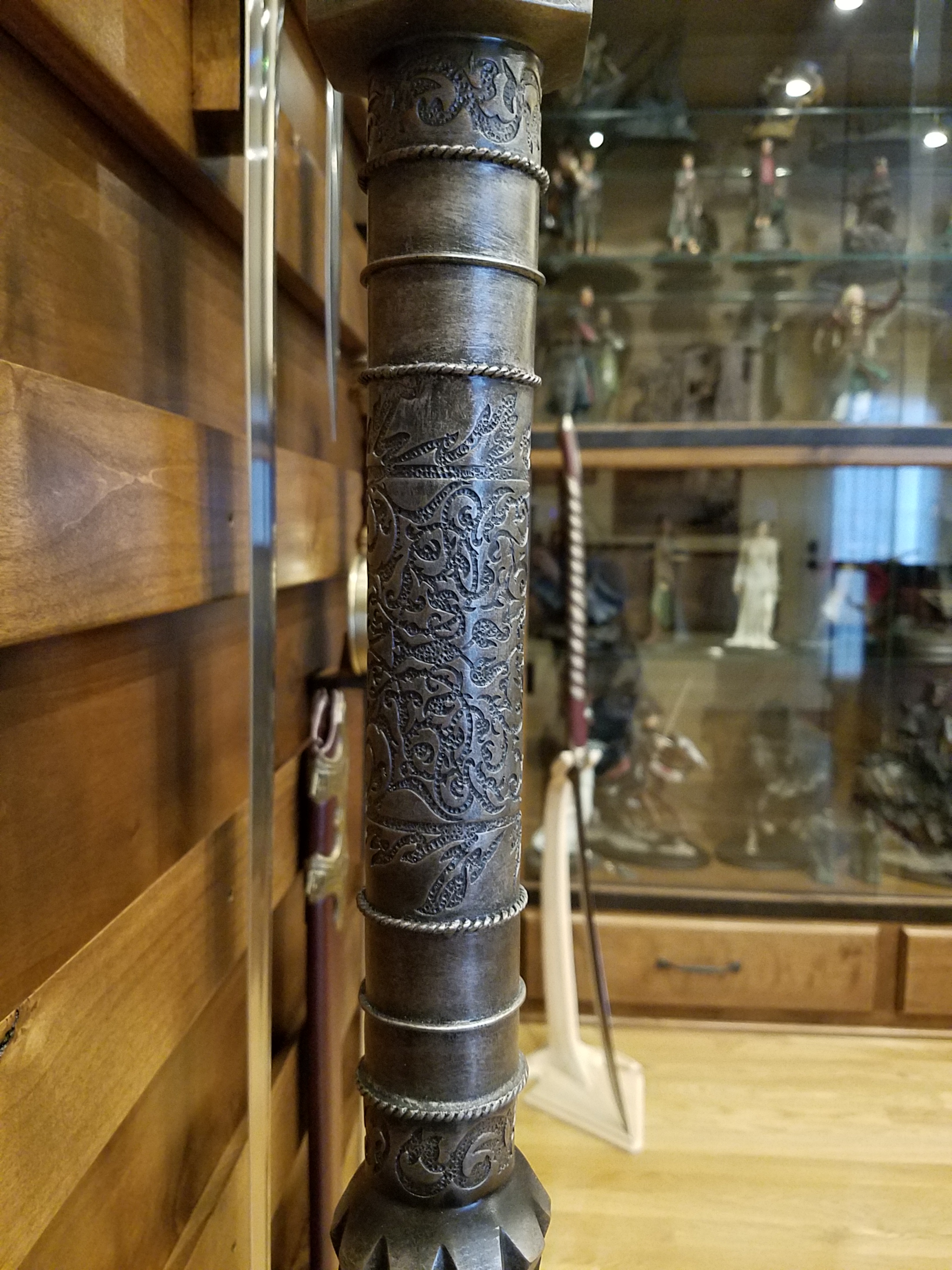

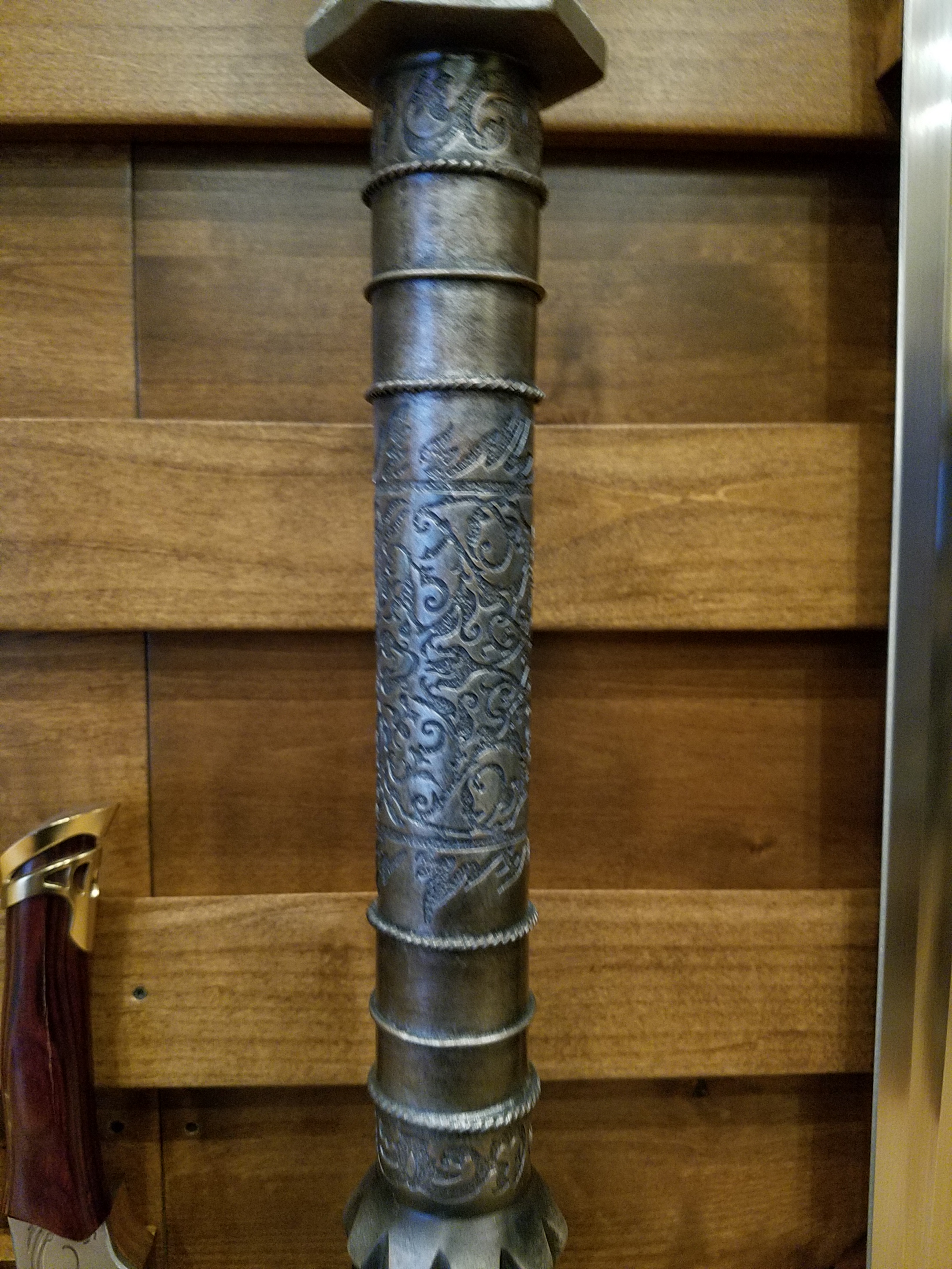

Here is some mace photos, photos are numbered and go in order. Some of the gauntlet as well
sm5.jpgsm4.jpgsm3.jpgsm2.jpgsm1.jpg2020-05-18 13.58.09.jpg2020-05-18 13.57.58.jpg2020-05-18 13.57.49.jpg2020-05-18 13.57.40.jpg
