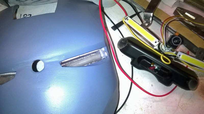

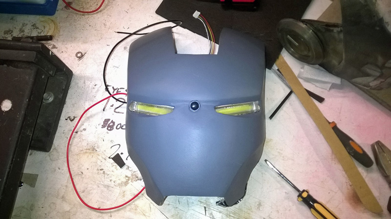

Faceplate Camera. A little panel-beating between the eyes, a backfill and primed the edge of the camera with a toothpick under a magnifying glass. Once the paint goes on the hole will be a snug fit for the camera. With a gold paint job and some gold film over the camera lens it should be pretty good.
Shoulder bell. First layer of bog and primer filler. Getting pretty good at this panel beating gig.

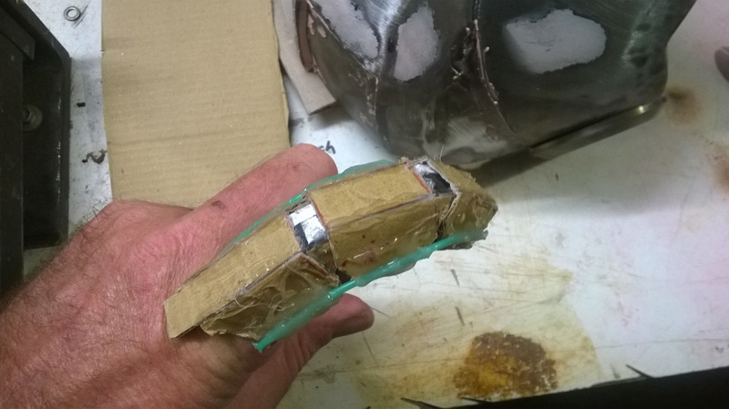

Not happy with my aluminium gauntlets. They are just too bulky and hard to get on and off. More prototyping in cardboard to improve finger dexterity. I'm scratch-building these because all the pep files that look great need too much adjusting anyway to fit my very broad, flat hands. Once I'm happy I'll make them out of steel sheet as per the rest of the suit. Instead of whipper-snipper cord on the outside I'll be using bike cable on the inside.

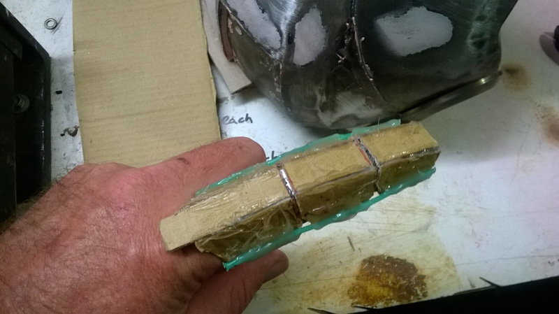

Re-designing fingers in steel this time.
For the curved underside of the fingers, rather than try to beat the steel into a curve over a round bar, I found a thick walled pipe to make a die to squish the plate into shape with the round bar.
Pressing the three together in the vice.
Presto!
Using the curved bit just made and adding some flats and angles, I welded up a finger as one piece.
Finger joints marked for cutting.
Knuckle pivot welded in.

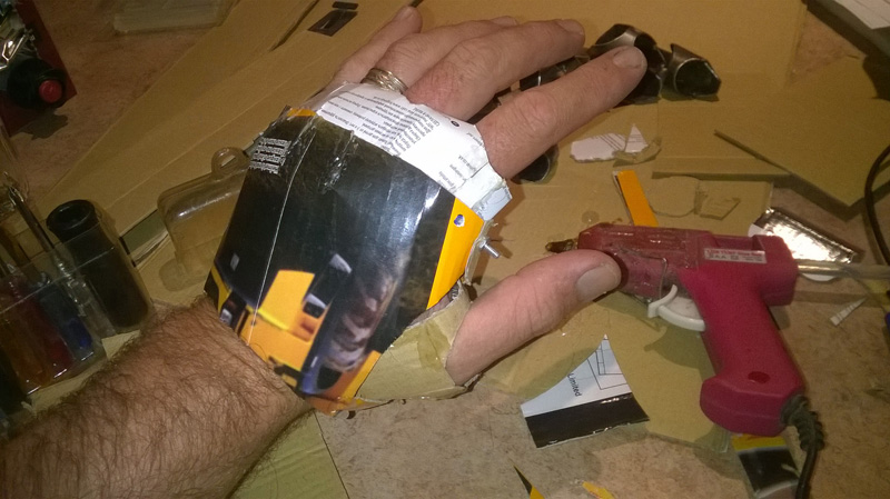

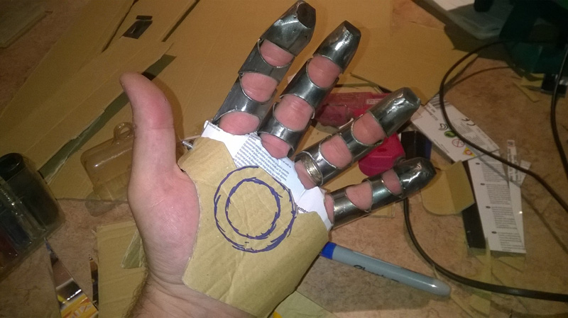

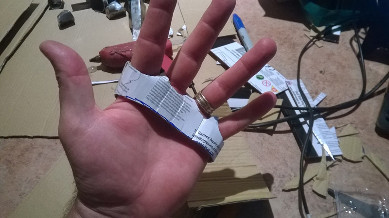

Hands down this has got to be the most difficult part of the suit. (See what I did there? ;)
I really want to be able to grab things, shake hands etc and all the gauntlets I have seen and tried have severe range of motion limitations.
So, it was decision time again to perhaps for-go a little movie accuracy for function.

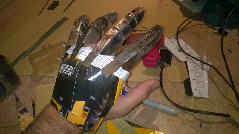

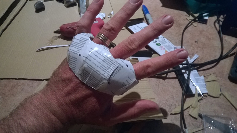

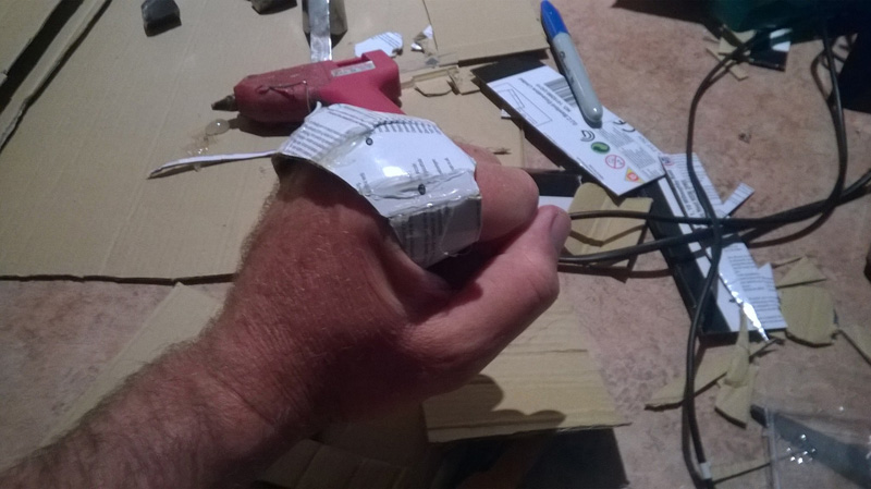

Steel is so versatile in that it can be beaten into curves and shapes that can ball-pivot inside other plates of armour. With this in mind I have designed a gauntlet that can fold along the crease inside the palm, plus let the heel of the thumb roll in to oppose the fingers.
Cardboard and hot glue does the trick. Looks a little rough, but this is the part where you nut out all the challenges and come up with solutions. It's going very well.
