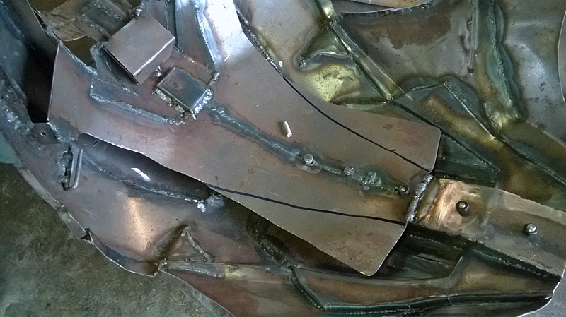

A light sandblast before I start on the finishing, then a clear coat on the inside.
I'm doing some weight-saving by cutting out any pieces inside that I deem unnecessary. There are a few bits I've added, but there are also a lot of bits that paper/card/foam/fibreglass suits would need, that a steel suit simply doesn't. Every gram I can save helps. Also cut off all the protruding bolts and sanded down the nuts. The padding will cover what's left.

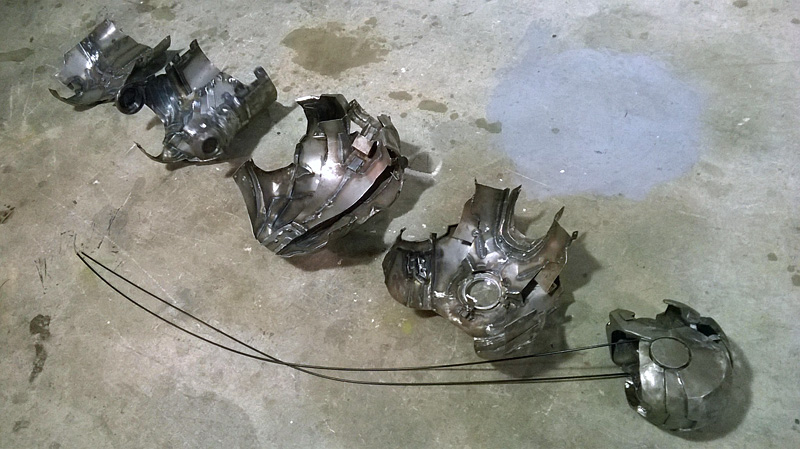

I spent an hour or so cleaning up afterwards, getting ready to protect the inside with POR-15 to stop rust. Main torso done.
I also welded in the second set of fittings inside for the faceplate return cable. A few quick pulls on both cables to test it with the helmet on. None of the bolts and hinges inside touch my face nor catch my hair, so with a balaclava on all will be sweet!
The cables will be cut much shorter later to stop at chest level and the actuator installed in the breast-plate.

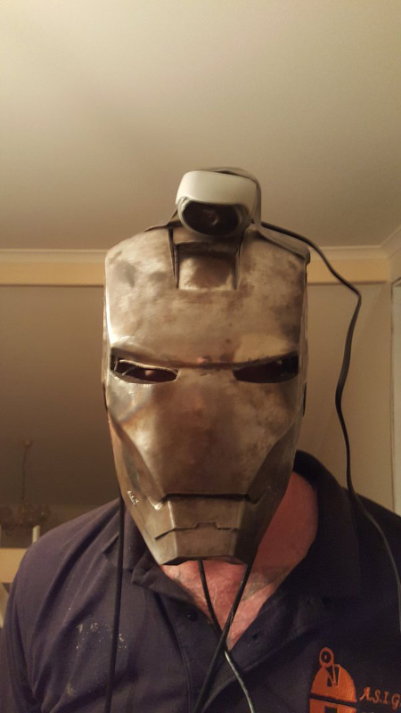

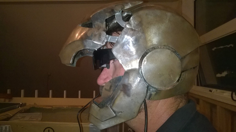

My friend Joffy came through for me tonight with some of the electronics which have just arrived from overseas. We got together this evening to trial the video glasses and a camera inside the helmet to check for field of view, fit and clearances.
We tried it first with the entire frame in there, but the frames were too tight and jambing up on the hinges.
So then we cut the frames off and taped the unit inside the faceplate.
We used an old security camera to test it and I can't believe how well I can now see!! It's AMAZING!! I told plenty of scoffers that this would work so I am feeling very smug now.
We have a lot of work to do.
