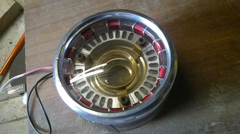

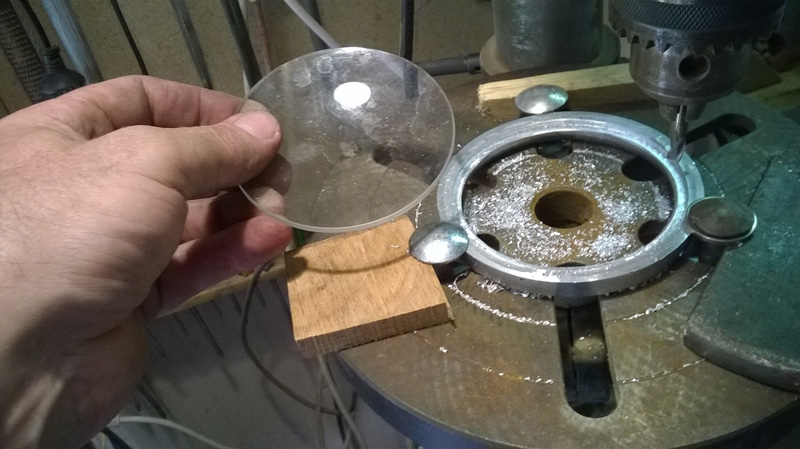

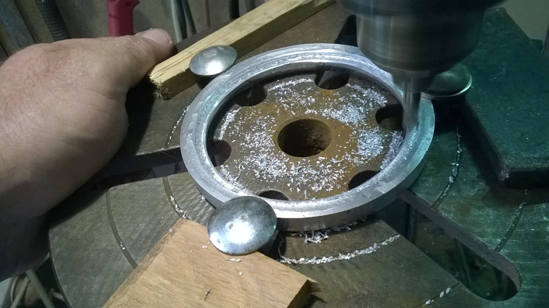

Unfortunately I don't always have access to a high-end mill or lathe, so I have to get inventive. Drill press bearings are not built for side-loading, but as I have a spare end-mill bit and if I just go lightly and slowly, I might be able to mill a gallery in the reactor frame to house the glass lens over the top.

Nice creative use of the drill press! I will be totally stealing this idea for the next time I need a simple milled circle.

Please be VERY careful. It's a dangerous way to do things. The job could let go and fly out at great speed, breaking fingers or worse, and the end-cutter could explode, causing terrible eye damage. Please take good precautions and wear appropriate PPE. (Especially eye protection) I took a big risk doing it like this.

I have to agree with the drill press machining... Its not idea and not the safest option, but if you take it easy and know your speeds it can work very well. Absolutely wear PPE!

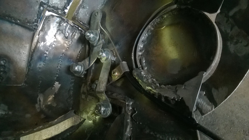

To attach the cable sleeves inside the helmet for pulling on the faceplate hinges, I will need to be able to change them when they wear out, so I've come up with this little low-profile clamp that can be loosened to change cables.
The long end will be welded flush on the inside of the helmet.

This helmet is smaller than most, keeping very close proportions with the wearer and the rest of the suit. As a result, there is no room for servo motors in the helmet to lift the faceplate. To solve this problem, I have used bicycle gear and brake cables to pull from an external stepper motor mounted in the chest.
Picture showing the cable-pull configuration on the inside.

This is a cool solution, similar to what James (xrobots) did with his resin helmet. He put a servo in the chin and that's what I'm planning to do with my foam helmet, since it has a tight fit.
You might have already checked his solution out.....but in case you didn't have a look at his website.

I did a servo in the chin for my last helmet. I think this is better.
