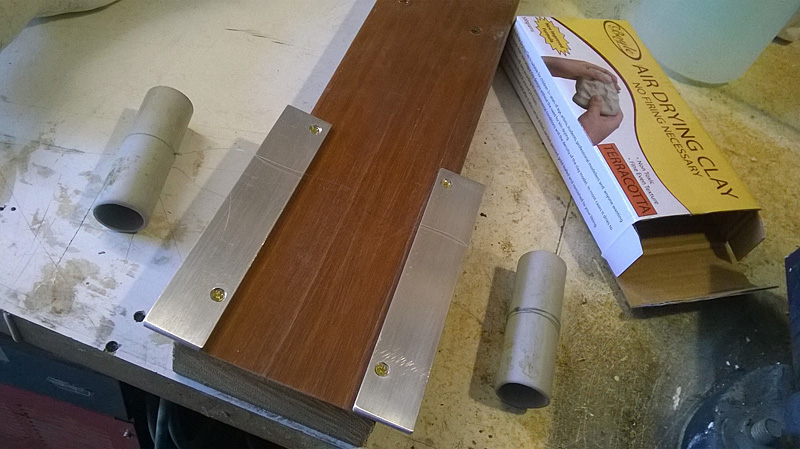

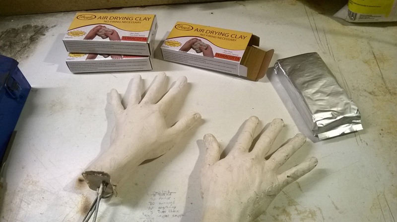

I'm now preparing for sculpting the Iron Man gauntlets. I need to cover the cast hands in an even layer of clay before sculpting. Made a clay-cutter out of a couple of strips of 3mm thick aluminium, mounted to a smooth lacquered wooden block and screwed to the bench. A couple of pieces of poly-pipe and some fishing line. Should be able to pack clay in then run the wire along to cut exactly 3mm thick plates of clay.

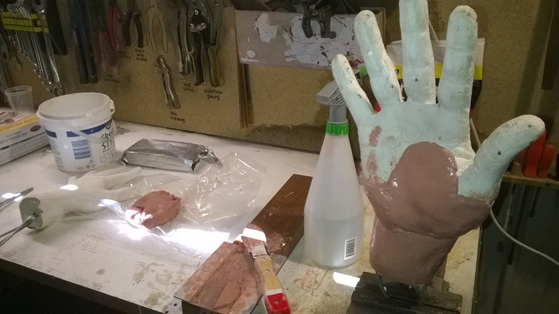

Today's progress. First time using clay like this. Not ideal clay either, but you work with what you've got huh?
Wrapping entire cast in 3mm of clay.

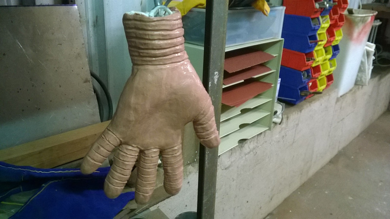

Hand wrapped.

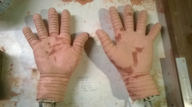

Under-armour glove details carved in. Drying time then sanding and refine details.
Patching up cracks and pits in the clay, a bit more sanding. Tedious, but the more time I spend on these the better the cast will come out.

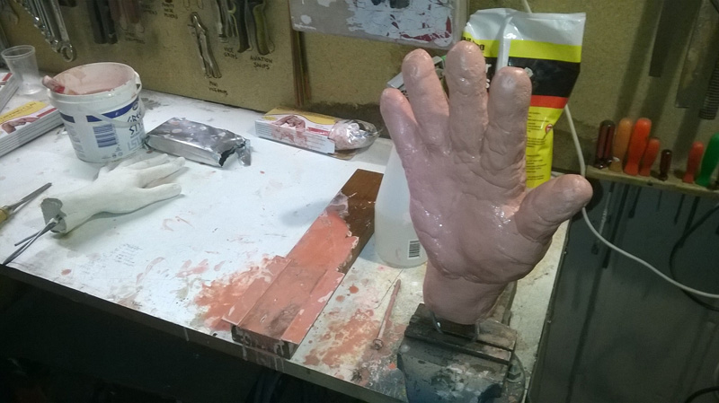

Packing the under-curves with plasticine in preparation for the pouring of the mold.
White Petroleum Jelly (Vaseline) as a barrier cream to stop the plaster from sticking.
First half of the mold - plaster poured. Tomorrow - the reveal!

Worked well, but there is a tricky bit or two that I've left a little on the low side that might need filling in before I pour the other half.
