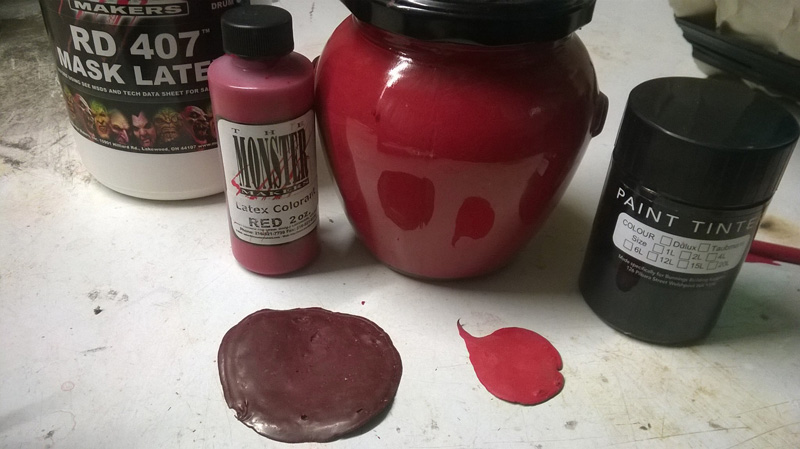

Trials tonight with colorant and paint tint in the white liquid latex. Thanks to Craig for the black tint. The left puddle has just a few drops of red and the right puddle has a drop of black and some more drops of red. I'll see how the flexibility of the cured latex performs in the morning.
After a night and a day curing, the latex with red colorant set as it should. The latex with the black paint tint,(one drop) is still runny and un-set. I think the black tint has severely affected the chemistry of the latex.

So what does the outcome mean for your latex plans? More time needed or different colour?
Hey George. OK. So the result is that the latex with the single drop of black tint added took a full day longer to set than just the plain red colorant.
The weird thing is that what's left in the bottom of the mixing cup, hasn't set at all. Puzzling.
That is interesting. Latex doesn't set or cure.. It dries. I wouldn't think a tint could cause it to stay liquid.
The water and ammonia evaporates out and what's left is solid rubber.
What is the temperature where you are using the latex?
Was the latex ever exposed to freezing temperatures?
Little test splotches like that should be dry in 30 minutes, not a day and a half.

30 minutes!!??
I don't know if it's ever been exposed to freezing temperatures. Certainly not since I bought it. It's been between ten and 30 degrees in my shed.
I'm really wondering if I've missed something. Should I stir the latex? Is there a catalyst to add that I don't know about? I'm under the impression it's ready to use straight out of the jar, just add colourant and away you go.

I dont think you missed anything, the website says its a single compound air drying latex so my guess would be some sort of contamination somewhere along the line.
http://www.monstermakers.com/product/RD407-Mask-Latex-for-Halloween-Masks-and-Props.html
Definitely give the jar a good stir. Try testing it again in a room temp or warmer area, and place a fan by it to encourage airflow over the piece.
As stigmorgan said, latex is one component. The solvents dry and what's left is the solid rubber. You can't really contaminate it, as the only real process is evaporation.
When I get home ill throw down some tinted latex and clock its cure time.
also I just noticed the black tint you have is a different brand and is labelled as a paint tinter so that may well be the whole cause of the problem
I did mention that at post #827. :D
Sorry, got a little busy filling orders the other day.
It took the latex (same brand, red tinted and everything) about 48 minutes to dry in a room temp (76°F) room, with light airflow over it.

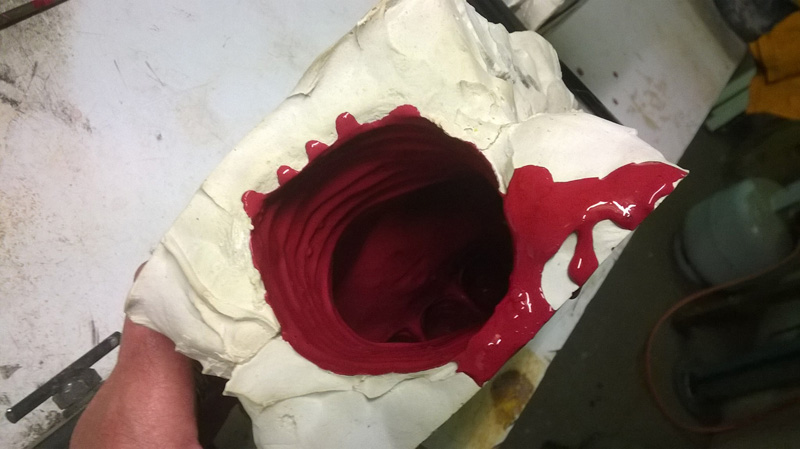

Over my plaster hand the clay sculpted layer was about 3mm thick to make the mold. I'm hoping that one or two pours, (layers) of latex will be thick enough and strong enough to make them durable, yet not so thick that I can't pull them on. I will be wearing a thin cotton glove underneath which I think will help.
I've never made gloves before. What do you think?
Hey MrMoldMaker, if I want to build a layer or two for thickness and durability, how long should I let each layer set before pouring again?

Mixing in a glass jar this time to get the colour kust right.
First pour in and back out to coat it.

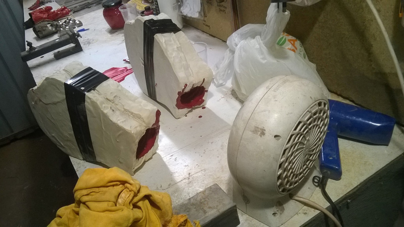

Warm, not hot airflow while flipping the moulds every few minutes to avoid pooling.
