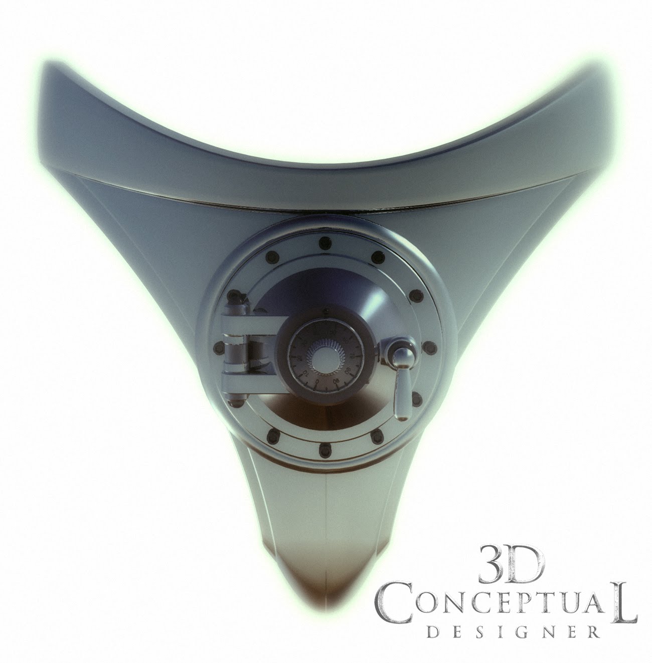

OK, I'll try....... I figure a man with your talent you could easily put in something of this nature.... Got to protect your.....ah you know... as well as being functional and easy to wear....;-)
Funny and functional:thumbsup good thinking,Peek.Other than that I wouldn't have known for a suit that solid.
