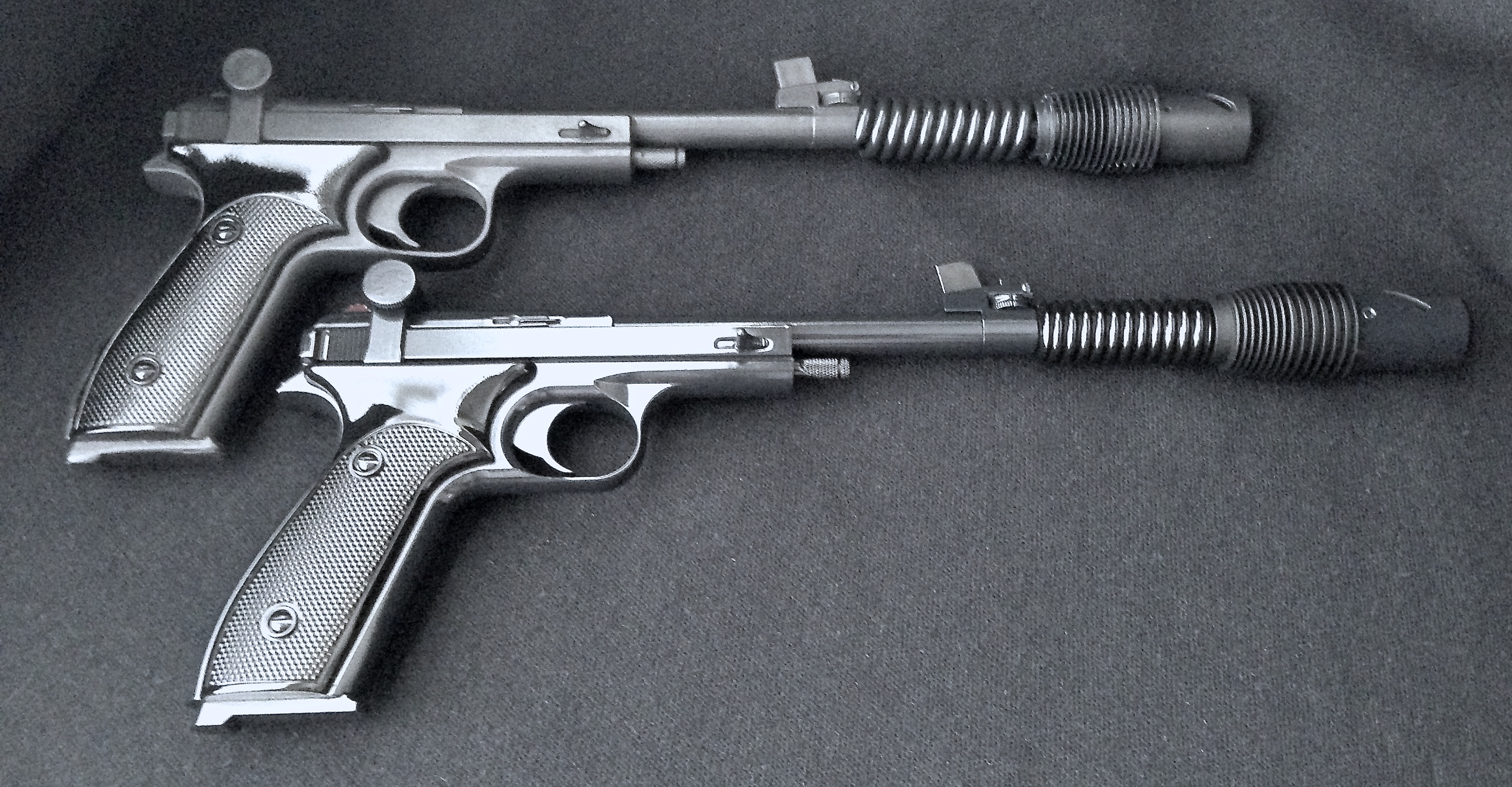

SO I finished my ESB Han Bespin the other day (minus the flash hider weather... have decided how to tackle that yet) and I thought I'd share!
...and this is how my other accurized Denix mauser sits to be converted to ANH...
