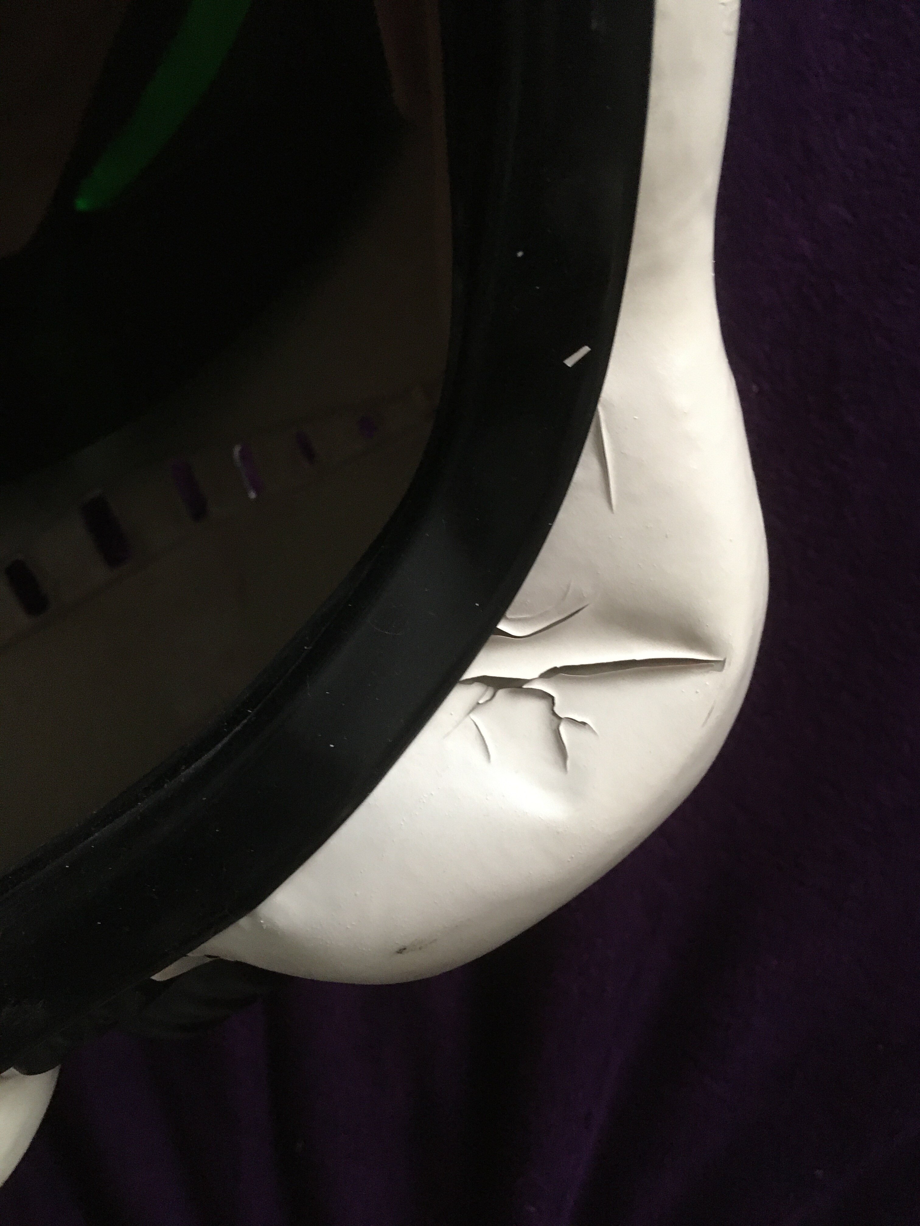

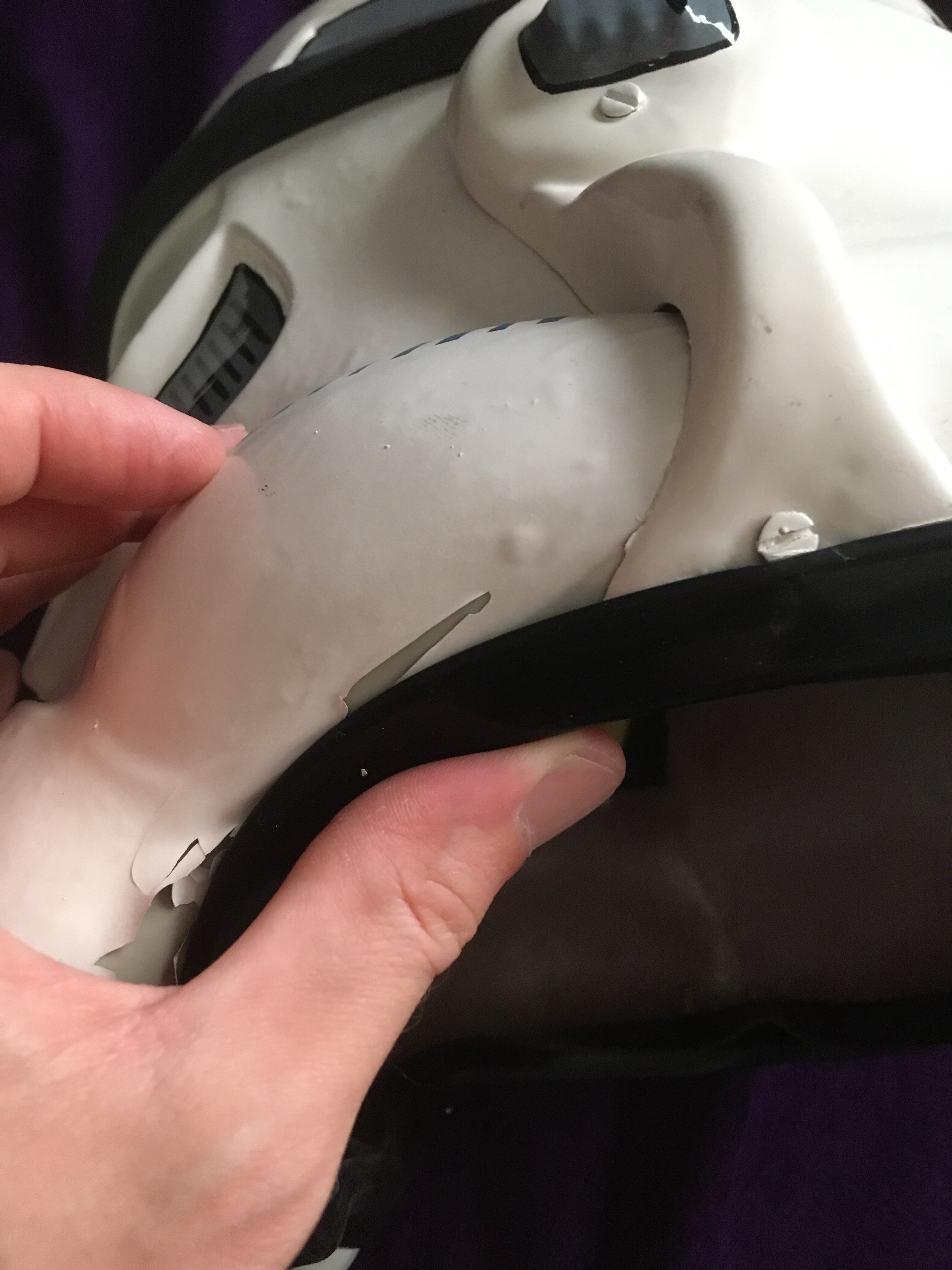

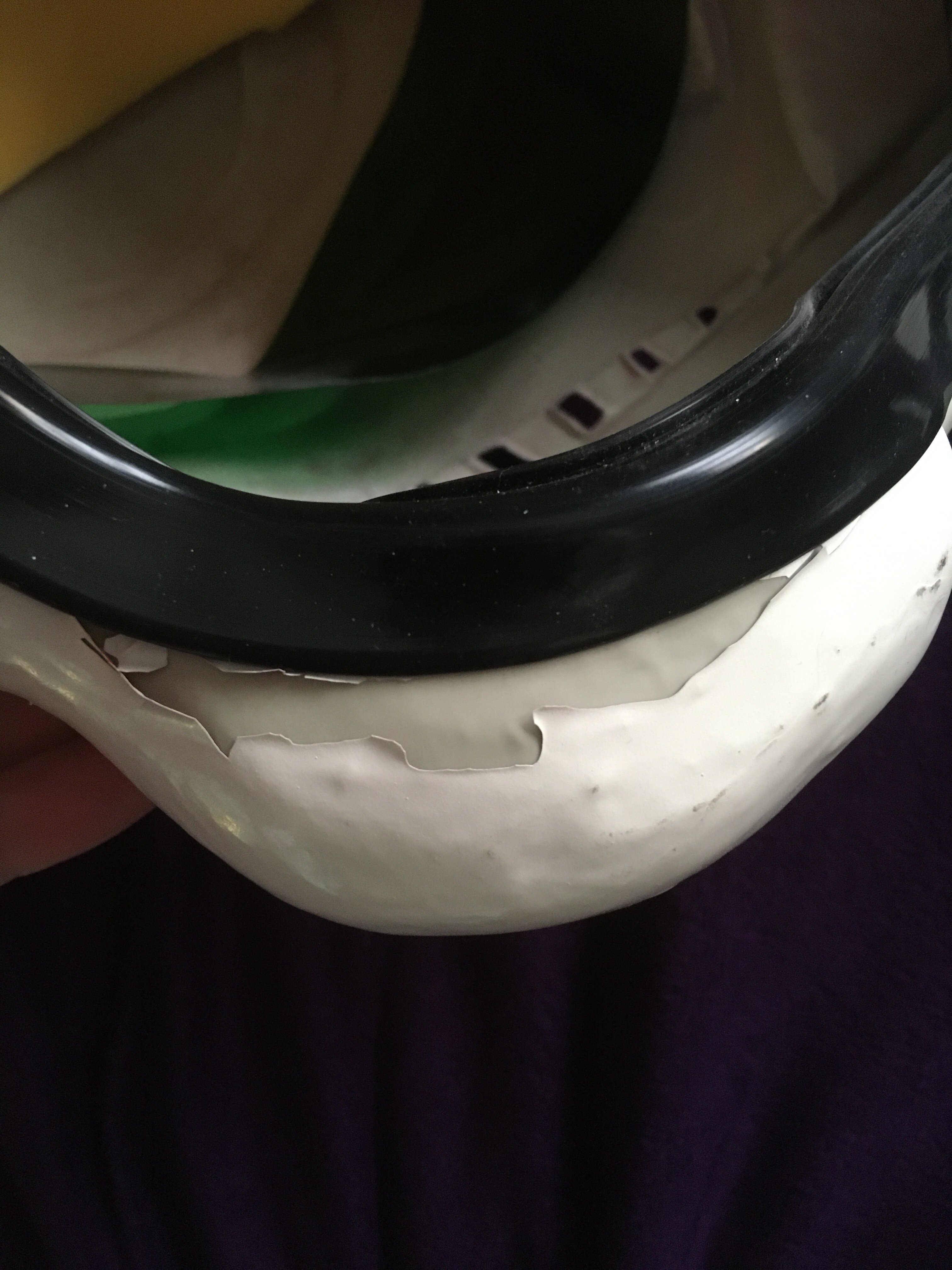

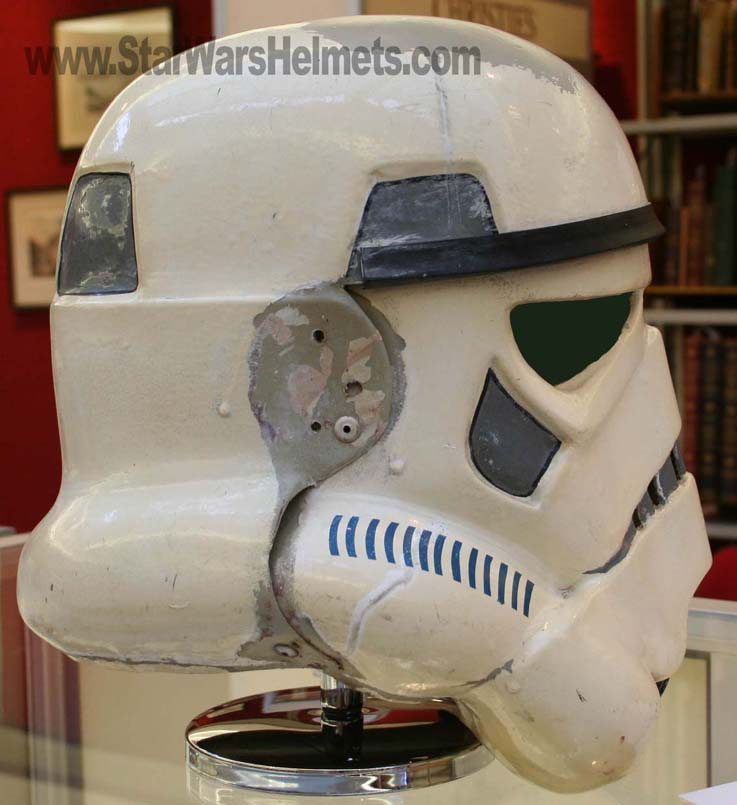

And another 4 years later its complete green again. :D
I´m not really a fan of paintjobs like this...this helmets are really expensive and should have a more durable paintjob.
Hopefully people that buy them know the paint will flake off over time. The point of these is to be as close to what was used on screen as possible. That includes a paint job that isn't durable.
You can certainly get a similar look but a more durable finish by painting several layers on an ABS helmet.
I think he could be potentially referring more towards the fact that the paint on the original seems to last longer, whilst these are peeling faster. From what I remember, the Og's were painted in three stages, Red primer, White rubbery base coast, White hard colour coat. I think the rubber coat may or may not have been omitted.
I have one from thier first run and it still has all of the paint it came with. You have to really chip at it or bash it around to get it to chip. If it's just on display it may lose a tiny bit but it's not just going to fall off. If you think Ainsworth would go as far to make things greater than these helmets you'd have another thing coming:)

"like used on screen" is not possible because you cannot use the real old colors they used in the 70s.So I think thats the reason why this helmets loosing their paint after 4 years and the real ones after 40. ;)
There are most likely many differences in the materials used. Different plastic and paint could make a difference in durability.
It's also possible the number of white layers is different. It could just be the lighting, but the white in the below image doesn't look glossy to me.

I would think the conditions the helmet is kept in will make a big difference in how they age. The photos I have seen of the screen used helmets vary quite a bit in how much paint has flaked off. Unfortunately I am not aware of photos of the same helmet taken a year or two apart to show how the paint on a single helmet aged over time.

I am not aware of much evidence to show how an individual original helmet flaked over the years. Usually the later photos are decades later. Obviously those helmets were treated pretty roughly during filming and sometimes in the years after filming.
The originals certainly did flake, even while making the film. I don't know if the original plan was to make the screen used armor the same way as the stunt helmets or not, but it would make sense for that to have been the plan. They must have realized the problem with painting Polypropylene since the TK armor, hero TK helmets, and TIE Pilot helmets/armor were all made with bare ABS, not painted Polypropylene.

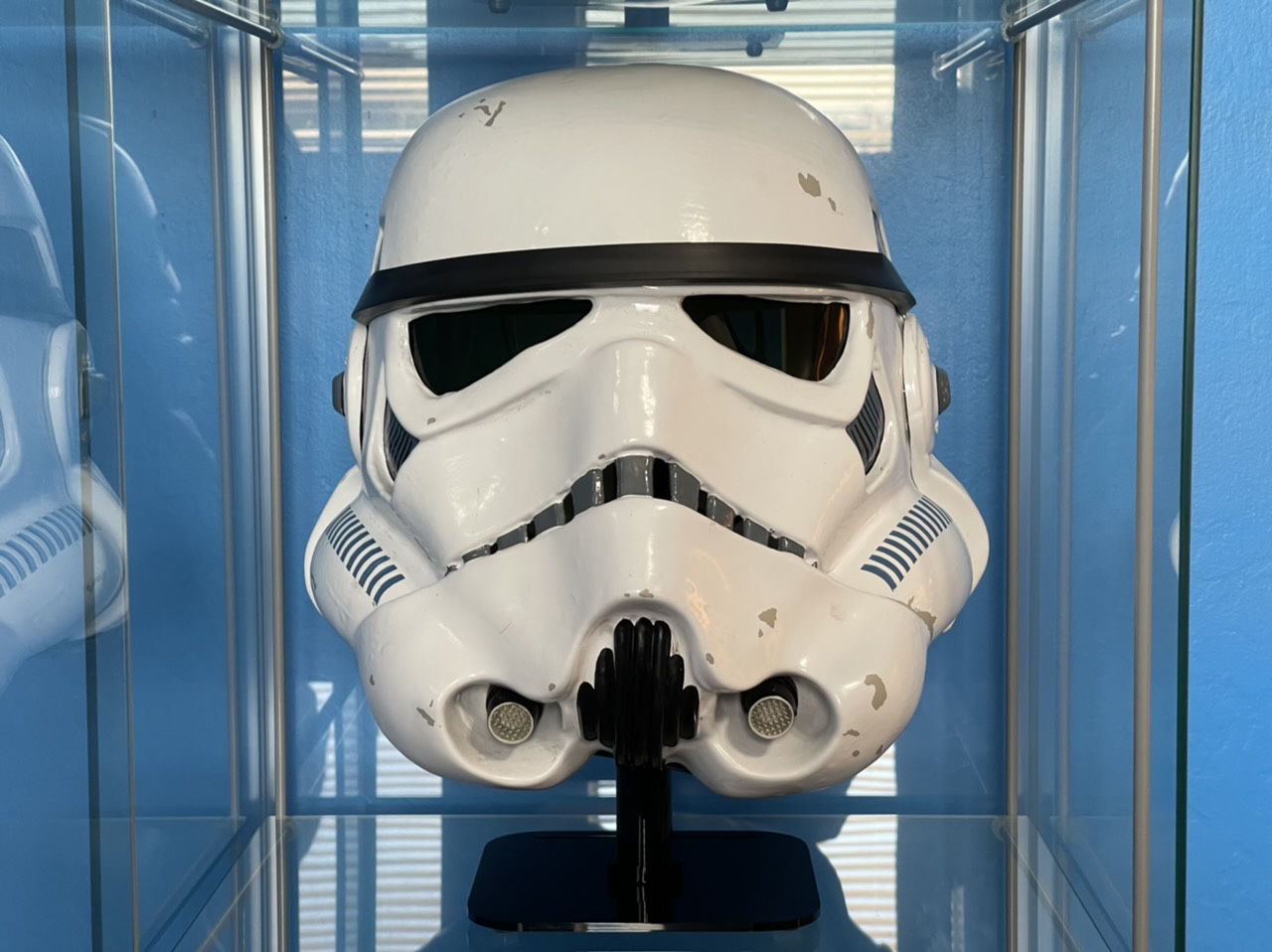

Here’s my battle worn helmet. My clean one should be arriving in a few days.

Same website, pretty glossy.
And the photos you provided were of the initial base coat layer (2nd layer) I was describing. Process as follows: Red oxide, flat/satin white, ears on, gloss coat white.
The ears in this photo:
Are infact unpainted. As the gloss coat was the only paint that touched it. You can see that some of the ears are of a different hue.
So you are indeed correct that the helmets aren't glossy in comparison to the ABS which my eye can see as glossy.
I think this was confirmed by either Gino or some other member who touched the o.g. helmets either here or another forum which we know is solely based around the stormtrooper, they mentioned the reason the missing paint in the ears in the above photo is because of the lack of colour coat giving it a hard surface, and that the 2 initial coats of paint flaked off in that area as it wasn't protected by the final paint layer.
You can see evidence of a totally different "white paint" with the "red primer" in the ear sections.

I can promise you that they 100% not used the same primer.They used one that looks like this.Same with the plastic.And thats ok for a replica.

This photo is so washed out but you CAN see gloss on the helmets in these areas.

They didn't switch to ABS for the armour because they were having problems painting the HDPE. They tried making the helmets with ABS as well at first, but had trouble getting the ABS helmets off the buck without cracking/ breaking the plastic, because of the the deep undercuts on the Stormy tubes. Therefore, they switched to HDPE which was much more flexible and easy to pry off the buck without breaking.
The helmets were never meant to last, only to complete the filming hence the limited life span of the paint. I also think I read somewhere that they might have used latex house paint and just put that on with a brush.
If you look closely at ANH you can see the stunt Stormy helmets are a slightly different white than their armour.
