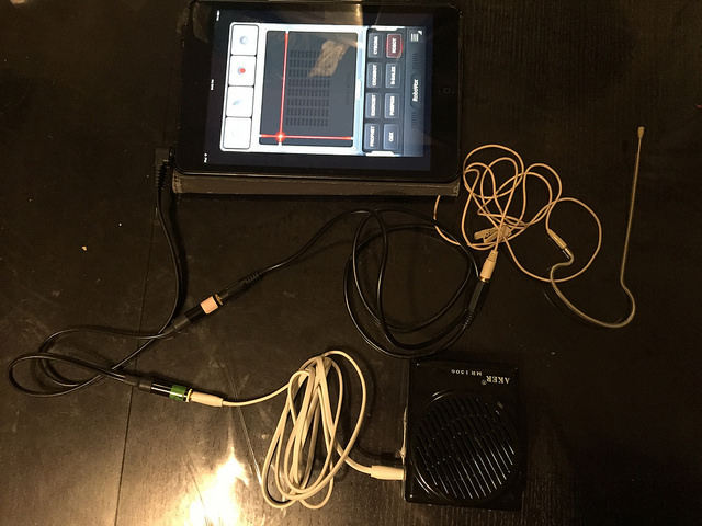

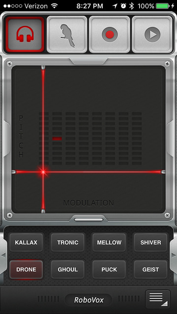

Received my new audio connection cable suggested by Tumbler It works!
My over the ear mic goes through the input and the output passthrough ends up in the aker.
Setup 3 different voice options for K2. Will try them out once I start full puppet testing.

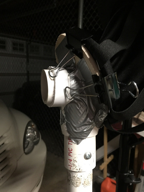

This uses the same technique as the shoulder sleeves. The large ring and the narrow small ring are permanently attached to the shorts fabric. They join to the fatter small ring to hide the hip PVC pipe once the legs are attached.
The pieces fit snugly to the pipe and slip ring.
Binder clips will be used again. Accessed through the removable 5" disc on the outside of the upper legs.

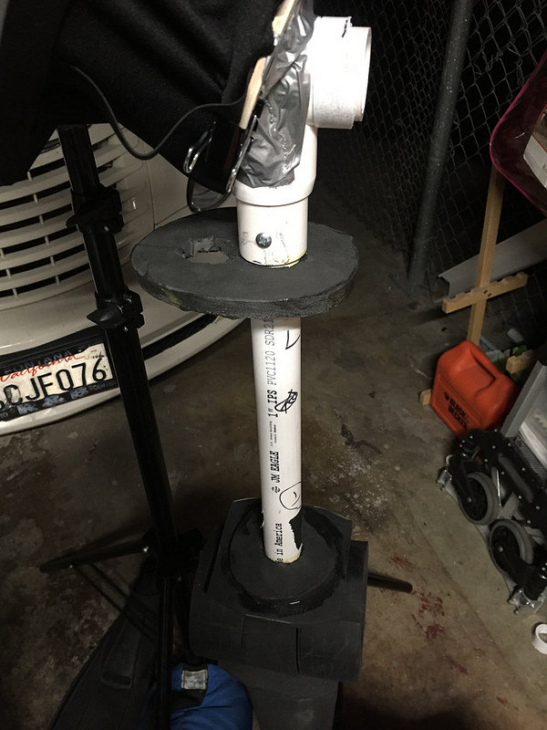

Getting the dimensions down. The upper leg will be supported by 3 foam discs inside it.

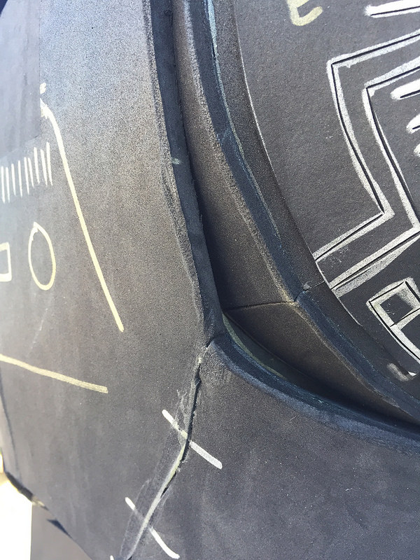

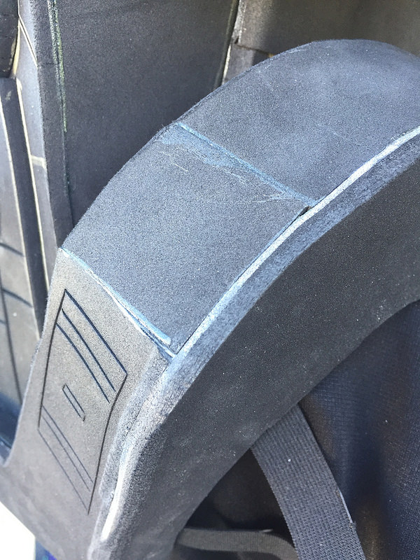

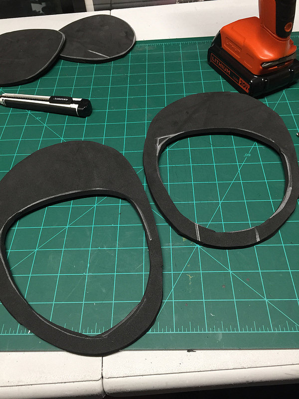

Remade the front panel. I've never been happy with the 2mm gap around the edges. Just needed to increase the size slightly. Cut off the original and traced around it. The pen width was about the increase I needed.
Glued up for the new front panel.
Old on the left, new on the right. I almost forgot to add the heat seared lines on the front before gluing it in.
I really like how the edges of the front panel turned out. I'll still add a little bit of filler but It's much smoother.

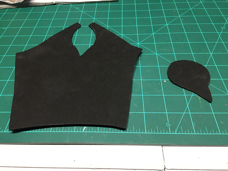

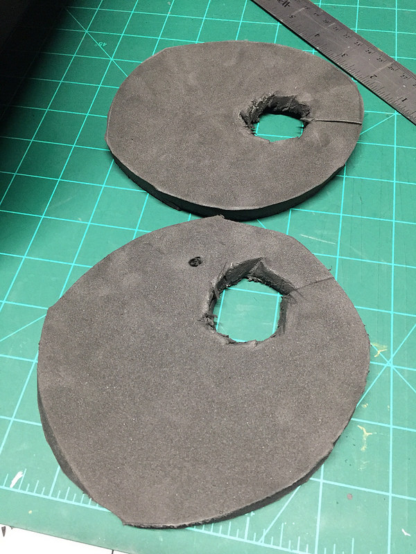

Templated out the inner pelvis pieces off of 2mm foam then transferred that to 6mm foam.
The insert fits around the center spine.
I decided to put the inner plate on the inside of the wing to keep the thickness down.

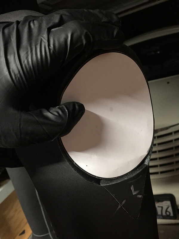

Cut out circle to funnel the shorts cloth. Similar to how the shoulders were funneled.
Glued and taped in the large wooden disc.
Glue primed on the outer plates. Made the funnel hole bigger to let as much of the fabric stretch as possible.

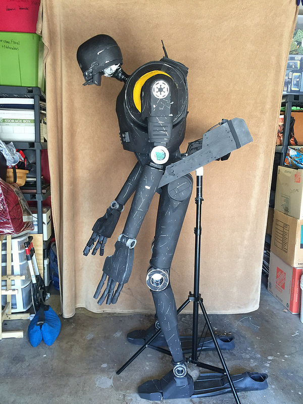

One of my new favorite shots. The torso is DONE!
Don't get dizzy.

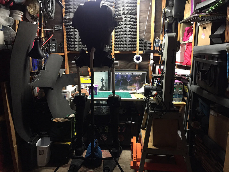

New garage setup. Purged the garage and moved against the back wall. Now my patient lovely and understanding wife can park her car in the garage. First time in 2 months.

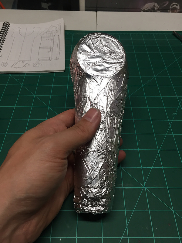

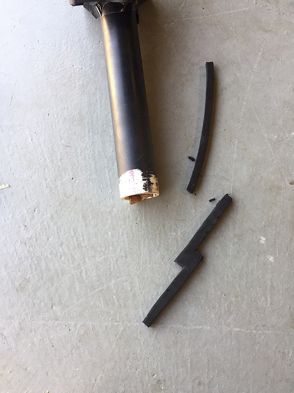

Time to finish the upper legs. This curve is just beyond my brain to turn inside out and flatten. Time to make a template. Sorry 31" big fig you're loosing your right leg.

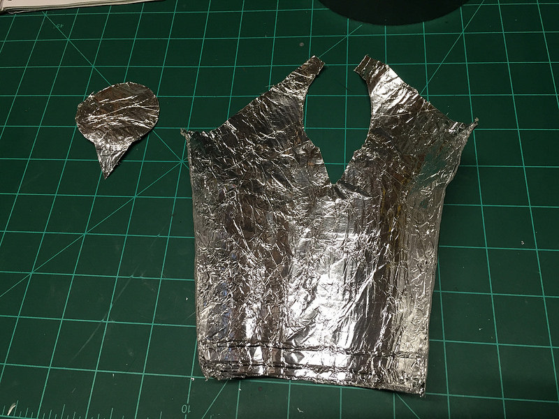

Opened up to remove the upper portion of the leg.
First cover in foil so the tape doesn't stick.
Then cover in tape and cut along seams.
Kept it only 2 pieces. Had to make a small notch below the outer circle so it all fits.
Decided to make a small scale test out of 2mm foam.
All cut out.
Turned out great, onward to full size.
I've seen this method used a lot by other builders but never used it until today.

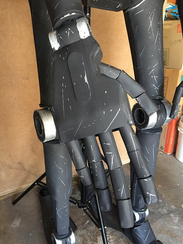

Finally finishing the detail oval on the back of the hands.
I'm always making 2 of everything on this build.
Detail in place.

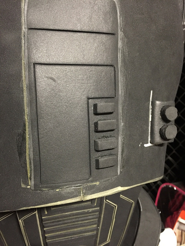

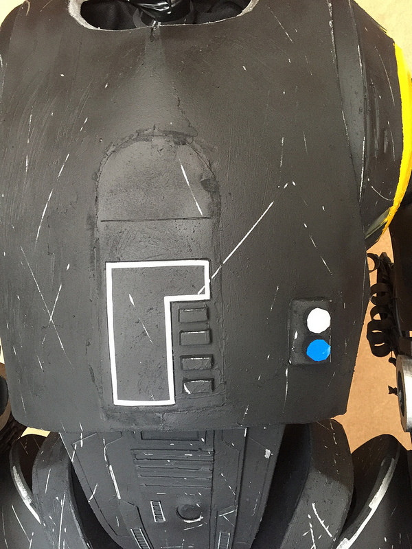

Also made the coin slot buttons for the front chest panel.
These look great. Another Star Wars part that we see on Vader's chest box and R2-D2's front.

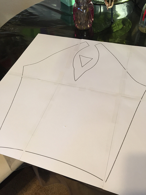

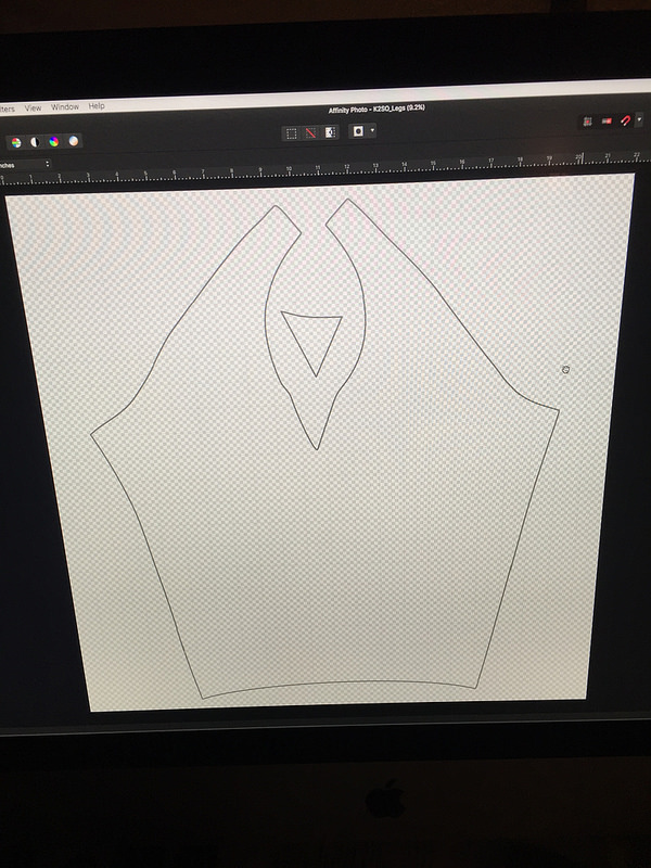

Scanned the template for the leg.
Upscaled to 21" high.
Printed out at full size over 6 sheets of paper.
Ready to transfer to foam.
But first a paper test. I'll need to use the inner support rings to have it hug the inside of the leg, and need to add 2" to the bottom but it looks good.

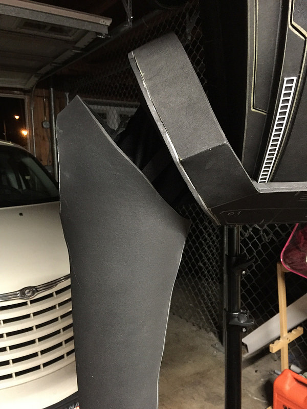

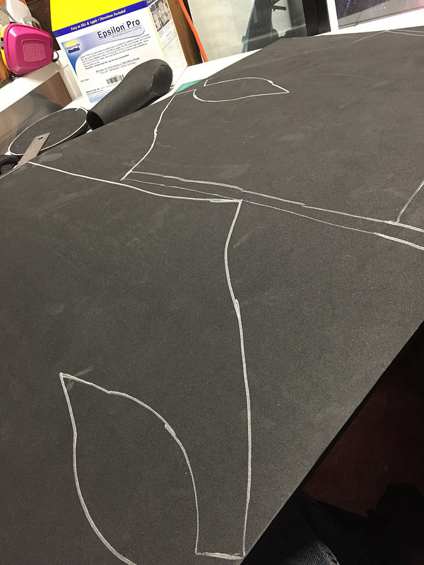

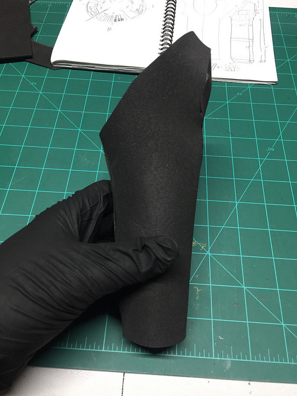

Marked up the two templates for the legs.
Added a little to the outer edge you can see here.
Determining how best to mount this.

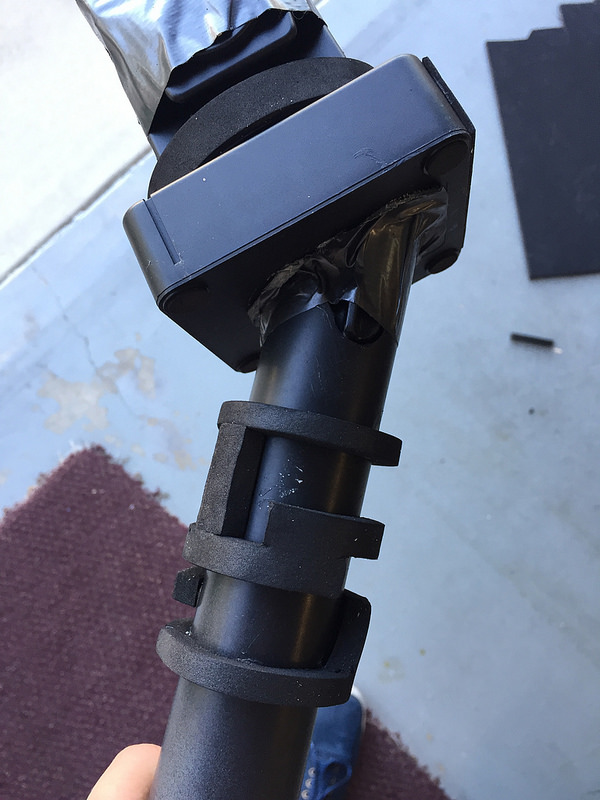

Made a custom support disc at the bottom of the leg (at the knee) and just below the side notch.
These will support the leg and keep it in place. I ended up moving the top placement hole, but why use more foam when the old one will be hidden.

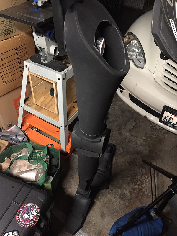

He's got a full leg!
Worked hard to make sure this placed where I wanted it so when K2 takes a step there is enough clearance for the leg to swing.
2 legs!

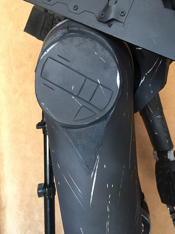

Cutting down some old circles of foam to make the cover caps.
Checking the circle size.
Readying some magnets, marking the polarity.
Counter sunk 5 magnets into the legs. This way the cover cap has an Up.
Matched up the magnets.
This access cap lets me reach in to secure the shorts cloth and attach the hip ring to keep the slip ring on.
Looks pretty good.
Cutting some foam to cap the top of the legs.
Leaving a lot of room for the shorts skirt.
Great set of legs.

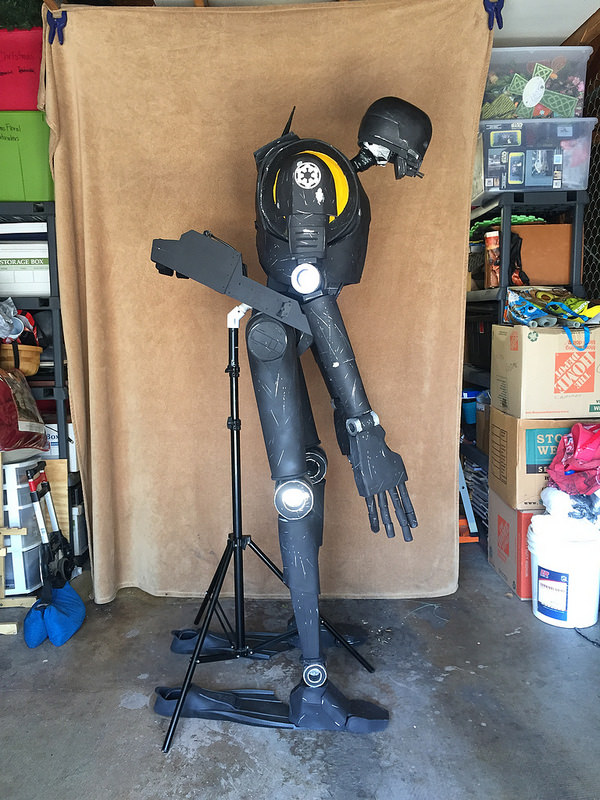

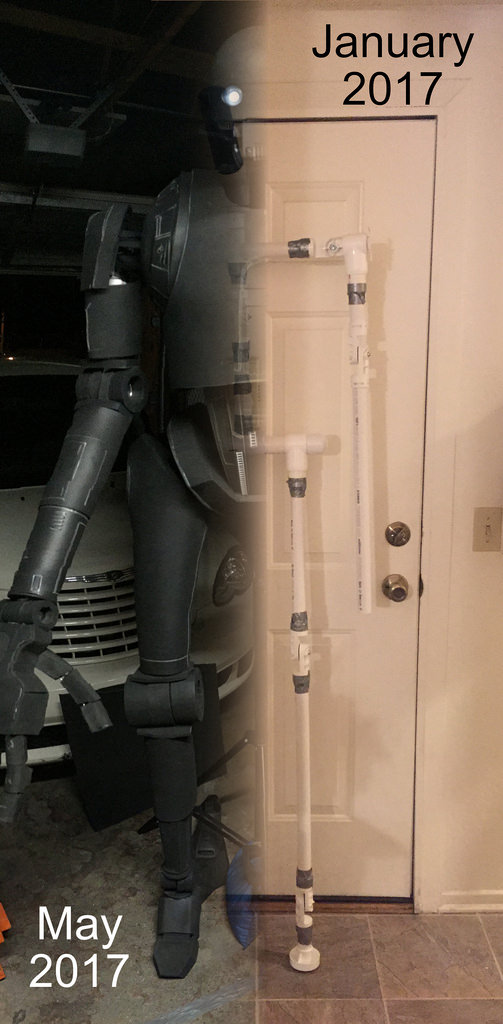

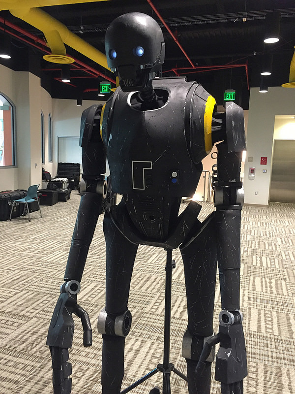

K-2SO, fully assembled the main components. Boy how far we've come.
Speaking of that, he was just a PVC skeleton in January. Sometimes you have to see past your current step to what will be.

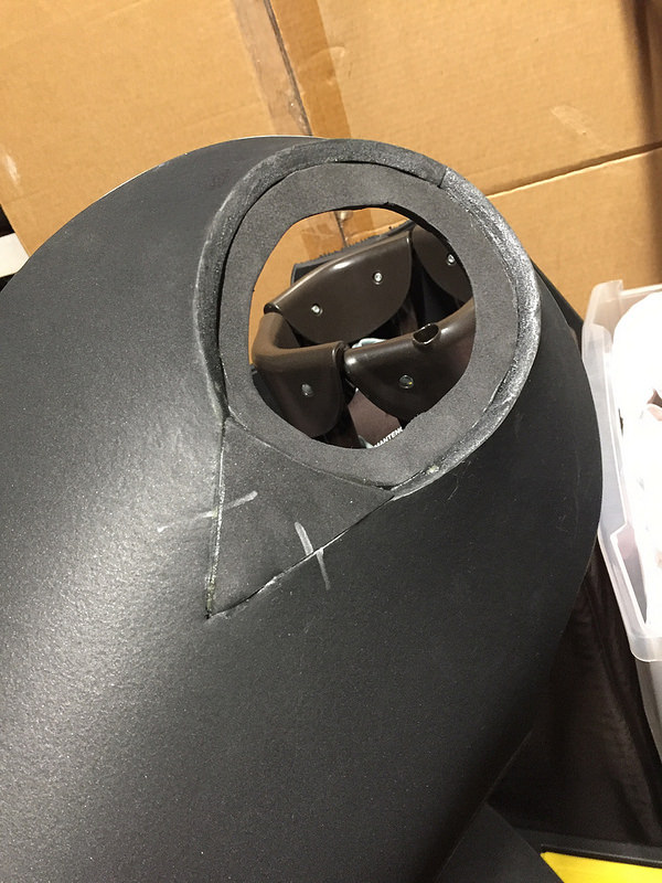

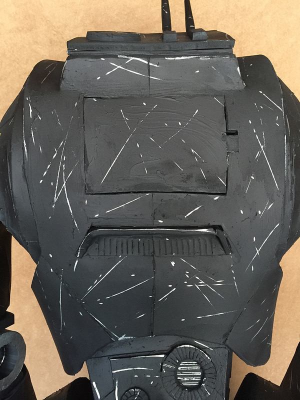

Time for some more details. Made a small cover for the iPad mini slot. This way if the picture is of the back I can cover it.
Had some help for the first time working on K2 parts. Dremeled the edges off most pieces. The fingers look much better now.

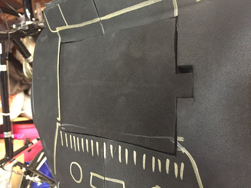

Added some magnet points for the back cog/bar access panel.
Removed the unseen electronics from the back panel. It snaps on and lines up nicel.

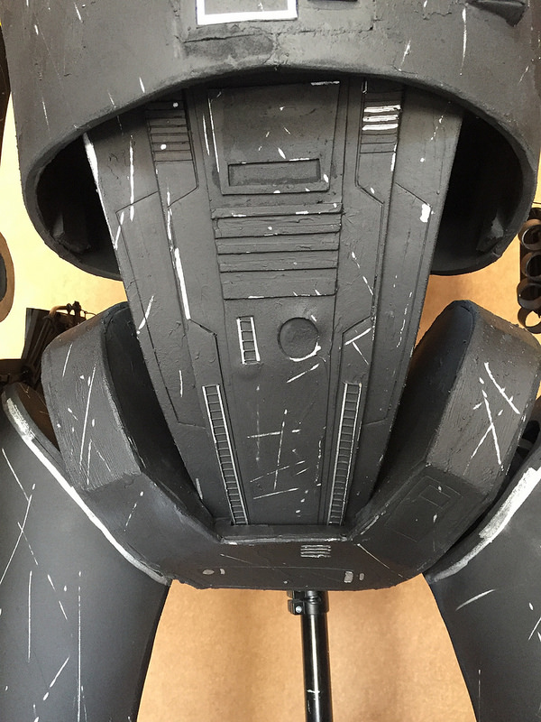

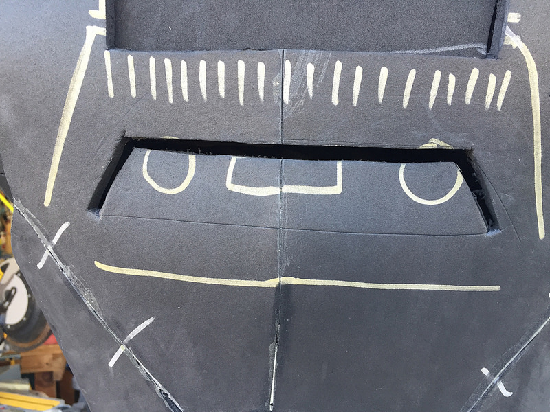

Adding this arch detail in the back.
Cut out a nice notch.
Taped in a piece of 8mm foam and heat scored the detail.

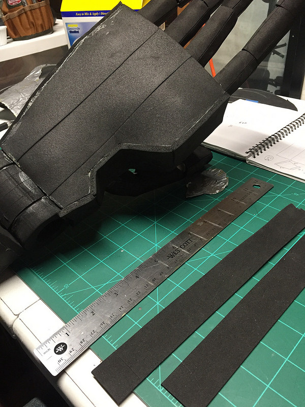

Prepping thin strips of foam for the neck detail.
These are glued on in no particular pattern but reflect what is on his neck.
I really like this little detail. But need to make some sort of cover for the bottom of the pan/tilt unit. At least before the neck servos are installed for head 2.0.

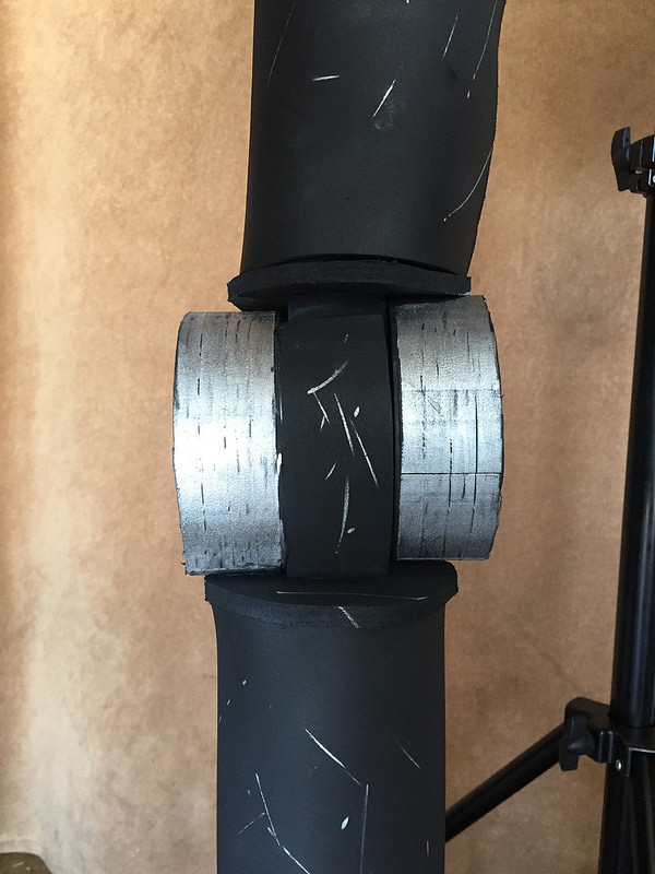

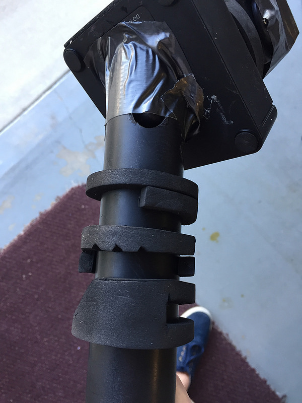

Also bit the bullet and trimmed off 1/5th of the knee joint puck. It split right along the glue line. This helps reduce the 3PO knee feel these have. I'll remove the other outer layers from both knees.

Looks f'n amazing!! I love the template making technique you used! Never thought of that! Great job so far and I can't wait to see more!

Friday was panting day! The night before I sealed the foam with the critter gun and Poly Latex 60.
Ready for paint, sealed foam.
A light coat of primer. I took my time making sure the paint didn't pool.
Went through 5 cans of primer.

Ab plate.

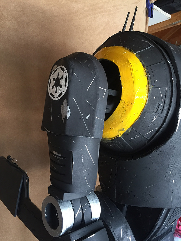

Compilation of painting the Imperial cog stencils on the shoulders.
It's looking better and better with each coat.
Still have some leftover texture from the brushed on latex on the torso, but it works out.

Masking off for the yellow ring on the shoulders.
Cut some electrical tape into circles and glued to his front buttons.

I decided to pull apart his left knee and replace the stopping screws.
New screw in place to keep the knee locked.
Made some pin striping tape for the front panel with a roll of electrical tape.

Yellow ran a little but still looks good. Also added many strike marks all over his body.

The microphone input jack for connecting with the harness.
Wire runs on the harness through the connection pipe. My over the ear mic connects on the vest.
One more plug in shot.

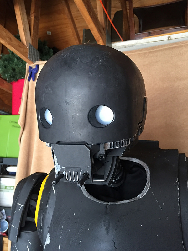

Added fabric around the neck to let the amplified voice out.
Strike mark weathering on the torso.
All pieces weathered and ready. Added silver on the joints.

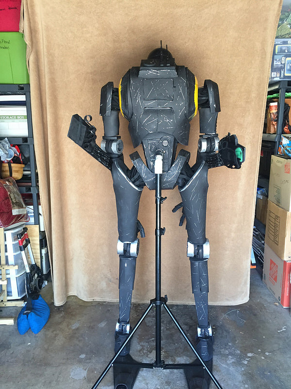

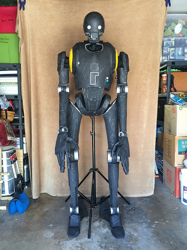

I finished K-2SO at 3:30am the night before. Got 3 hours of sleep then packed him in the car and rolled out.
He's DONE! I packed up K-2SO after a few hours sleep and took him to the Star Wars Reads event in Rancho Cucamonga, California. It's our largest 501st event in the Inland Empire and so much fun. Enjoy the pictures!
Creator standing with creation. All assembled on the staging floor.
He's looking great.
Explaining his pieces to the gathered costumers.

Getting ready for the character parade, about 5 minutes before the neck failed and his head fell 7' 2" onto asphalt. Survived though!

Front

Hand

Abs
Head, you can see the new "weathering" on the front plate from when his head took a fall.
Knee

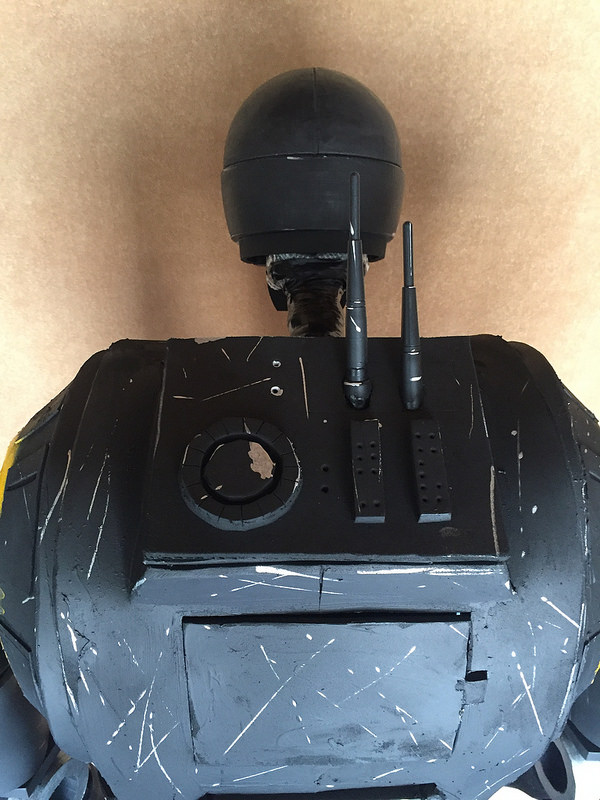

Lower back
Upper back panel

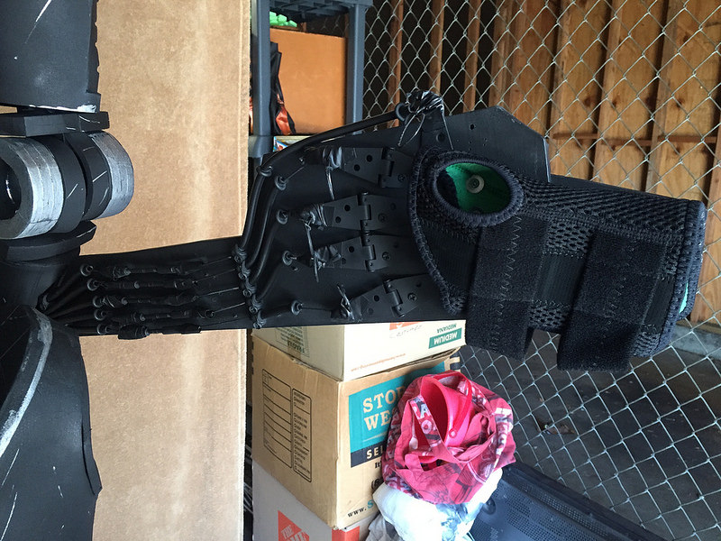

Right puppet hand plate. This one is strapped to my hand for better control.
Left puppet hand plate. This one I can slip in and out of so I still have a free hand when needed.

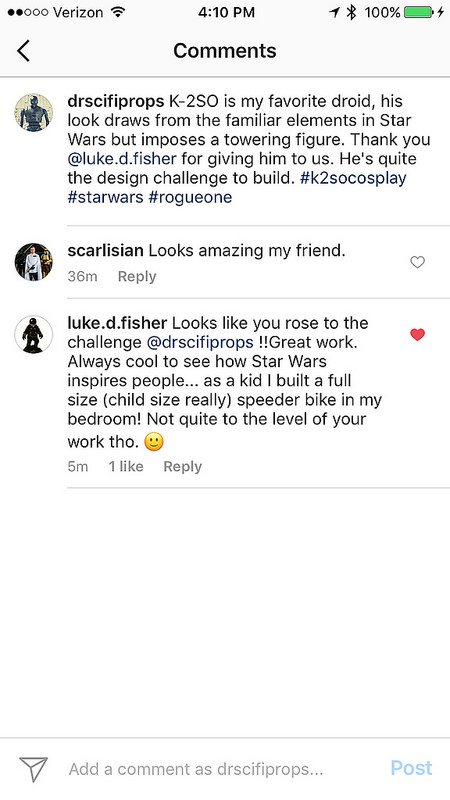

Also, a highlight of the day, tagged Luke D Fisher in one of my instagram posts. He was the designer of K-2SO and often posts concept art and maquette sculptures. Received a kind response back.

Congratulations on a fantastic build !
Great problem solving, documentation and photography. Such a fun build to see come to life !
I just want to borrow it for one night so I can stand it over my son's bed so when he wakes up.....lol :lol:thumbsup
