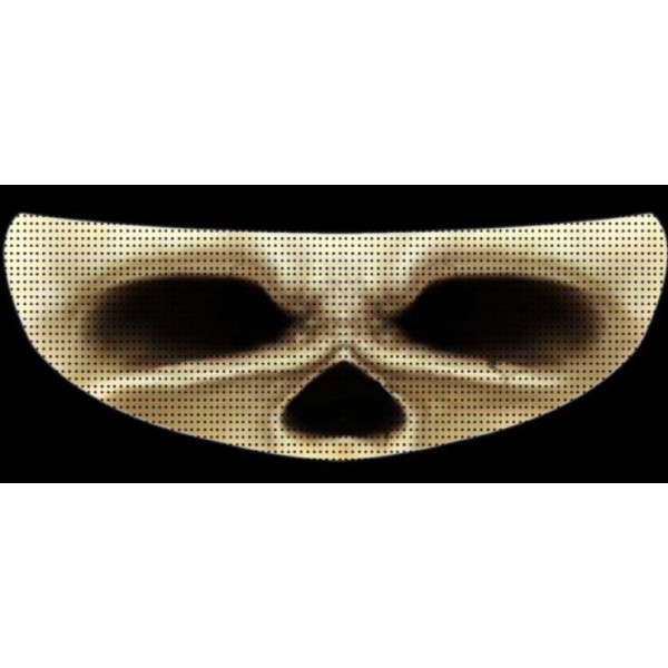

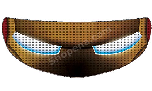

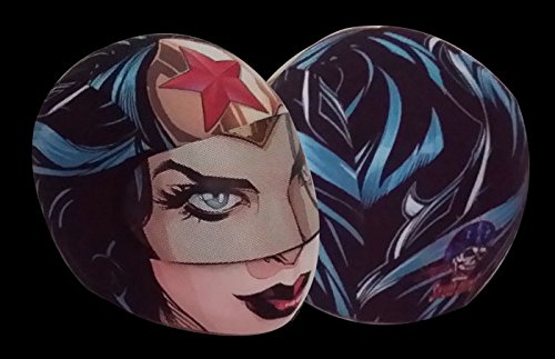

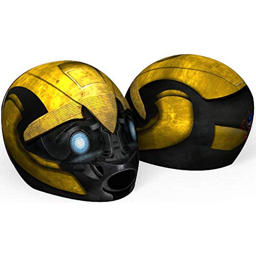

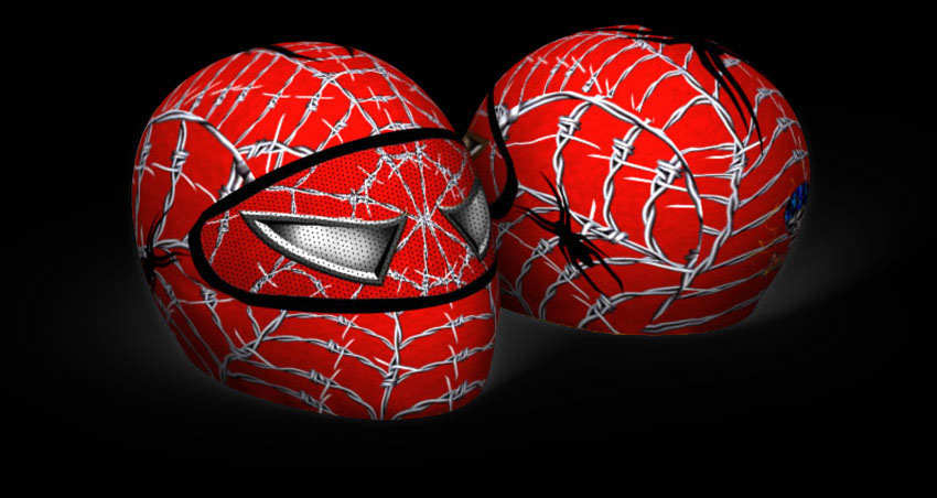

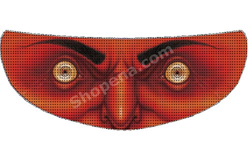

"Now for the eye lenses' visibility issues (which are paramount for motorcycling). We've all seen the faceshields on motorcycle helmets. They are usually either clear or tinted. But....some of them are colored or even have decal like pictures on them with dots, that you can see through with no problem from inside the helmet, but can't be seen through from outside the helmet. If I had this particular DOT/ECE approved helmet, I would take out the existing eye lenses, cut out the portion in the middle between them (that is the cosmetic add on front constructed part of the helmet) and using a motorcycle face shield section that has those dotted decals, that are either gold/brass or bronze colored (preferably bronze) all across the front so I had the same vision forward and peripheral that I would have with a regular motorcycle face shield. I would then mask that (say bronze) face shield off around the shape of the eye lenses, and then remove the dots from that area. Then when I was done, it would look like I had eye lenses like came originally with the helmet and the rest of the area of the front, would look bronze outside the helmet, but I could see through that area (where the nose is and beyond) just as good as I could through any standard motorcycle face shield. Understand what I mean?"
To expand upon that even more, here's some pictures and more explanation of how the Rocketeer helmet lenses can still APPEAR to be like the individual eye "goggle type" lenses to anyone OUTSIDE the helmet, but the person IN the helmet, in reality has an entire face shield they can see forward and to the sides throughout the entire face shield just as if there were no decal there on the face shield. You would have to cut out the front area of that Rocketeer helmet between the original front part's Rocketeer goggle lenses, and install an all across the eyes front face shield that has the dotted decal on the face shield and that decal would look like the original Rocketeer individual goggle lenses plus the bronze area between those lenses.....to anyone outside of the helmet looking at the helmet, while the wearer would have the whole face shield to look through. See my photos of motorcycle helmets that have that dotted decal on their face shields and decals available to put on face shields to see what I mean. The online ads for these types of helmets and their face shield decals say that depending on the helmet, the dotted face shield decal, MAY (but not necessarily) decrease a person's vision at night or in snow by 5%. But that same 5% decrease (sometimes, not always, depending on the helmet and the person) in vision also happens if you just get a tinted face shield anyway. That same technology used via the dotted decals on the motorcycle helmet's face shields, is also used on windows to that the people inside the home can see right through it and not see the decal, but anyone outside the home can't see through the windows and only sees the decals.

I hope my expanding upon what I wrote earlier and the pictures I've included, helps to better explain what I was writing about. Click on my below pictures to enlarge them and to see the dots in the decals that from inside the helmet's face shield you don't see and can see right though, but anyone outside the helmet only sees the decals. Thus from outside the helmet it looks like the original Rocketeer's individual eye lenses and the bronze metal between those lenses, but from inside the helmet, the wearer can see through the entire face shield. Just like the face shield decals you see in my included pictures.

  • SkullSkins-Red-Devil-Universal-Full-Face-Motorcycle-Helmet-Windscreen-Graphic-Visor-Tint-Shiel...jpg

I think your idea is an interesting one. You have, obviously, made your research and your experience as a rider is another + (y)
Love that you'll have some sort of integral helmet but with the optical illusion of a "face-shield-visor" that will reproduce the look of the Rocketeer helmet. You were also mentioning a type of soft fin. Maybe it could be made in solid rubber, so every time your head would turn, the major surfaces of that fin would bend/collapse with the wind pressure. Or, securing the fin with springs (a little bit like a saloon door), so it can collapse on either sides when turning your head?
