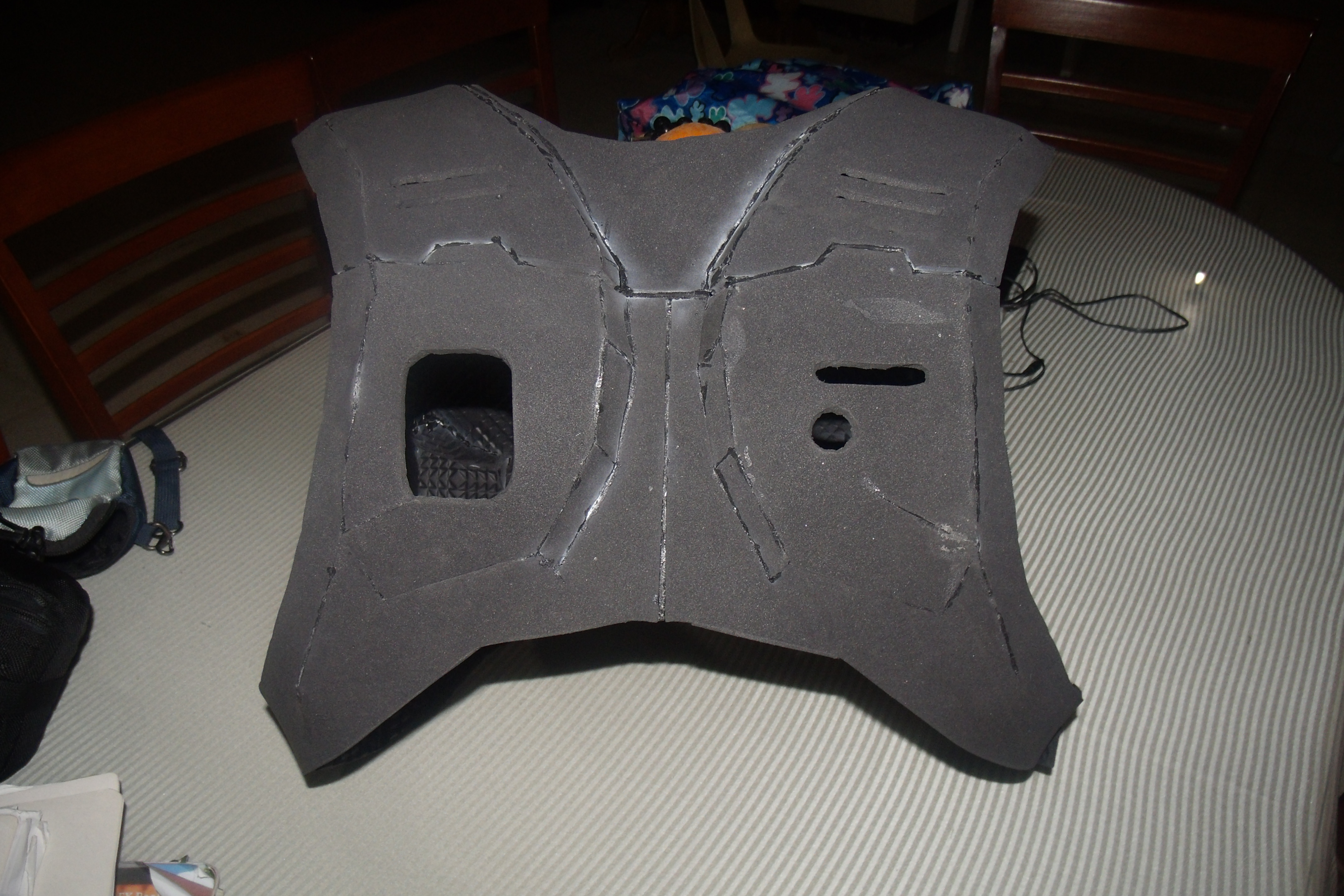

My armor progress on the helmet and chest piece care of Laelee's foam files:Image1447.jpgGEDC0373.JPGGEDC0373.JPG
Will post more as I progress. We finished the chest piece with all the details but I did'nt take a pic as we were still tweaking. Started on the gloves too. Like Stealth, we deviated and started some "original" designs and methods such as the gloves (pics later) and the hinged helmet:GEDC2259.JPG
