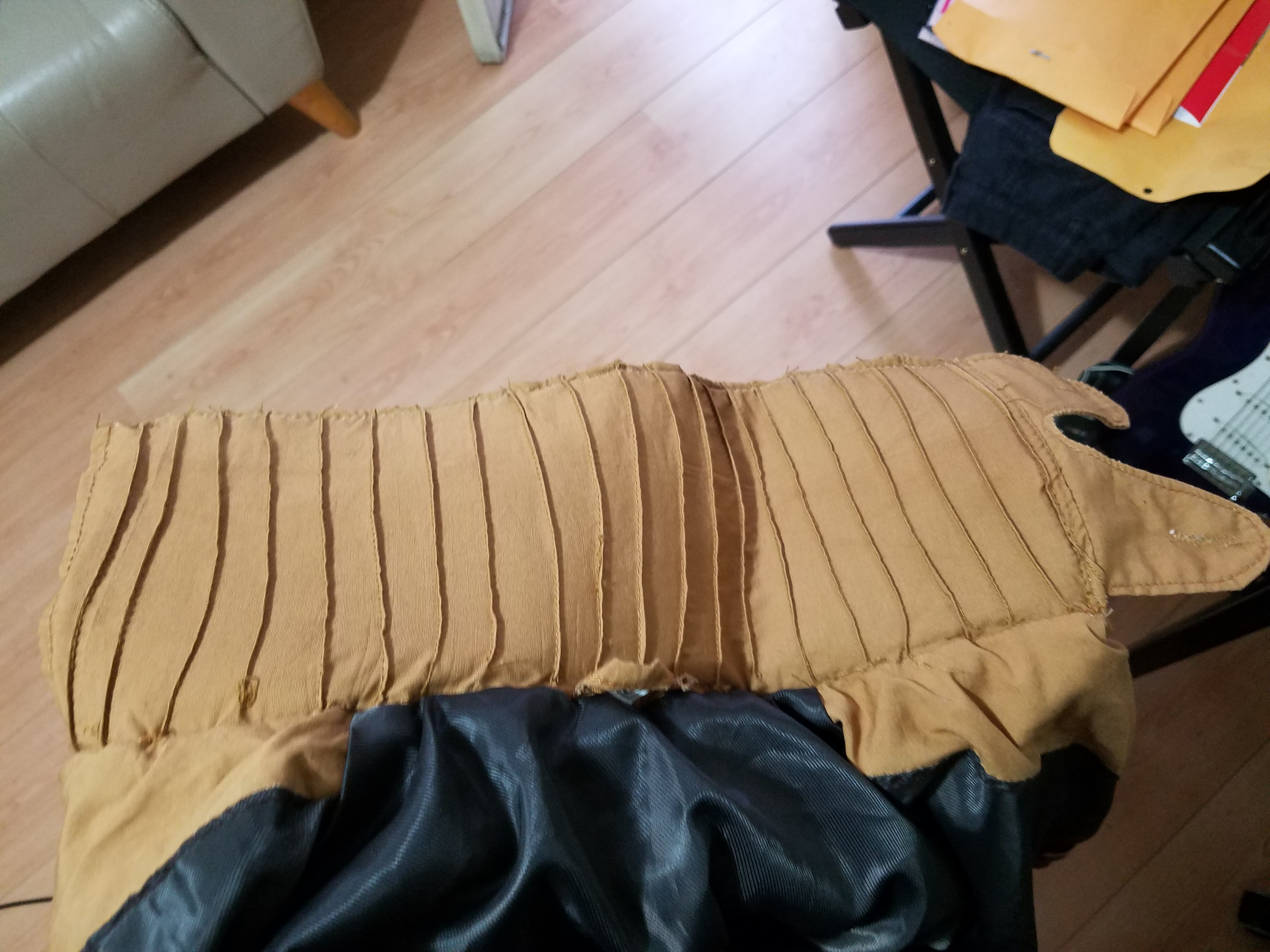

This is what I have to work with lol. Should I just remove this and start from scratch or remove the seams he made? 20170826_185709.jpg
Whoa....Sorry, that's not cool. They went pleat crazy....very weird. Your really gonna a seam ripper for that and a beer.
I'd try and pick the stitches out and see how the fabric held up. If looks pretty good, then just iron it, block it/reshape it and start again....but you will definitely need extra fabric for the top quilted piece....just the collar it came with is not enough and one reason why its not accurate to the screen version.
If the fabric just couldn't stand up to what looks like pretty tight stitching...which it may not have - then yup you'll need that extra fabric and start from scratch.
Also, if the patterning is correct and how you wanted it then save the pieces so you or the next person you have work on it can draft the pattern from the existing pieces. Tho, from what i can see - it look like a rectangle with no shaping to it that wont, in the end, lay like a collar should....tho that could just be cause it so puffed up or whatever.
And do not go back to that person....unless it free...and then, buyer beware.
Good luck!
