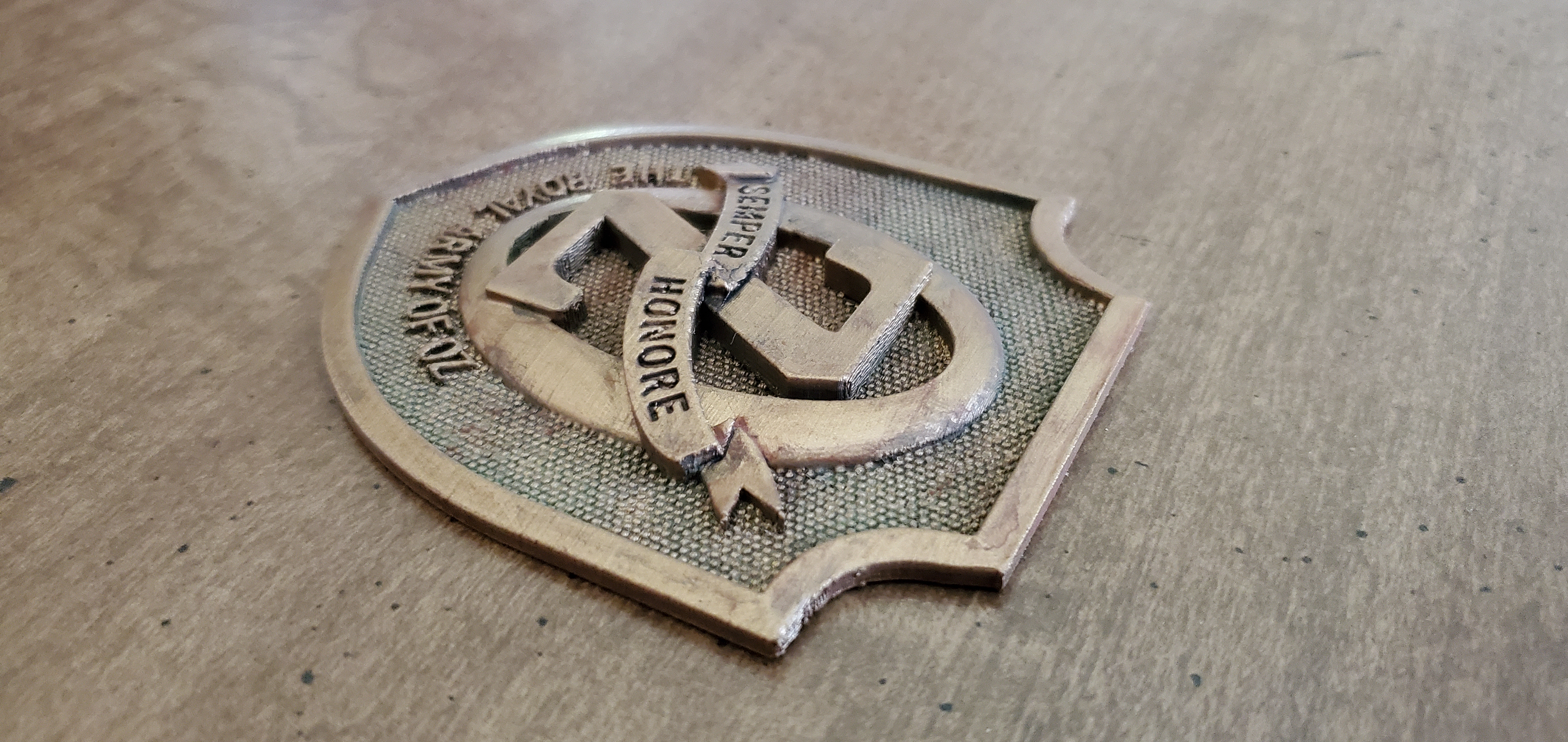

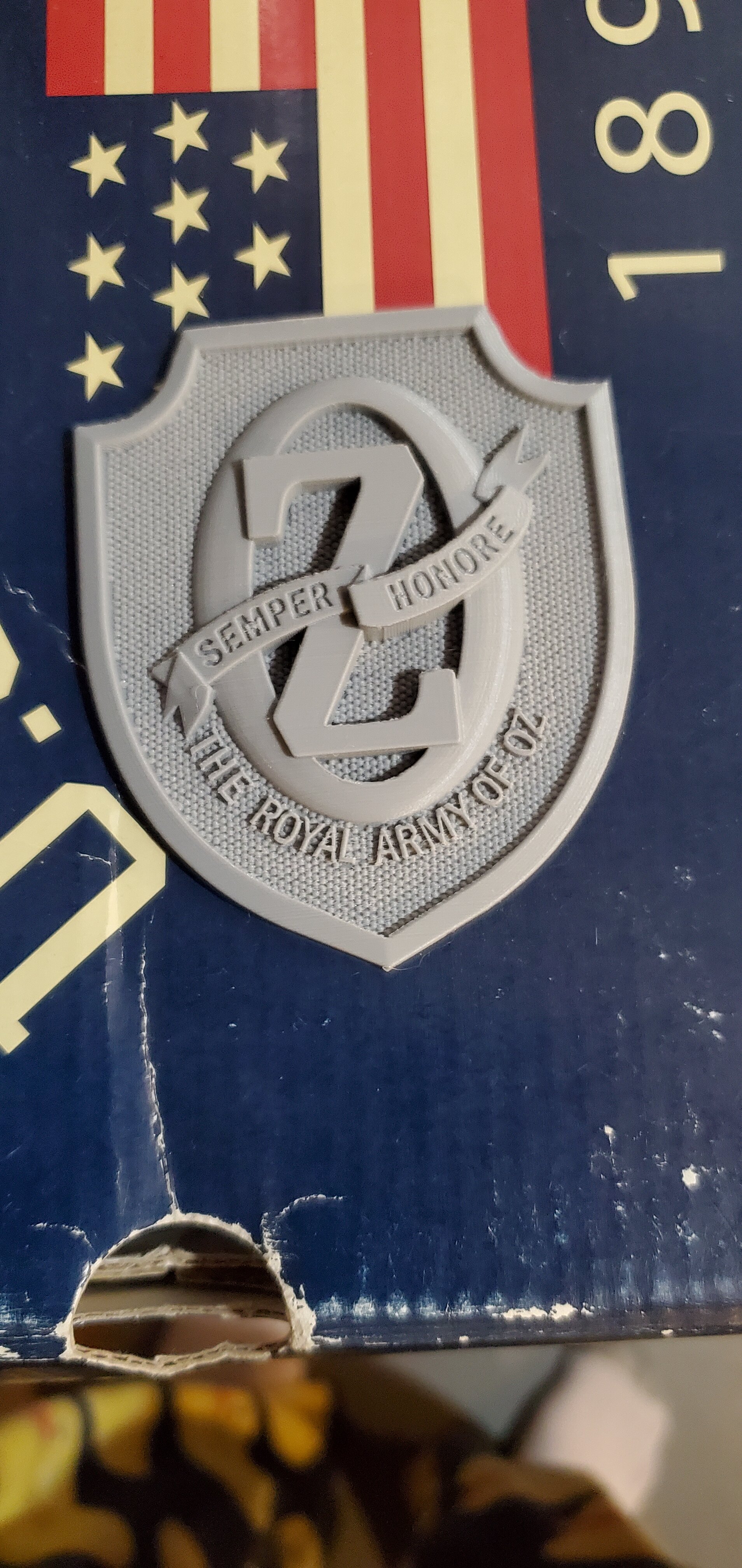

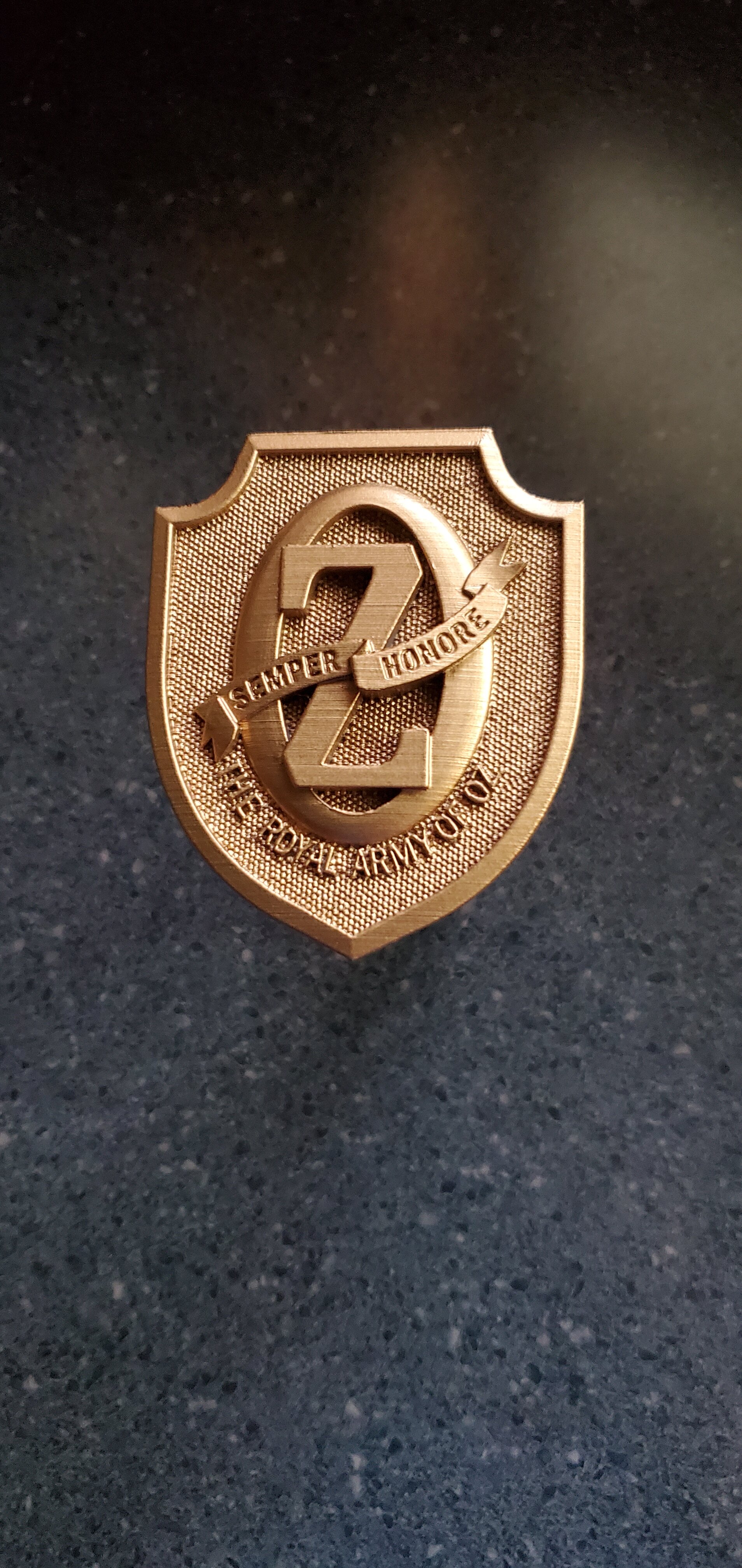

Tik Tok's Royal Army of Oz Chest Emblem
It's been a bit, but another update for you all of the newest addition to my collection. My daughter is currently 7 months old, so progress on basically everything is slow going at the moment. On Tik Tok's chest, right over where a human heart would be, is a presumably solid metal (copper) emblem indicating that he is a member of (or the only member of) the Royal Army of Oz.
According to Google Translate, "Semper Honore" means "Always with Honor." A very fitting slogan for a dedicated protector of Dorothy and friends.
As with virtually all things I can lay my eyes on in this movie, it has always captured my interest. The big O and Z, reminiscent of the Key to the Old House / Tik Tok's room and the old, patinated metal look.
They gave out metal casts off of hero emblems upon completion of the film as crew gifts, which occasionally show up on ebay for a few thousand dollars. These are shiny and new, being based on the end coronation scene, when Tik Tok is all shiny and polished himself. I'm not a fan of this look. Not only am I not able to afford it, but don't like the new appearance, and the castings are pockmarked with airholes and sloppy errors. See the lettering in "semper" below.
I found and purchased an excellent 3D model on Cults 3D, and printed it out. I found the precise dimensions in one of the above mentioned ebay listings of a crew gift version (same size as hero) to be 8.5 cm tall by 7 cm wide. The depth is unknown, but I did 1/4" at it's highest. Mixing measurement units, I know. Too bad.
Here is the printed emblem before any finishing work.
And spray painted. I used this Ace Hardware Metallic Antique Gold spray paint I had left over from my DaveP Luke Hero Saber paint job.
And weathered to be more like old metal. I could not seem to get the lighting correct to actually show off the weathering in the photos, but it definitely is there. Sage Green, Burnt Sienna, and Black acrylic paint washes got it where I wanted it. This will be the paint scheme of my next few posts...

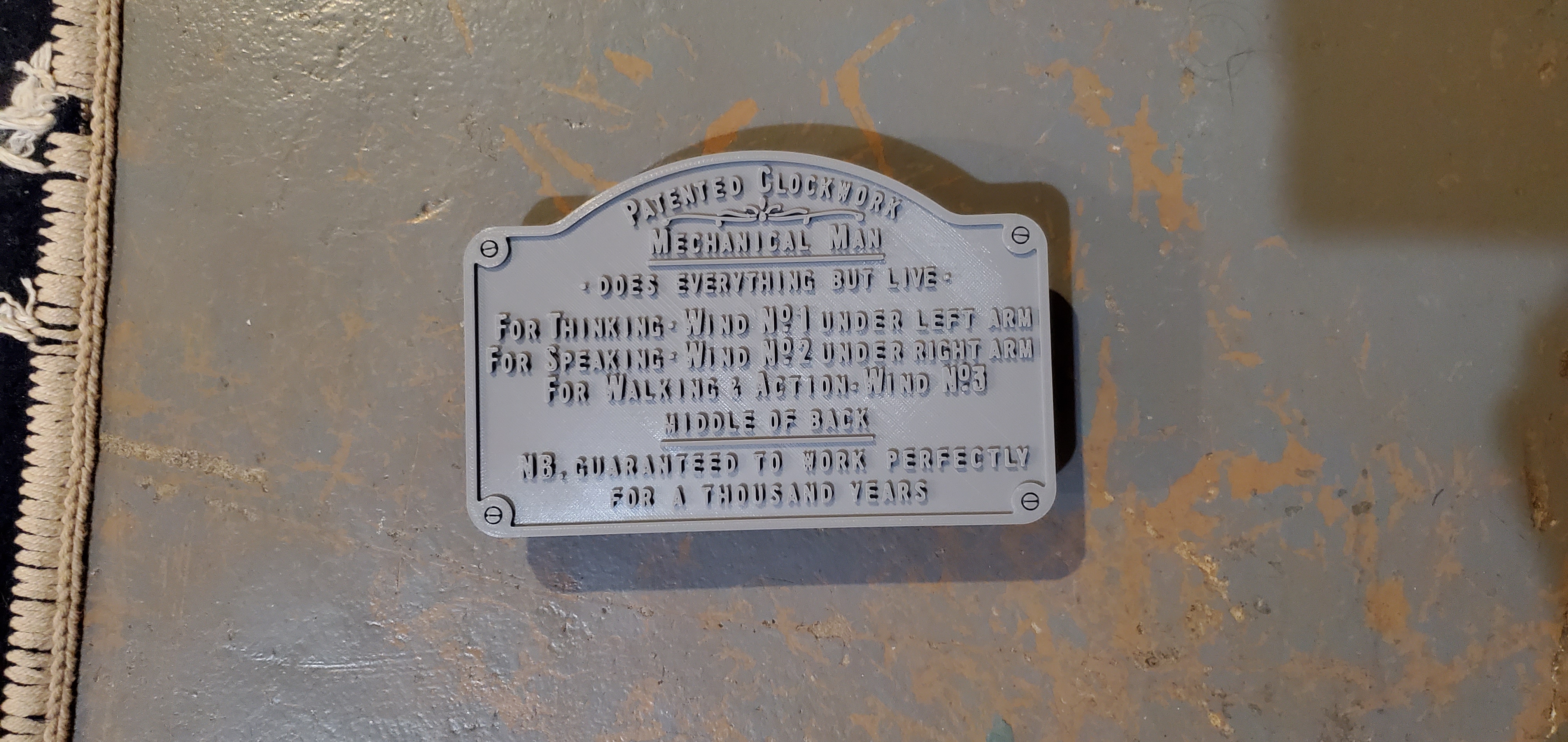

Tik Tok's Operating Instructions / Backplate
Next up on the agenda is the plate that is screwed onto Tik Tok's back, informing the user how to operate him- where to find the keys on his back to wind up his thinking, speaking, and action. These were cast in metal, and POSSIBLY given out as crew gifts. I'm seeing conflicting information online about that.

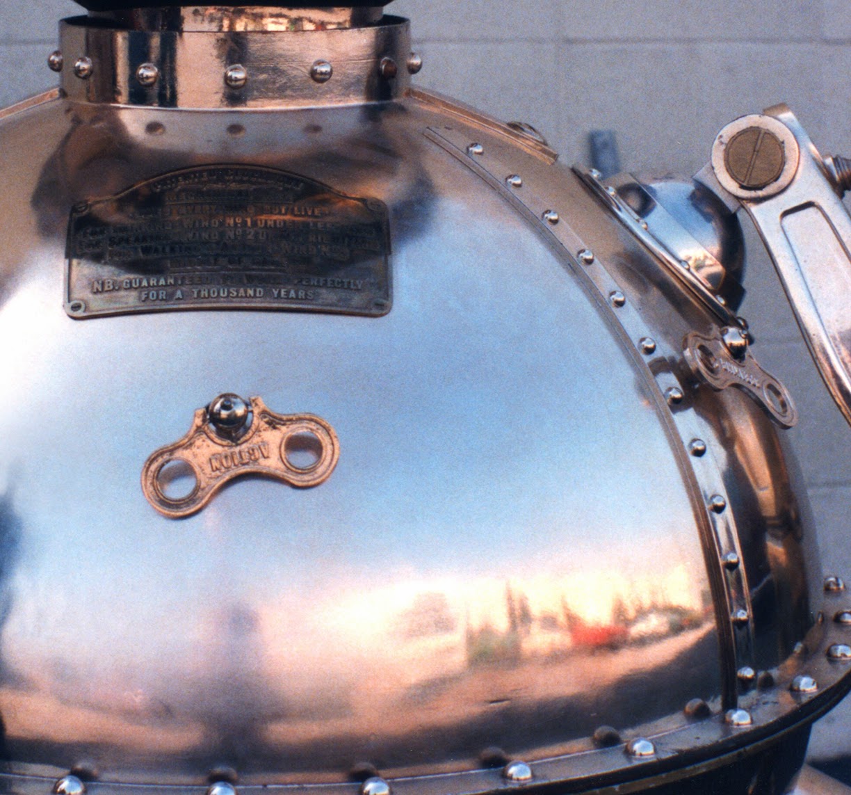

Here is an unknown photographer who had the wonderful foresight to include a ruler next to the plate, seen mounted to the shiny coronation scene version of Tik Tok.

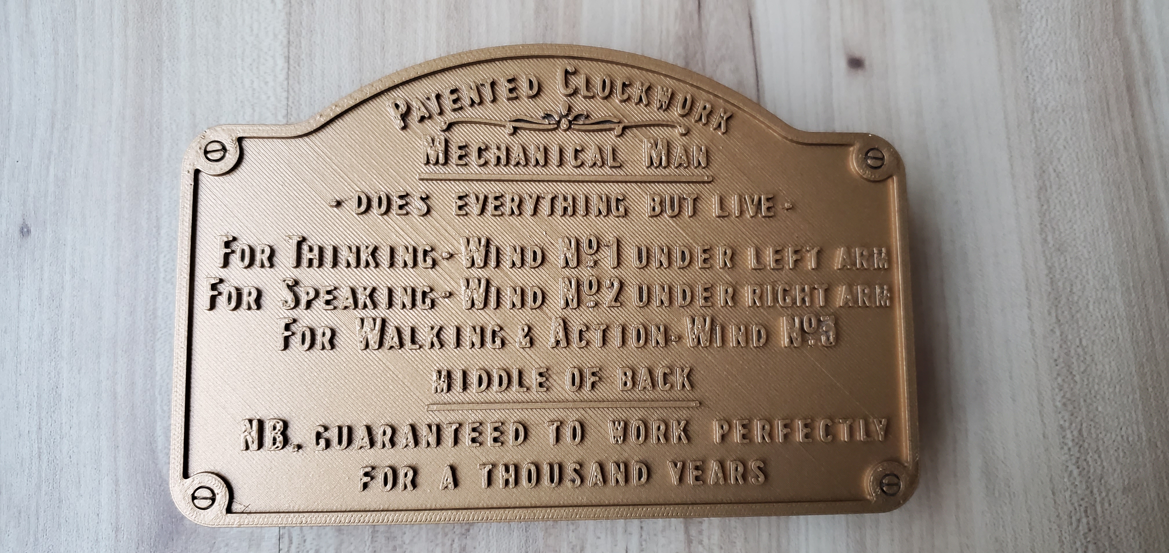

6.5" wide, and 4.25" at it's highest peak in the middle. Maybe 1/8" thick. Using this next picture, you can see that the plate itself is curved to sort of match the curvature of Tik Tok's spherical body. It doesn't quite look like it is a perfect curve, as there appears to be a bit of a gap in the middle between plate and body, but close enough. I don't think a shadow explains ALL of that dark area.

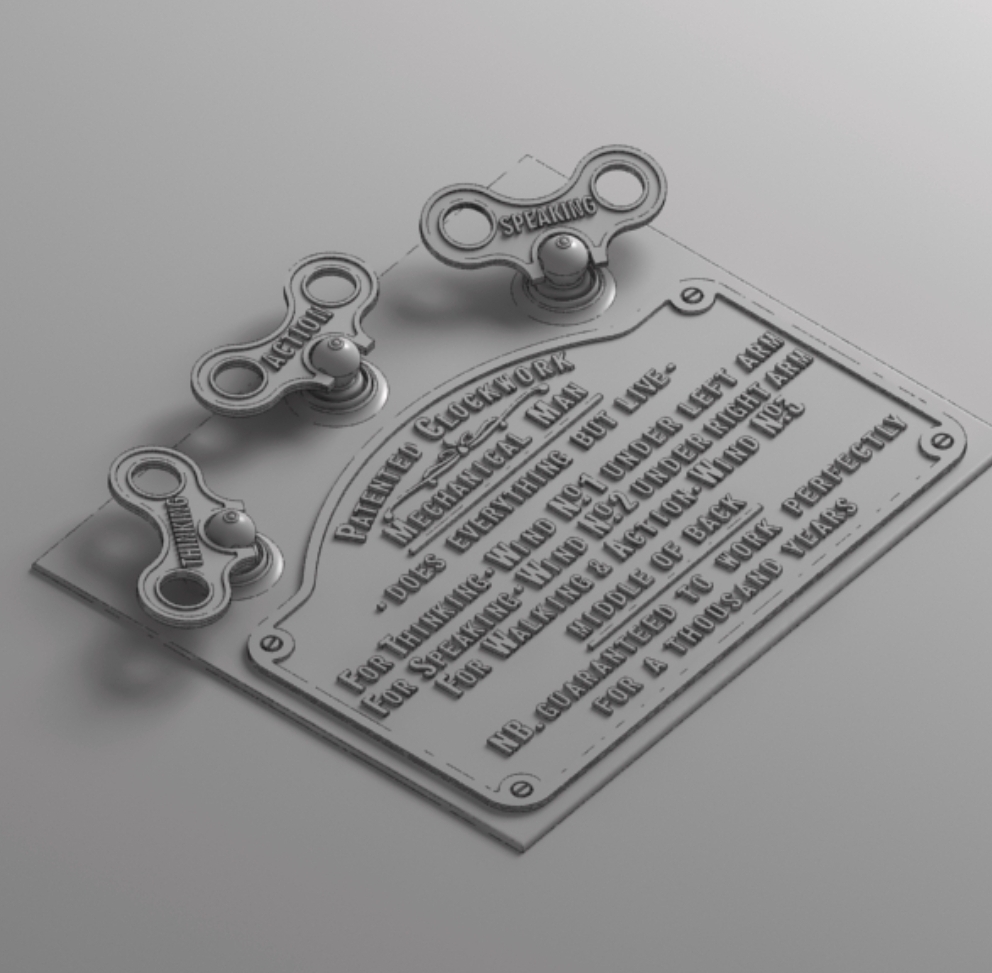

As with the Royal Army emblem, this 3D file was also found on Cults3D. It's not a super perfect match, but it gets the job done. Minor adjustments would be nice- font is subtly different and spacings primarily. I still think it's a good model, though.
Here's hot off the printer
And base coated. Same as before- Ace Hardware Metallic Antique Gold spray paint.
And weathered. I like the look of this shot and coloration the best, so this was my inspiration.
Sorry, but again- photography is not in my wheelhouse, and I can't seem to take pictures that look like real life. But this is my final result. Gold, burnt sienna, and sage green acrylic paint gave me the patinated copper look I wanted.
Some day when I learn how to make sand molds, I would love to cast this in actual copper. Hopefully someday, but this will look great on the shelf until then.
Always loved this guy! One more piece is complete.

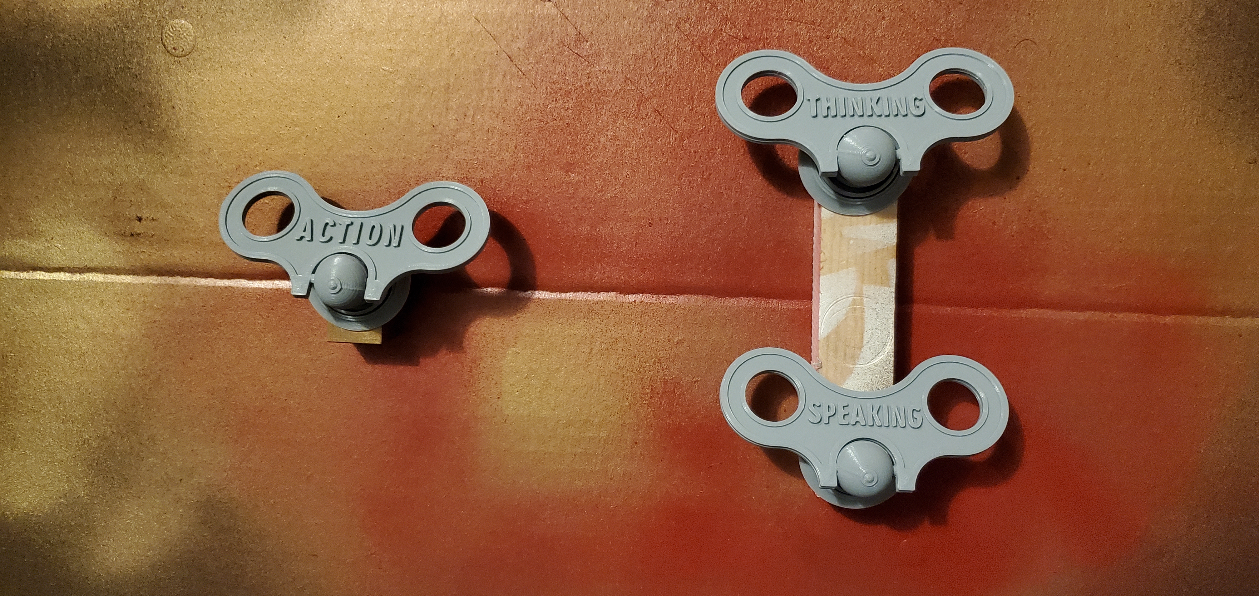

Tik Tok's Winding Keys
Hot on the heels of his operating instructions, we have Tik Tok's winding keys. Thinking under left arm, walking / action middle of back, and speaking under right arm.
oz tik tok thinking key.jpgoz tik tok action key.jpgoz tik tok speaking key.jpg
Another big shout out to the unknown photographer who had the foresight to include a ruler to make a measurement against. The keys are much bigger than you may initially think, at about 3 7/8" wide, making the height about 1 7'8" tall, for the key part alone. The mounting and pivot point adds about another 1". They are double sided, each side being identical.
This was another Cults 3D file- these keys and the backplate came as 1 file. They did need drastically resized- if you assume the file is correct, they print out comically undersized, about 1" wide, or thereabouts. Each key prints in 6 pieces, and needs to be glued together. I'm really happy with how these turned out. Kudos to the model designer.
Same drill. A before shot, but not spray painted shot, as I forgot to do so. Oops, but nothing really new to see if you've been following along.
Same paint scheme. Sprayed Antique Gold, acrylic black, burnt sienna, and sage green to match my previous Tik Tok parts. Again, didn't want shiny, and prefer the used look.

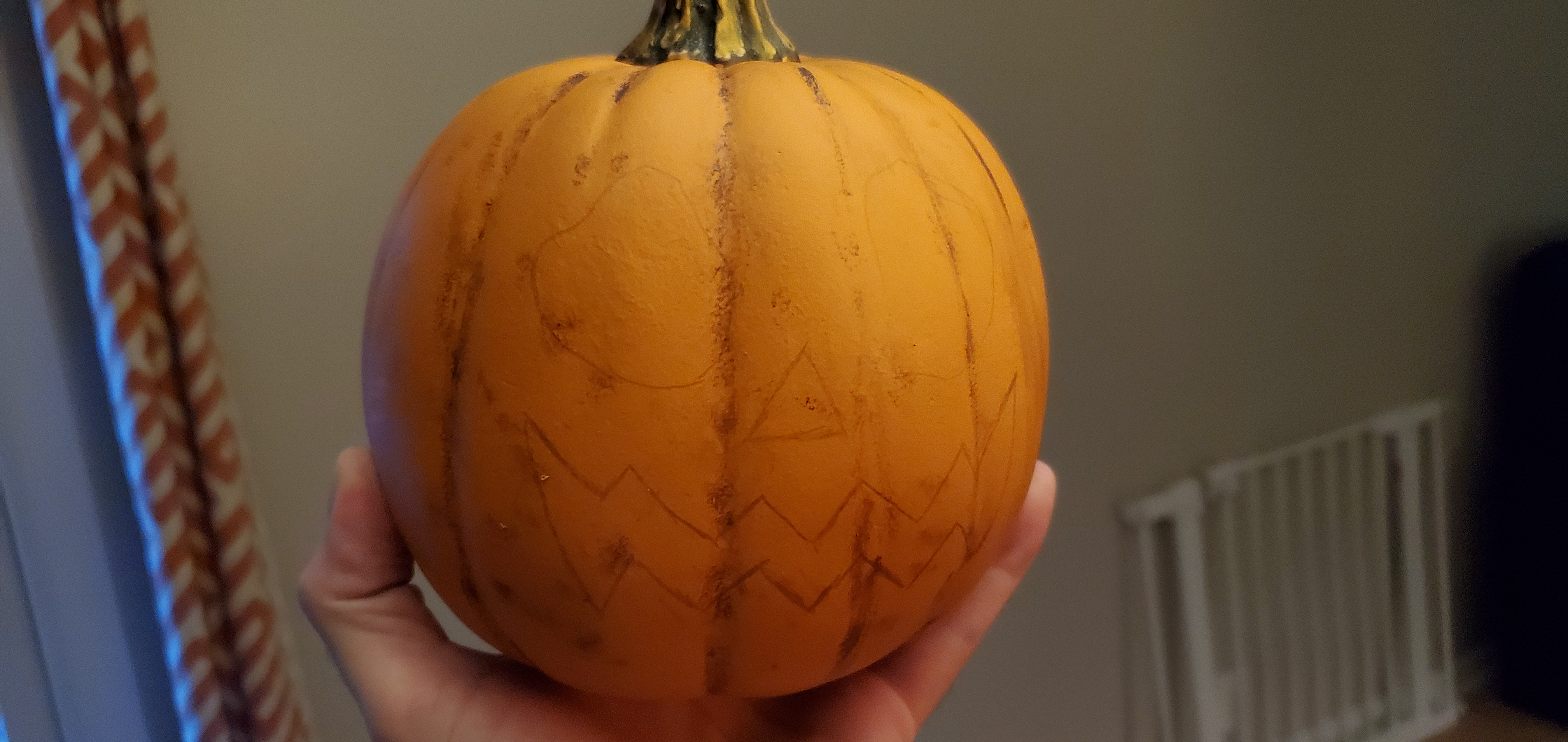

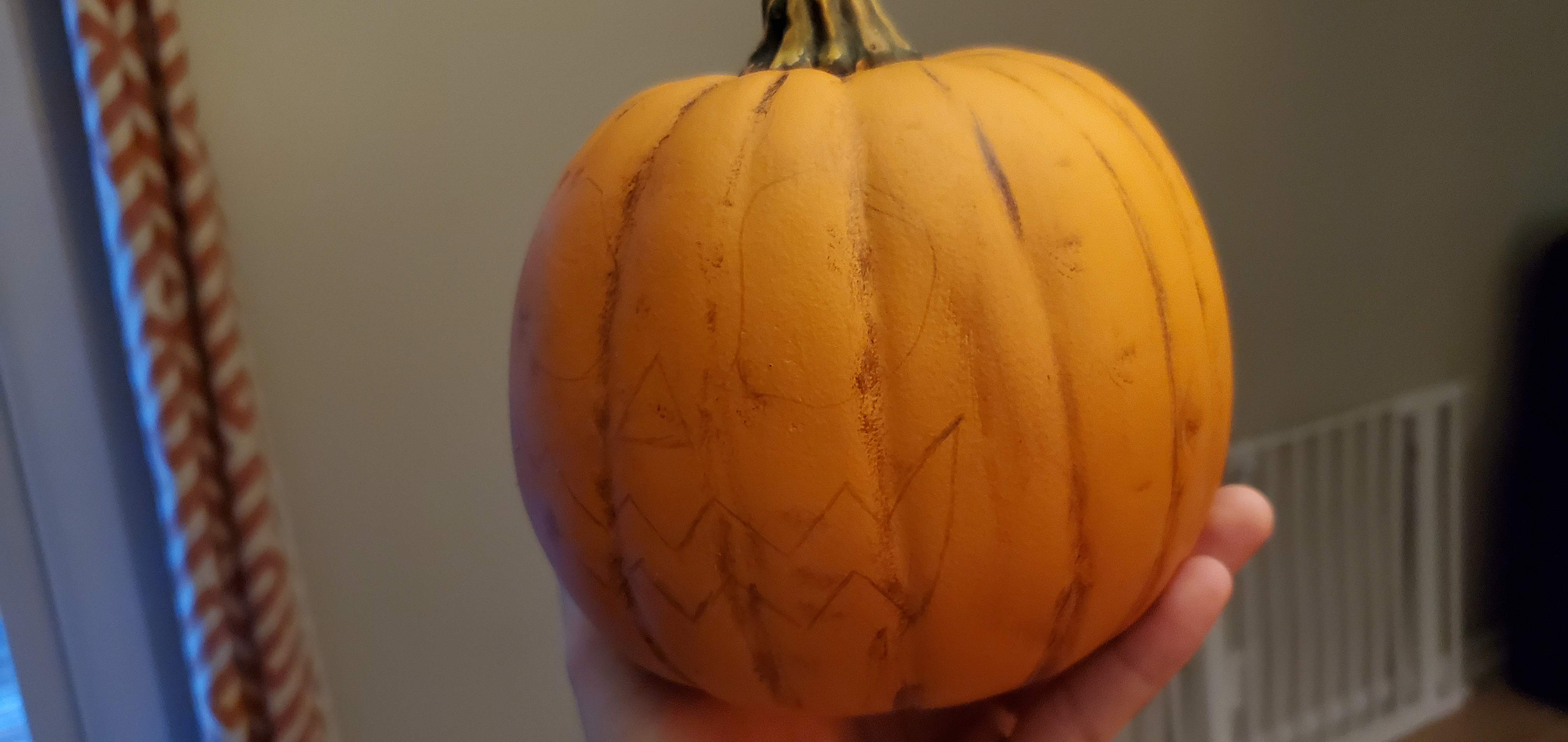

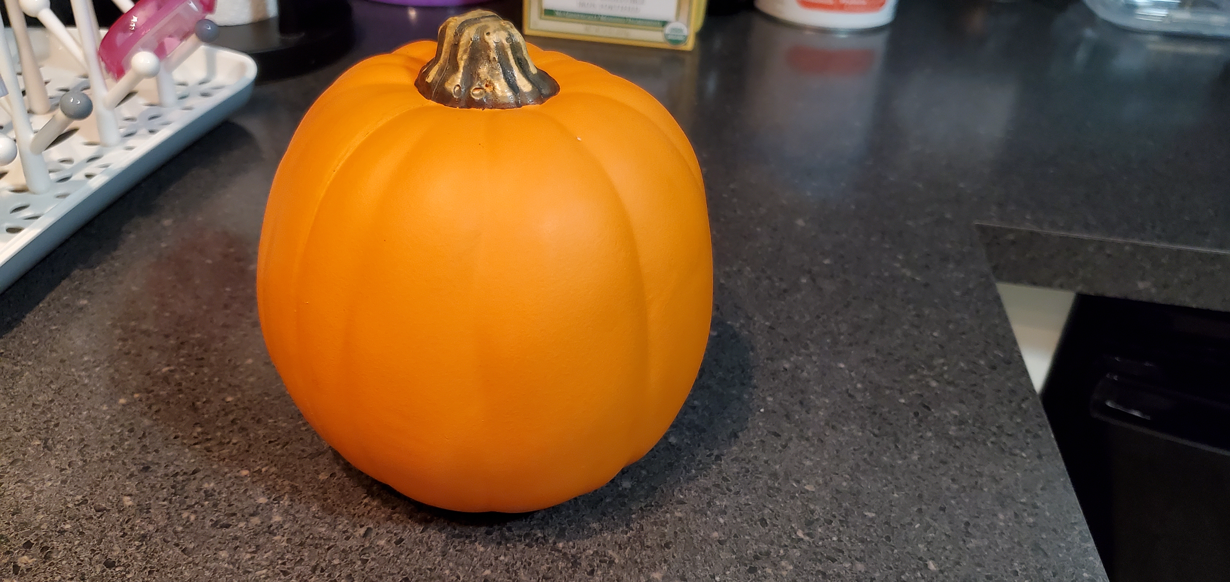

Seemed like a fitting candidate for my next build. So I got one of those hollow craft pumpkins from Michael's, on sale of course because of the season. Ashland brand, about 6" tall and 6" in diameter, this was the closest I could find that seemed to match what we see on screen. It's a very dense foam like material, but not actual styrofoam. The original was possibly (?) a real pumpkin, since it's only in a few shots. But then again, there is that above prop display. So I'm not sure.
Here it is in all of it's obviously fake, almost cartoon-like glory. Much too consistent looking for me.

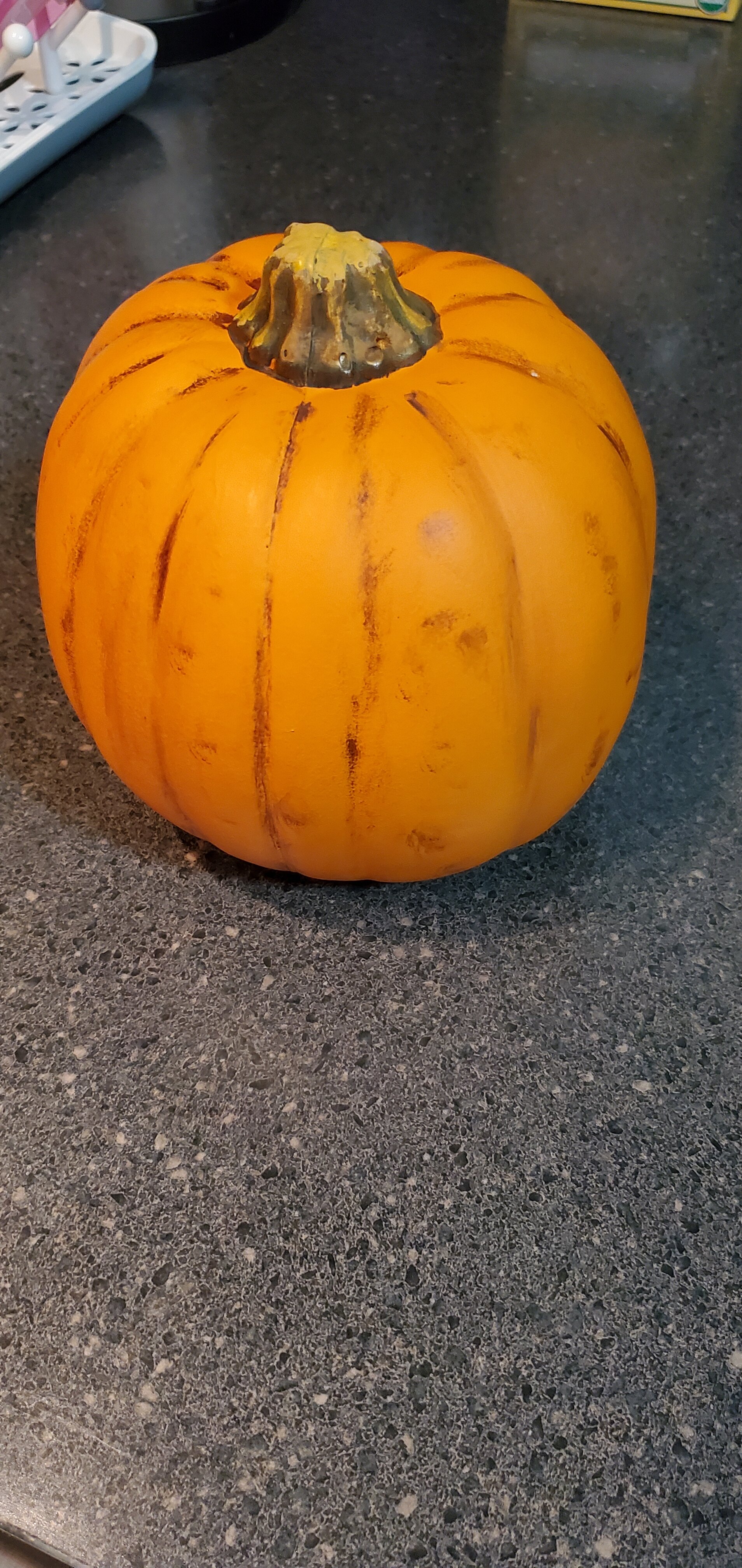

So I weathered it up a bit to look more like the real deal. I used primarily burnt umber and "cafe mocha" acrylic paints for the vertical lines, and cafe mocha again, along with antique gold and medium flesh for the stalk. Much better.
Then using my reference images (not all shown here) I penciled in the face. It's a good thing that pencil erases pretty well on this surface, because I had to redraw that miserable mouth too many times. But I got it to a point where I was satisfied. There are 5 teeth on top, and 4 on the bottom.
Carving time! Some places online claim you can use actual pumpkin carving tools on these, but after a test, it leaves the edges too ragged. So, I used the method recommended on the tag- use a hot knife. Thankfully, my wood burning / soldering iron has a screw in exacto blade attachment, which worked just fine. The curvature of the eyes matches the screenshots, and I did cut the top lid, as it is visible on screen. I'm showing off in dim lighting, so the lighter colored interior looks more black, like what we see, and not too bright as it would in natural lighting. I don't really want to paint the interior black (since real pumpkins aren't), but it is an option. After a test on the eye pieces, I can confirm that spray paint doesn't melt this dense foam, and brushing on acrylic paint will suck in a lot of paint. But it is possible. Cut the lid and spray inside, then cut the face.
Sure, it may just look like any old carved pumpkin, but amongst the other Oz stuff in my collection, it is undeniable that it belongs there. Another satisfying prop project. Propject?
