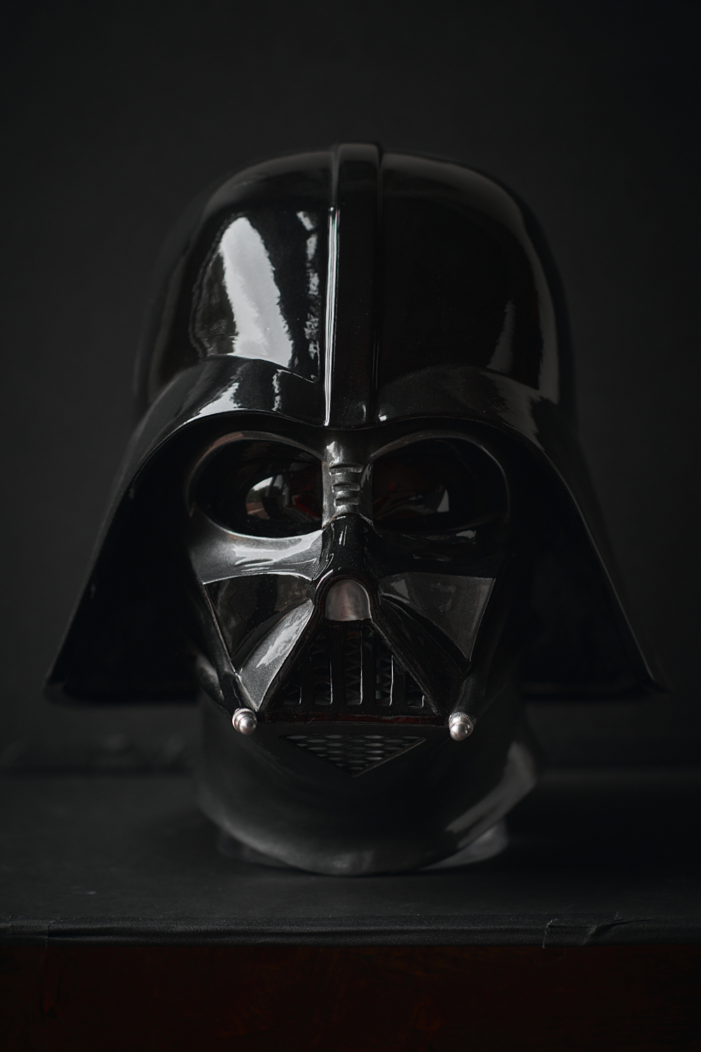

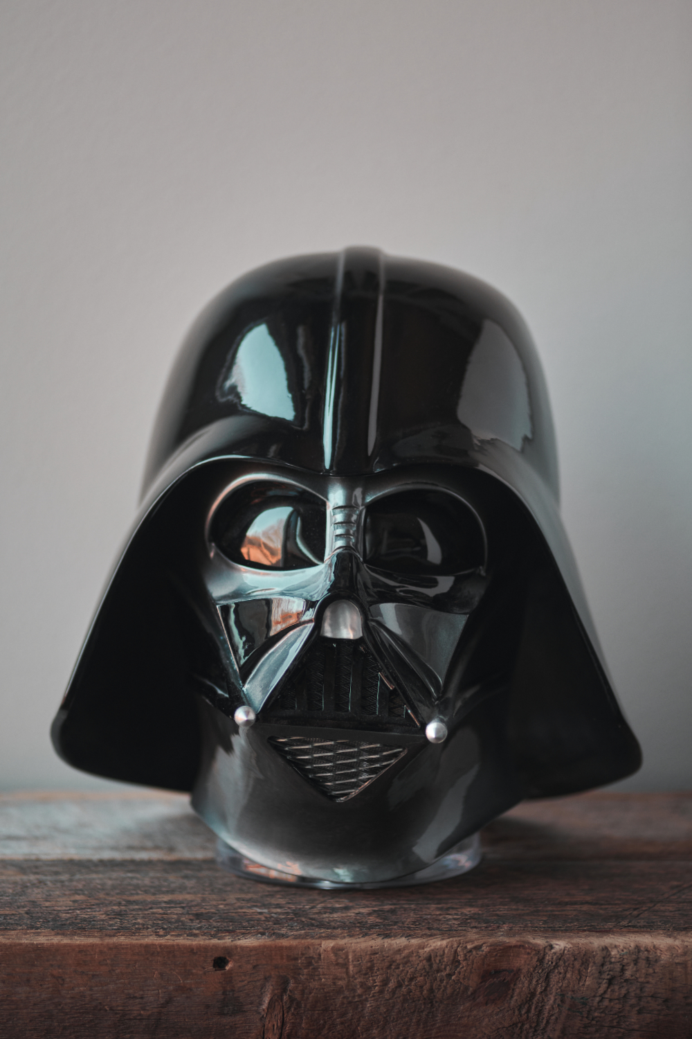

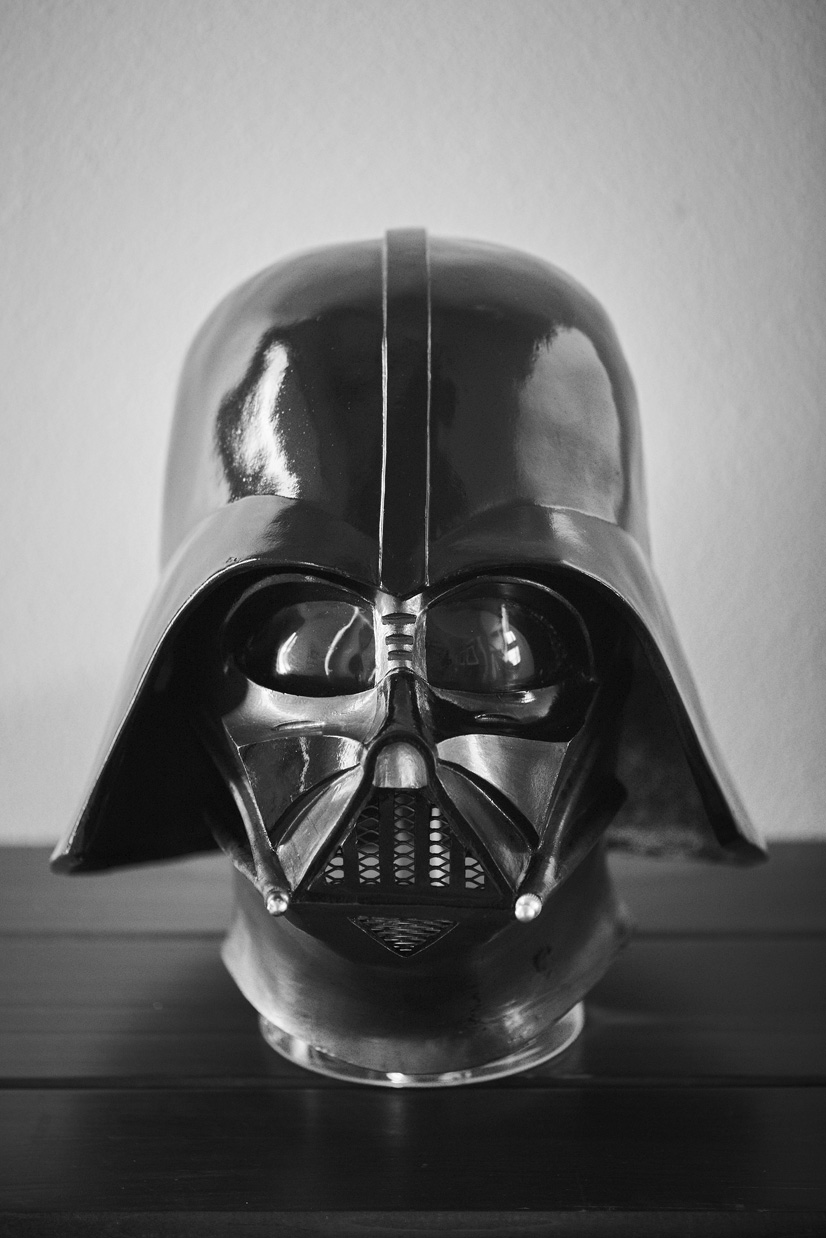

I'm a photographer, and I've photographed numerous lineage Vader and Star Wars helmets. That dome warping isn't a lens trick.
To get a good non-distorted vader helmet portrait, you need to be at least 6 ft from the helmet, with at least a 50mm lens. An 85mm lens from at least 6-8 ft would be best.
TM ESB
SL ANH
TM ANH with an EFX Dome (below), has a flared neck.
GH ROTJ
There were just diddling around with my camera and lenses from 6-8 ft from the helmet, next to a large window.

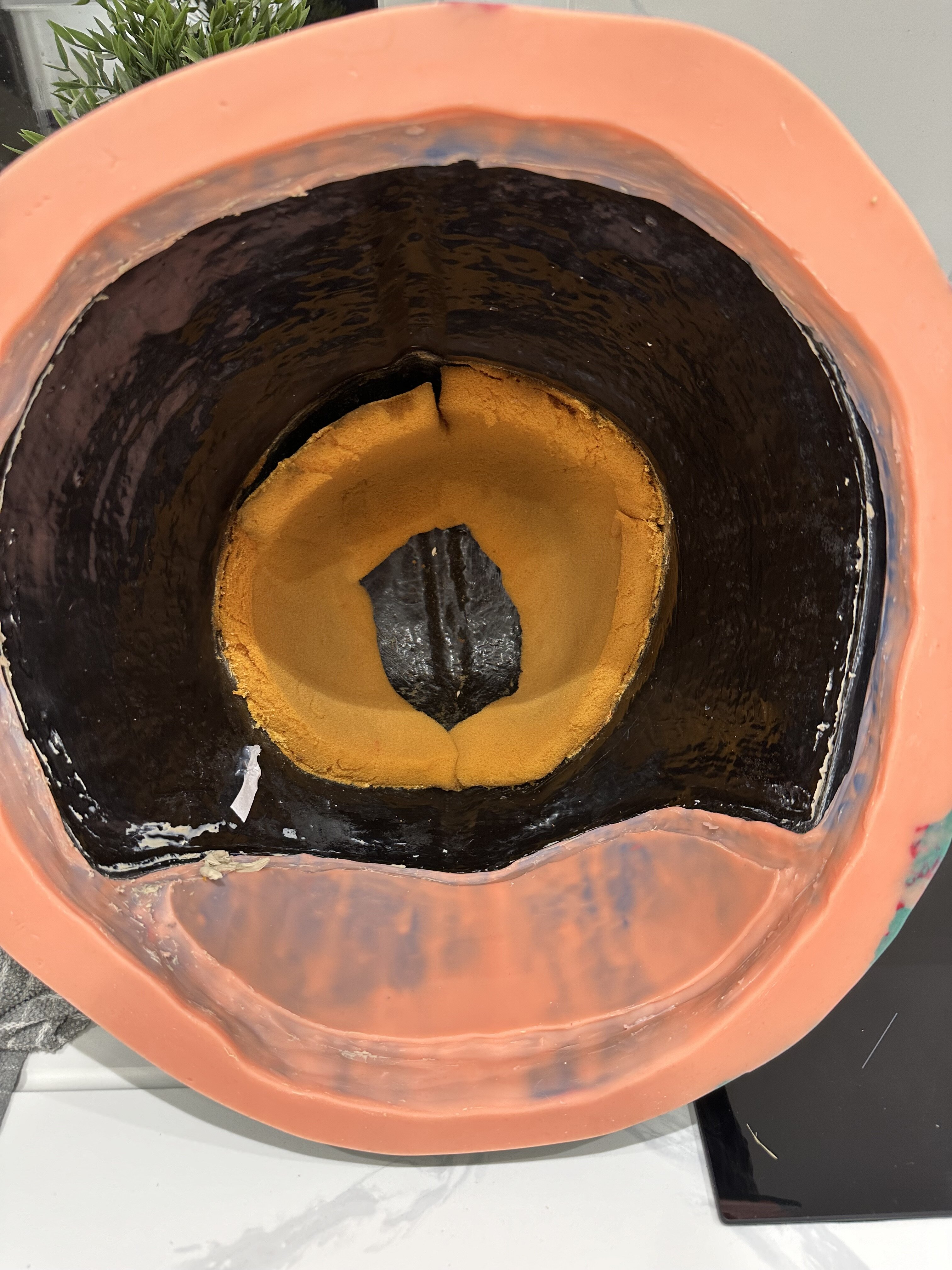

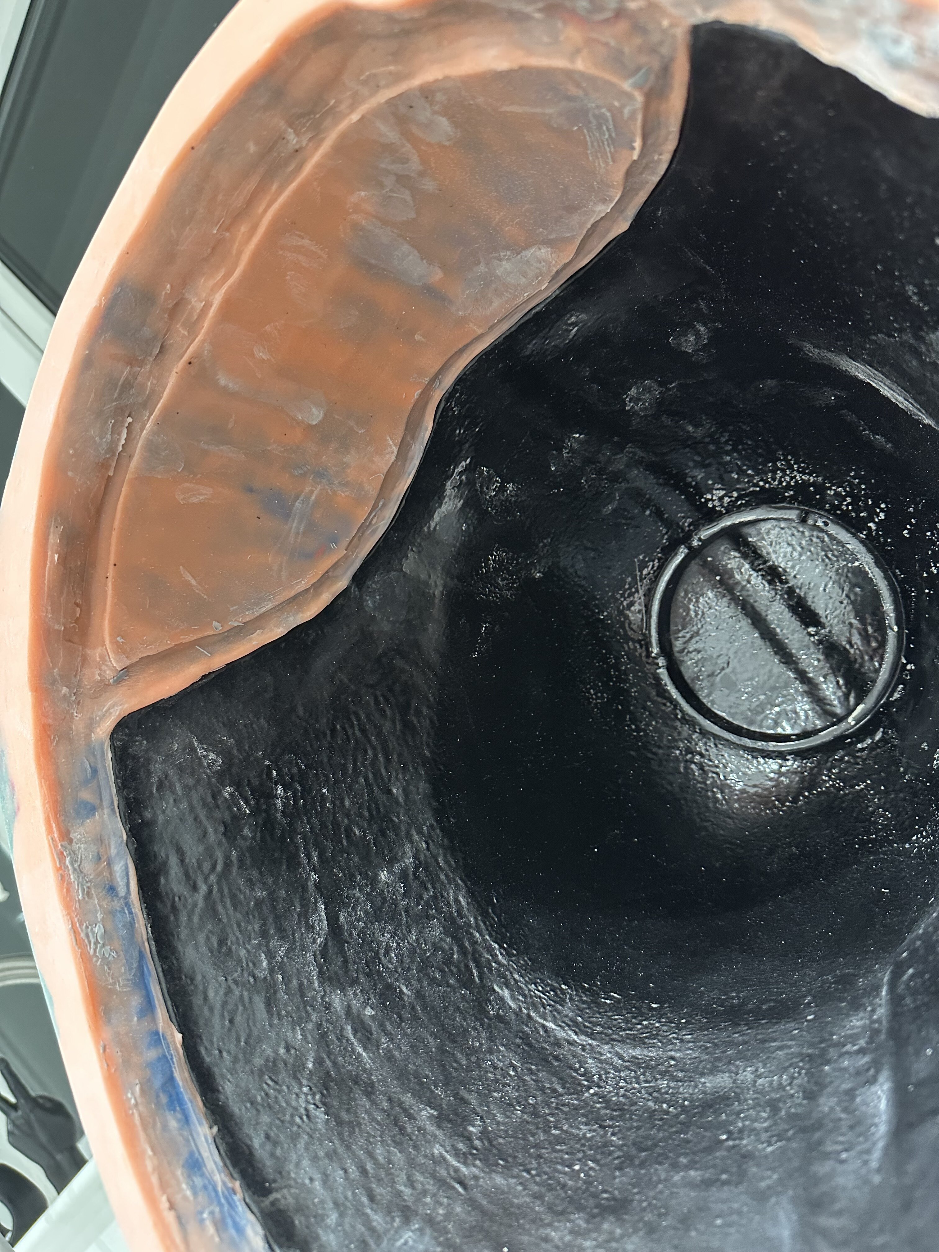

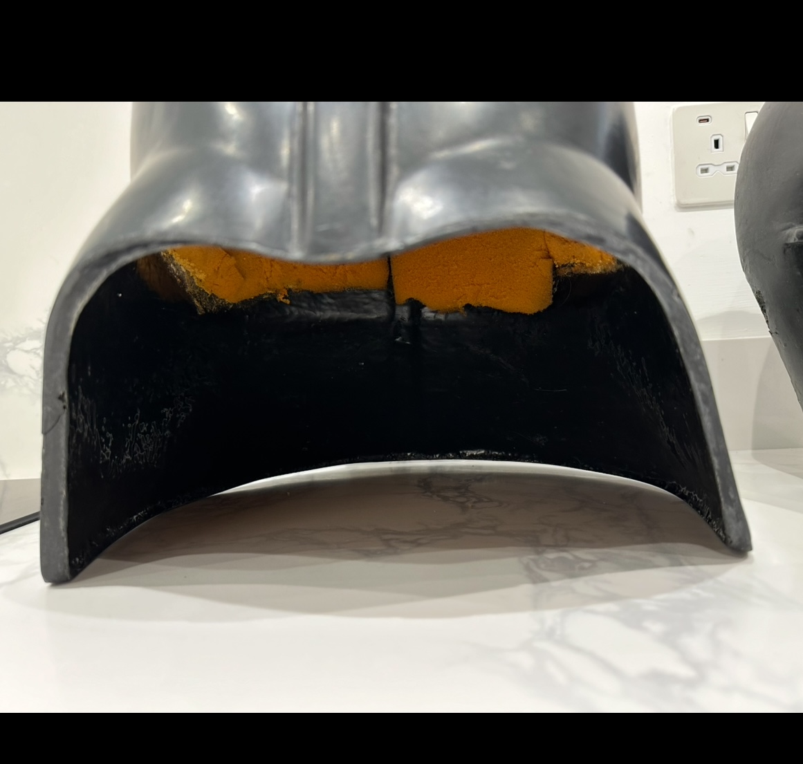

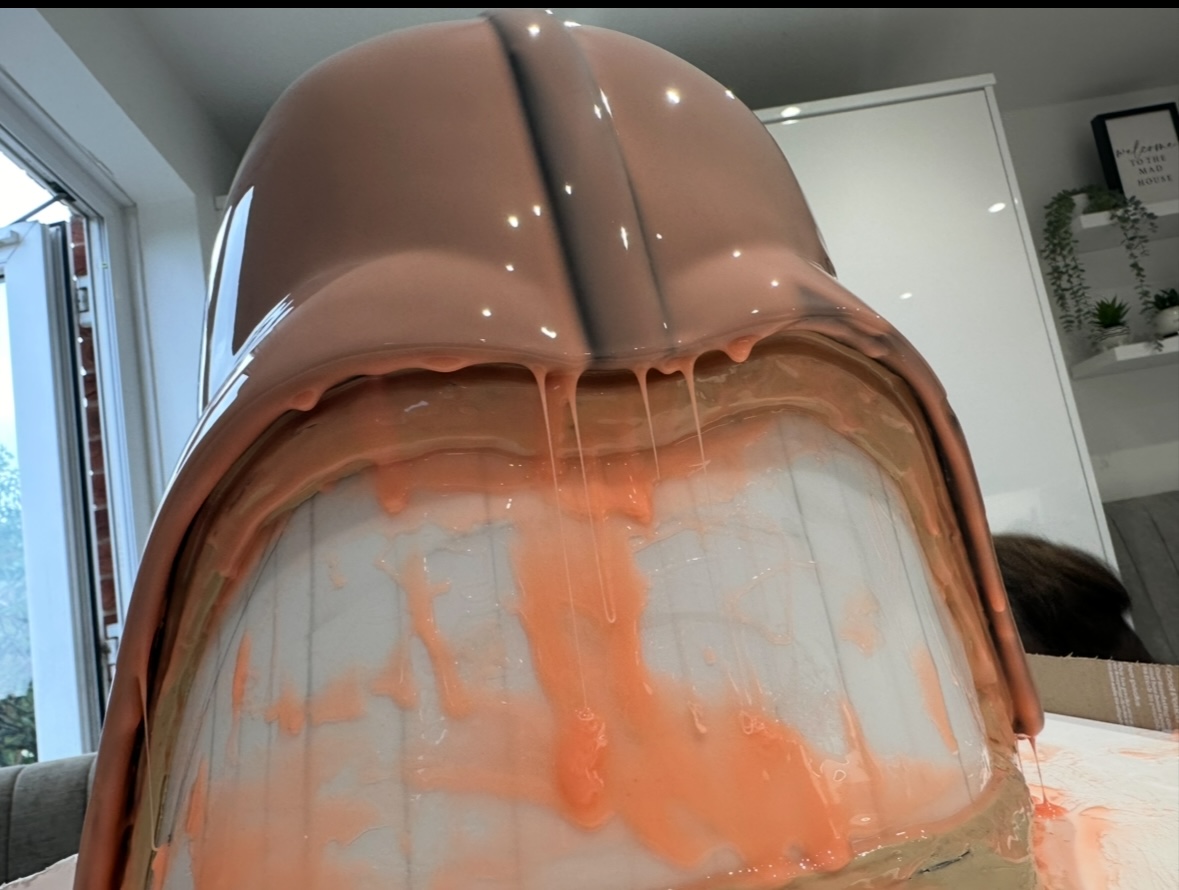

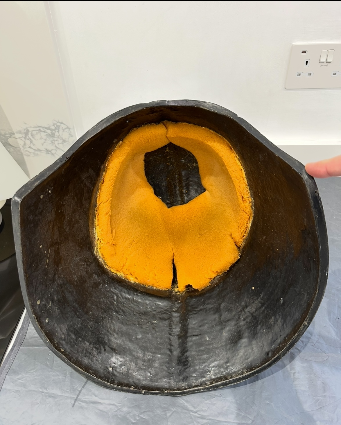

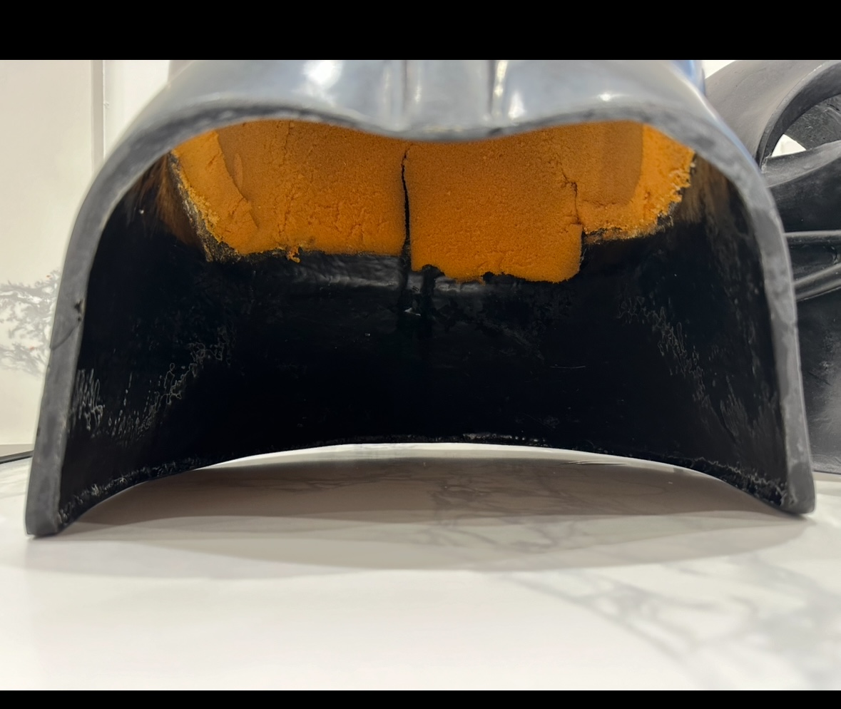

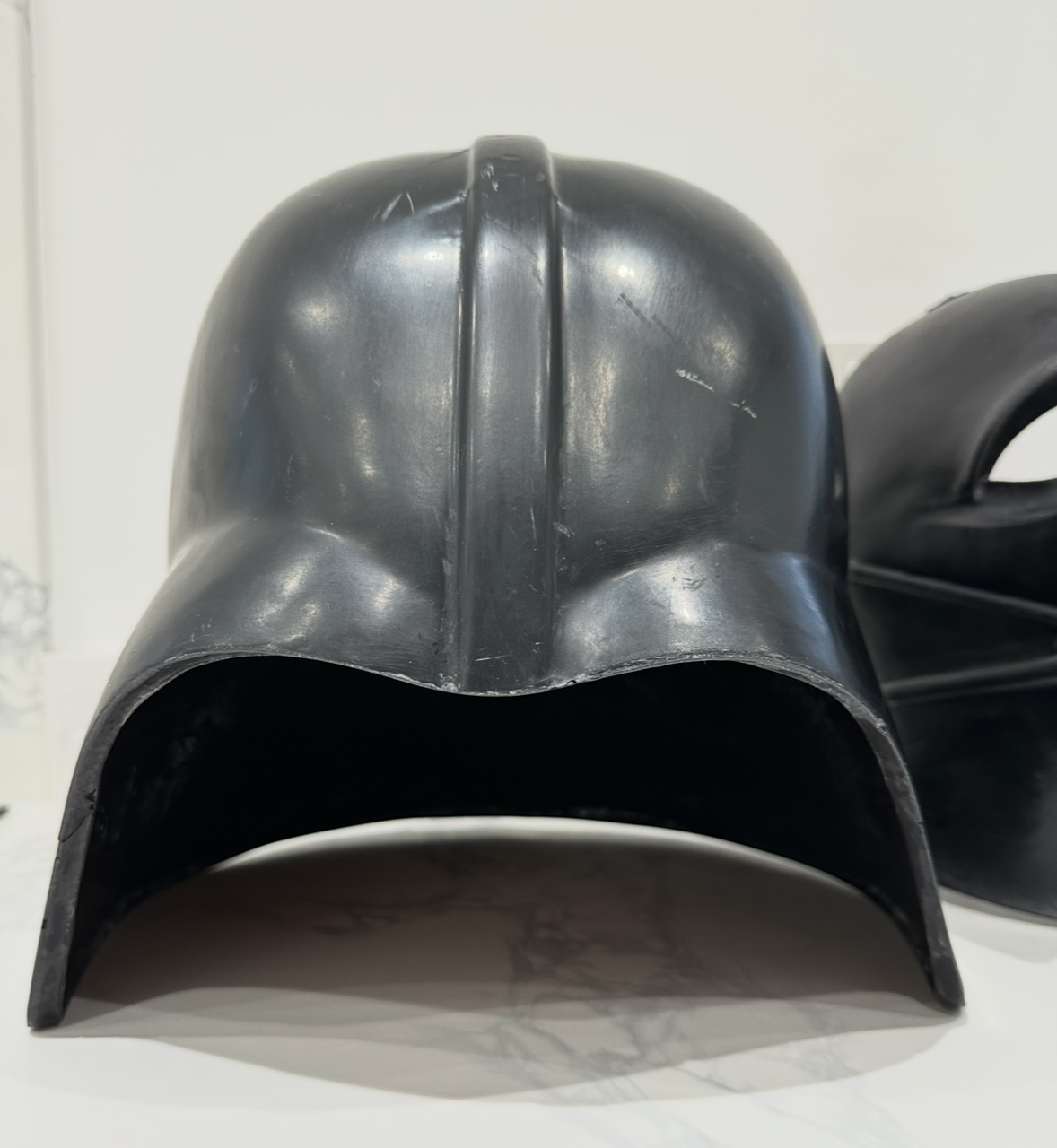

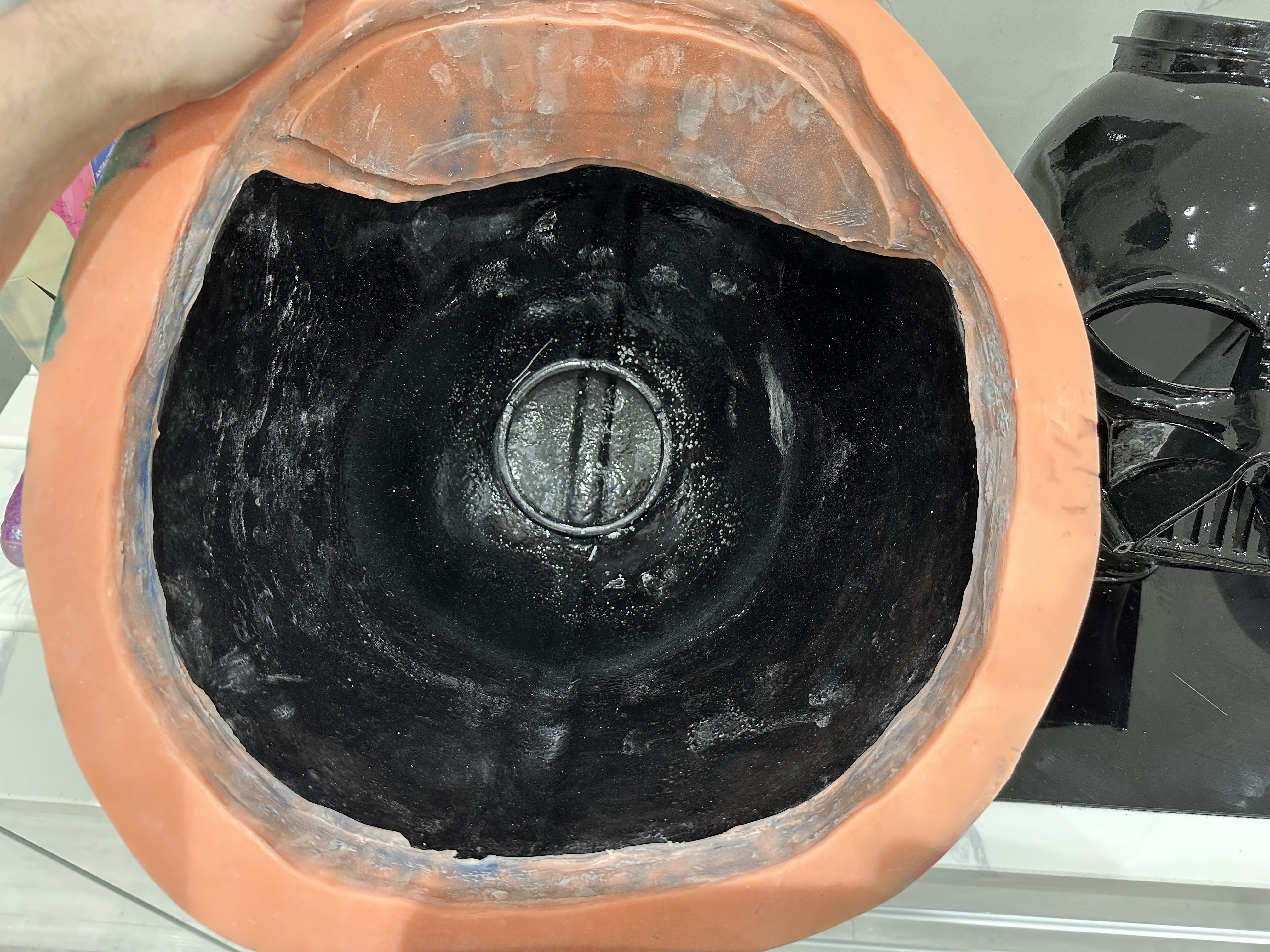

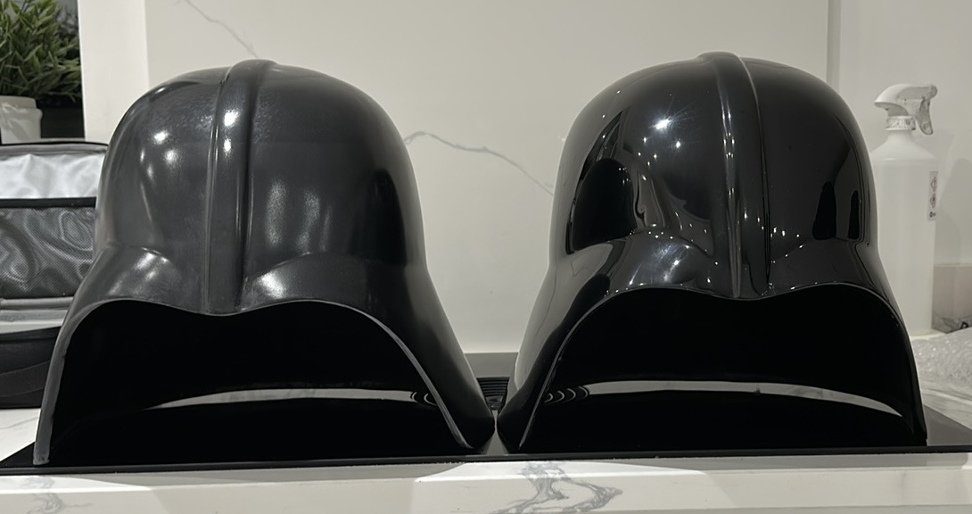

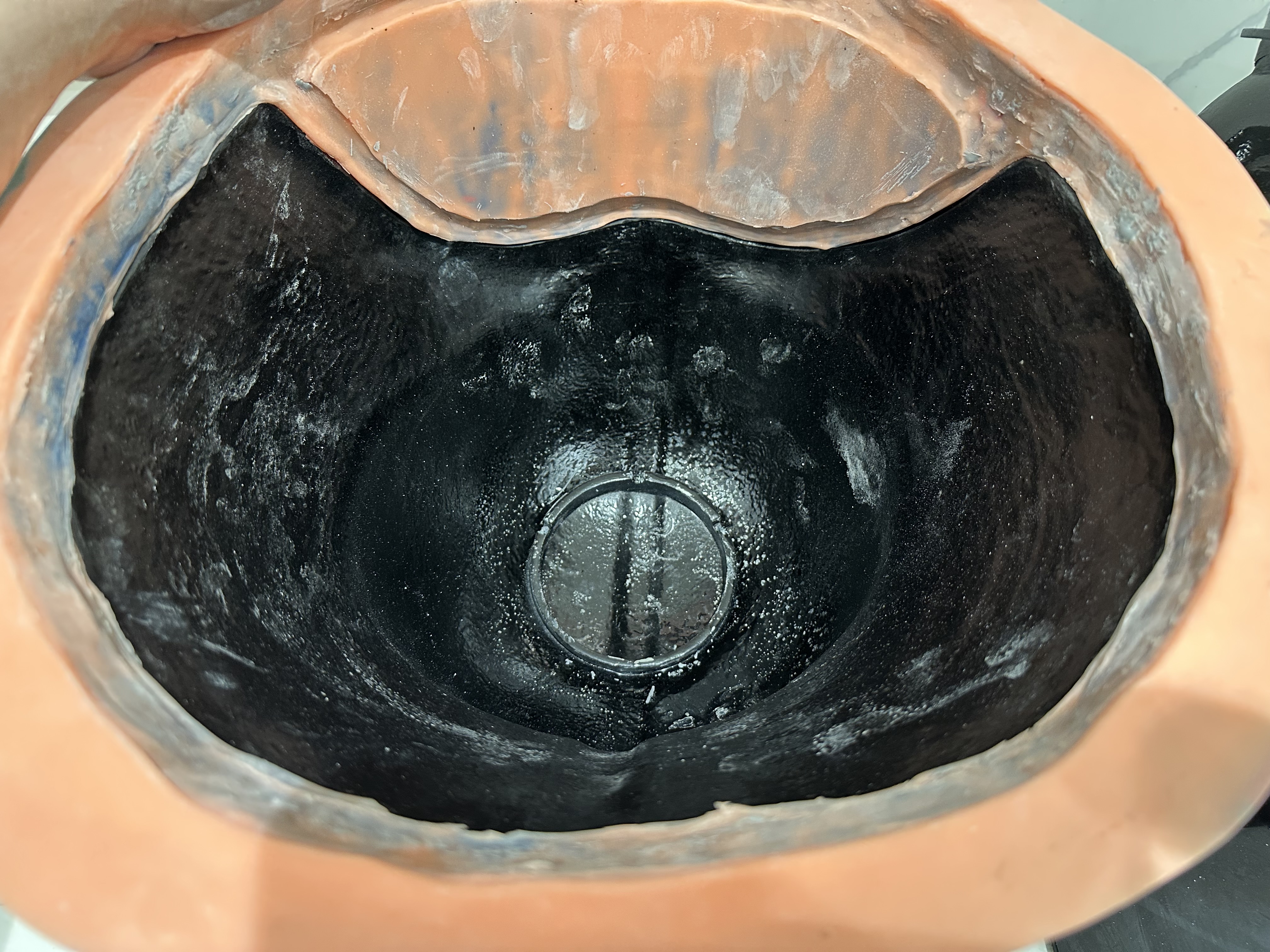

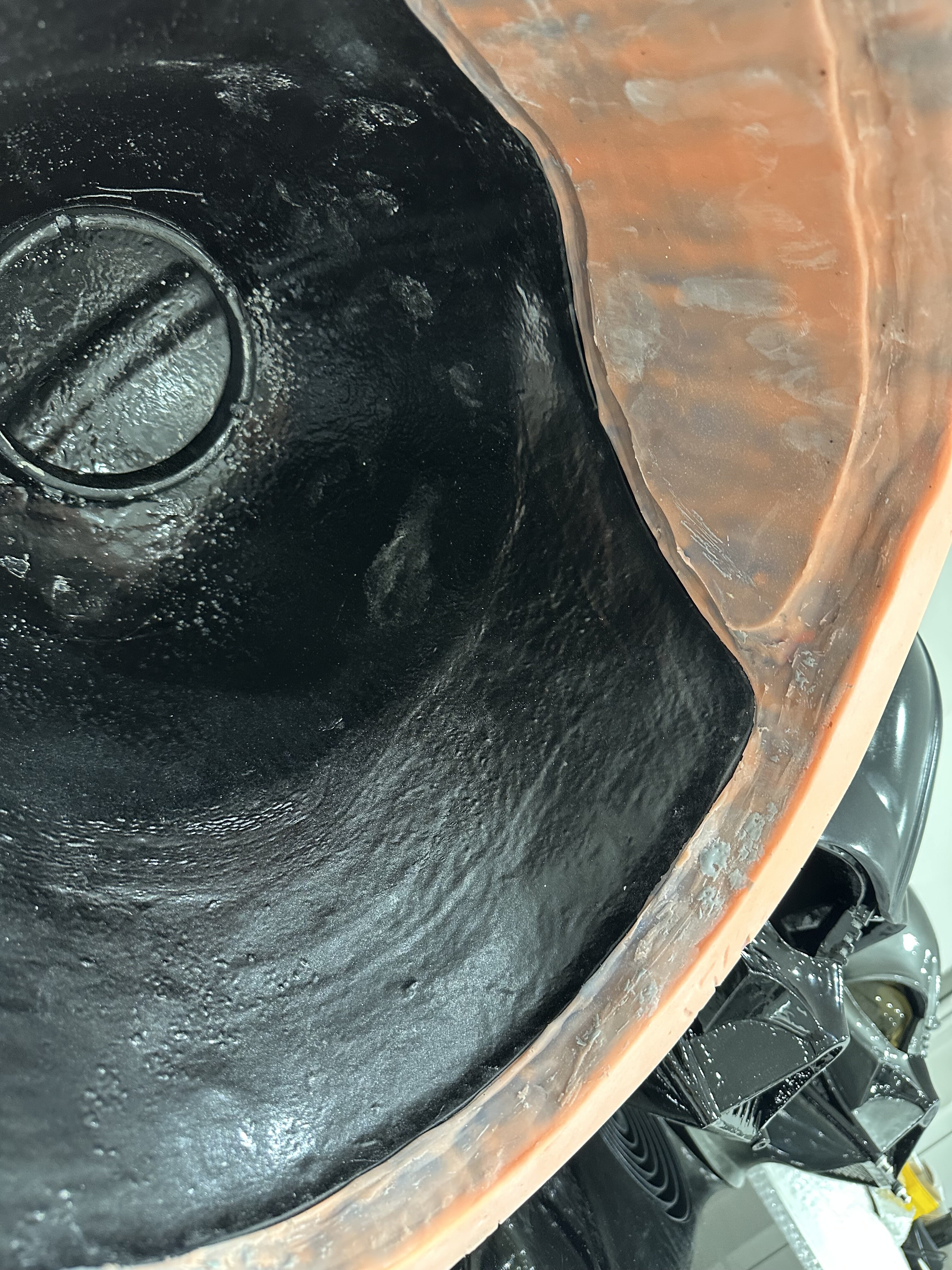

For my own sanity I’ve checked and the dome has not wrapped in molding and is as the original BR helmet. I popped one of the run helmets into the mold.

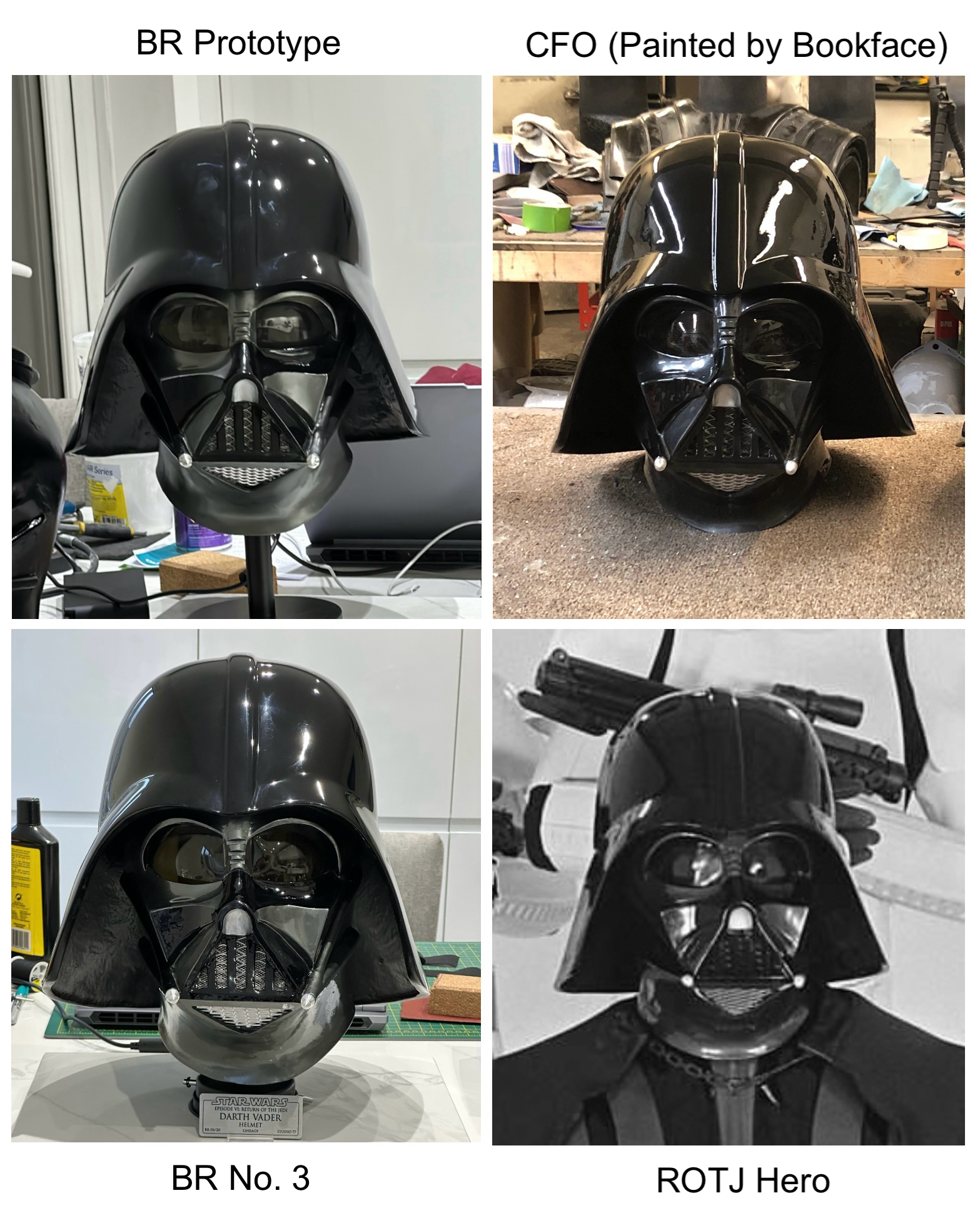

This is shipping? There is something seriously wrong (warp/flaring) with the dome.
The painting and finishing on the helmets is beautiful. The casting... in particular of the dome (left side) with the flaring... For the price of this helmet, that dome needs correcting before it ships.
There doesn’t appear to be any signs of warping, as David mentioned it’s just the way the dome is positioned and simply needs some adjusting.
If you don't see the difference between BR No. 3 and the CFO, ROTJ hero, or even the BR prototype, I don't know what else to say. It's clearly warped/flared - whatever you want to call it - on the left side. Perhaps the dome skirt is slumping on the right as well. This is not an uncommon problem that's been seen with other casts.
The mold may be fine, but it's what happens to the dome once it's out of the mold.

One factor I think is affecting the positioning is the fact that each mask is hand casted and has a non uniform thickness and when we designed the mount, we assumed uniform thickness. This means that the screws need considerable adjustment to tweak and make right if any of that craziness makes sense.
The domes are vacuum casted so nothing has happened to them after out of the mold.
