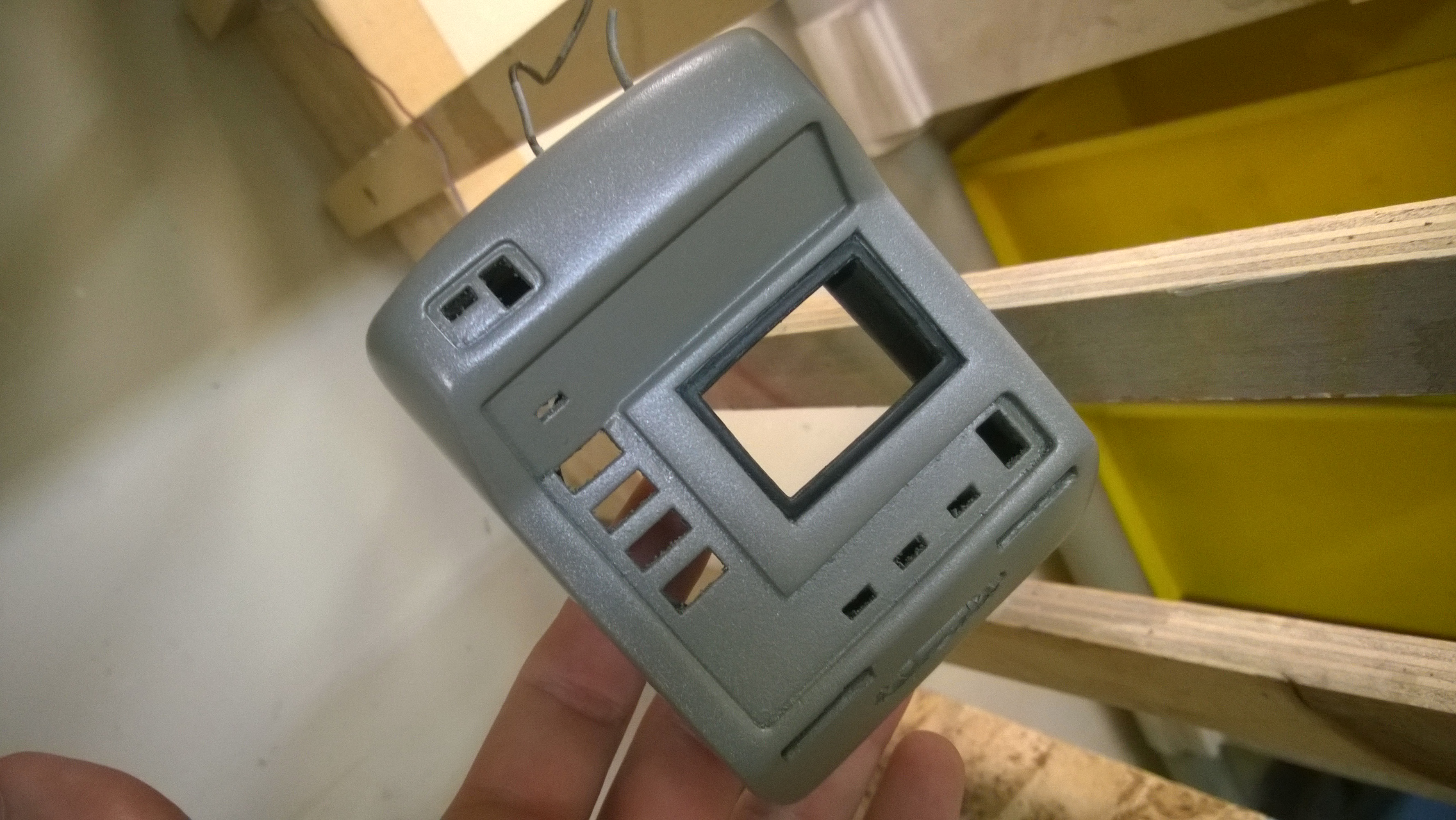

I have been having a less than entirely fun experience painting a resin-cast Mark VII tricorder.
I primed with self-etch, painted with Krylon gloss acrylic, sanded, dusted with Krylon silver, and then applied a lacquer clear coat (Watco Clear Satin). Unfortunately, anything other than the lightest of mistings of the clear coat causes the topcoat to wrinkle and crack down to the primer. Very light mist is fine, but anything enough to wet the surface markedly tends to cause this monstrosity:
Which means I have to sand back down to around the border of the primer and gray and start over.
Some experimentation has led me to the conclusion that this is an issue of a chemical incompatibility between the acrylic and lacquer. Namely, the lacquer seems to be acting as a solvent to the acrylic, even though it is entirely dry. I have another prop that I painted using laquer-based paint and I tried applying the same laquer clear coat on top of that copiously (far more than the tricorder ever got) and there was no sign of cracking at all. So, as I say, it seems to be an issue of incompatibility between the chemicals. Why the problem doesn't occur with just a light misting is entirely a mystery to me, but using many very very light coats actually does work, notwithstanding the anxiety of trying to apply it without overdoing it.
Here is my puzzle: now that I've managed to get the prop to accept a clear coat using the lacquer with multiple light coats is also when I have worked out the cause of the problem, so my question is: should I sand everything back down and start over, or leave it as it is (looking fine now) and just cross my fingers that something isn't going to do wrong down the road? My fear is that somehow the lacquer coat is going to dissolve the paint over time and end up cracking anyway.
Any other ideas as to what's going on here chemically or in terms of my technique would be most appreciated. My surmises above may be entirely incorrect.

You are right on with your guess of solvent incompatibility. Lacquer paints are much more robust and their solvents can attack weaker paints like enamels or acrylics. You can paint any other paint over lacquer, but you have to be cautious painting lacquer over acrylics and enamels. Light coats (like you did) are the best way. That gives the solvents in the lacquer a chance to evaporate quicker so they don't have as much of a chance to affect the underlying paint. Once the lacquer's solvents have evaporated, your underlying paints should be fine.
Another factor is the way paints dry - particularly gloss paints. Gloss paints are designed to skin over, which is what creates the glossy surface. The paint also contracts slightly as it drys, pulling the skin tight. A by-product of that process is that the skin traps solvents in the wet paint under it that then take longer to evaporate. So a gloss coat can feel dry on the surface, but still be soft underneath. When another paint; like lacquer, is sprayed over this hard/soft sandwich, it contracts too. It pulls on the skin of the paint which tears it away from its soft under layer creating the crackling texture we all cringe at. (unless you are painting a 10th doctors sonic screwdriver, ha ha!)
So the best advice is to use all the same type of paint, or at least spray enamels over lacquers and not the other way around.
Krylon reformulated their paint recently. The "regular" consumer grade is garbage. what you want is their Industrial grade, that's the original formulation. In fact,several paint companies have reformulated their paints such that the paint takes much longer to cure. Cure times have gone from several hours to several days! Rattle can paint is quick and easy but with new EPA regulations (especially in California) is ,at least in my opinion, making rattle can spray paint a less attractive option. Invest in an airbrush and mix your own paint as one more tool in your arsenal.
That is your problem right there. I have worked in the paint industry, for a manufacturer, for the last 15 years (specifically in the wood coatings area). The Watco product you topcoated with is a solvent-based nitrocellulose (NC) lacquer. You applied that over an acrylic paint. The solvents in the NC lacquer (toluene etc) are not compatible with acrylic paints. They are too "active" and will cause acrylics to crack or wrinkle. You might get away with light mist coats but that is still not a good idea. It does not matter if the acrylic is dry or even fully cured. These two coatings are not compatible.
Bottom line, if you're using acrylic primers and basecoats then use an acrylic lacquer to topcoat. If you're using enamels then topcoat with enamels. If you want to use the lacquer then you need lacquer based primers & topcoats but good luck with that as they are rarely available to consumers.
