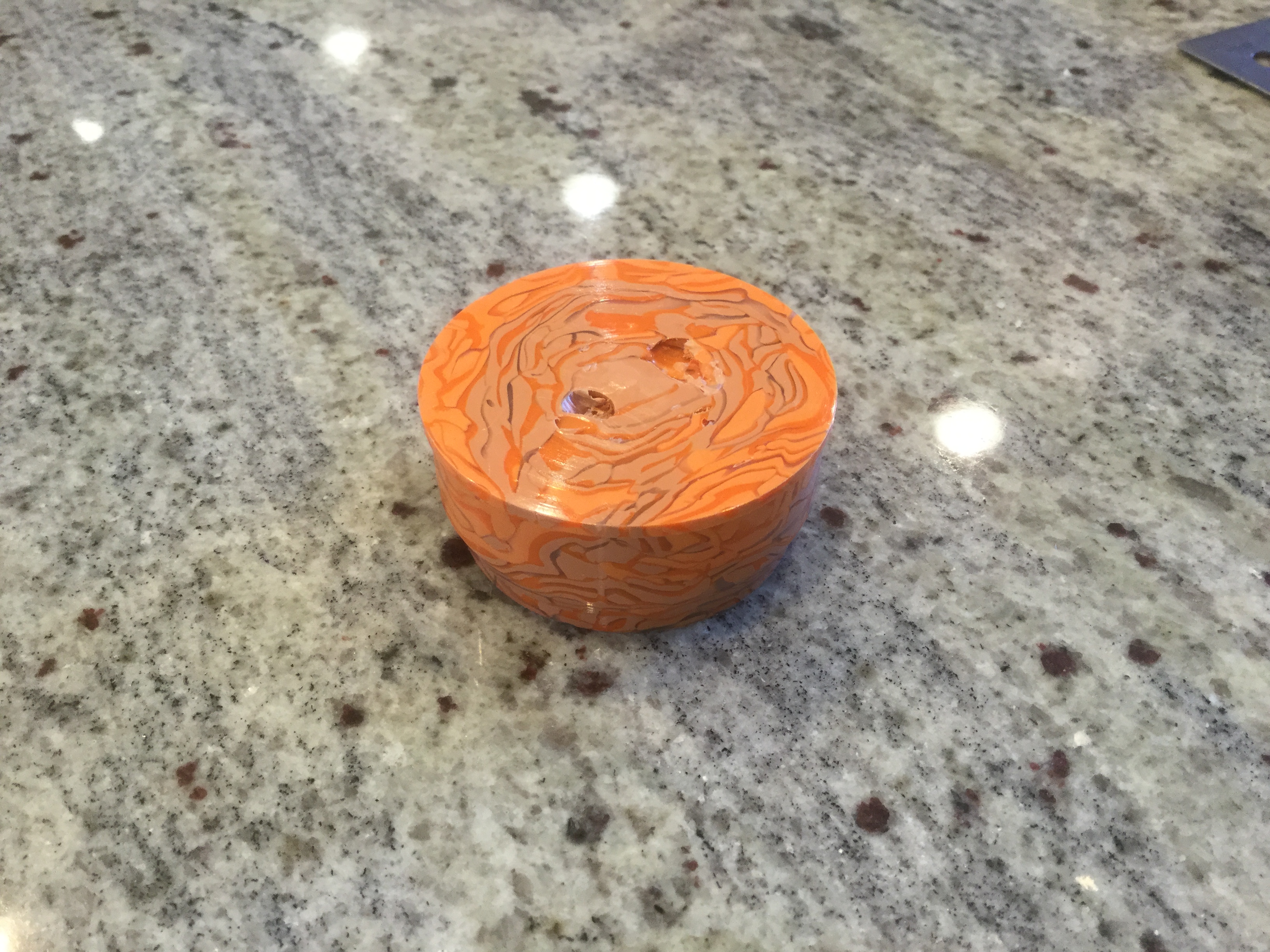

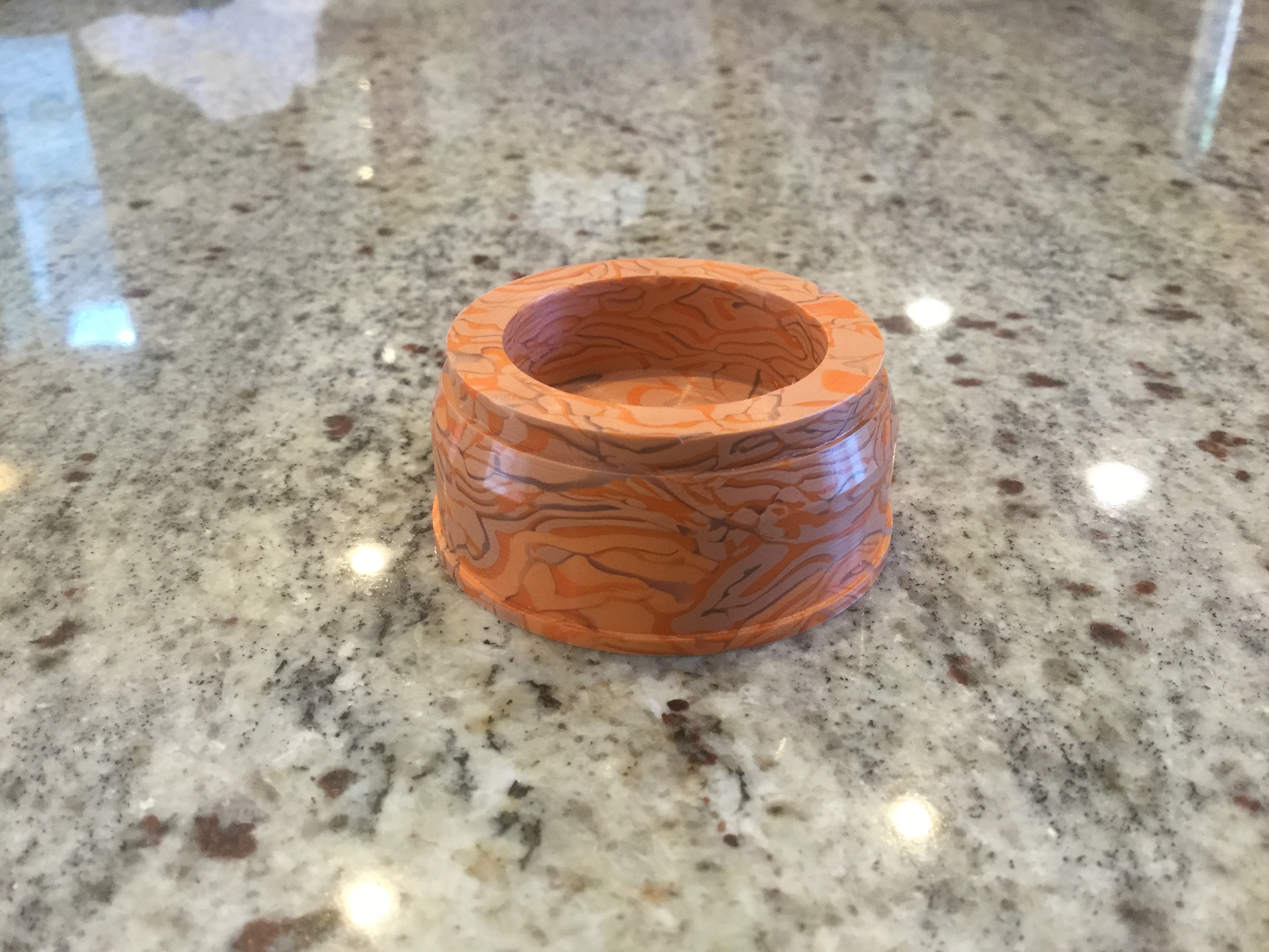

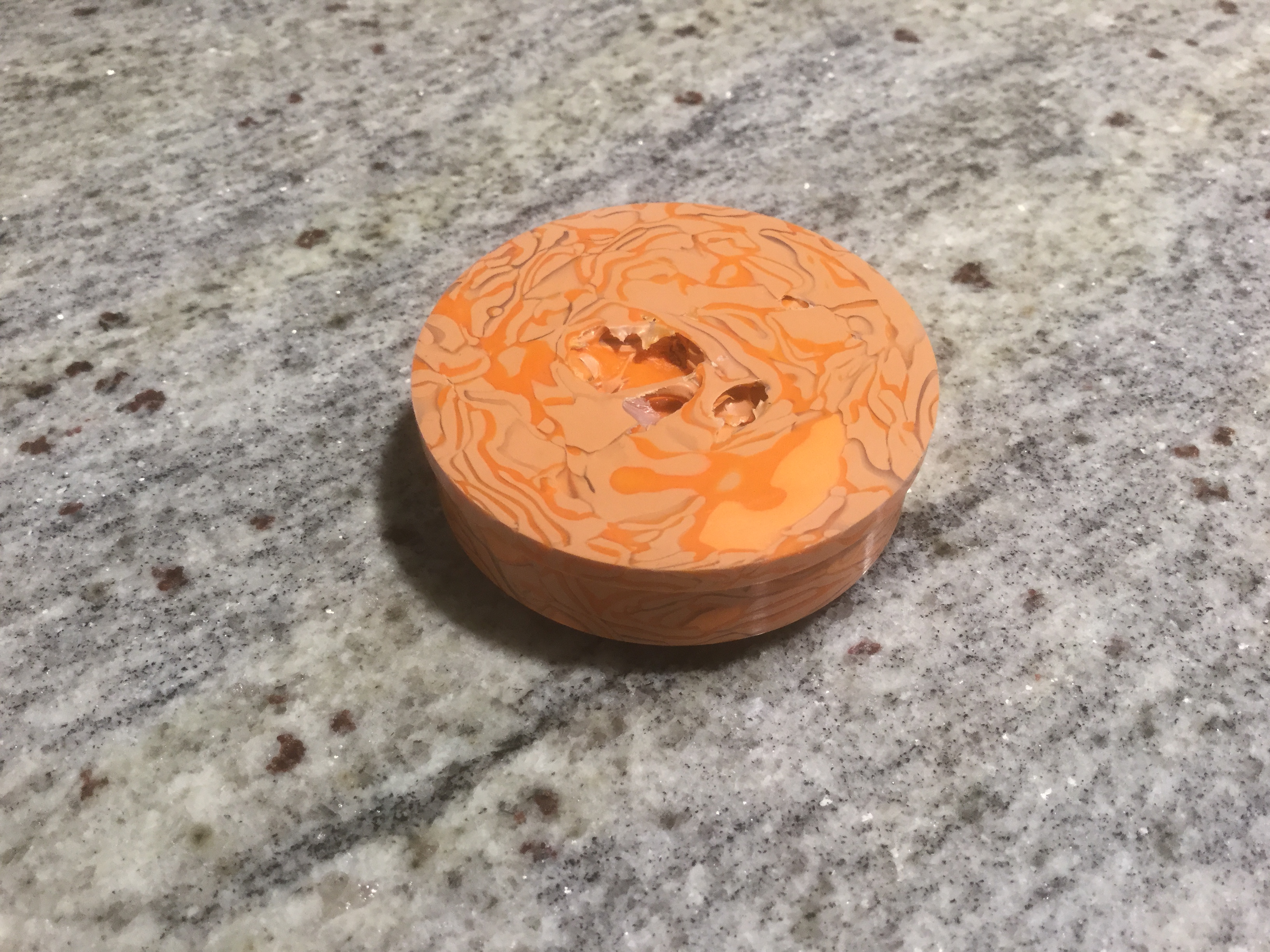

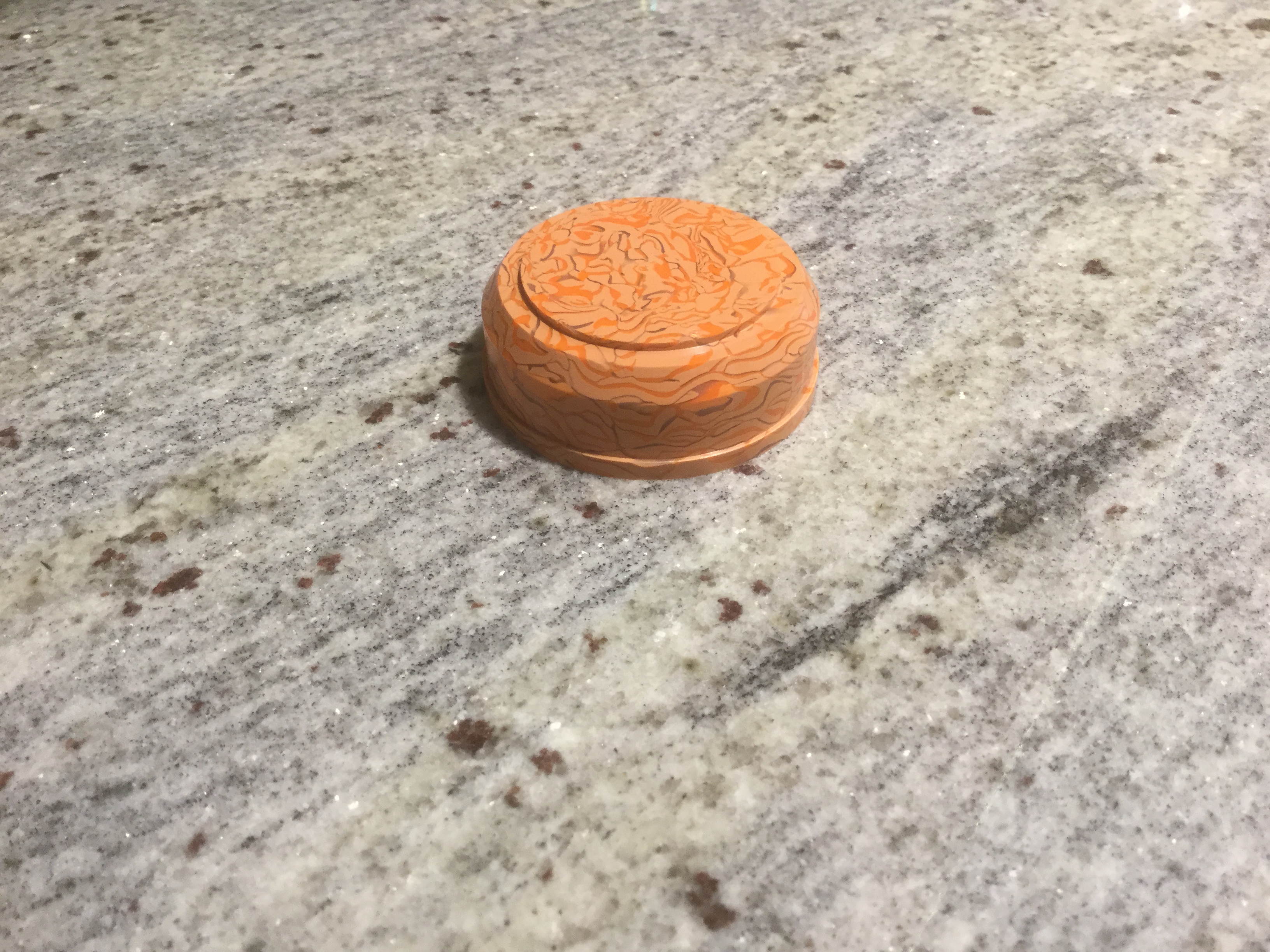

Hi guys. Thank you for your input and comments. I parted off the first profile.
On the back there is a big void. Despite compacting the plastic during the melting process these voids pop up now and then.
If I had a mechanical drawing with measurements that I was trying to fabricate, the voids would be very problematic and frustrating to work around. But since I'm free wheeling it and just having fun with my lathe it's ok.

Hello x197; surprisingly the plastic is quite rigid. I though it would be rubbery, but it's not. While I'm turning the plastic, It stands up to the pressure of the cutting tool and doesn't become deflected.
Yes, these voids are a problem because of un-even heated material. Somewhat difficult to do, but not impossible. The trick is always to maintain said piece hot...and then do a layering of that hot plastic. It will adhere to the other layers as long as it's in a very soft state. And that's the difficulty: you'll have to get a few ovens to go back and forth between pieces.
To heat up your form will also help a lot;)

The Piranha; I saw a video on You Tube where a guy used a heat gun to fill a void in HDPE-2 plastic. I think that would work well.
Joberg; I think you are right that this problem could be mitigated in the original heating process.
I think the pieces I cut the plastic Tito are too big and course, and this is what is causing the voids.

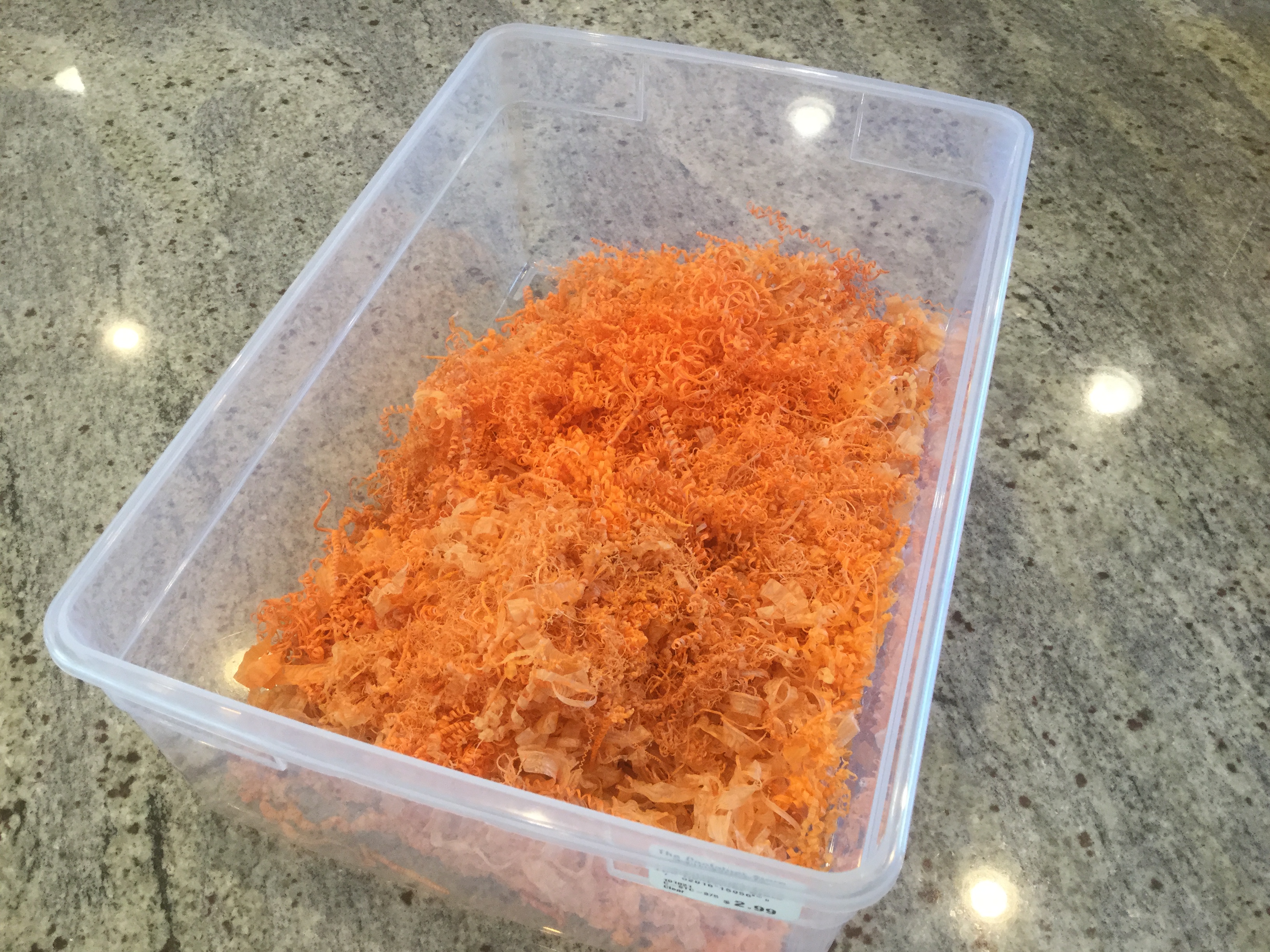

I will take the shavings that you see under the lathe and make another block of plastic paying special attention to compacting the plastic as its melting.

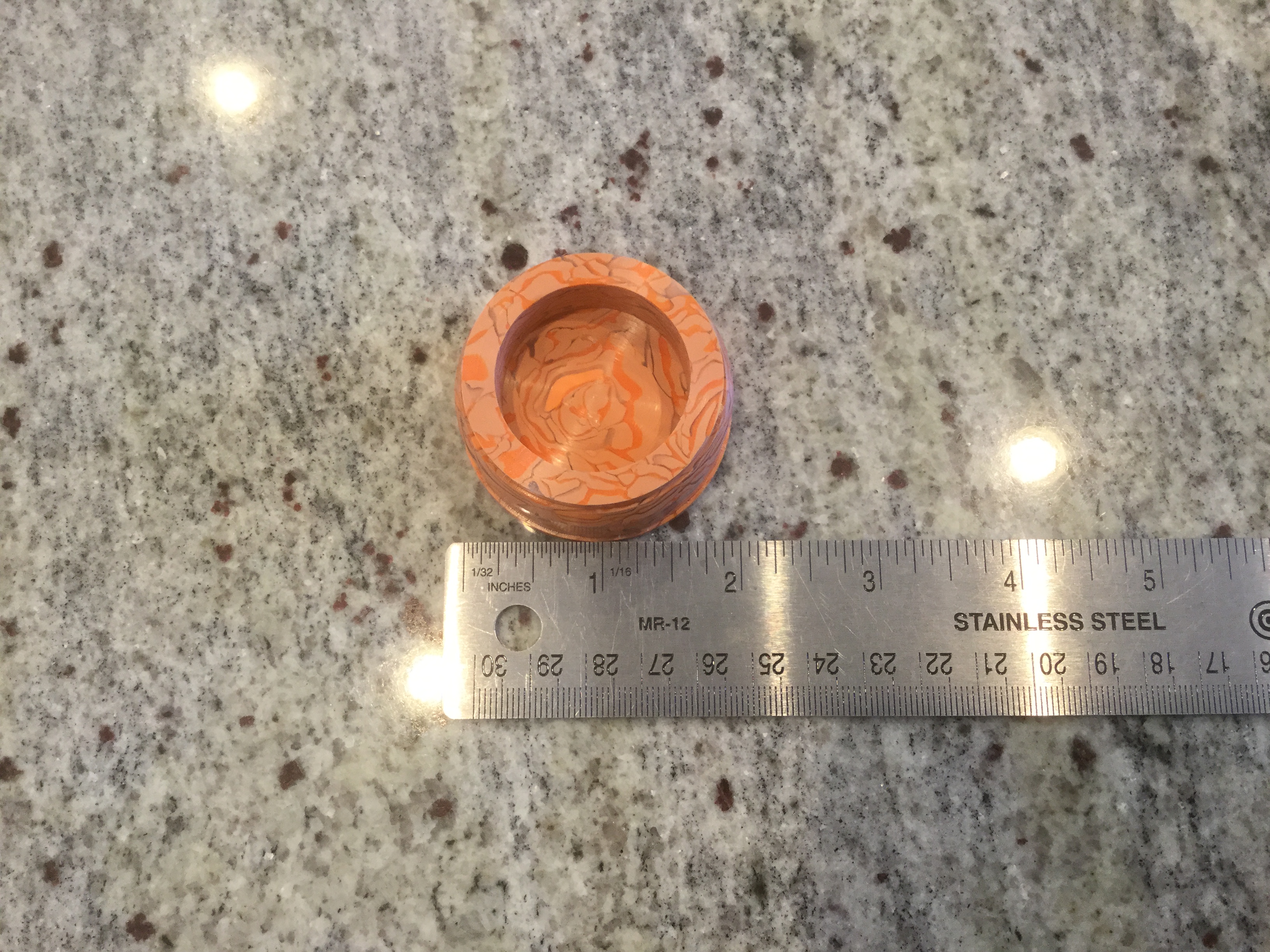

Here is another widget I turned on the lathe.
There is a big void in the back.

I have been saving the shavings and I'm going to use them to make another hunk of plastic. Because the plastic is chopped up so finely, I'm hoping it will fix the issue with the voids in the plastic.
More to come soon. Thank you for looking.
When it comes out of the oven, is it so soft that it can be stired? That may be enough to release the bubbles?
