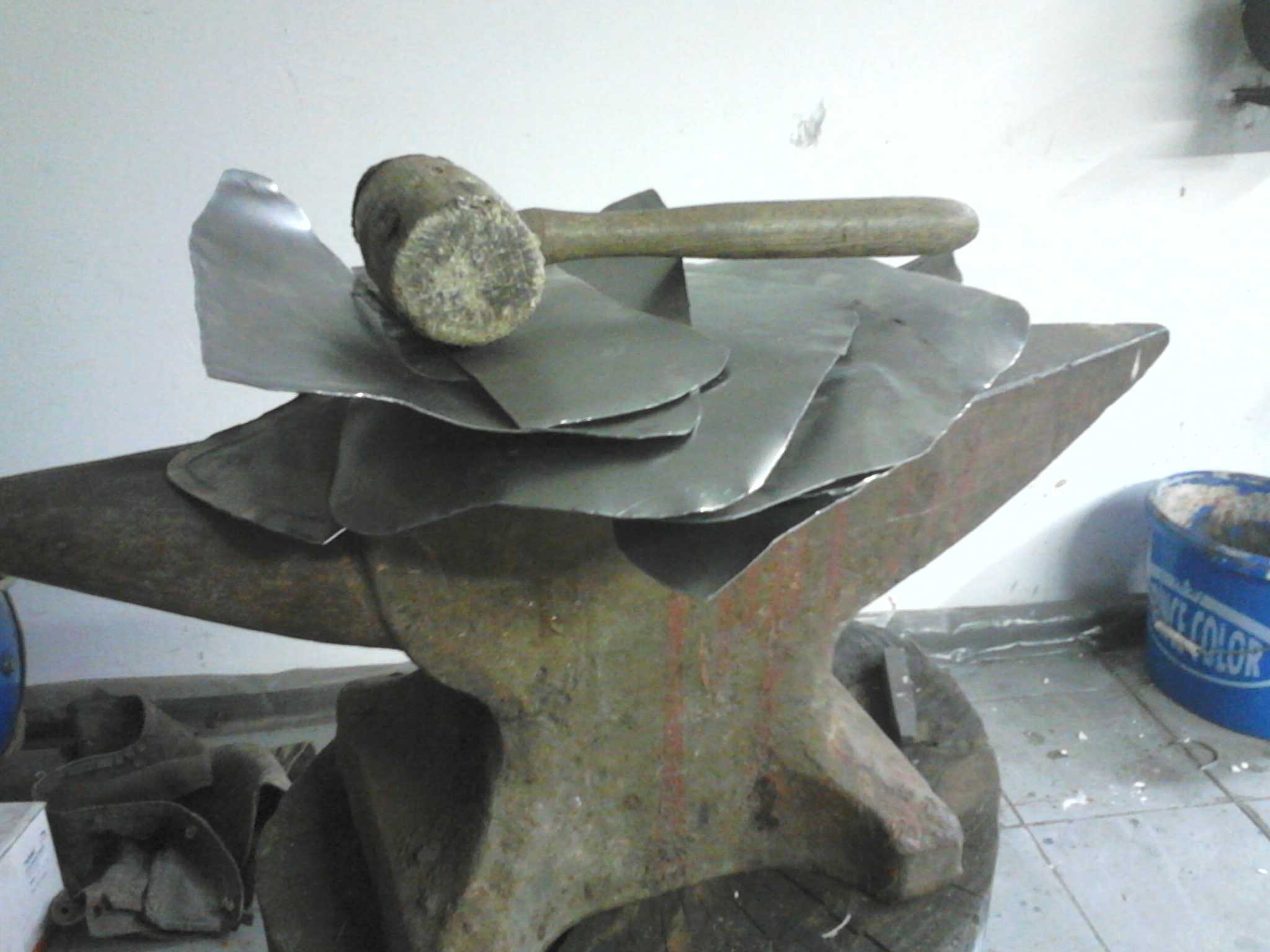

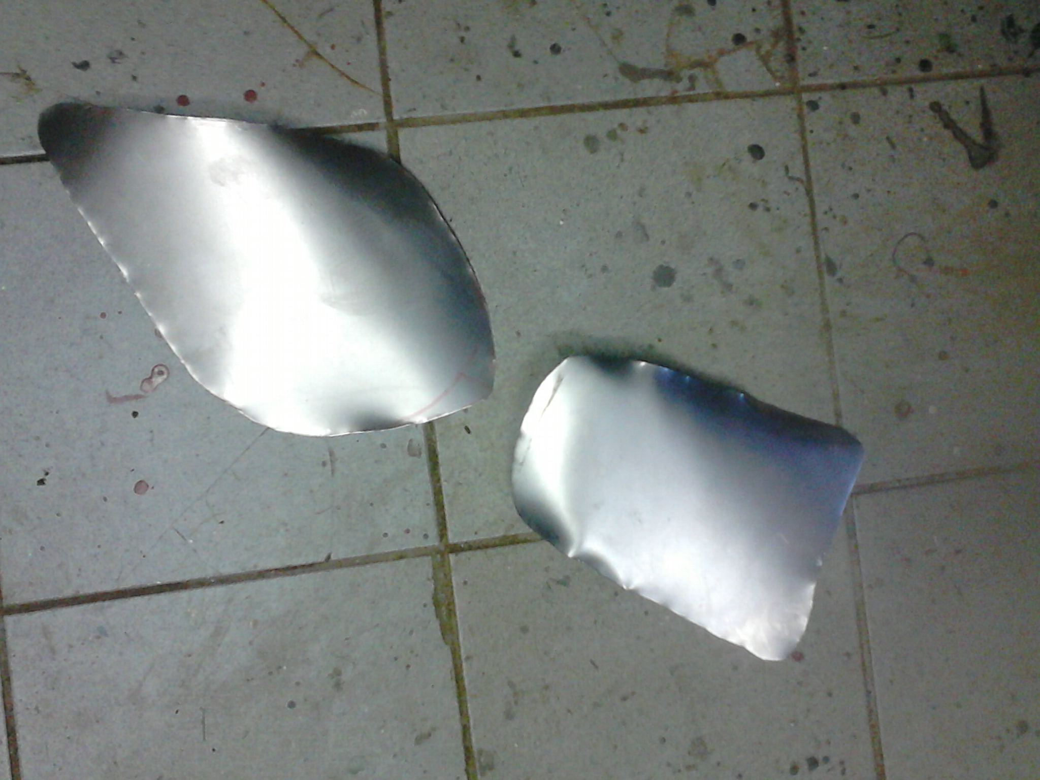

Another step was to make the iron bases for all the plates. It was just basic cold smithing, taking a piece of cut out steel sheet and hitting it with a rounded hammer (not the one on the picture, that one is a mallet) under an angle on an anvil.

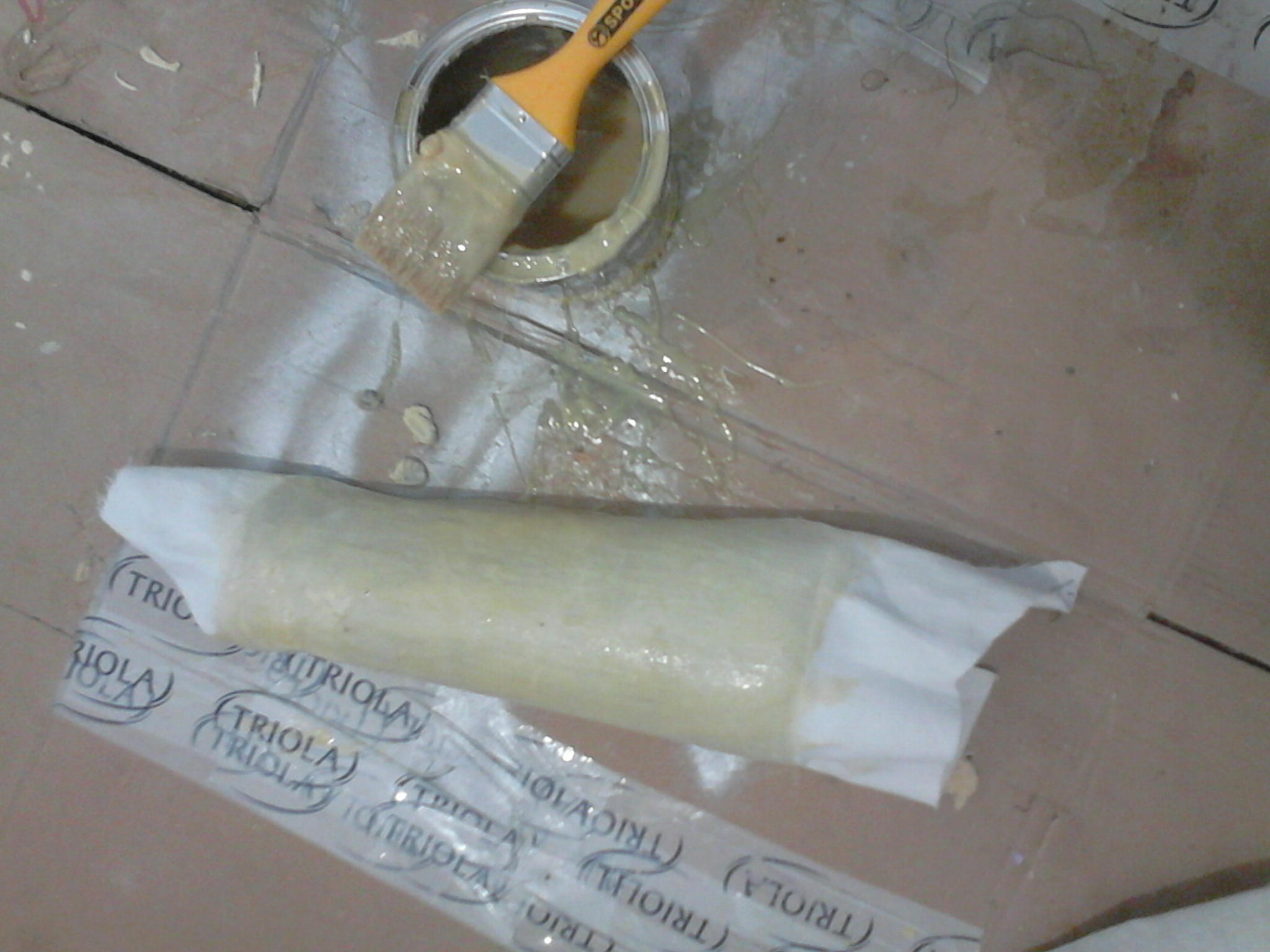

Than I covered them in cloth so it would hold onto the bone meal better and also to make it bulkier.

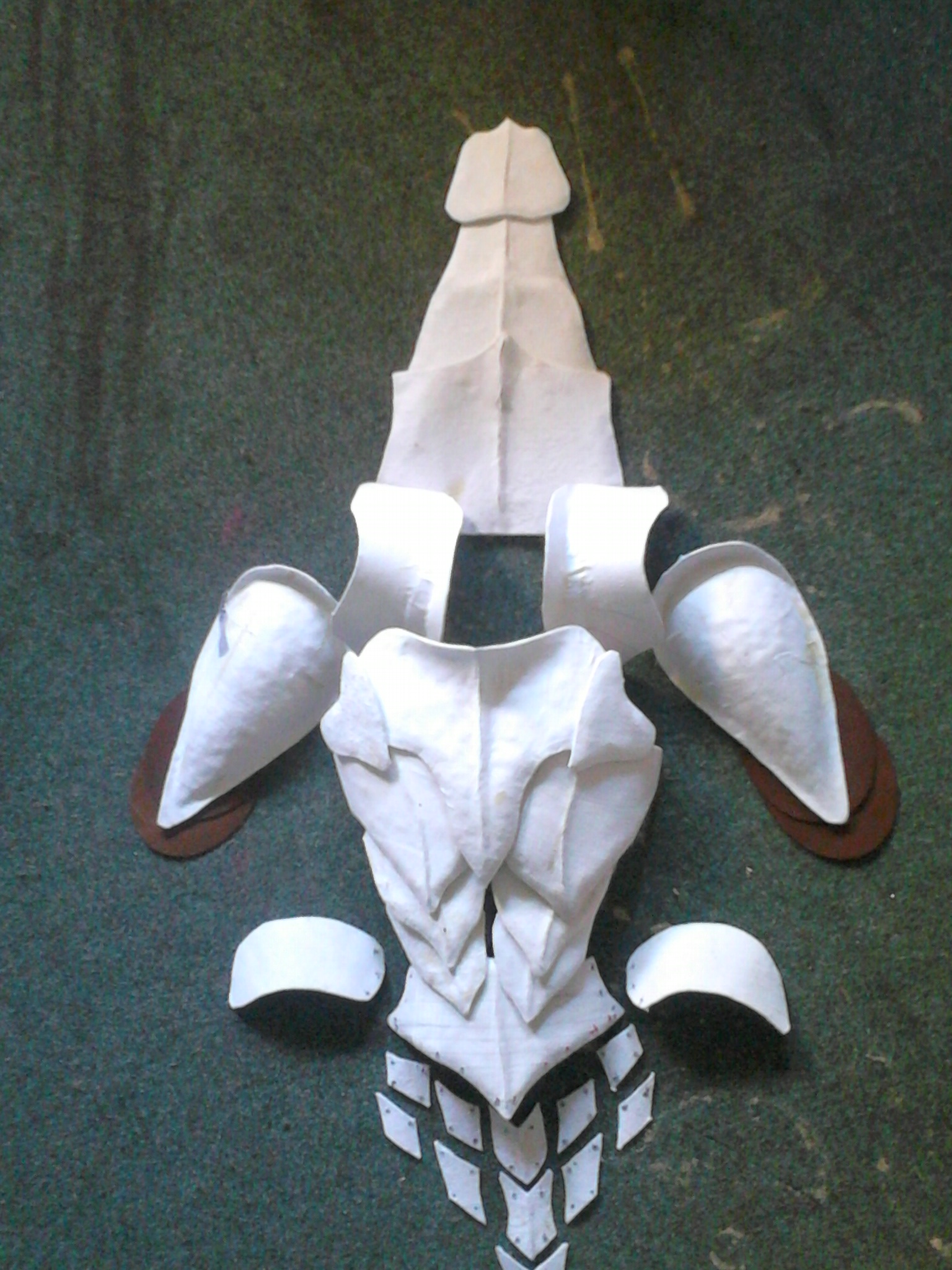

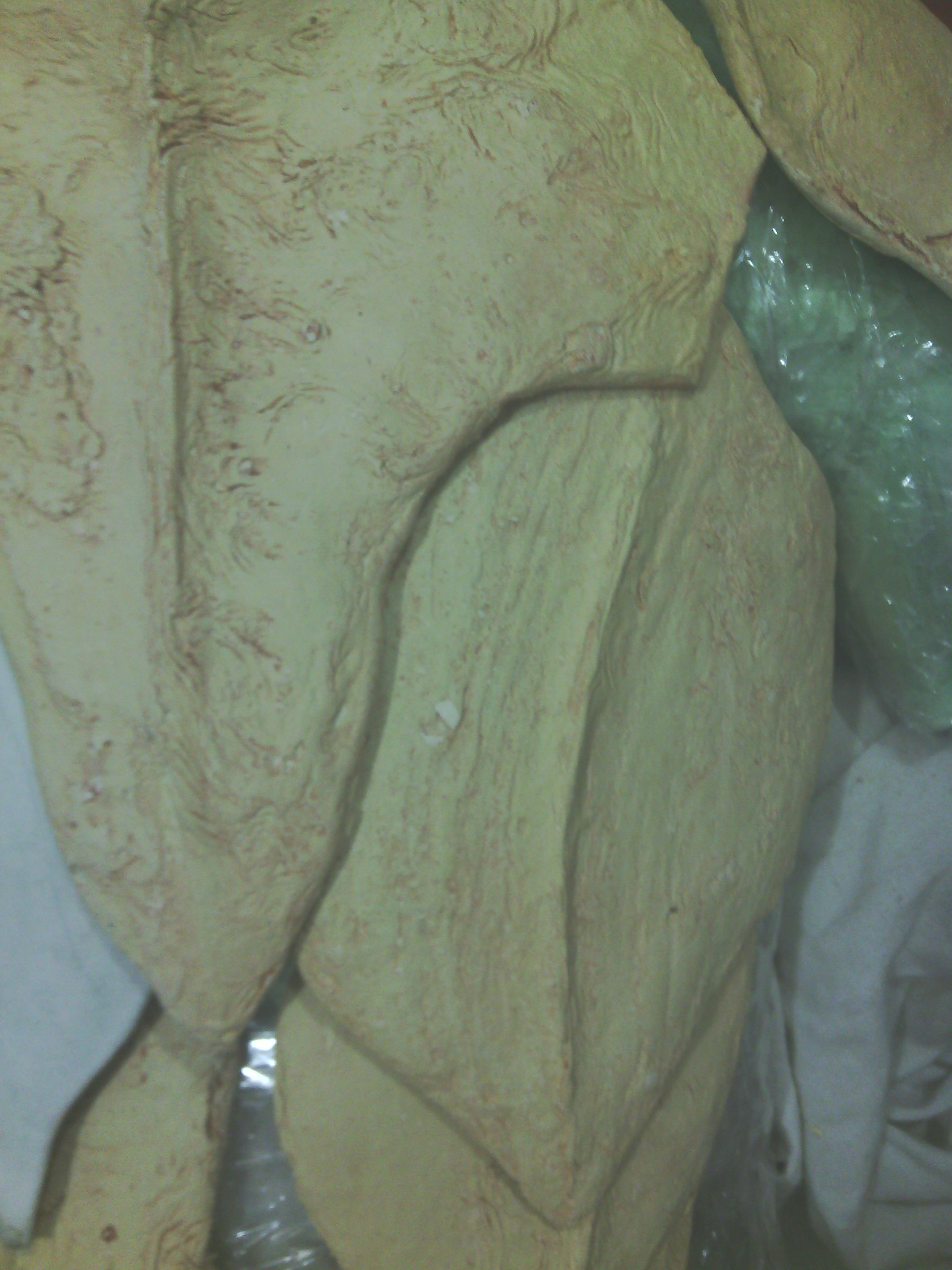

After that I simply mixed bone meal (which is commonly sold as a fertilizer) with some yellow adhesive, although I´m worried it might be a local brand, for the most authentic results, use animal glue, that one has similar perk as the one I used, but it´s not so easy to come by, and I´m lazy. After mixing I applied the mash onto the plates.
I like to throw the piece with applied bonemold into some more bone meal to smooth the surface and to make further manipulation easier.
When the bonemold hardens (I like to keep it still overnight to be sure) I smooth it out lightly with sandpaper and then apply some polishing medium. I used simple boot polish, was happy with the result, so i did not experiment any further.

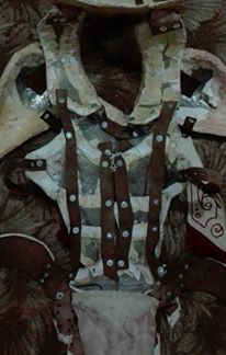

Than I used a whole bunch of rivets to get the whole damn thing together.

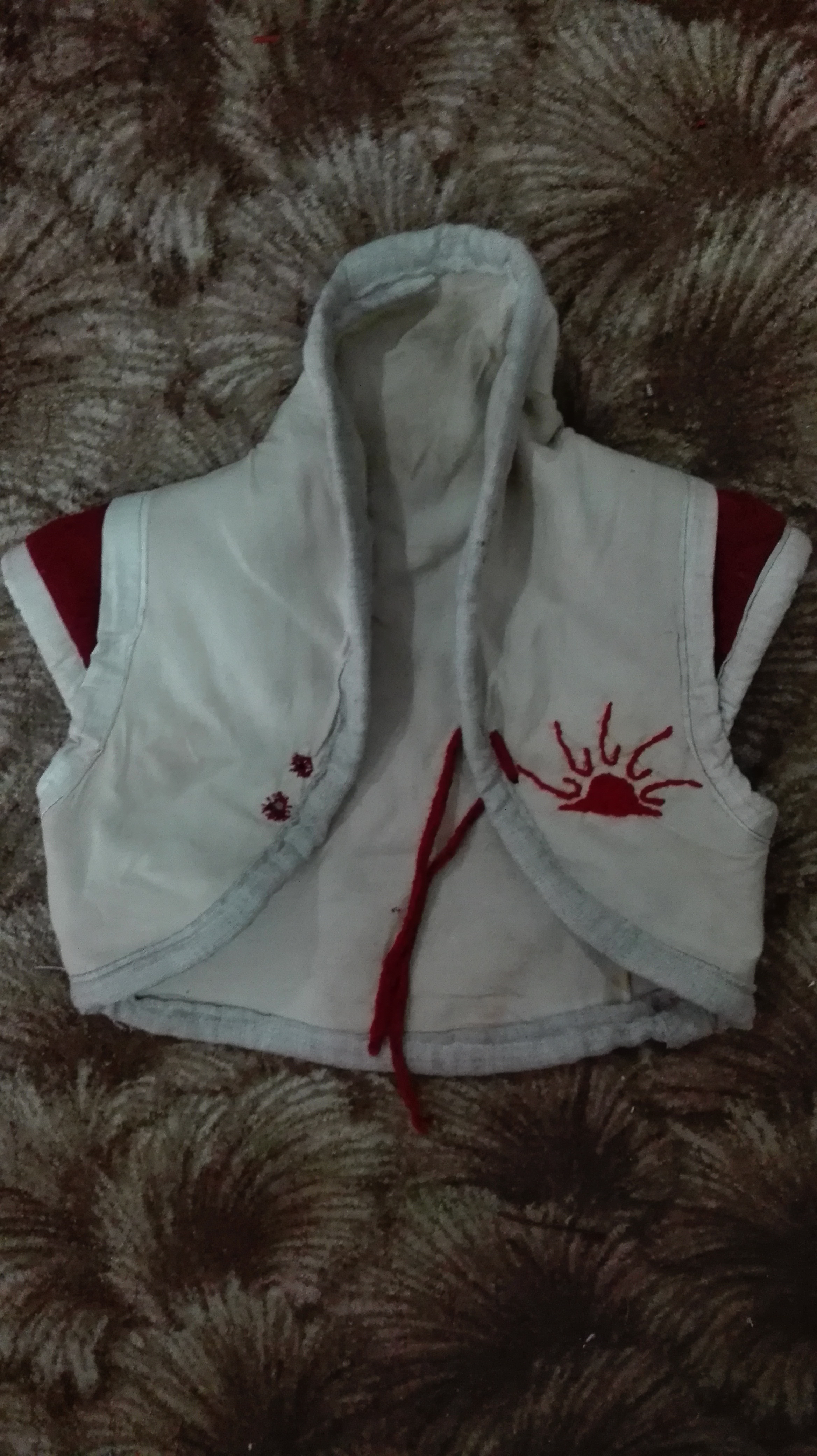

And that was for the plates itself, rest was just simple sewing and embroiding. First I made a small padded vest to work as a gambeson.

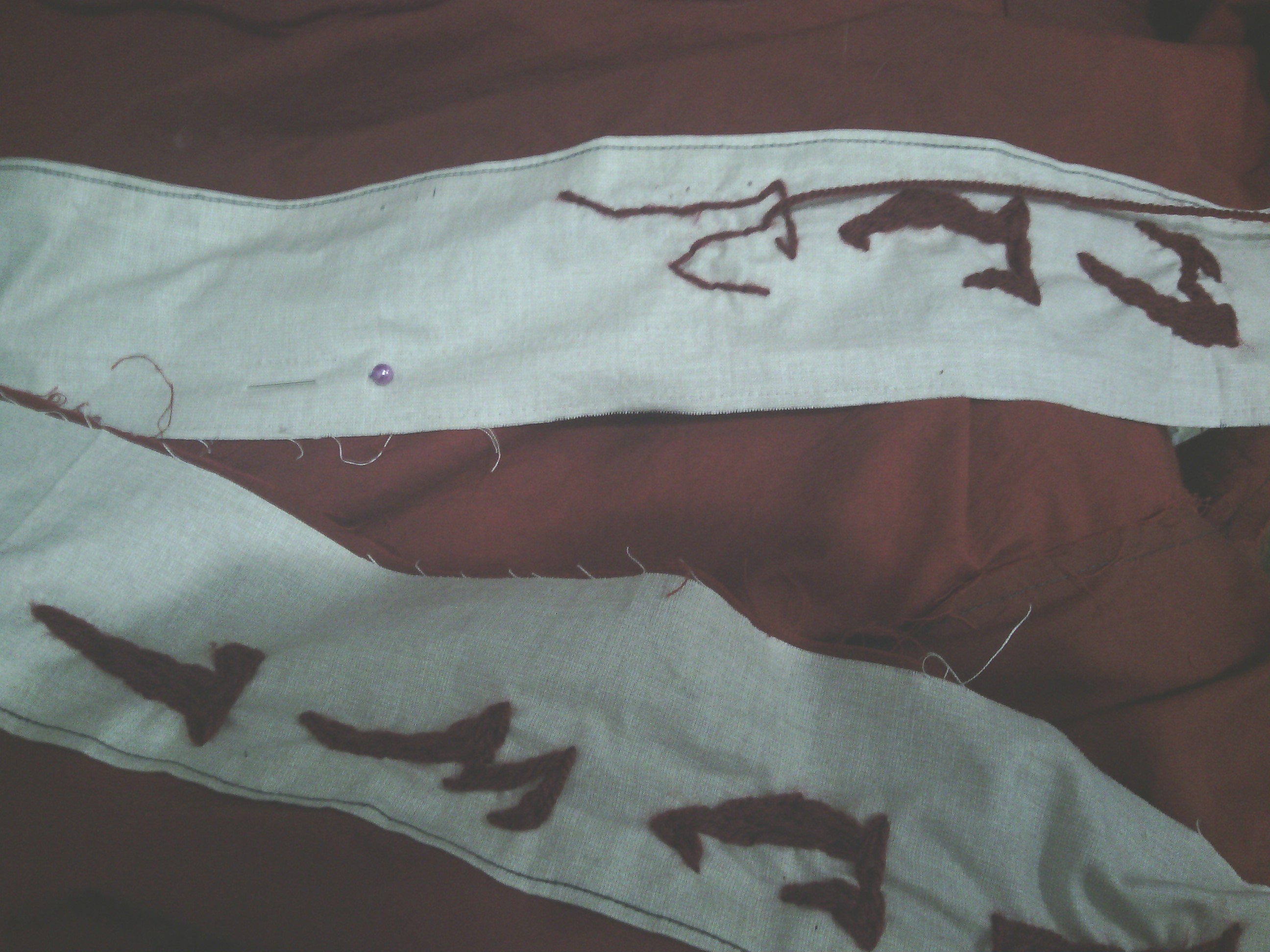

Next was heavily embroided robe, with a lot of nasty things written in Daedric signs. Seriously, don´t translate those.
