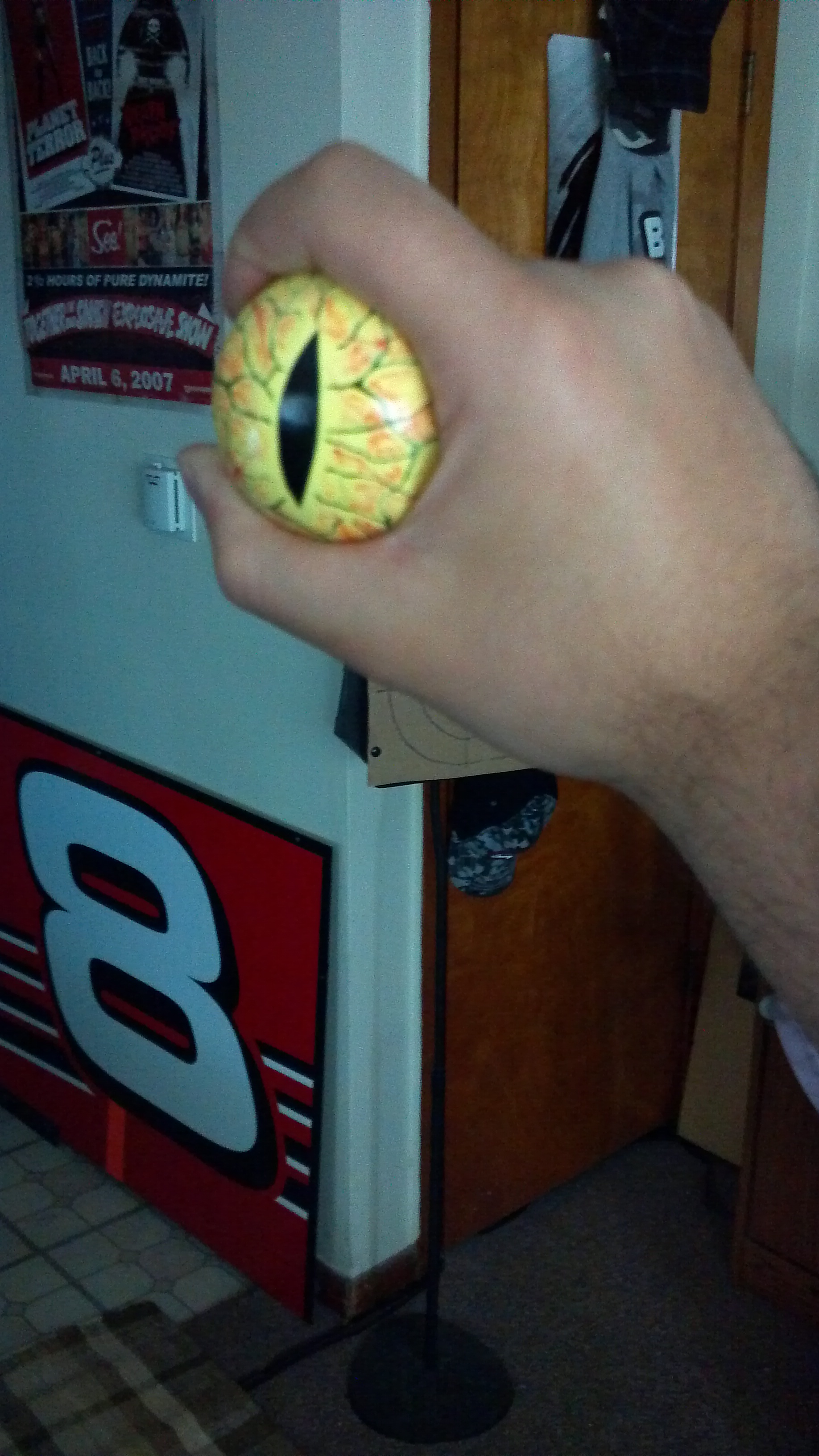

So I decided to tone it down a notch by giving the eyes a wash of lighter yellow. They were just way to colorful. I'm pretty happy with them now, I think they're more believable now at least.

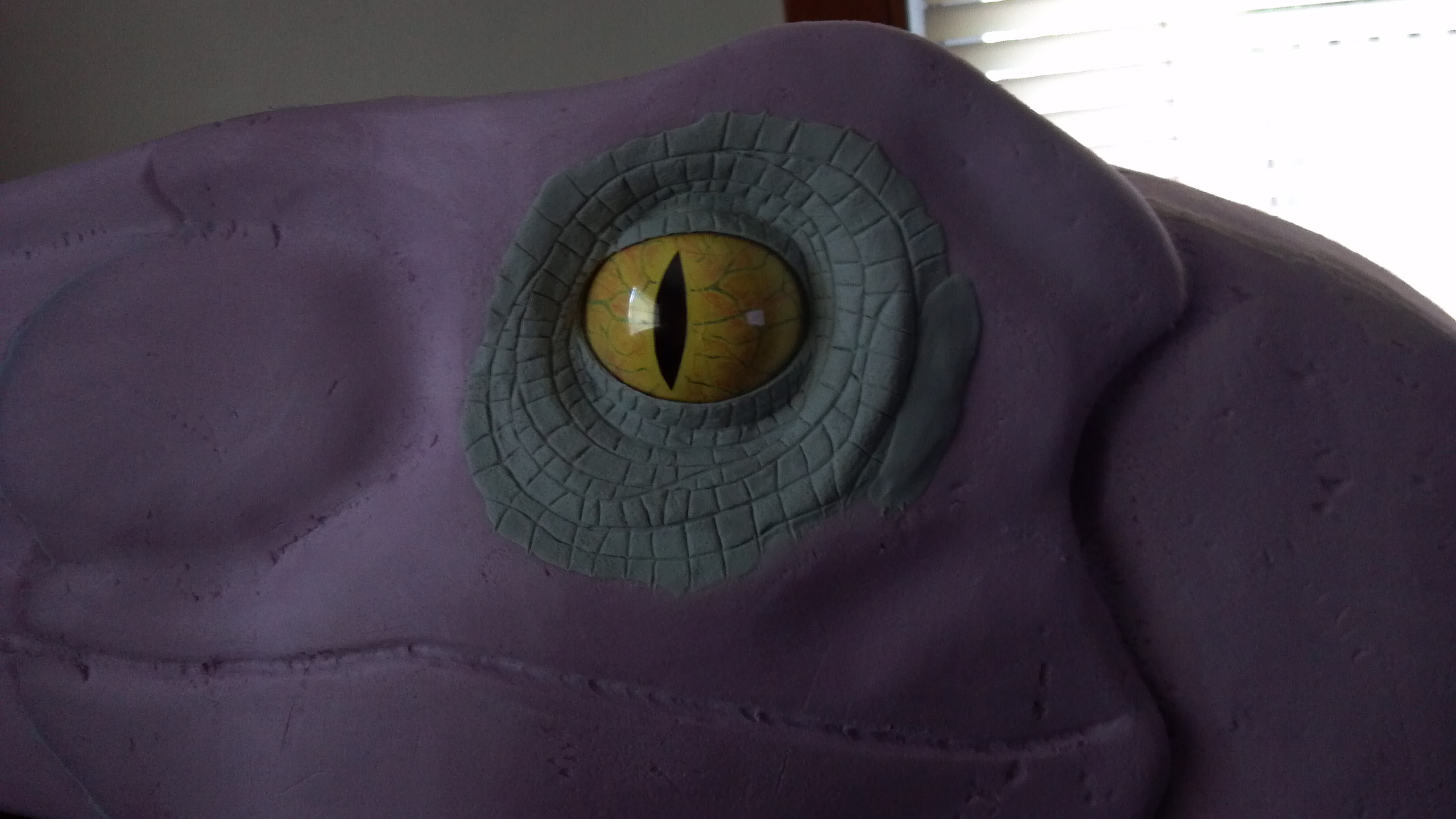

Thanks haha I'm pretty happy with it. The clear outside of the eyes are the two halves of a clear fillable ornament. I just cut the loop off. The inside is just crappy air dry clay I had sitting around, which was actually getting moldy :sick pretty gross. I just used the inside of the ornament to shape it. Here's how they look now

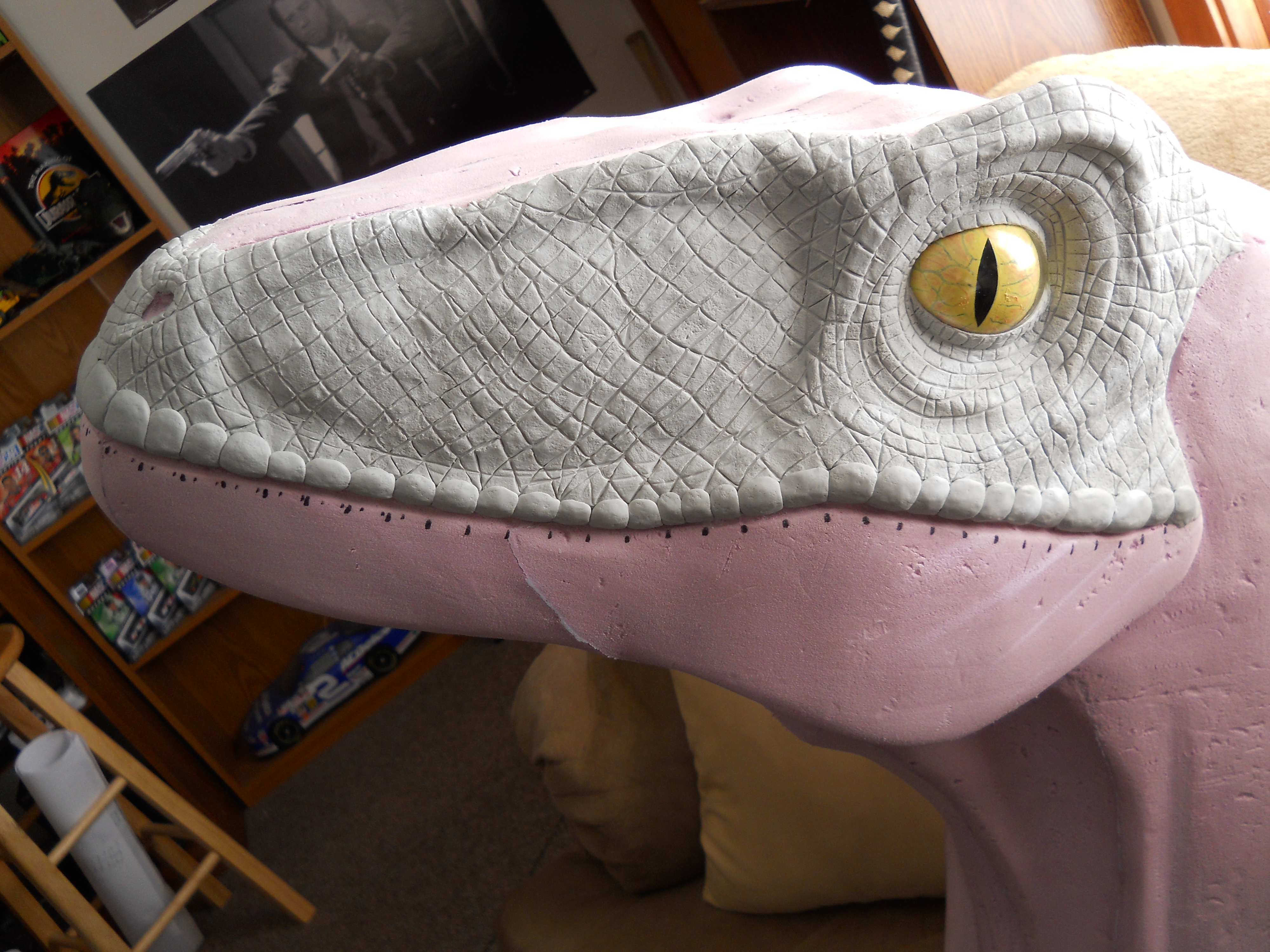

I reworked the eyelid making it more even left to right

Oh man, the memories of the countless hours texturing and retexturing are all rushing back to me.

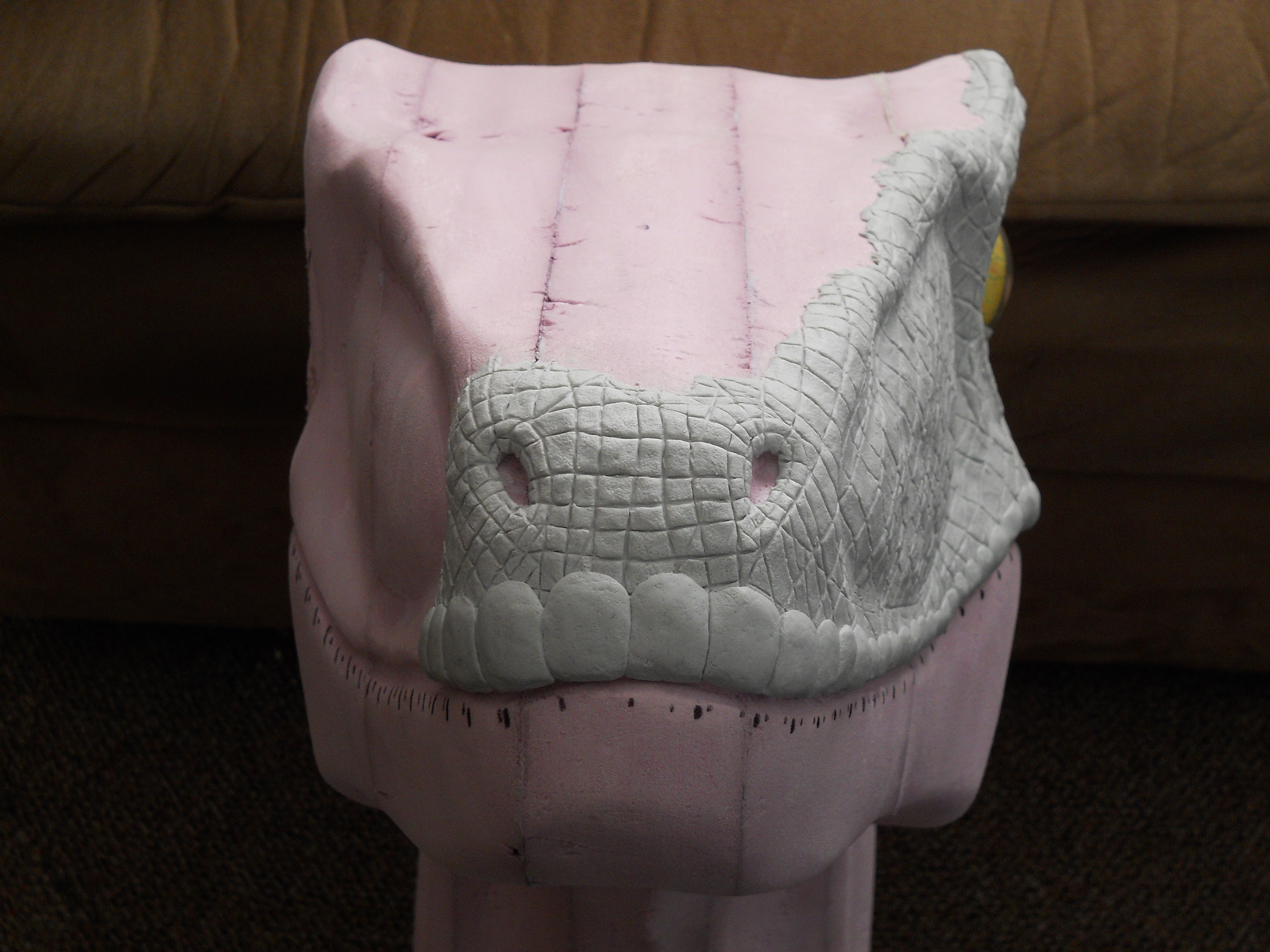

Looking nice, good thinking with marking out the lip scales.
Re: Jurassic Park Velociraptor Bust
Looking really good!! The foam carving/shaping & the scales are looking Awesome :) :thumbsup
Haha yeah...and with this stuff it's a one shoot deal so if i don't like it I have to live with it. The lip scales actually started out as a straight line and looked horrible so i applied them individually and kept them fairly smooth. I'm pretty happy with it now ;)
