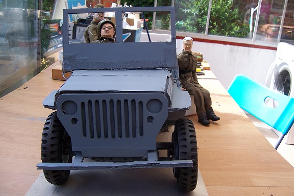

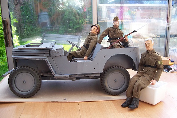

This is my first 6th scale model anything.
The last time I did this was as a youngster using Airfix kits.
I've used an Electric Boost RC buggy to keep cost down and get a reasonable good scale fit to start with.
Using a tip from here I've used foam board secured with tooth picks and wooden skewers.
The body comes off the chassis in three main sections to make it reasonably easy to get at the RC parts.
So before I go to the next step of making more accurate patterns and getting the glue out I wondered whether
anyone had the time and inclination to take a look and give me their suggestions how to improve what I've done so far.
While I was at it I also made my first ever head sculpts for the "Dads Army" trio which was fun.
Kind regards,

trswrp is right the pictures on OSW are of the Electrix Boost which I have extended with a cut down second chassis and a few pieces of L shaped aluminium suitably drilled and tapped then screwed into position.
If you decide on a Boost as the donor vehicle I would suggest you also get a second pair of front wheels as the standard rears are pretty wide.
I also went for a set of stronger shock absorbers as the originals were just a bit too soft to take the extra weight.
As for the finished panels I am going to stick with foamboard as its easy to cut but also has a certain rigidity and is very light. Any of the alternatives you mention IMHO would be as good as long as the motor on the RC donor can cope. I understand that there is an upgrade motor for the Boost but this is my first RC vehicle so you would need to search around for confirmation on this.
I molded the spare type/wheel and cast it using DIY expanded foam which was "interesting" but again keep the whole thing light.
To save weight I also used wooden artists maniquins for the bodies of the figures.
Good luck with your Jeep.
Please let me know if post anything on your vehicle as I am always looking for inspiration and ideas myself especially as this is my first too. :)
Bern

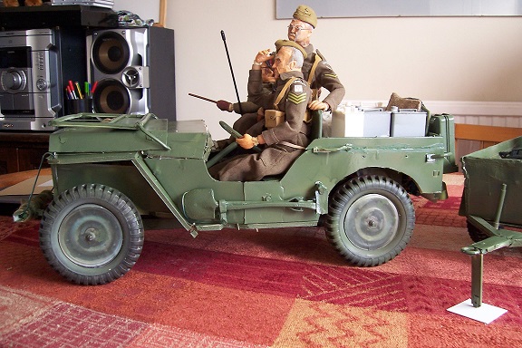

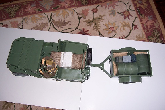

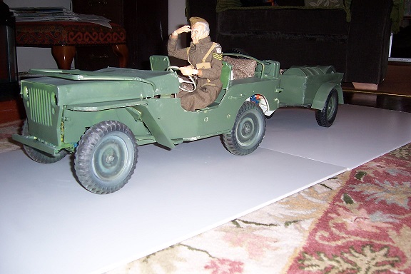

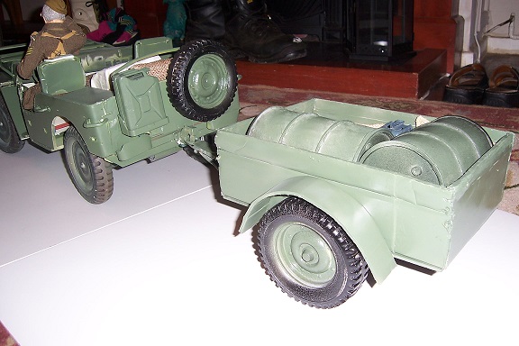

Latest build update.
IT RUNS!!!
Having changed the original 20T RC motor for a 70T
I got it running indoors on carpet and slippy varnished wood flooring.
Now for a "bit" of finishing.
I've also made a second one for a friend using the original panels as templates - that has been created a lot quicker than the original which took 8 months of my spare time. :)
This included getting side tracked making the figures and bits of cargo e.g. oil drums.
It's certainly been loads of fun.
A big thank you to everyone who has helped me with this with various tips and suggestions,
Bernard

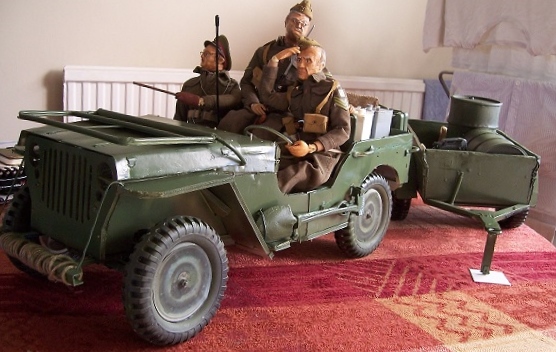

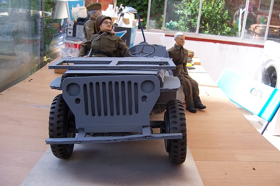

Update.
Getting on with the finishing.
I realised the front was too far ahead of the wheels so made a slight modification to the frame and associated foam board panels.
As it's Remembrance day here I though I'd give each figure a poppy to wear while I was at it.
Bern
