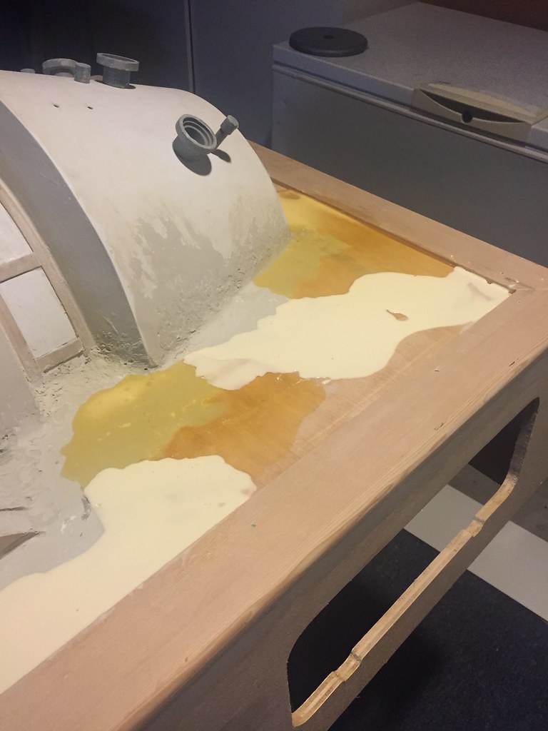

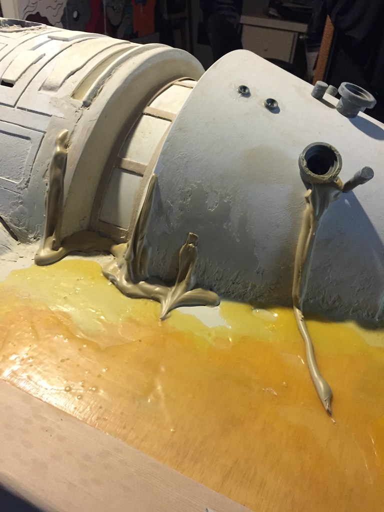

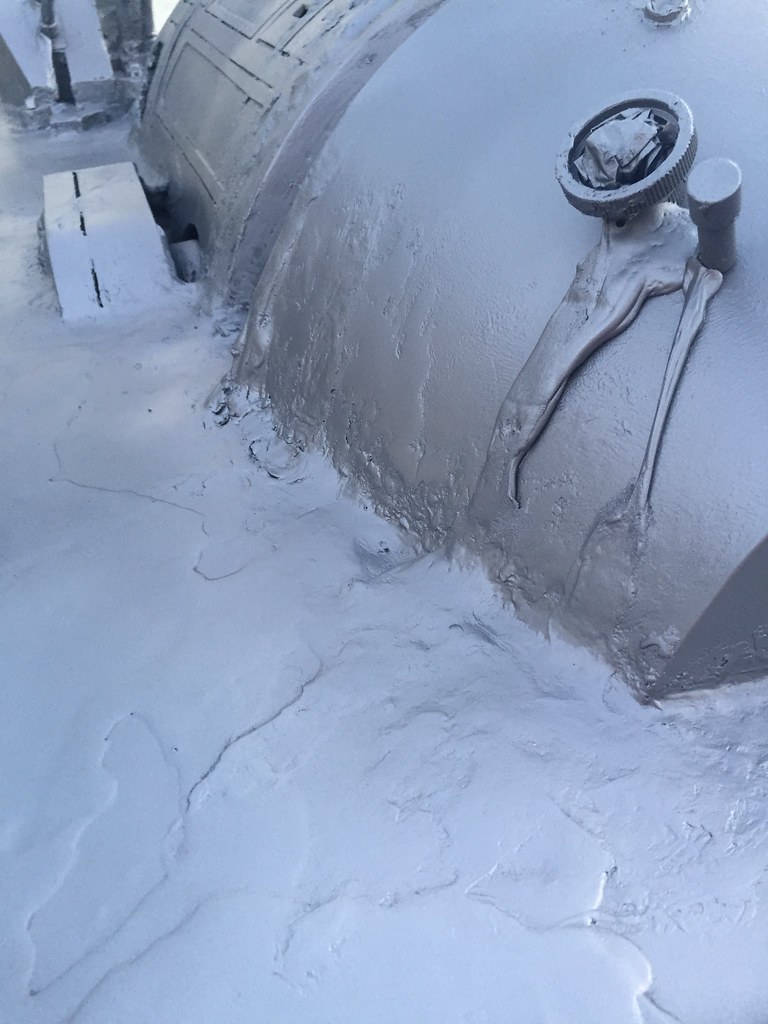

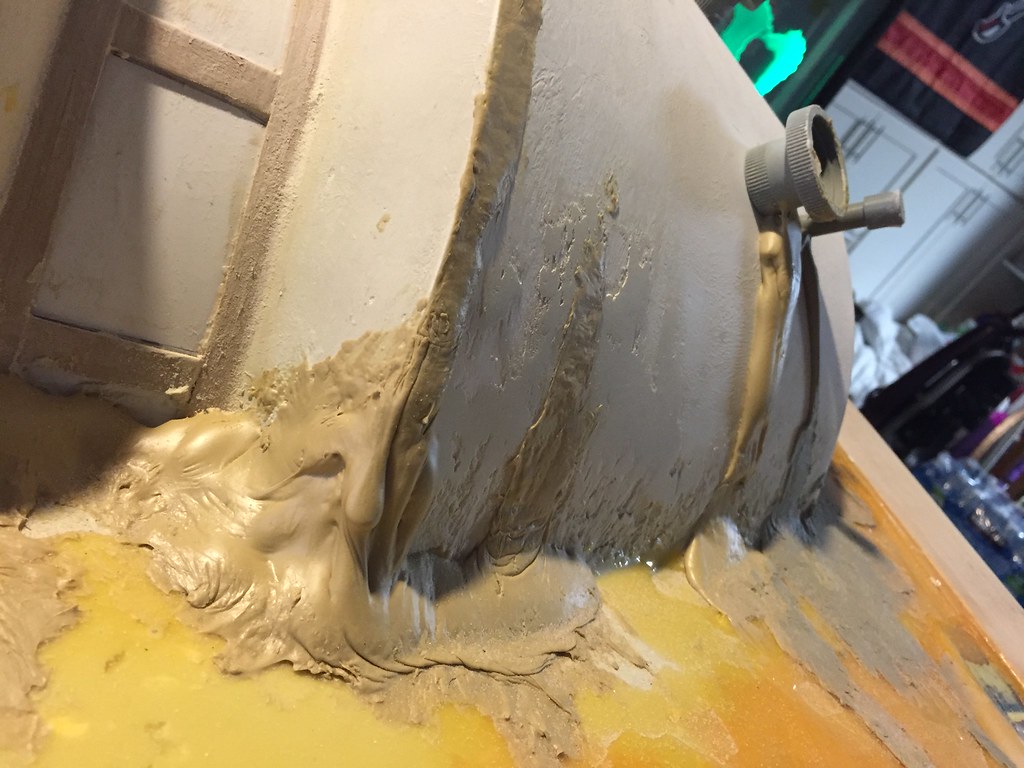

I've started the Carbonite effect. I did this with my HIC, and it worked great. After you have the bondo blending done, you just pour large puddles of glue in random areas. I then took my air hose and spread it around to thin the puddled areas out a bit.
You let the puddles dry for a couple of days and then do it again. After about the third to fourth time, the puddles start connecting and overlapping each other and it gives that layered Carbonite look
So far I'm at two layers. I'm hoping to be painting by Friday, but we'll see
First layer puddled
Then spread out with air hose
Same area two days later. Starting the second layer here

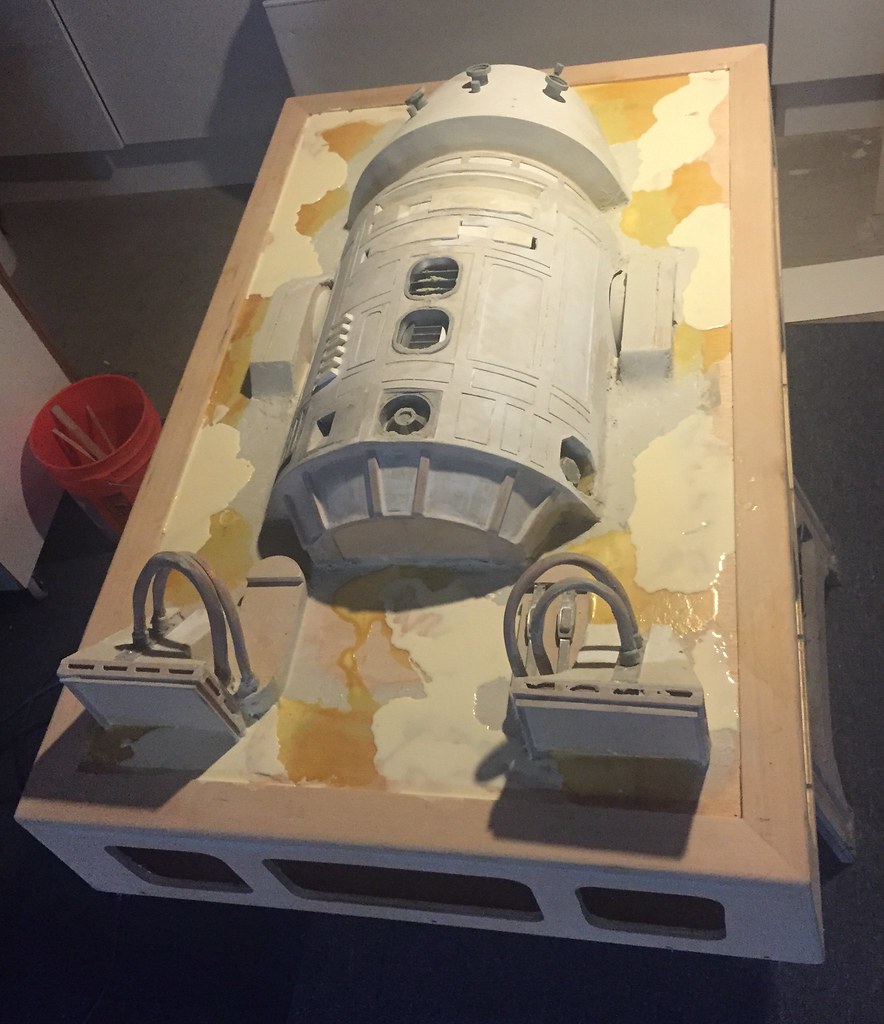

And an overall after second area is covered. It looks weird now, but after you paint it, it really comes to life
RIC by chris stephens, on Flickr
Here's a reference shot of what I'm trying to have come across on mine.

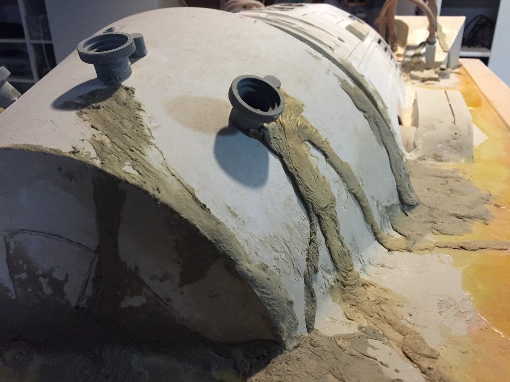

I'm using liquid nails and a big tile grout sponge. You're going to have to invision the final look after paint and weathering. Right now, there's a lot going on with different layers , each having a different color. It's going to really take shape after paint, so trust me...

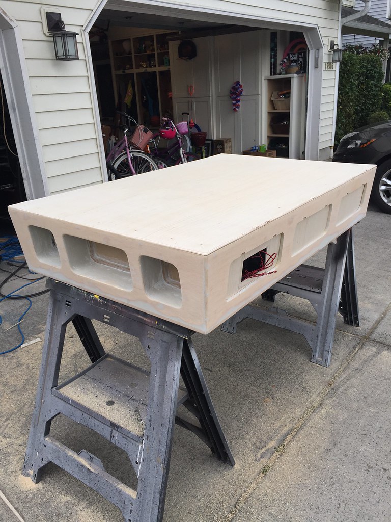

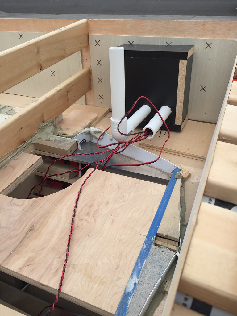

And earlier today, I put may panel backs on. I built a box in the hero panel so that I can have a place to house whatever electronics I go with. I also added PVC so that I can route the wiring from the eyes to the box. And also a second one for wiring out the back ( in case I go with a wall plug in set up).
And since this will be on display in our Jawa area, I made a finished back for it. This way we can prop it up wherever we want and don't have to worry about a hollow back to hide from view.

i didn't want to loos ALL of the detail, but I've filled them in like this ..

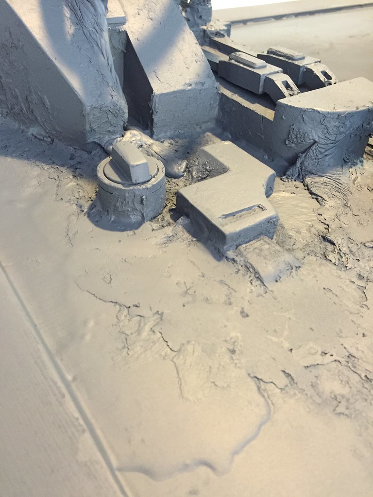

However, primer also shows you all of the flaws. I really am looking for a soft blend from the droid to the Carbonite. There are a lot of areas where the liquid nails shriveled up when it dried too... Not digging the look.
So, to take some of the sharpness out of these areas, I filled them in with drywall mud. I'll let it dry overnight and then sand it tomorrow. It looks drastic, but after its sanded , the differences will be subtle
Here's what I'm talking about. Wrinkles and if you zoom in , you can see there are some sharp edges that could be blended better
Hate to end the day on the "before"', but Hopefully I'll have some pics ready by tomorrow night of the "after"
I love the trails of carbonite off the dome greeblies. It's almost like he is crying.

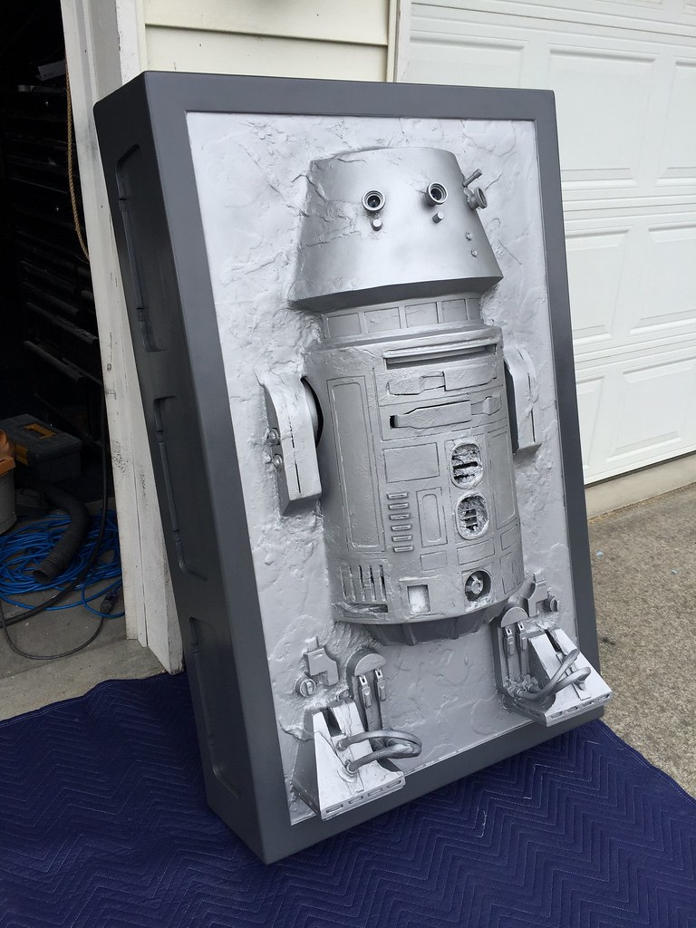

So after countless nights of losing sleep over which movie version to paint it , I flipped a coin and went with an ESB two tone.
I painted the box with several layers of nickel and black before putting the final coat of slate grey seen in the pics below. I did this because I think the box will take a lot of abuse over time and having black or metal show during damage/scratches is better than wood.
I still need to weather the carbonite area and clear coat.
