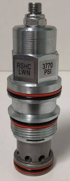

Hi, does anyone know what the shiny metal part behind the rubber bumper is? Has it ever been identified?
I'm slowly collecting the parts for a build, but so far this is the closest something that I've come across:

Also, your found part photo is a hydraulic cartridge valve (I worked selling these for almost 30yrs). I'm sure the prop part is not one of these because the larger rings would be there for o-ring seals (as shown on the valve) and that part does not have them. The o-rings are what seal the cartridge in the cavity and separate specific sections of the valve. Similar looking but I wouldn't waste a bunch of time hunting for that.
Looking at it further, it have similar shapes as some of the threepio parts (maybe a leg piston - also used on the Falcon cockpit) and see if any of the profiles look similar.
