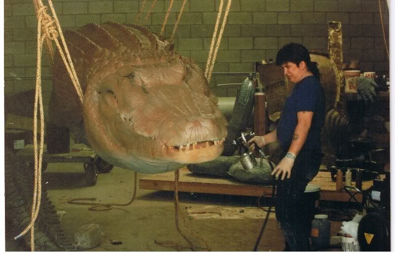

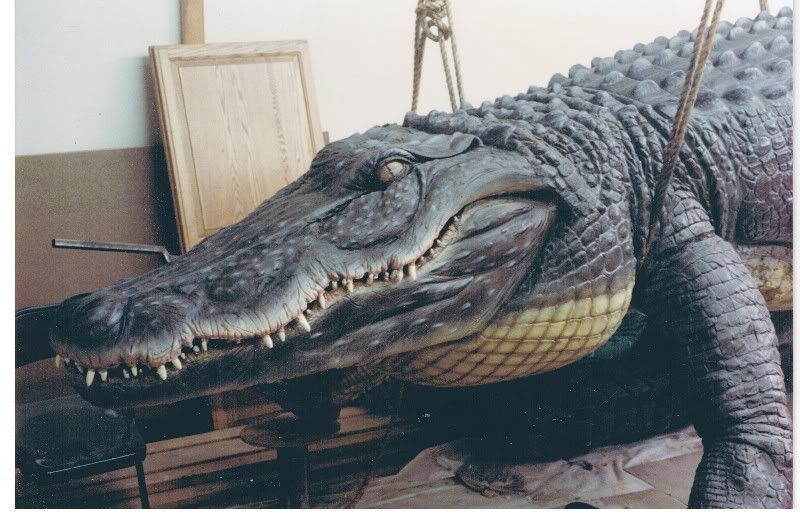

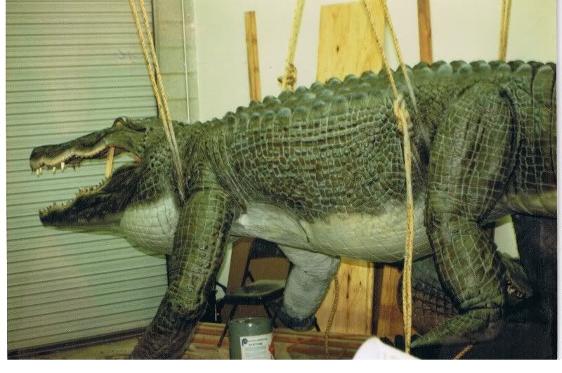

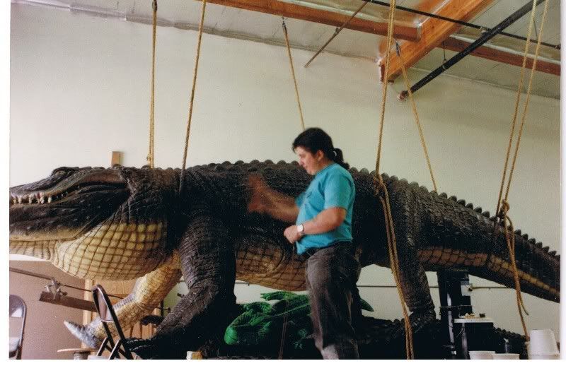

While working on a film in the 90's called Alligator 2. Kelly Mann and I built the Alligator out of polyurethane foam. The Alligator was 35 Feet long and the molds were huge. We had to make a tail with a boom on it so we could swing it at the actors.
We finished the tail in the middle of the night and loaded it in the back of a truck.
The next day one of the props guys fell extremely ill and was puking and all of his muscles were contracting at once. He thought he had the flu.
I found out that he had climbed into the back of the truck so he could sleep on the way back to his shop. He used the fresh Alligator tail as a pillow and covered his head with a tarp to keep the wind off.
Long story short he essentially had Cyanide poisoning from the escaping gas. He was down for a week straight in the hospital. Here I am spraying Urethane paint without a respirator...not too smart.
