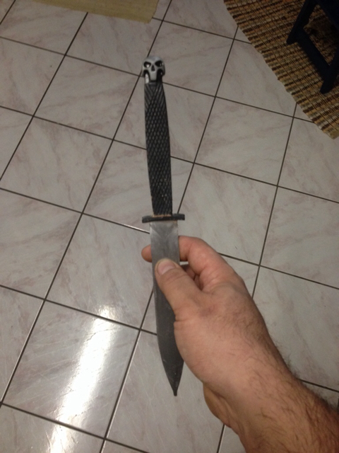

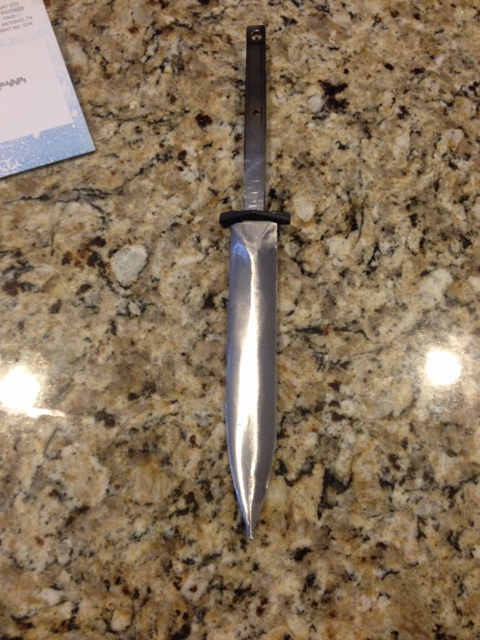

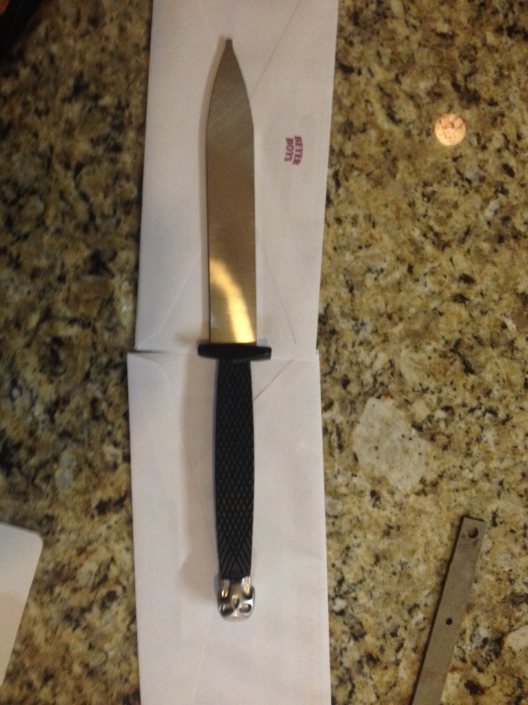

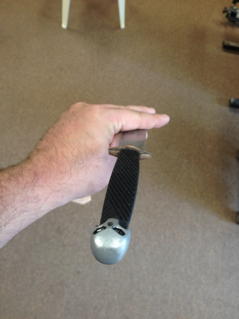

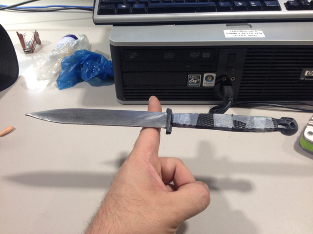

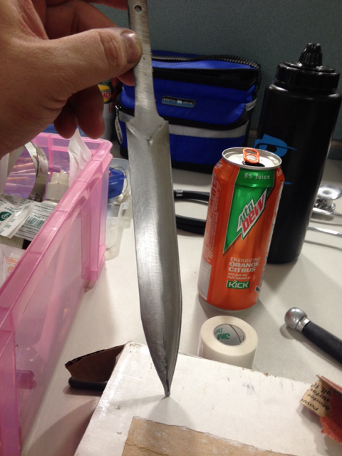

Blade testing, these aren't as long but the beefiness is there

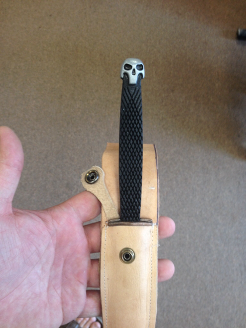

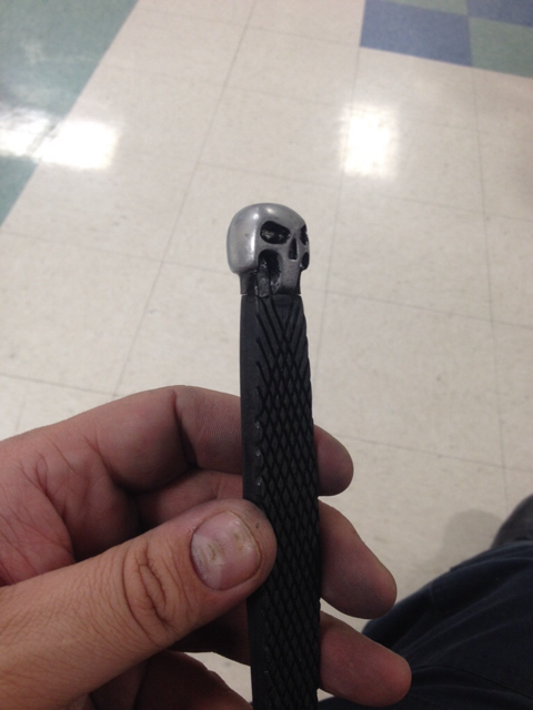

Cut the handle long ways and ground the slot for the tang... Fit the handle and glued it down..
The next one I will cast the handle around the tang so it's one piece and solid... The skull on this one will be drilled and glued down..

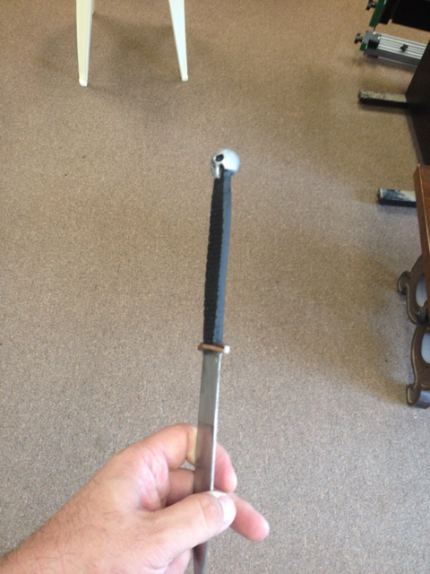

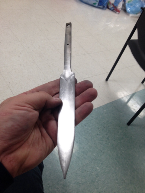

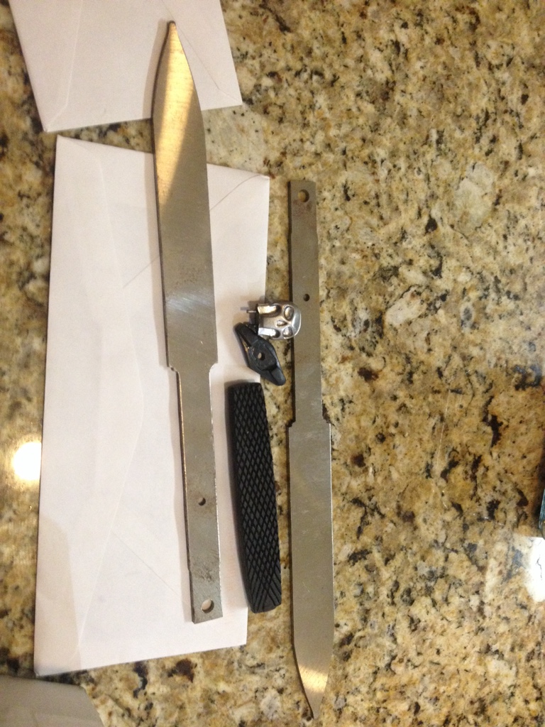

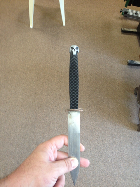

I think after I dissemble it and a little grinding here and there it will make for a good blade blank. The hilt needs to move up some then depending on the pieces I'll grind down the hilt parts to size. The pommel I might carve from a small chunk of aluminum then tap it so it can thread on. Get the parts fitted then epoxy and screw it together. Should be an ok medium between display and "real"

Yeah it's pretty close to the blade pictures. The movie blade looks slightly thinner/slimmer and maybe slightly longer then the one I found. For me the slim/narrow blade and the "triangle" grind at the bottom were important to try to match. You can get these daggers and ones similar for around $10 shipped. Check out ebay for 13.5" Ornate Daggers... if your patient you can score one for like $5-$7ish. Got mine coming for $6.

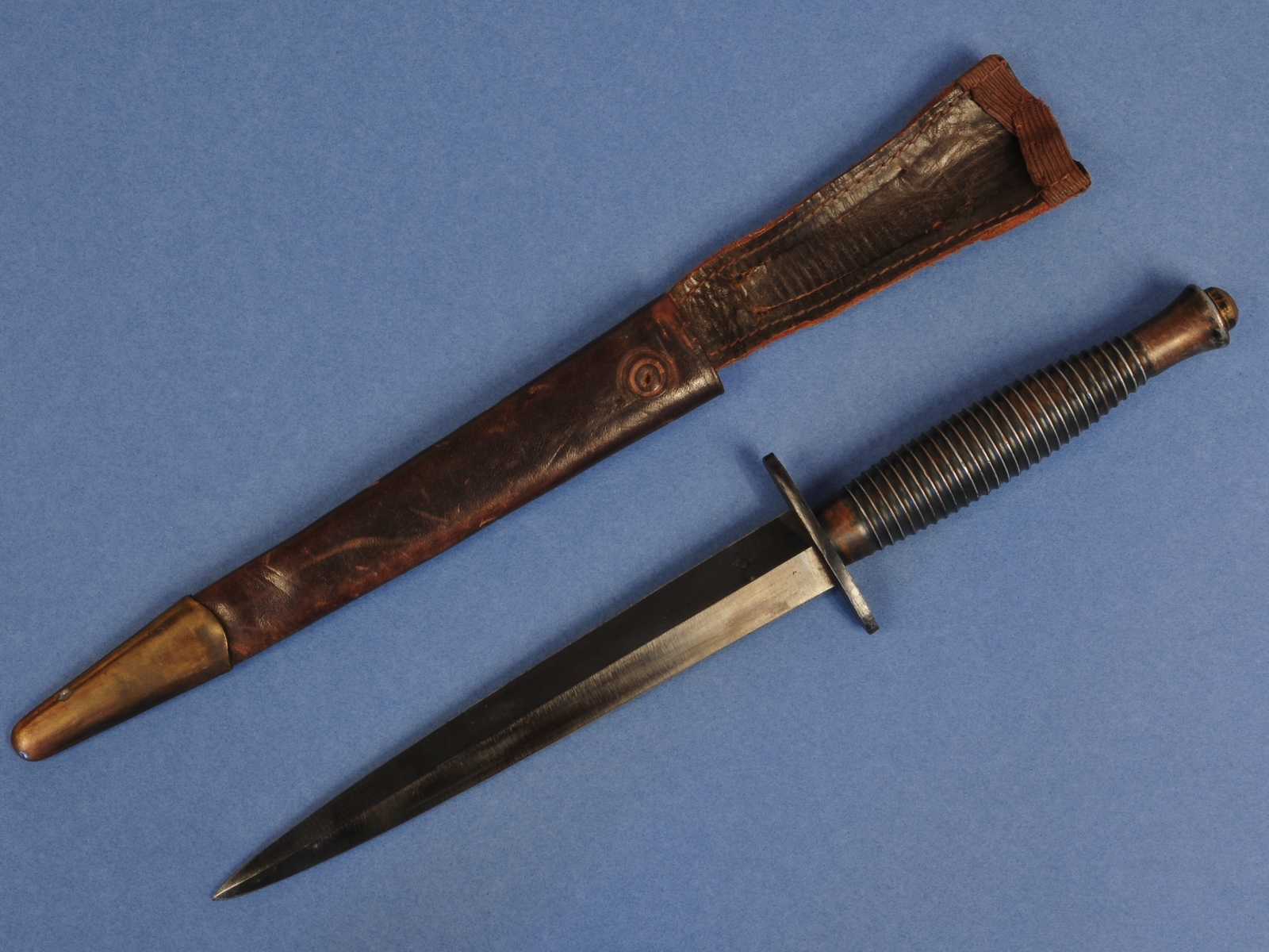

I was doing a little more research on this recently. I kept looking at the Skye Fairbarns British commando knife as being the closest comparable blade

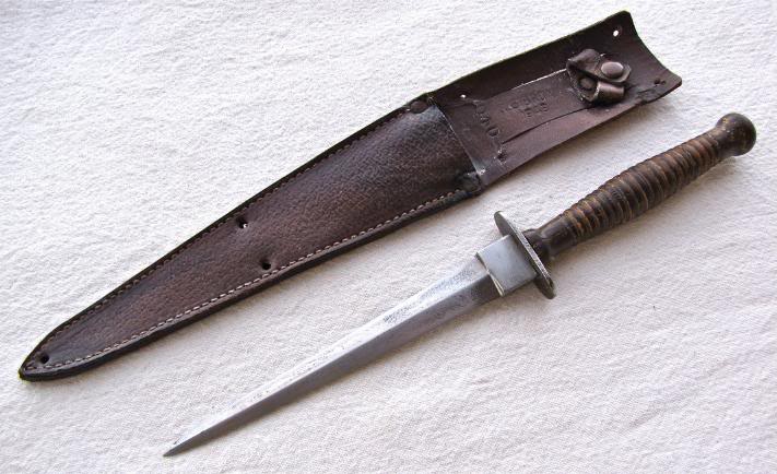

but then I remembered that the Punisher 89 production was shot in Australia! Here is the Australian commando knife.
Maybe that was the main piece of inspiration for the knife?

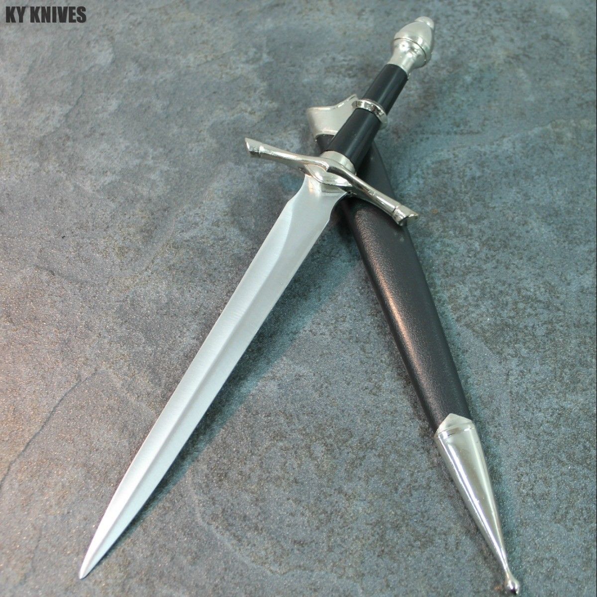

Those are pretty similar looking. I wonder what or if they used for bayonets around there. If you wanted to do one up like the British version this ebay dagger looks similar:
But I still think it was some kind of bayonet.

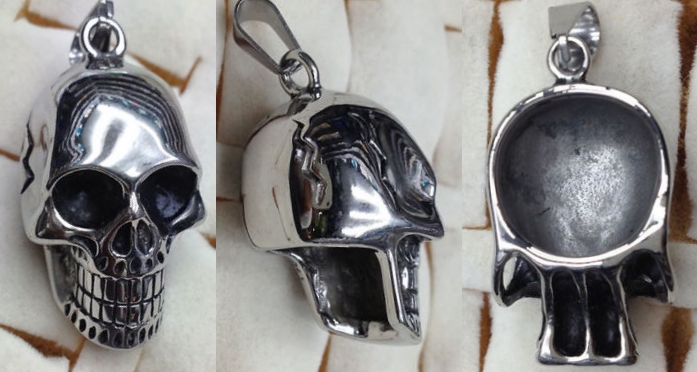

I looked around to see if I could come up with an idea for a pommel and I found this:
Its a stainless steel skull pendant on ebay for around $5. Could grind off some off the lower jaw and smooth out the features as much as possible without going all the way through. Also the inside is hollow so maybe a nut could be welded/tacked inside so it can tighten down.

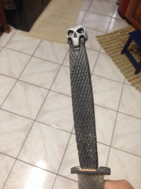

I will cast a few in bronze and you can thread it, i can do a silver patina on the skull and make it nice ...

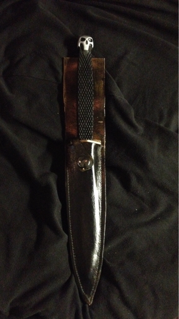

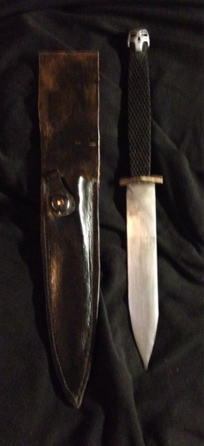

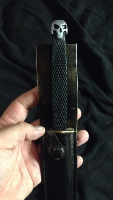

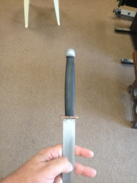

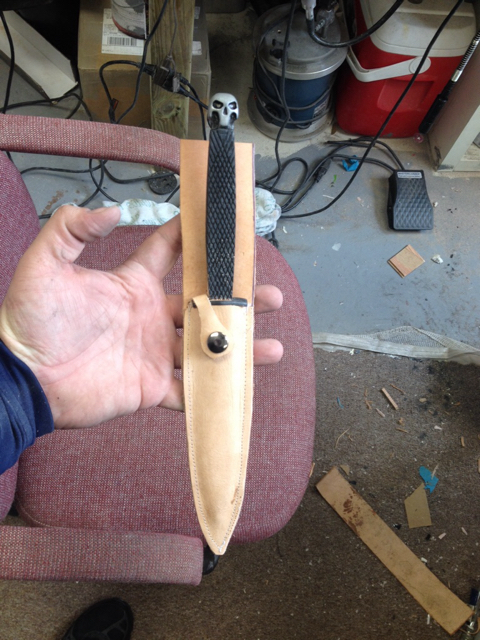

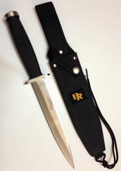

Took a tip from a fella on a Knife discussion group about a blade to match the dagger in the film, I don't believe it's the one but I was really impressed with how it looked overall and got one to turn into a replica dagger. It's called a "Pig Sticker" the particular one I bought is made by a company called "Bladerunner"
That is beautiful. Epically beautiful. *touching my screen in a perfectly natural and not in any way creepy manner*
Have you considered a quantity of these?
