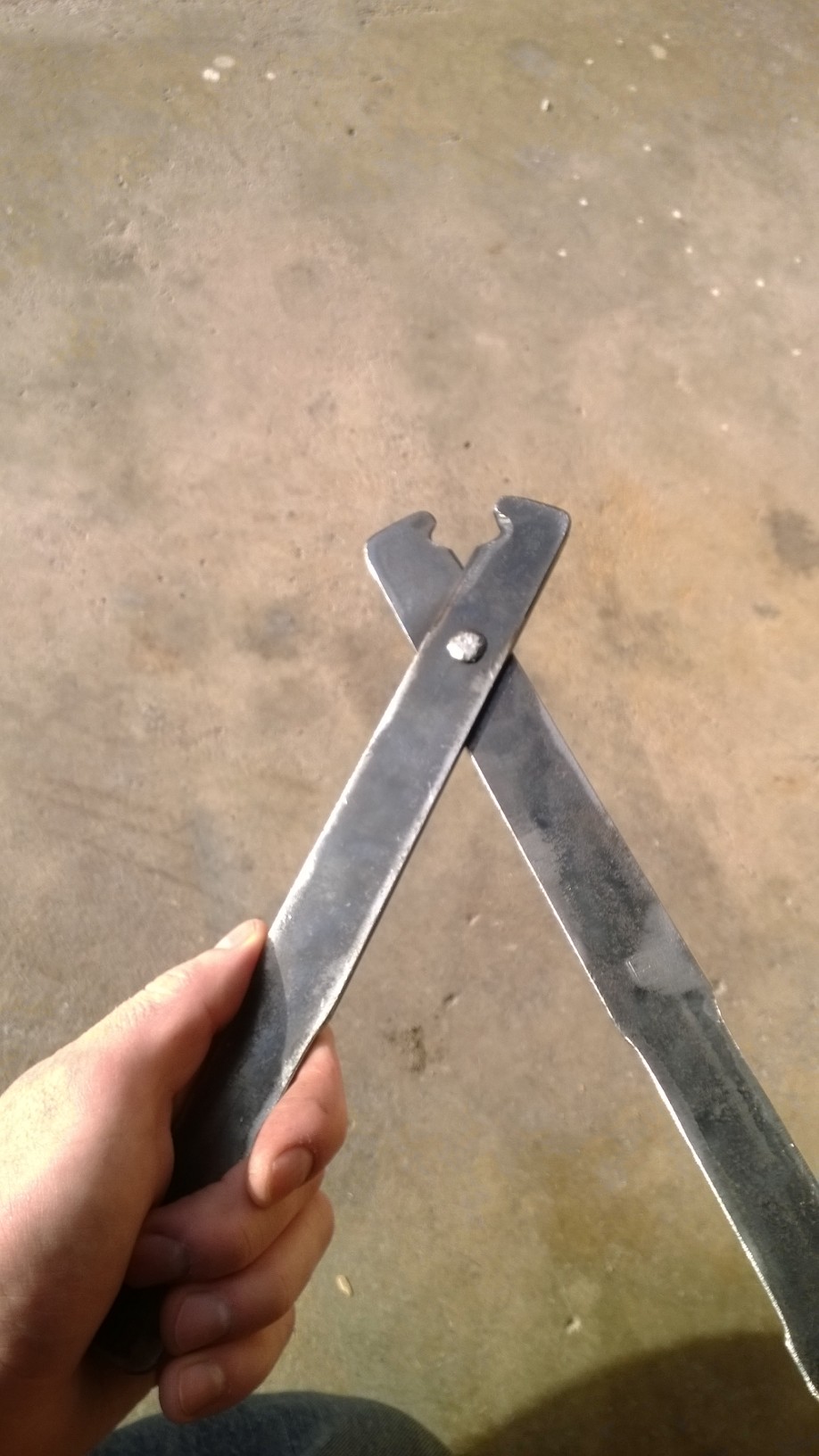

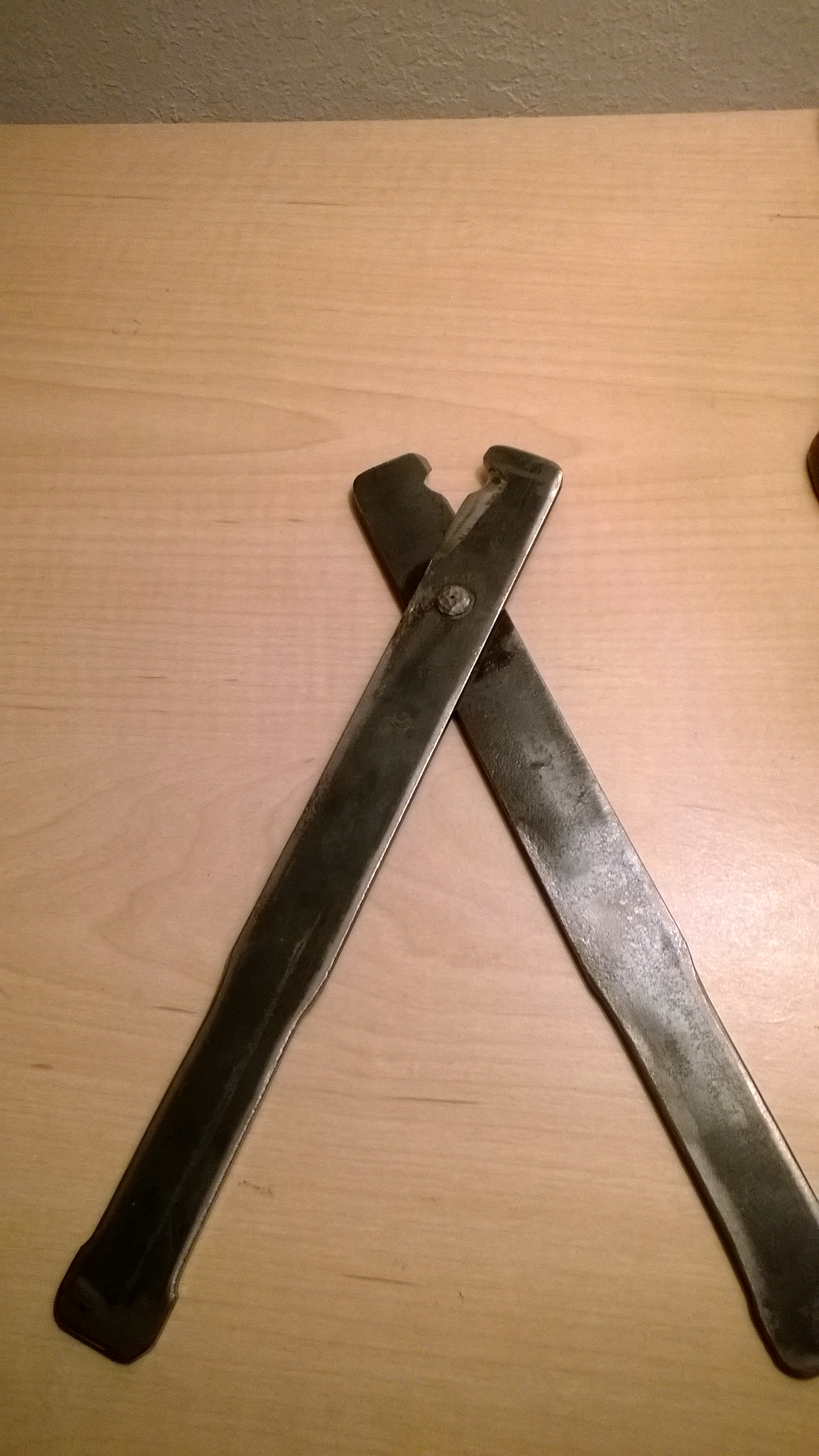

this is what i have so far. the knife blade im sorry to say i attempted to make into a saw back blade and i could salvage it. the wire cutters are roughly the ones from great escape. i make the rivet by hand and have been able to cut medium thickness copper house wire. im going to leave them out side to rust up a bit. still looking for materials for a wrench and a digging pick. so this is what i have done today.

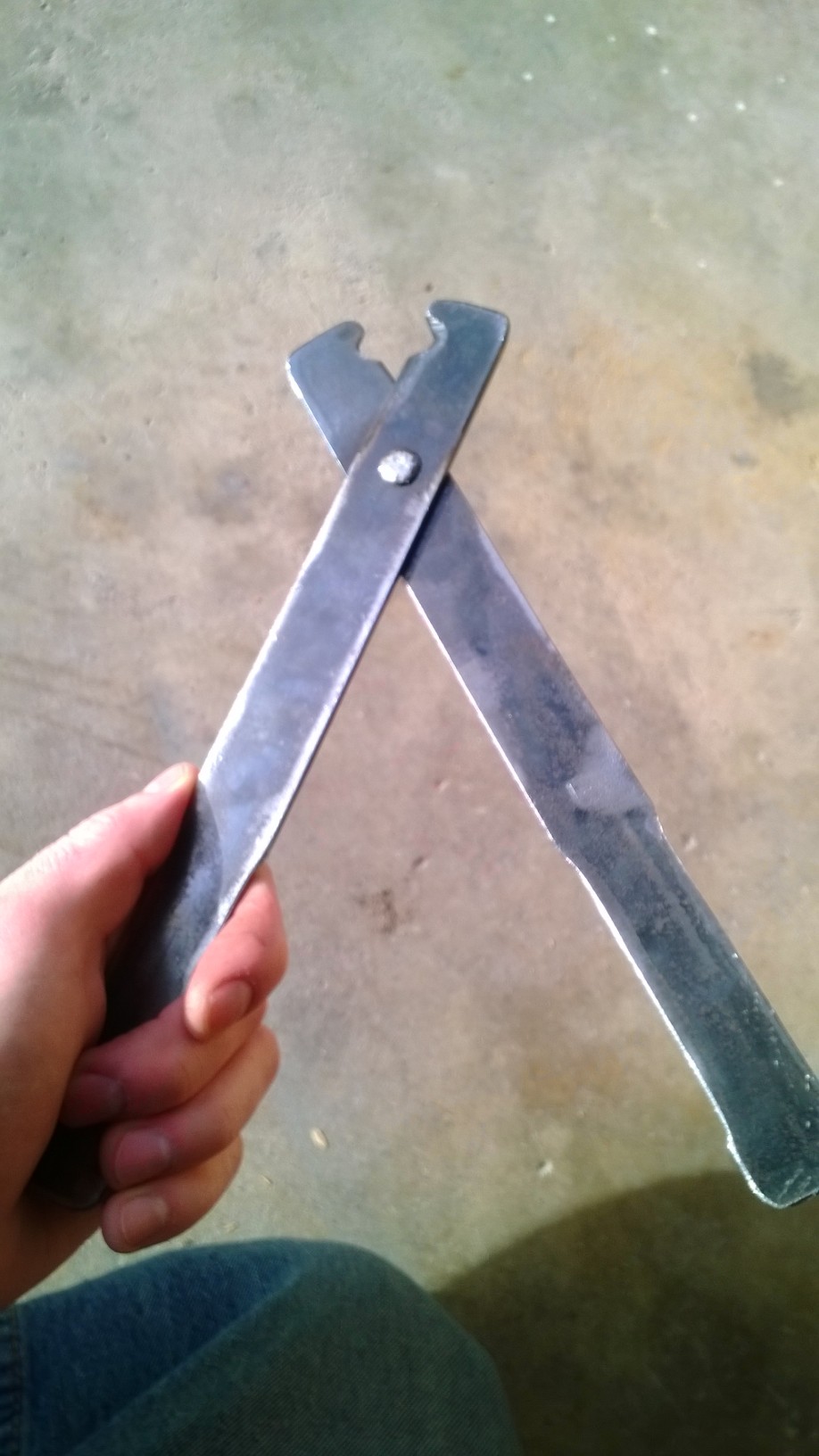

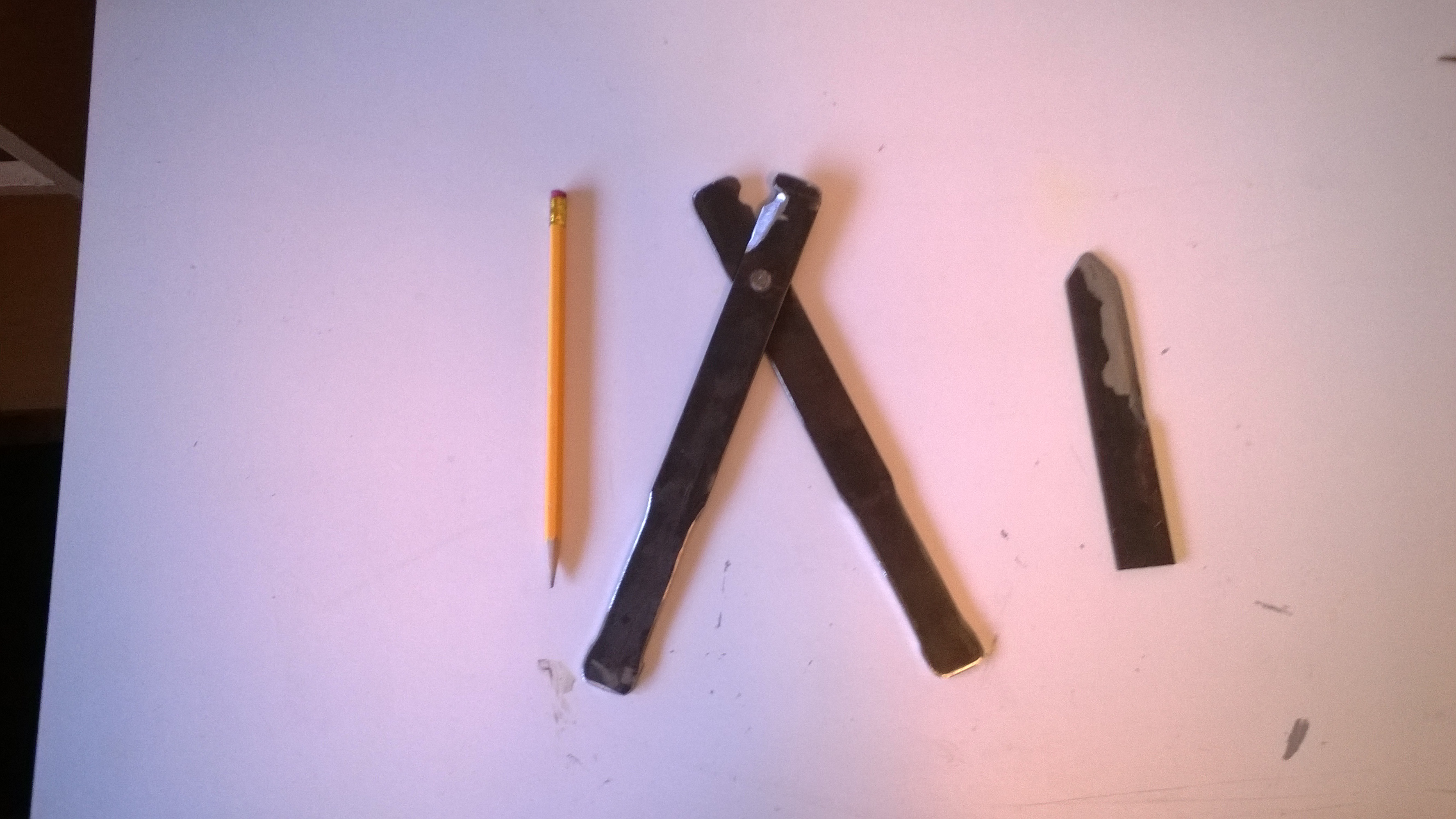

work a bit more here and there. i heated the jaws up with a torch and quenched them in oil. weathered a bit. still working on the rest of the kit.

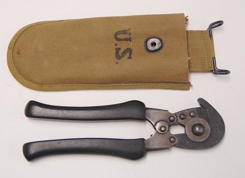

This is what actual WWII issued wire cutters looked like. These same ones were still being issued well past Vietnam. My 1SGT was a green beret in Nam and still had a pair on his web belt during the GWOT/OEF.wirecutters.JPG Most WWII survival kits would not contain wire cutters because they'd be taken away if caught before being taken to a POW camp. Most escape tools in a POW camp would have been crudely made with whatever they guys could find. Yours look good.
