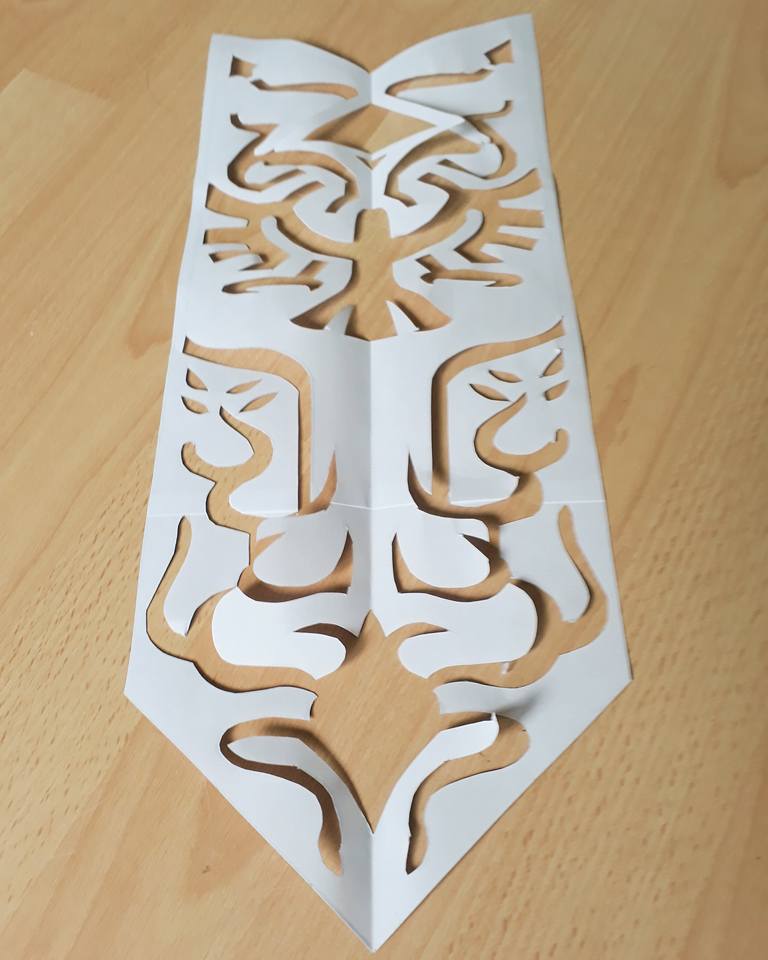

The breastplate started as a simple basic breastplate. I made the patterns by using paper and for the cup pattern I traced a bra cup. I don't use the sandwich method unless you also see the inside on your finished armor. The details were made by using worbla scraps, rolling them into snakes, and after adding vaseline inside a Tri-Bead roller I pushed the hot worbla in. Voila, 3D edges! This saved me some painful fingers, but I still had to sculpt all the hot worbla in the right shapes. This breastplate took four days if you count in all the hours I worked on it. I also had to take too many breaks from sore fingers...
View attachment 749415View attachment 749416View attachment 749417
