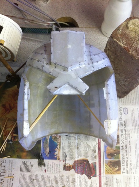

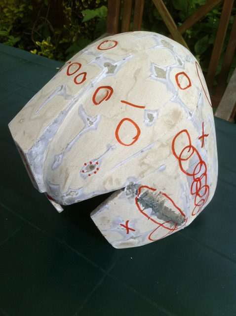

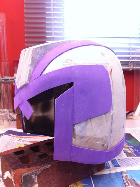

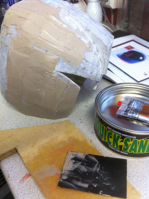

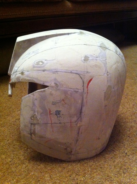

Here's some piccys to match up with the request :)
