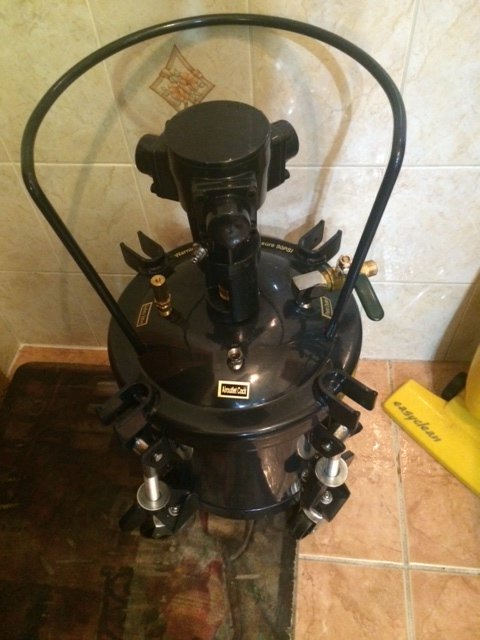

I saw your post and tried to do what you did, but I made a mistake and bought the wrong pot. It has an automixer on top. Can I do the same thing with this you think? Or should I try and return it?

I'm pretty busy right now so I can't help much, but I can talk you through it here. You have the 5 gallon pot, mine is the 2.5 so it's a bit different. Follow Bigturc's thread on his 5 gallon conversion. With either pot it only takes about $20 worth of parts.

Yep, but be careful as this is the smaller 2.5 gallon. Not the big 5 gallons we got at huge discount!
