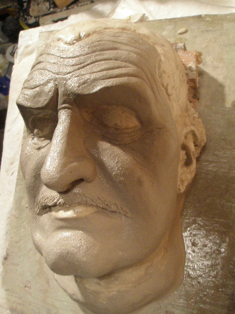

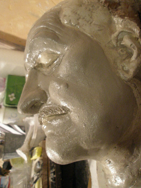

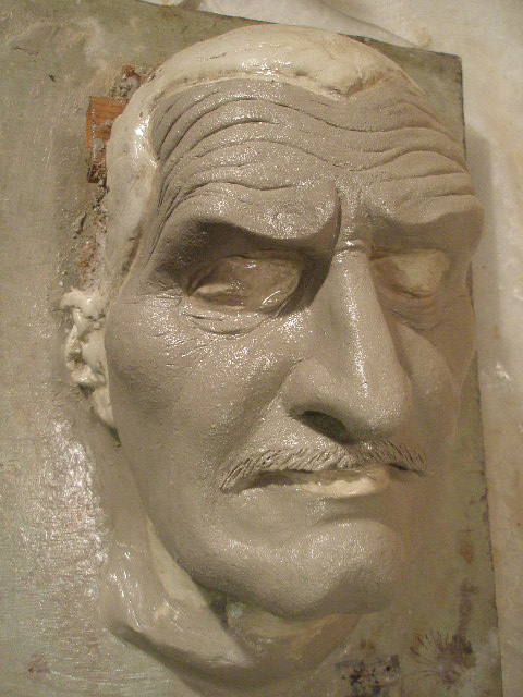

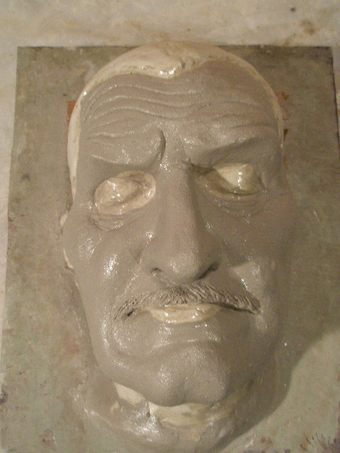

This is my Vincent Price that I've needed to cast in silicone (forever!).
Wow
Wow, Somafoama looks cool, but way outside my budget.
Thanks for the heads up on adhesives and all that. I think I'm gonna try solid 0-10 or 0-30 for now. I have some powered pigments that I used for hot melt vinyl to tint. Yea it's too complicated to core already, though I've done that.
By "a light soap release", you just mean dish soap or something else? Bar soap?
