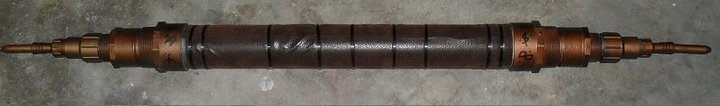

Here are a couple of shots of the spear tip--Now im going to start on the painting and final touches!!
Here are some more pics-- trying to get a little done here and there. Still have to darken up the leather on the handle.
Works pretty cool too
Lookin sweet man. I'm still so in love with the concept. I can't wait to start playing around with my own.
I know you've been busy with your Arnold Expo, but have you had a chance to try etching into the metal extension rods? I think it is a cool idea and would love to see if you can make it work for you.
