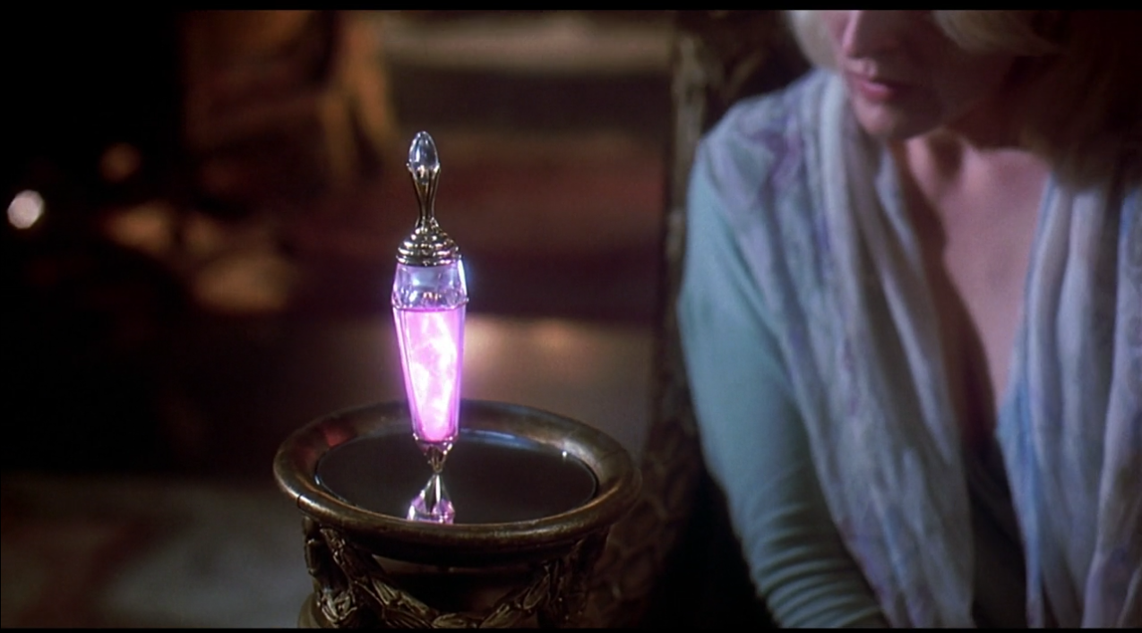

Here you go. Looks to have a magnetic wiggle/sway when Lisle placed it down on the mirror, but it could have been all CGI (since there was moving potion inside). The rest of the shots looked like it was completely stationary. Likely connected to the mirror with a rod or something.

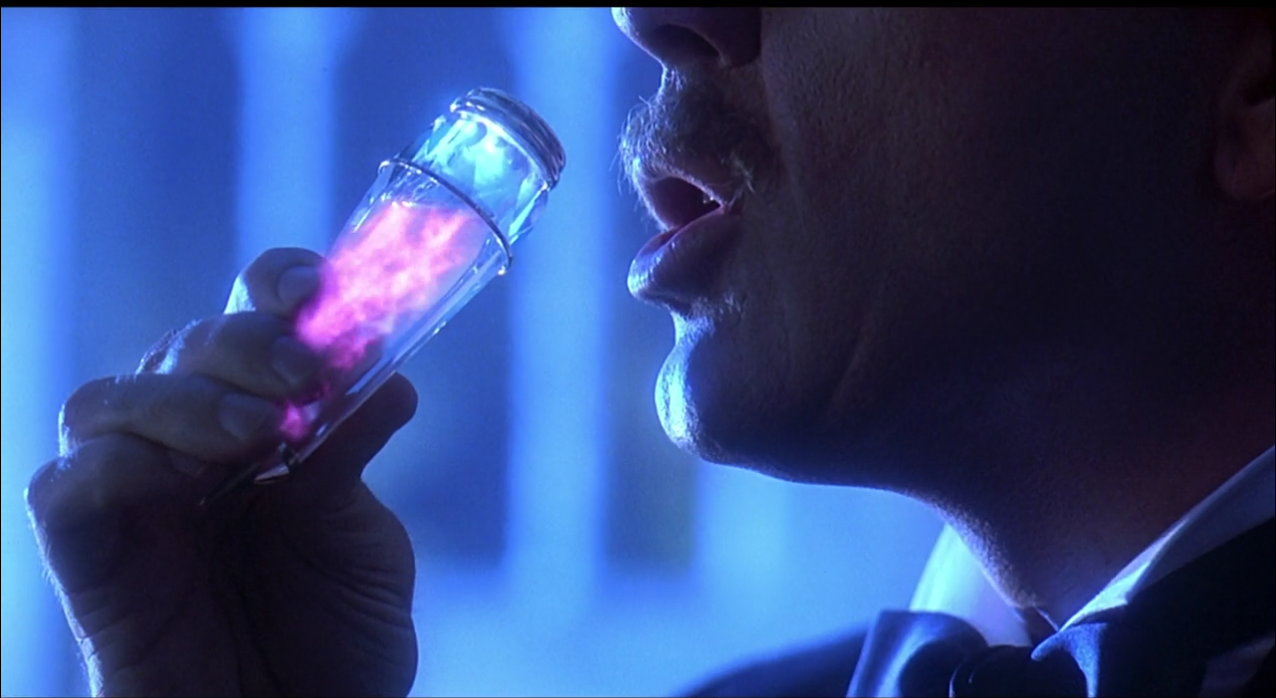

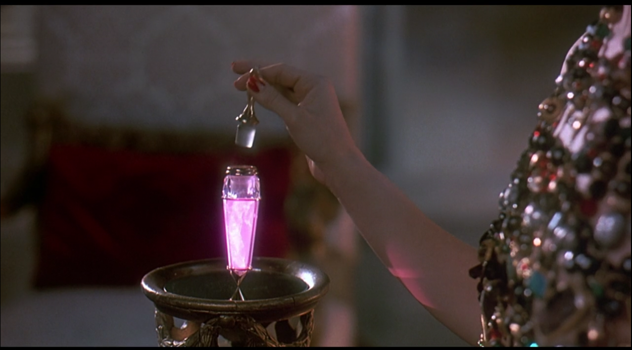

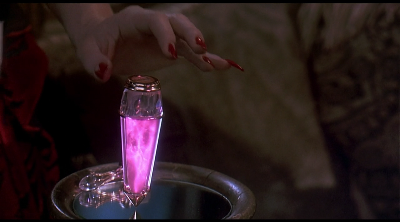

I've taken a slew of screenshots from Amazon video. These aren't blu-ray sharp, but they're not bad. Below are a few of the vial. If anyone wants more, shoot me a message and I can send em your way.
Screen Shot 2017-08-01 at 1.38.00 PM.png Screen Shot 2017-08-01 at 1.46.04 PM.png Screen Shot 2017-08-01 at 1.50.37 PM.pngScreen Shot 2017-08-01 at 1.52.46 PM.pngScreen Shot 2017-08-01 at 2.07.46 PM.png Screen Shot 2017-08-01 at 2.09.52 PM.png

Based on its behavior, I think we're probably looking at three props.
One has either a magnet or a piece of ferrous metal in the top and when it was set down on the table, an electromagnet just off camera and right above it was turned on just before Lisle let it go (in order to keep it from flying out of her hand or being tilted as she was setting it on the table). The table is stationary, so it would be easy to build an electromagnet and position it at just the right height to attain balance for the prop without risking it flying up into the magnet.
After it was set down, they switched it to an identical prop with a shaft running through it into the table for the scenes where it's either a long shot and you can't show the magnet, or Lisle interacts with it (like taking the cap off).
The third was a stunt version that was solid clear cast resin.
I don't believe it was composited digitally into her hand, because in other scenes with digital compositing you can still see some artifacts of compositing if you slow it down and look at it closely, but the scenes with the vial don't have anything like that in them. And prop guys always try for the simplest approach first, and a physical bottle suspended by a magnet would be easier to make than a CGI version or a bottle suspended by a bluescreen arm and then digitally painted out, and would do the job just fine.
