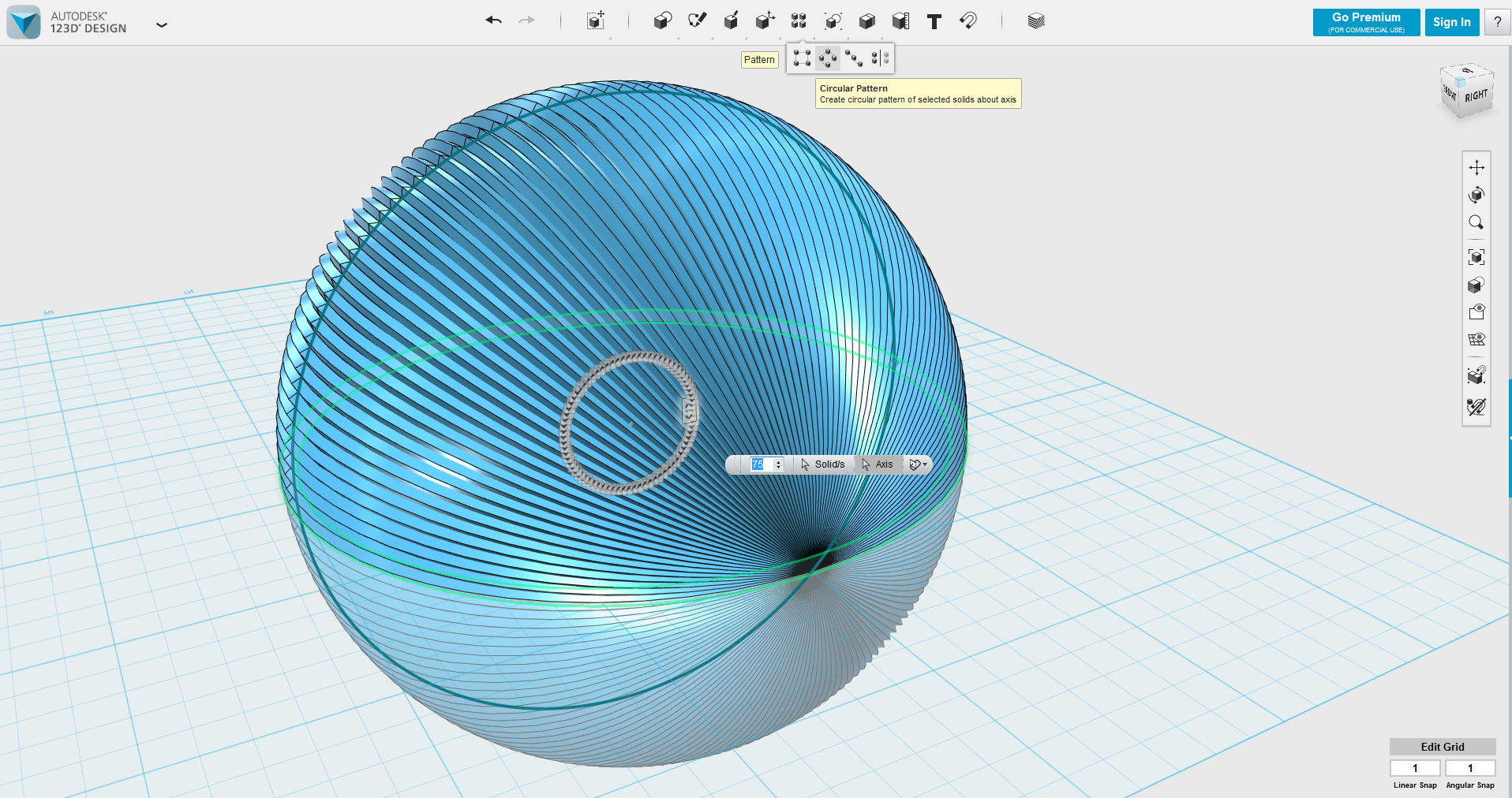

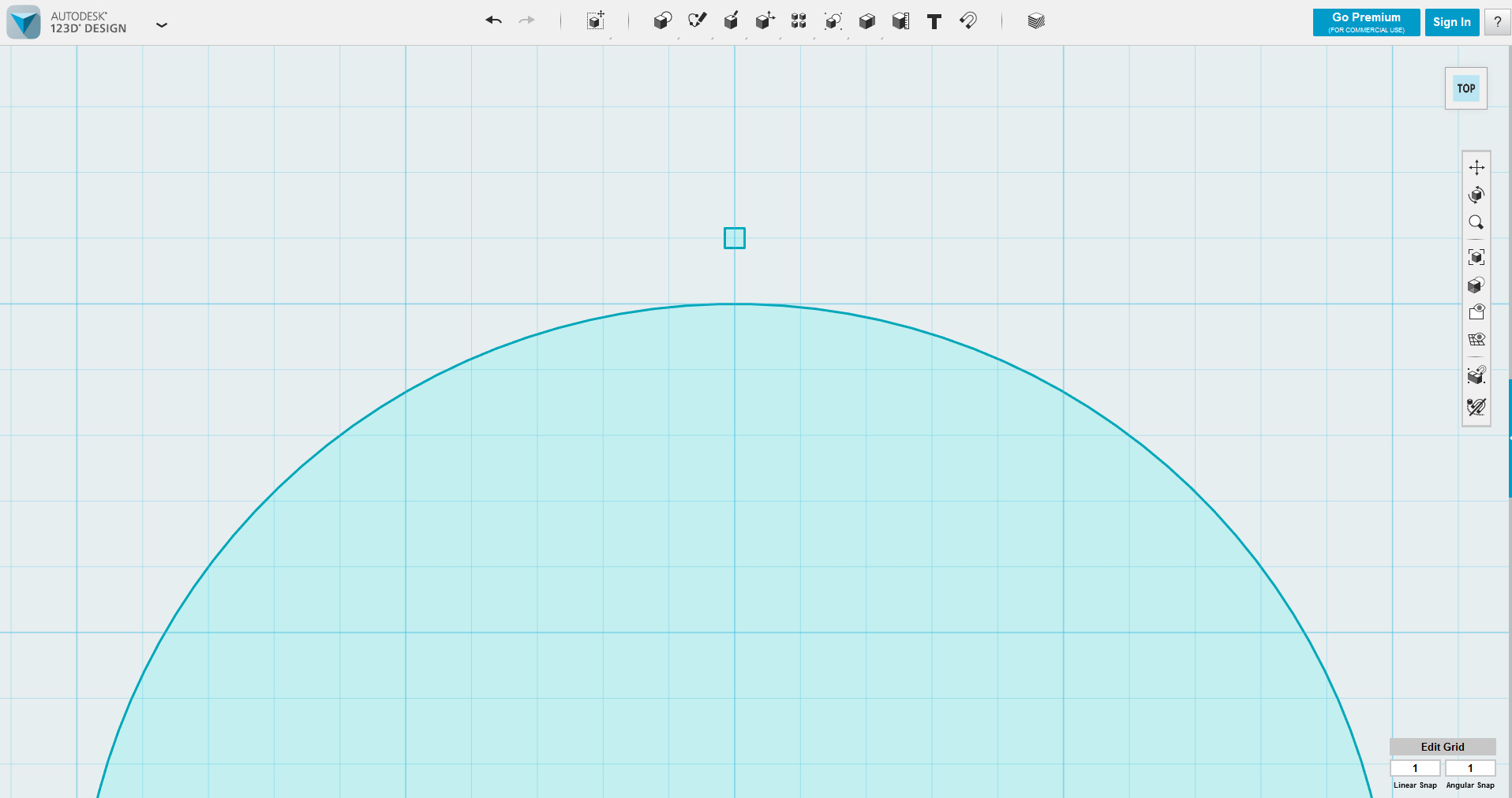

Ok so as promised, I've written out a little how-to for my process for modeling the knurling on the pokeball. I went into this not actually knowing how knurling worked and after a bit of research I figured out a decent method. It's not 100% accurate and I don't recommend using this method if you need something to be an exact size. However this is mostly for aesthetics (though it does make a decent grip) and my printer can only print a certain level of detail so it works just fine.
so to start, the pokeball is 100mm so I start with a circle that is the same size. Then I create a 1.5x1.5mm square.
then I turn the square 90 degrees on one axis and 45 on another (as seen above). The size of the square will determine how deep the cuts will be. I'm planning on clear coating this to get rid of print lines so I made mine pretty deep. If you have a nicer printer than my printrbot simple metal you may way to shrink the square a bit.
I apply a sweep modifier to the square using the 100 mm circle giving me a ring. The center of the ring is the perimeter of the pokeball and the points are sticking into it. This is very important. If the center line is above the perimeter then your knurls will have this square shape which is also cool but it might not be what you're looking for.
Then I use the "Circular Pattern" tool to make 75 copies of the ring. This will probably be pretty laggy if you don't have a decent enough computer but buckle up, it's gonna get way worse lol.
then select each of the rings and combine them into one ball. This can take a while to do so be patient before closing the program and yelling at me that it didn't work T_T.

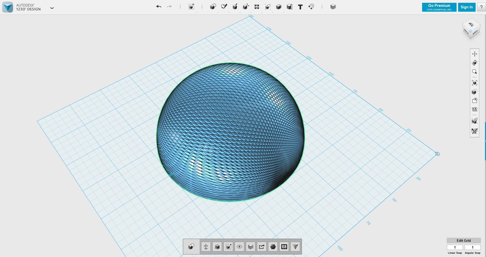

Then duplicate the ball and rotate it 45 degrees as shown above. It might help to cut the ball in half. For whatever reason this made it slightly less laggy for me. Then combine the two spheres for one last reaaaaaaally long load time. You might want to do the next step to both spheres and then combine them last. Please note that the top of the ball looks great but the farther towards the center you go, the more this method falls apart lol.
Then I created a cube the size I wanted for the grip (20x40) and gave the corners a 5.25 filet modifier. Then I booleaned the knurling sphere with this and it gave me the shape above.
Then I took the leftover strip and boolean subtracted (I think) the pokeball top and it left me with the image above! If you have any questions please feel free to send me a message and I'll try my best to help you out :D
