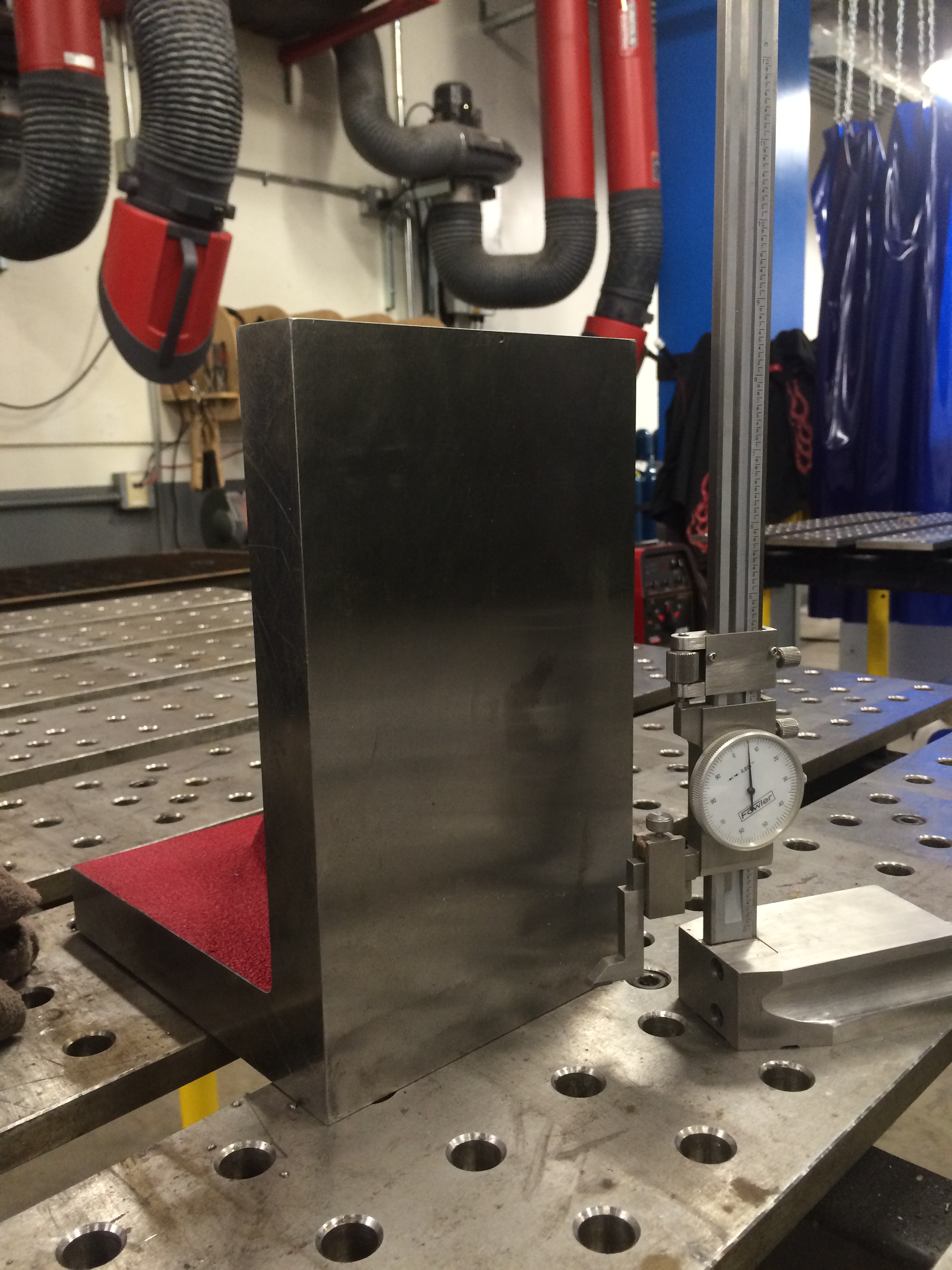

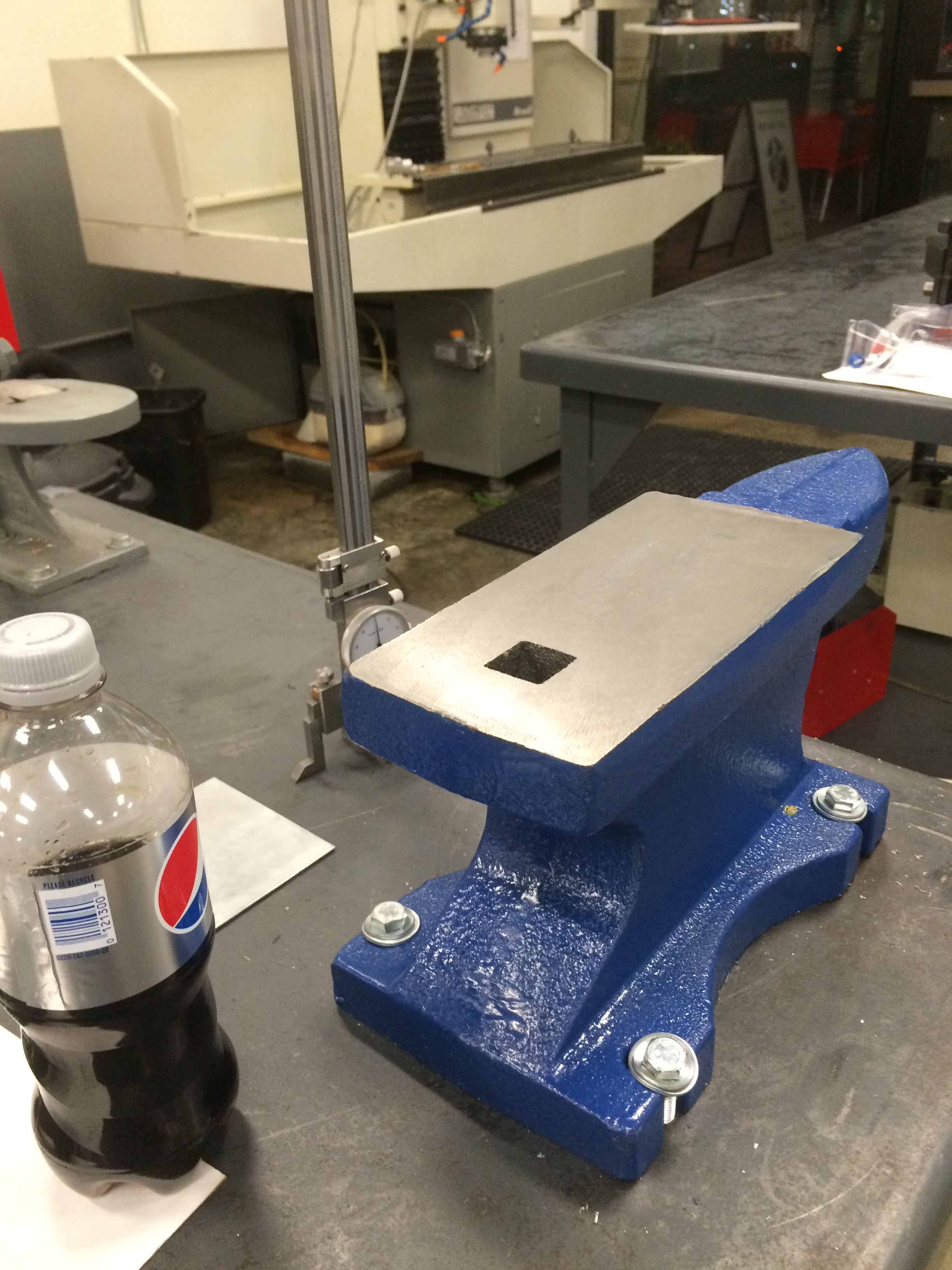

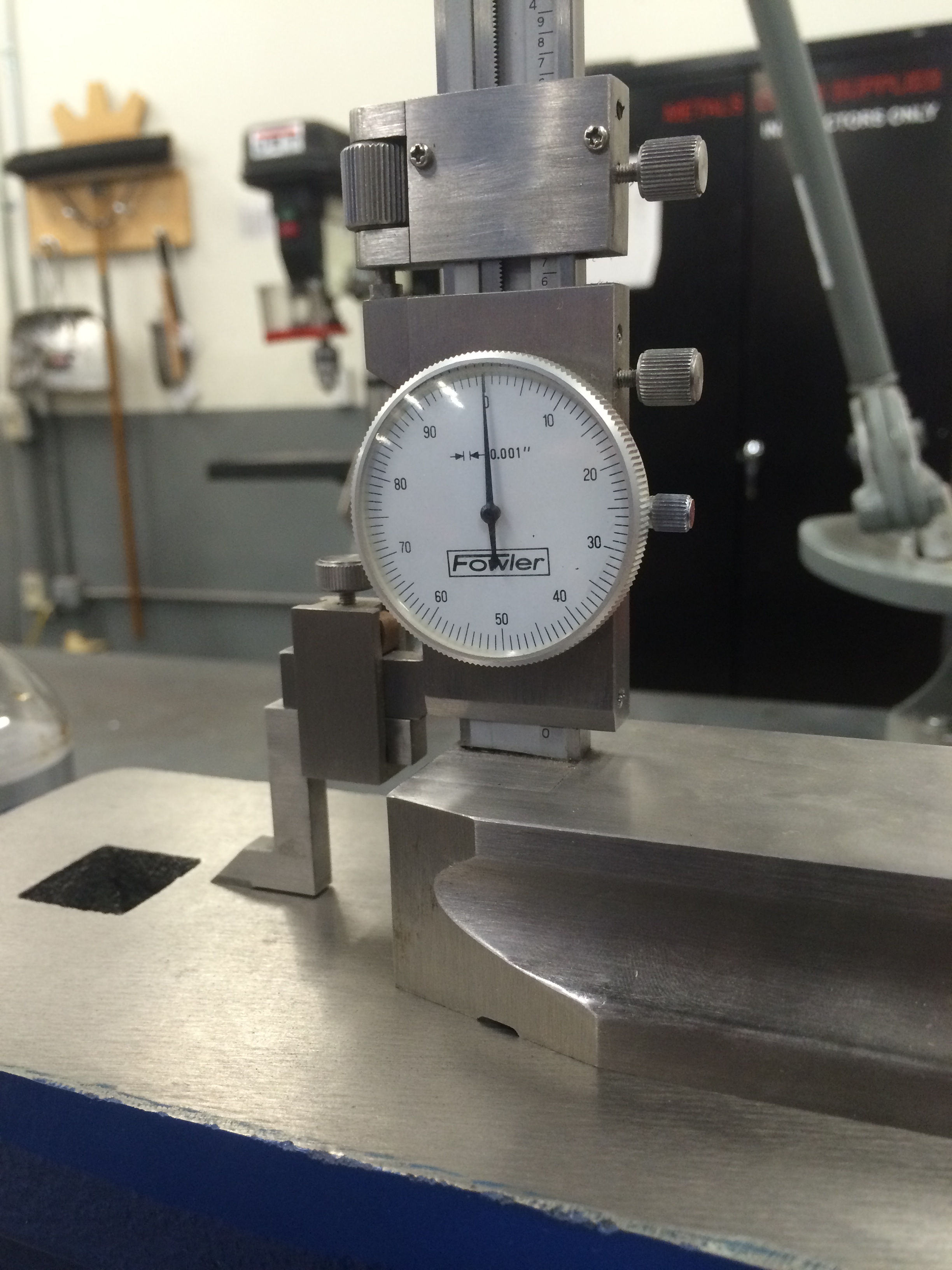

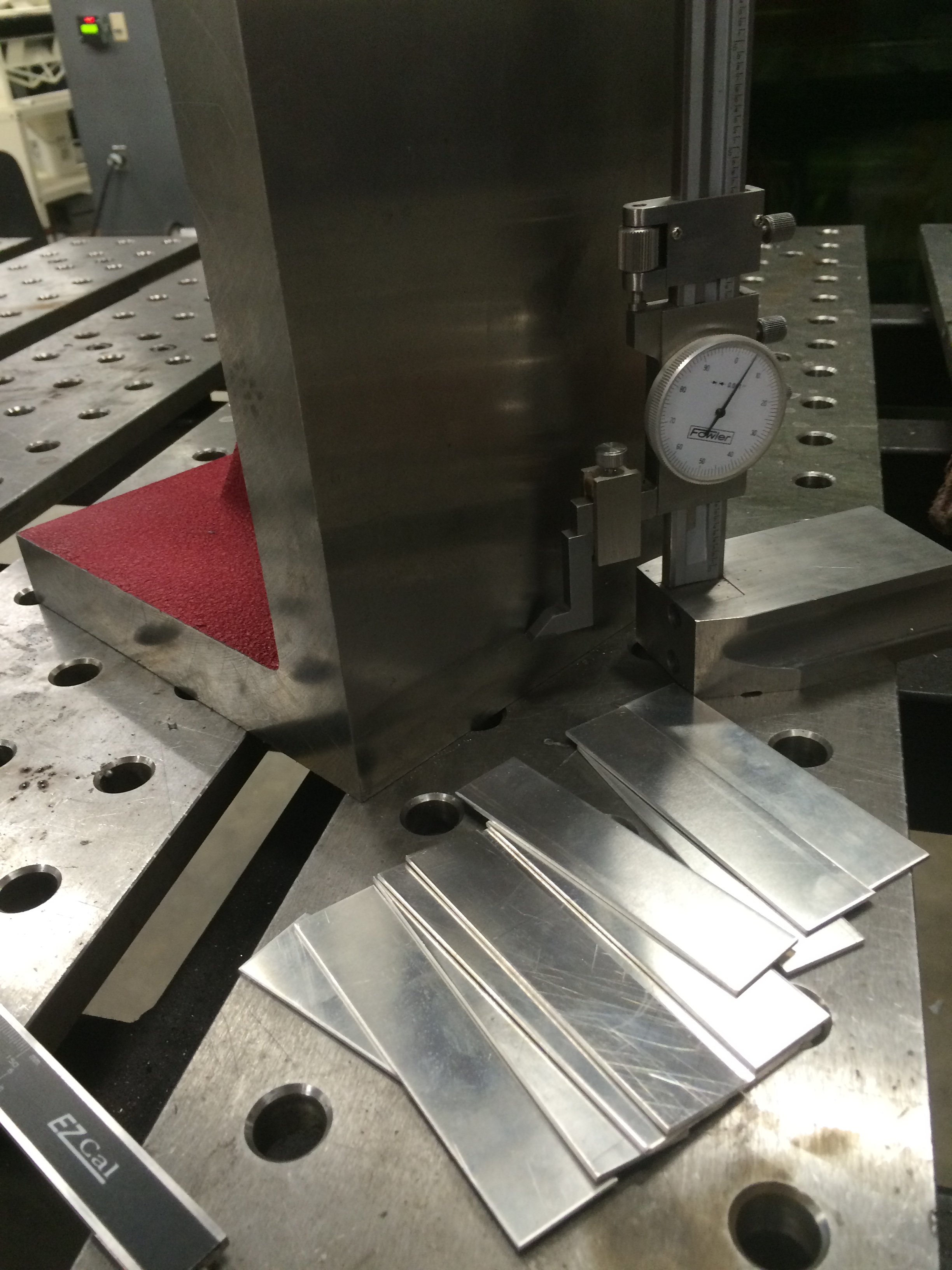

It's a video showing three methods for precisely laying out holes for drilling, two of which use a height gage, and we've got a
sweet height gage in the machine shop.
Just look at all that sweet, height-gagey deliciousness!
The thing to the left of it is... um... one of those big steel machine shop thingies that's, like, all straight and flat and stuff. I don't remember what it's called, but my groin muscles are
really pi§§ed off at it, so maybe it's best we're not on speaking terms.
So I thought to myself, "Self, why not adapt tubalcain's old-timey shop method to make insanely straight and exact cut lines, which I can then make grotesquely jagged when I try to cut them out on the bandsaw?" Okay, not exactly, but that's the way I should've said it to myself. So yeah, it's actually my fault for not warning me I was headed for trouble. My cuts did come out nice and straight later on, just not on the bandsaw....
To set up for this, first you need a very flat, perfectly smooth surface. Machine shops usually have a slab of perfectly ground steel for this, but Techshop doesn't seem to for some reason. Maybe they don't like flat things.
Here's what I came up with at first: a nearby anvil (new to the shop, so I missed it at first glance). But not so great, because there's really no room on it to work. But it was fine for making sure the gage was good and zero was actually zero (and when, you ask, is zero
not zero? When I'm the one doing the math, that's when.
sigh.).
So I realized the welding tables are perfectly flat, and as long as I used the side farthest away from the actual welding positions, it wouldn't be a lunar landscape of tiny steel slag drops. Turned out it was, just much less so, which left me room to set up and slide my gage around with relative ease.

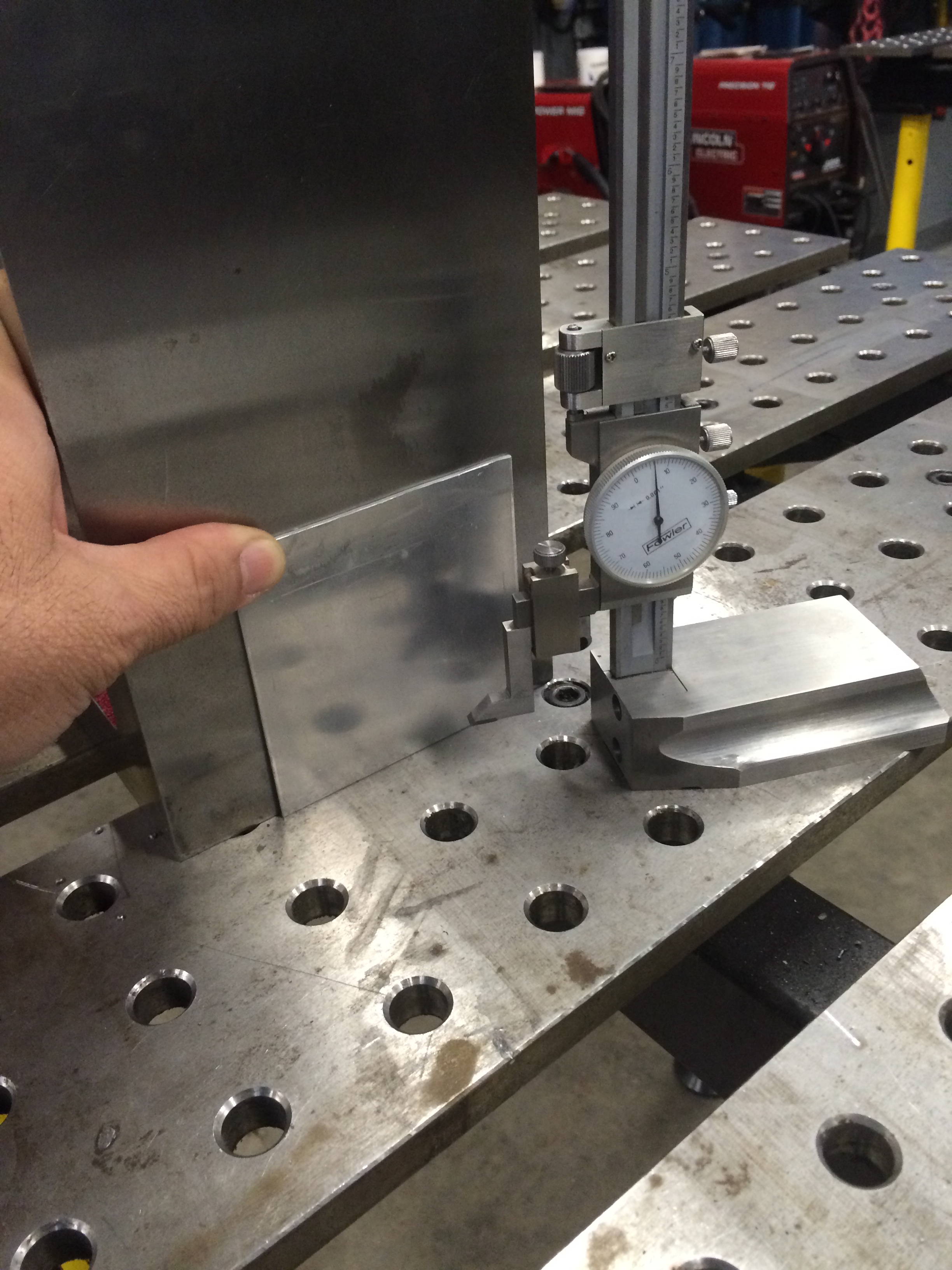

So you start by figuring out the width of your fins, which I got by measuring the ones on my Wand phaser: 0.906", give or take a thousand feet. Meh.

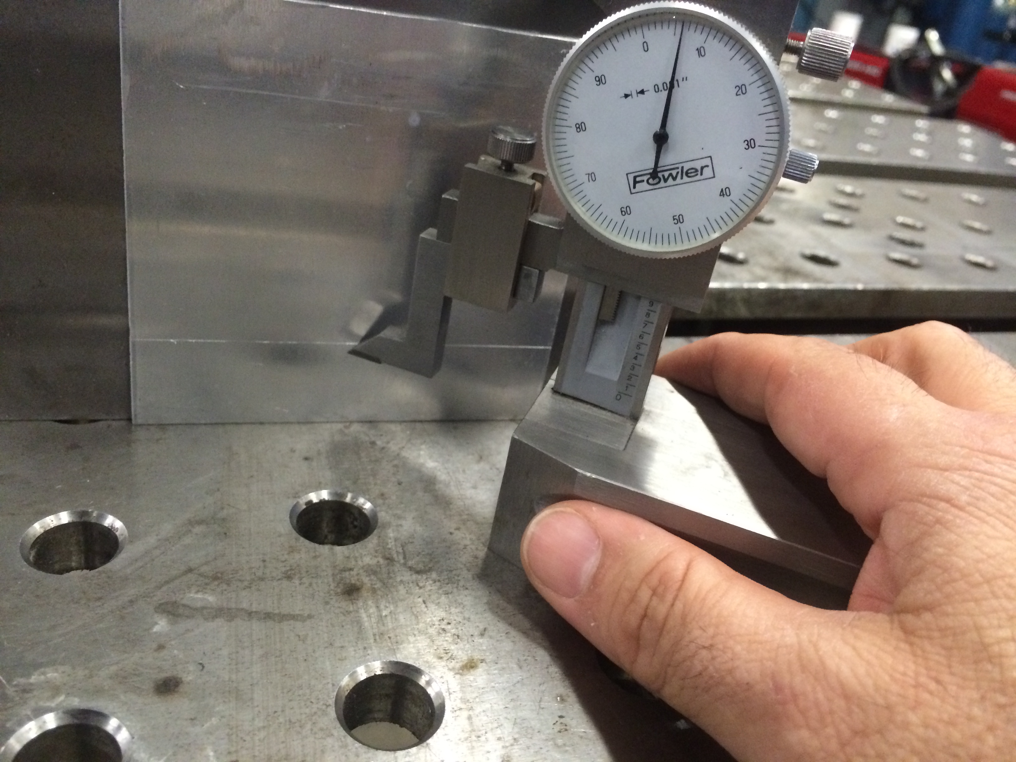

Then you set the height gage to exactly 0.906", after you spend 15 minutes figuring out how to operate a fµçking height gage in the first place. Hint: use your calipers to double-check. It's like math -- if your answer is the same as the one in the back of the book, you did it right (or you got very, very lucky). In fact, it
is math -- no wonder I suck at it.

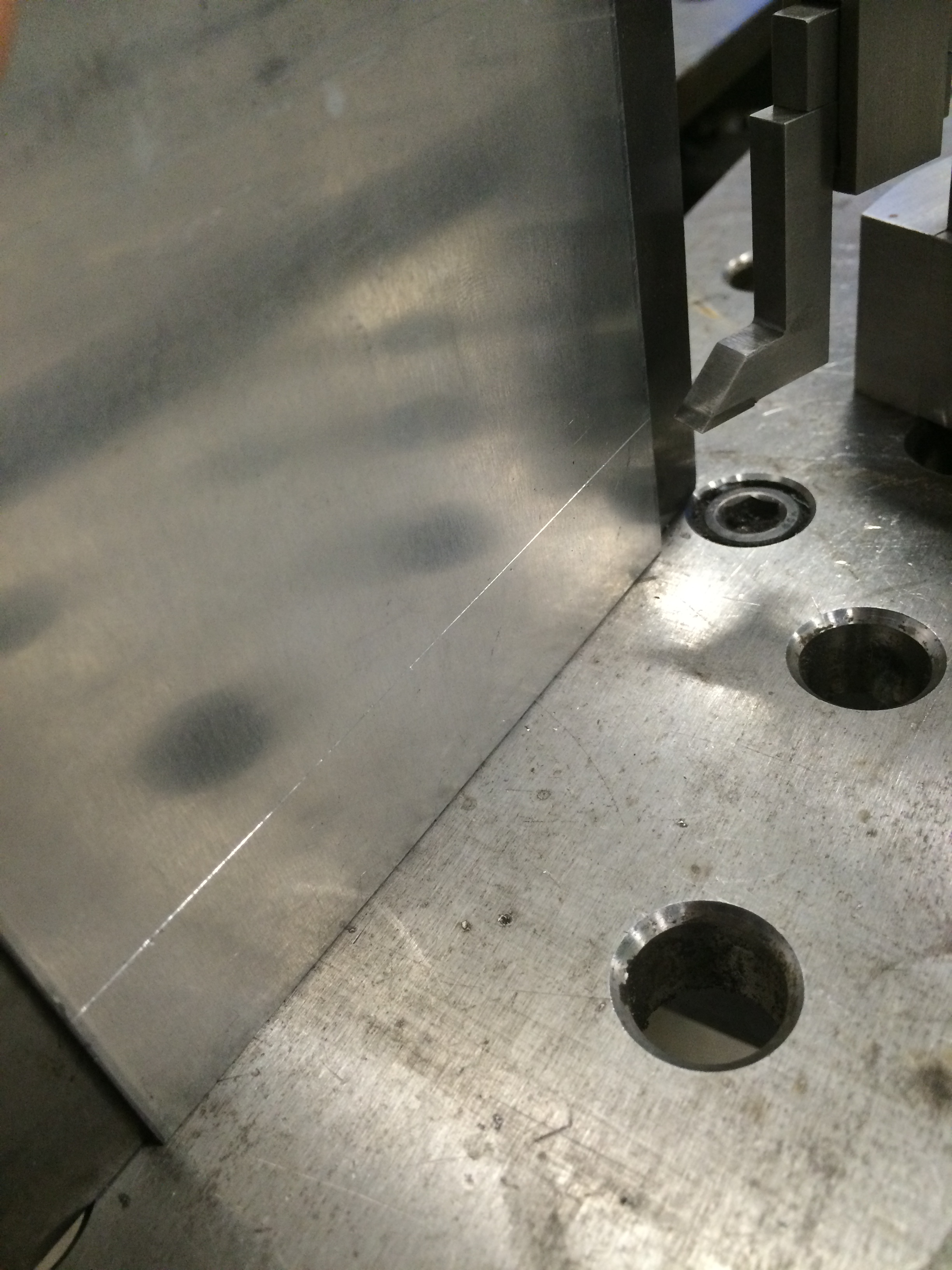

Once the height gage is set to the correct height, and the bottom edge of the metal you're going to mark is perfectly straight, you just rest the metal against your perfectly vertical slab of groin-killing steel death and drag your height gage across it like this:
As long as your surface is perfectly flat, your height gage is correct, the nuts are correctly tightened, the bottom edge of your sheet metal is perfectly straight, Dr. Deathslab is perfectly vertical, and there are no tiny little bits of dust or shavings underneath your instruments, it's pretty easy!
So when I saw what a perfectly straight line I could get this way, I thought, "Self, now that you're on a roll, why not mark out the entire fin outline this way, and get perfectly marked-out fins?"

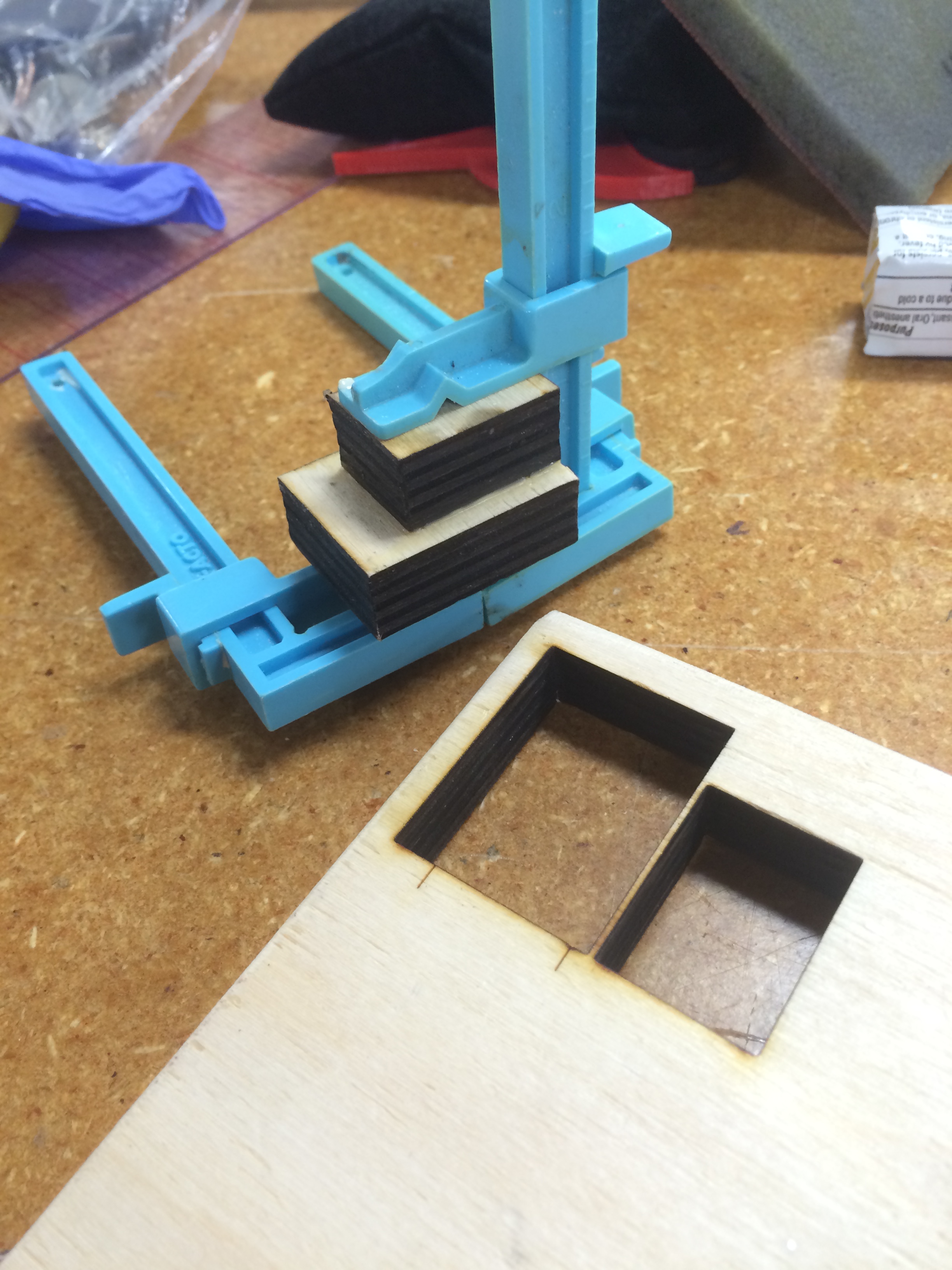

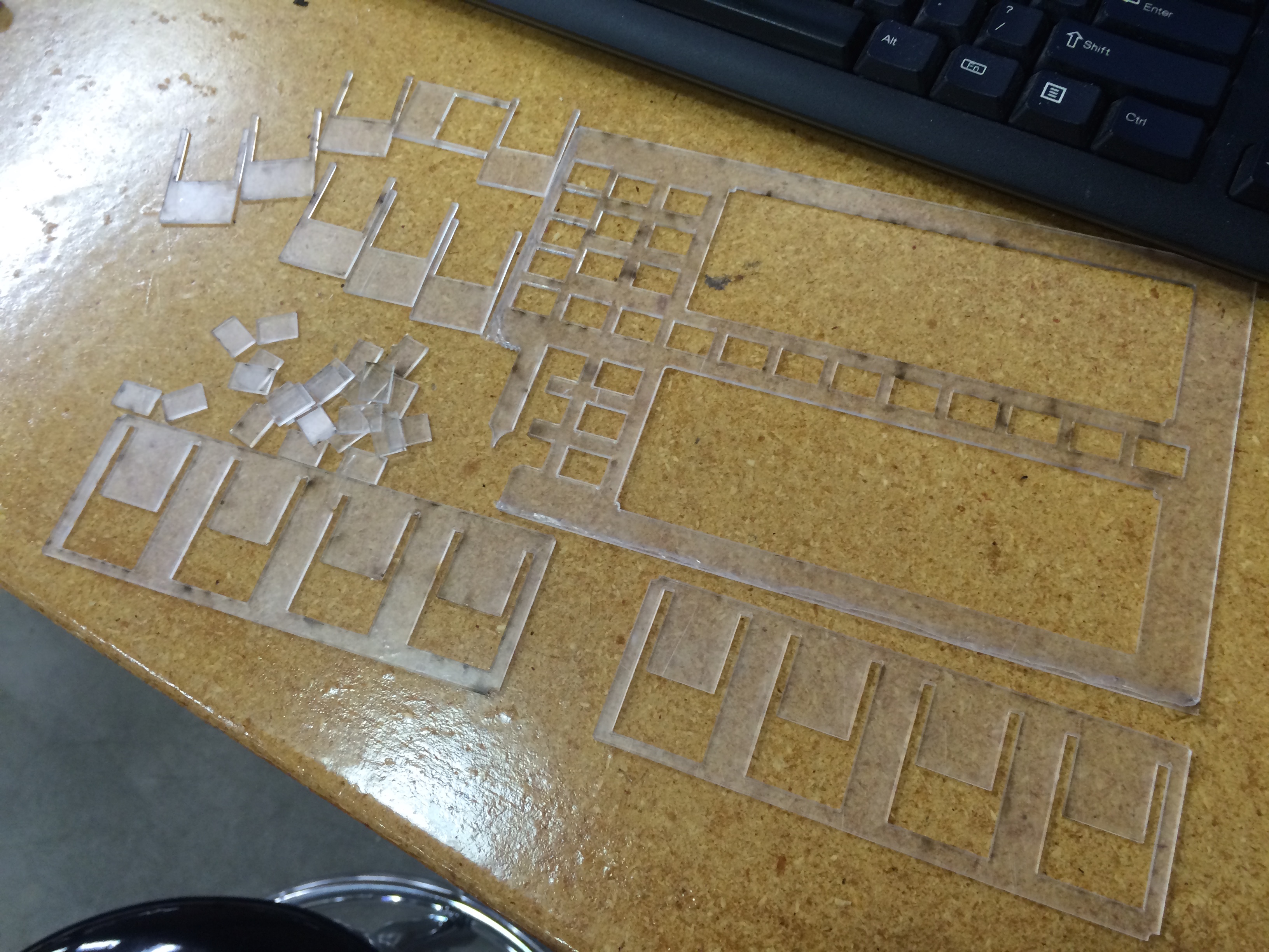

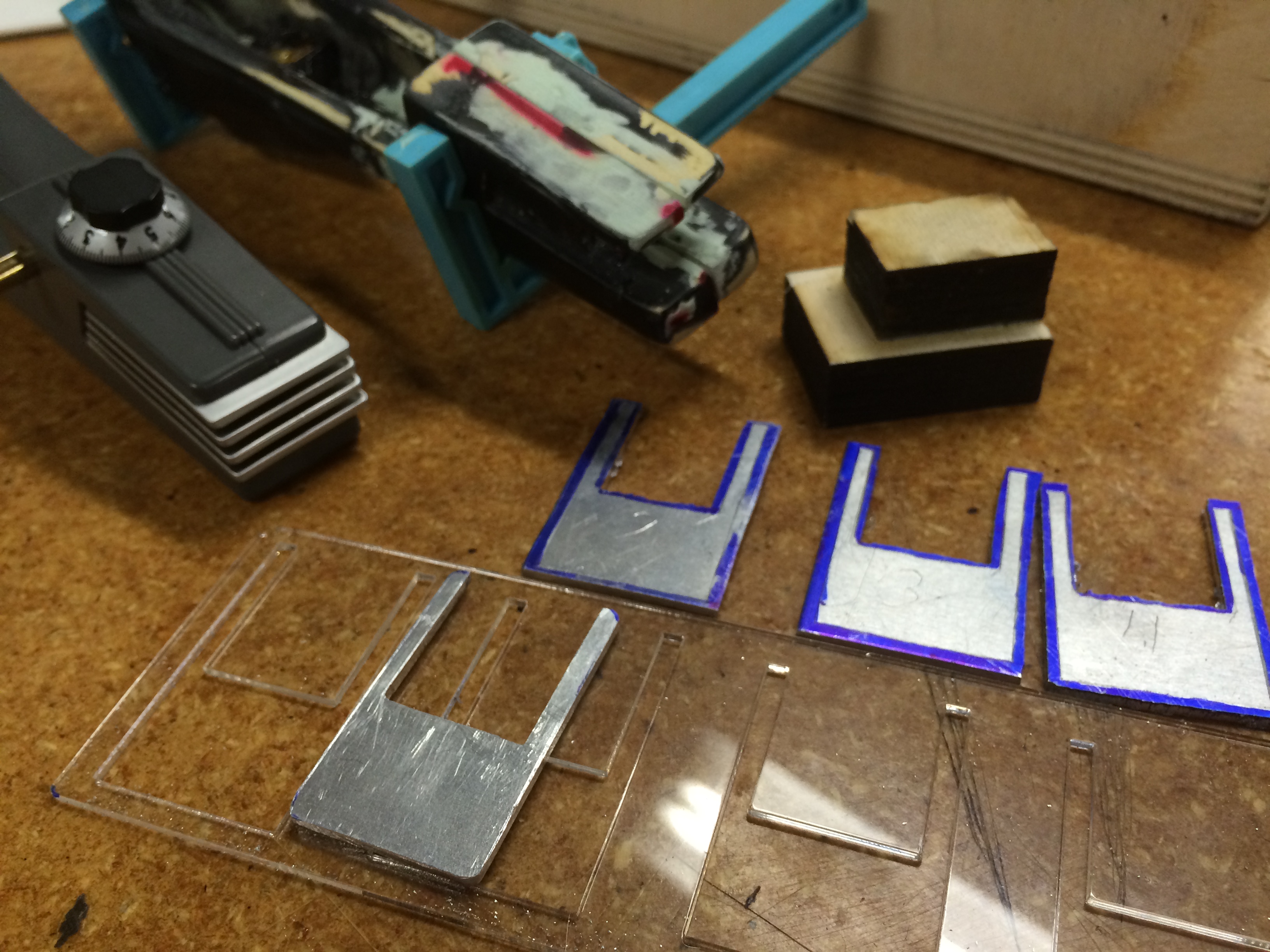

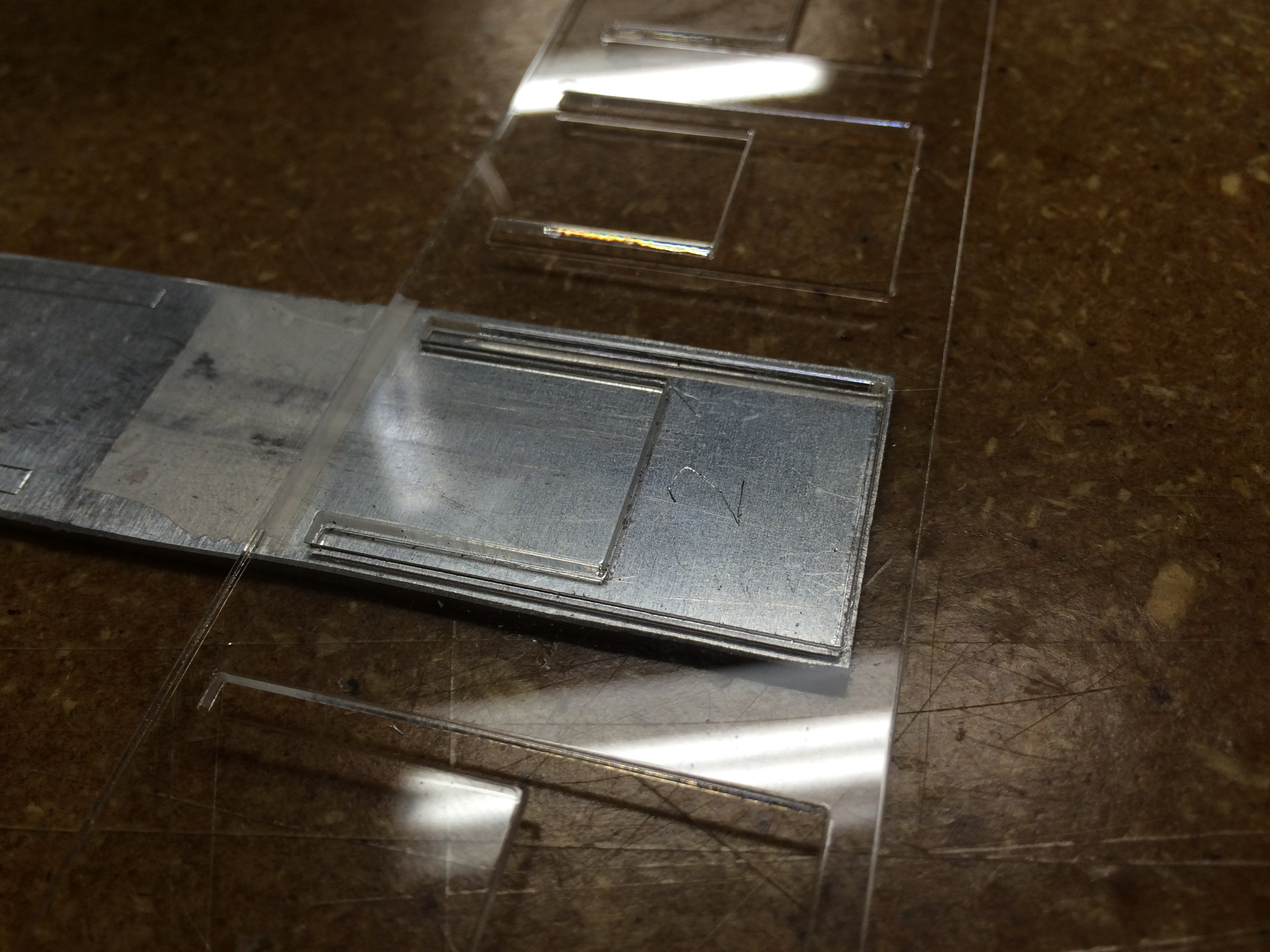

So here's where I ran back to mommy, which is what I now call the laser cutter. I just created a template in Illustrator and cut myself out a pair of stencils in acrylic.
The tiny squares in a pile on the left are spacers for the fins. You might notice I used a much smaller sheet of plastic stock than usual and didn't cut out 5 million of these things. There's a rea$on for that.

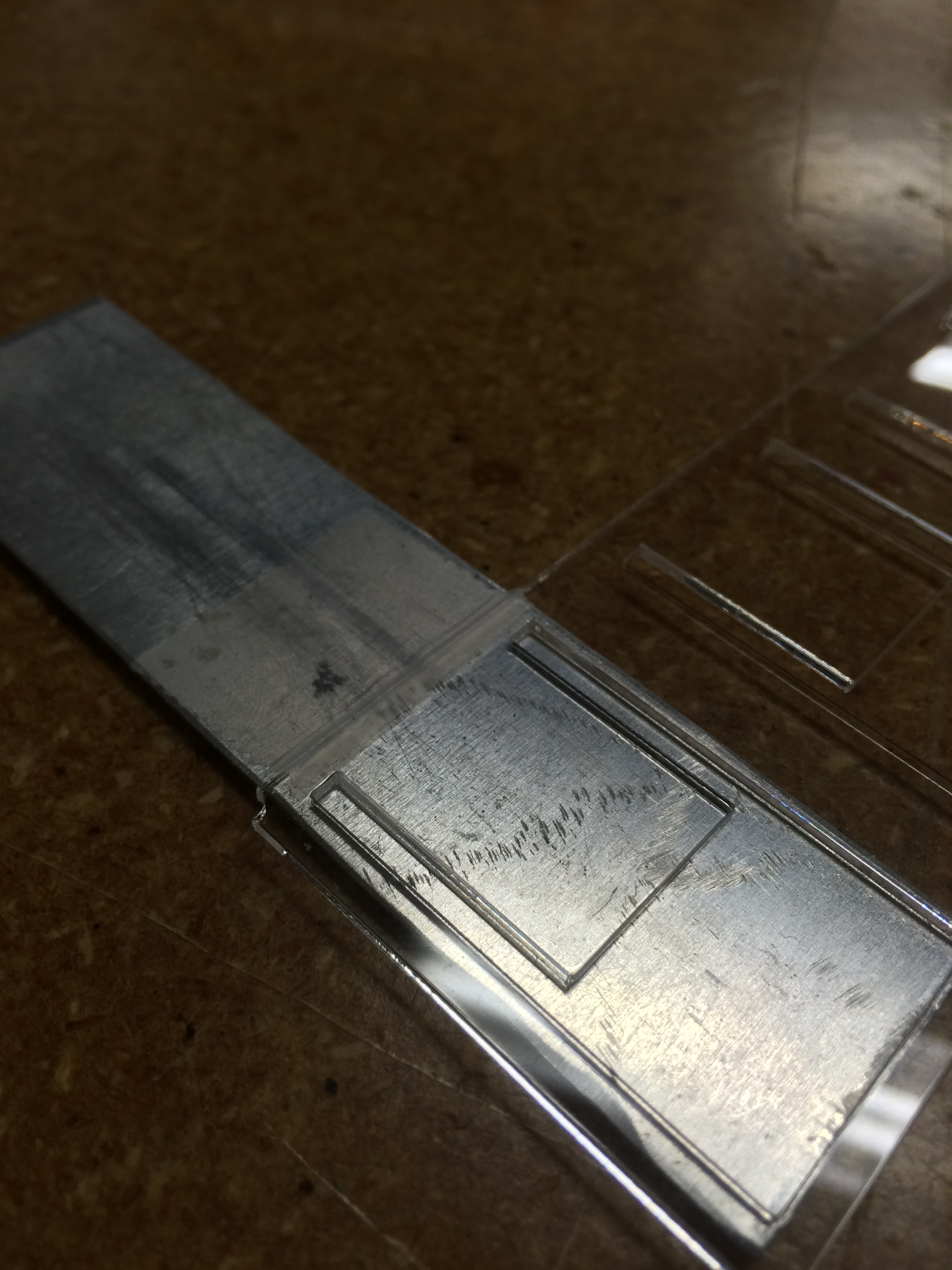

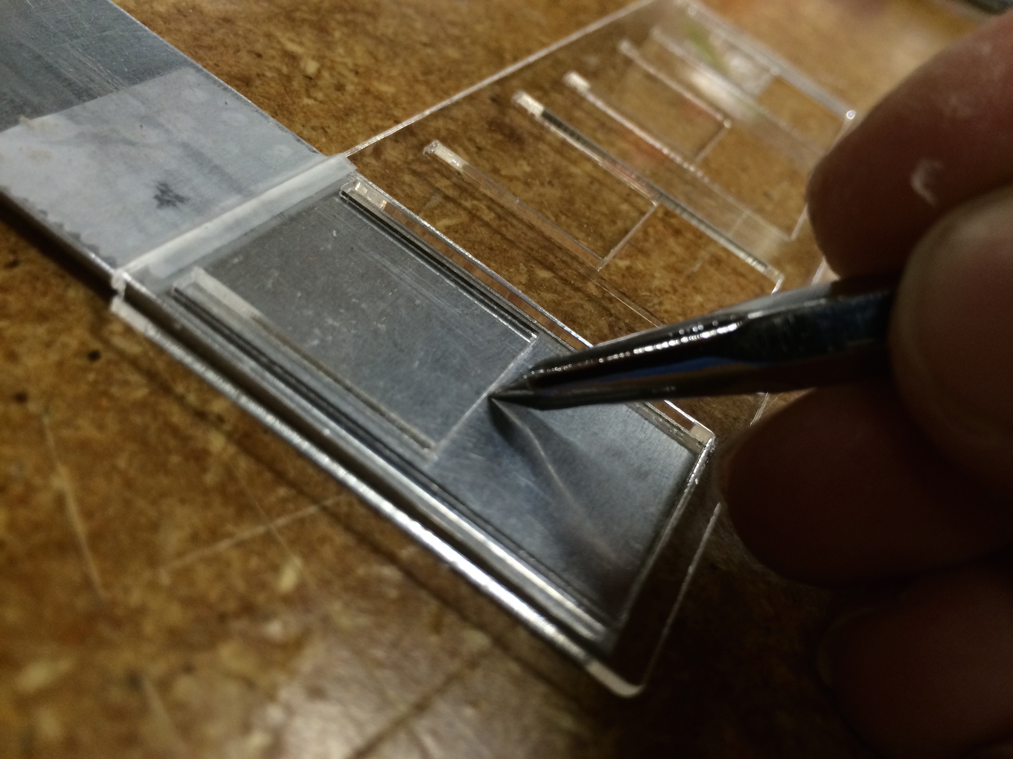

Once I had the stencils, marking the aluminum was even easier than with the height gage. I just Scotch taped the stencil on the aluminum, and traced it with a machinist's scribe:
I numbered them 1 - 4 from bottom to top, because it's very easy to confuse them once they're cut out. Funny I didn't think to do that on the actual stencils.

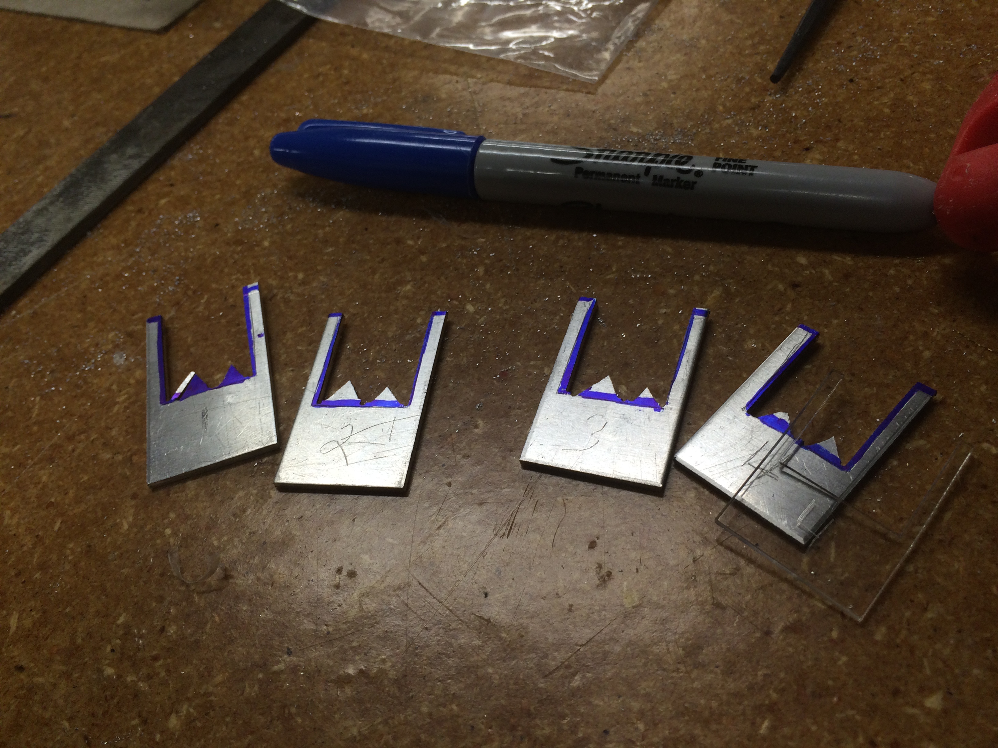

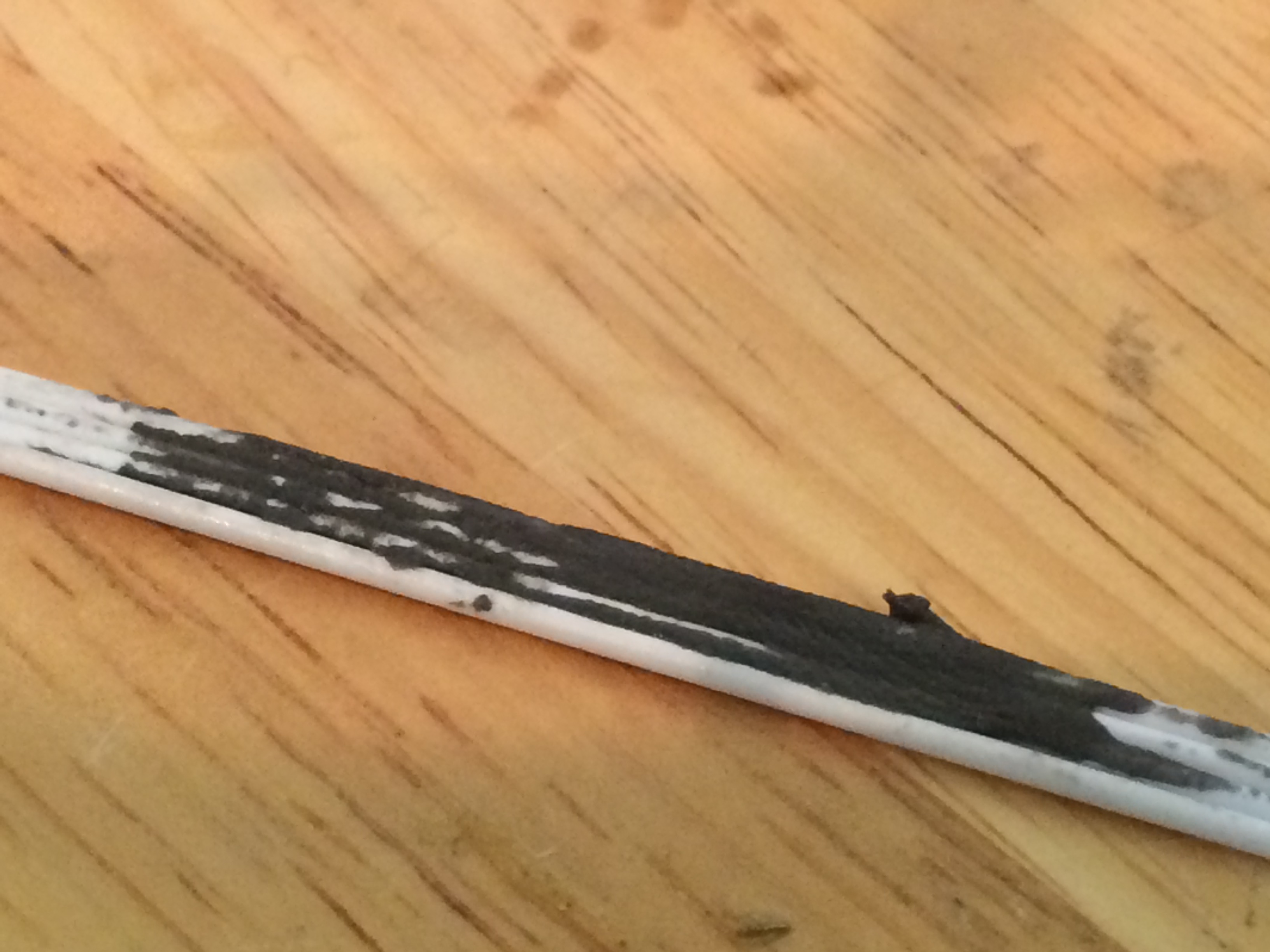

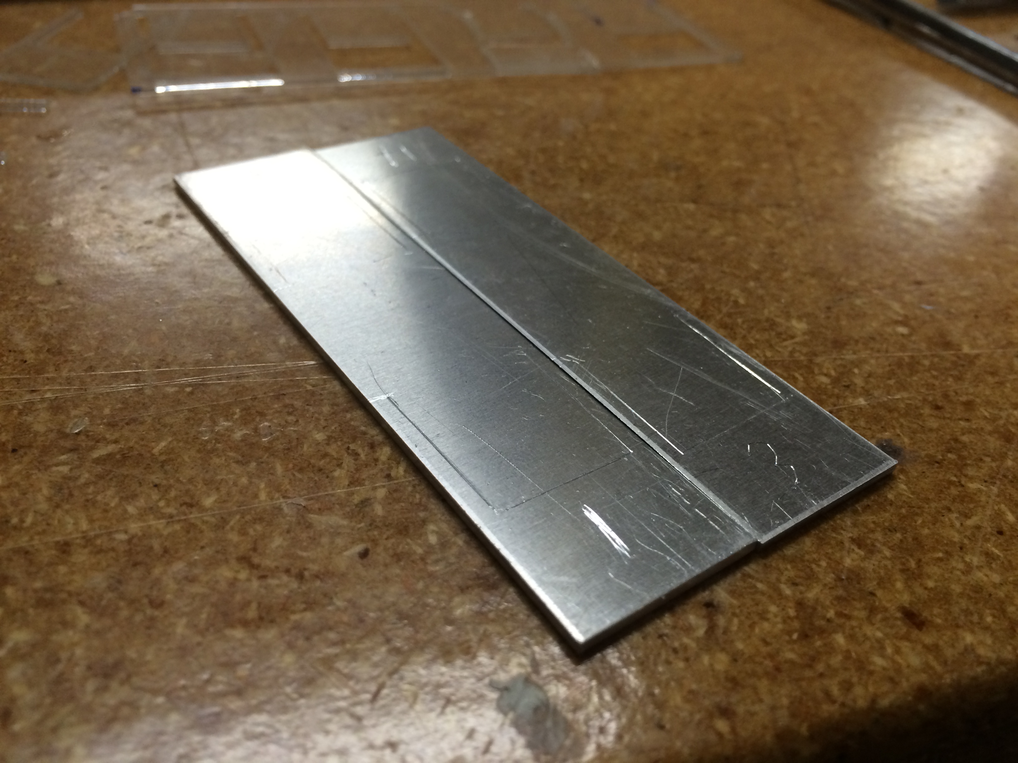

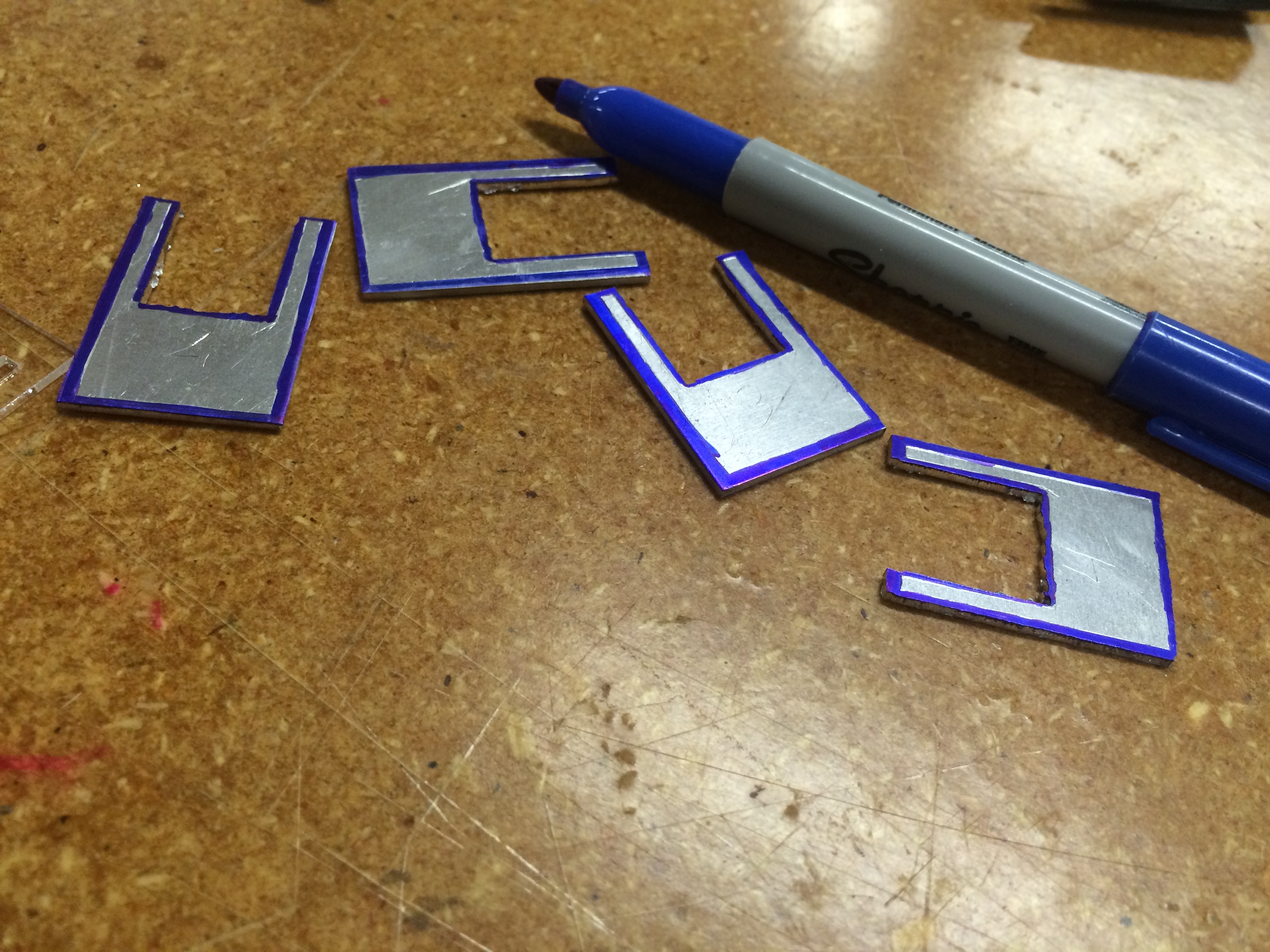

After I cut them out on the bandsaw (which oddly enough went very well), I marked them for filing with a blue Sharpie -- just mark the parts to be filed away, and file them away till there's no more blue.

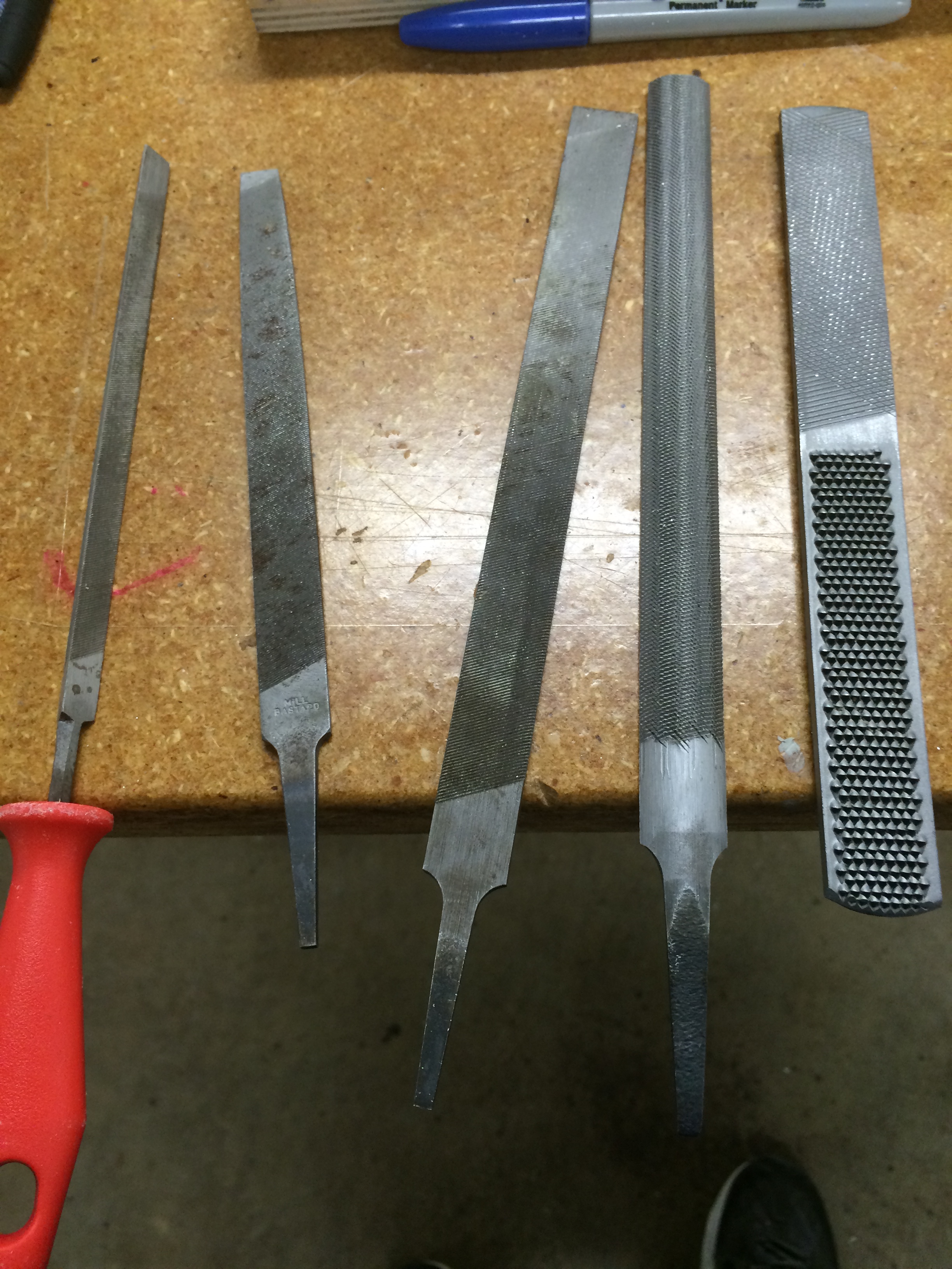

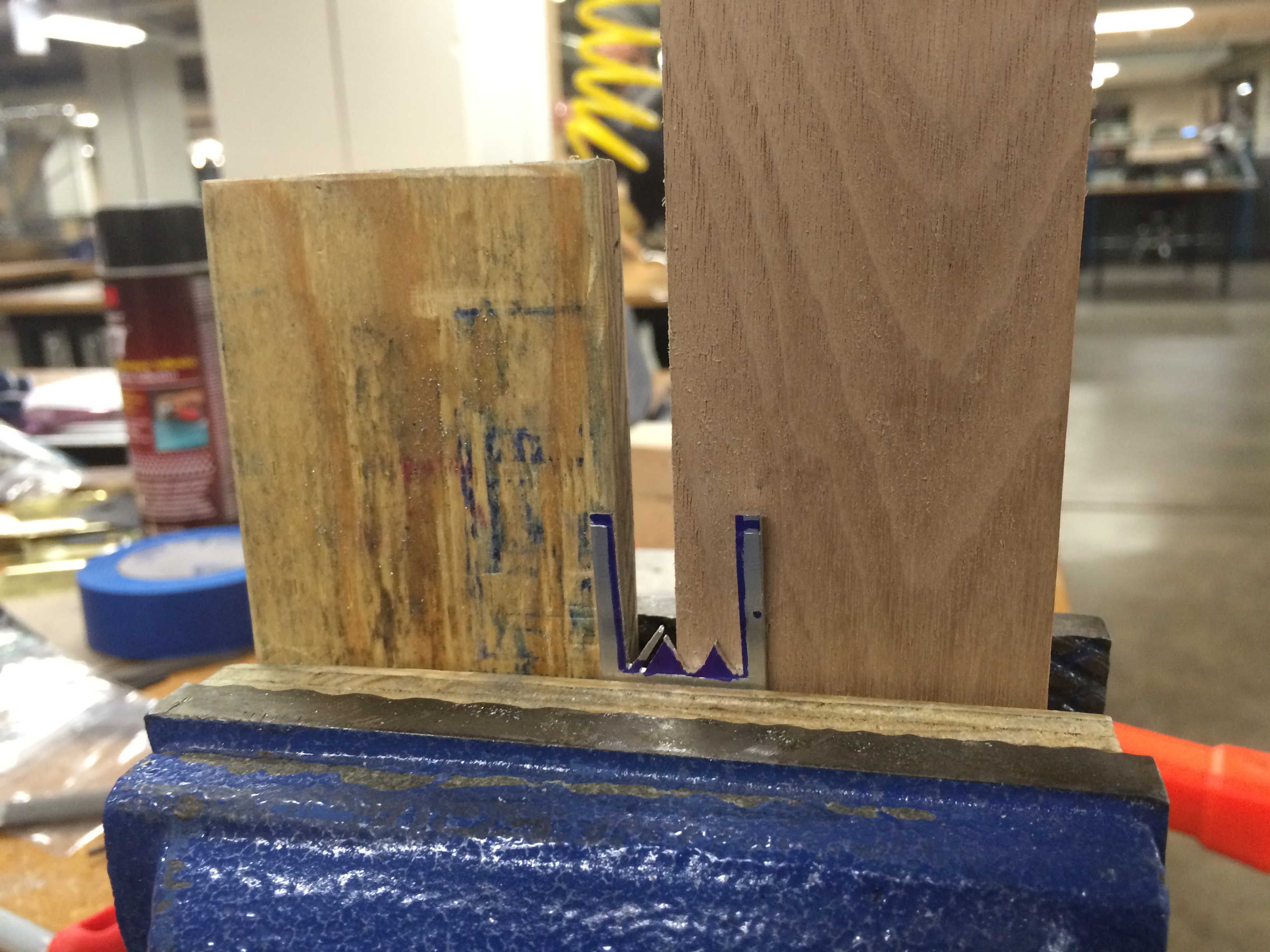

Here's a useful tip: When you're filing the edge of something thin like this, mount it as close as possible to the edge of your vise to maximize control and help keep it from bending out of shape when you file it. You want just the parts you're going to file away to be exposed. I also like to place my front wood block just a hair lower than the rear one, so I'm better able to see my markings. Remember, this only works if you file properly -- in one direction, away from you.
After I finished filing the contours on #1 (the bottom fin), here's how it looked:
And with 2, 3, and 4 staring me in the face, after taking about 30 minutes filing #1 to shape, I suddenly realized. "WTF am I
doing?!"
