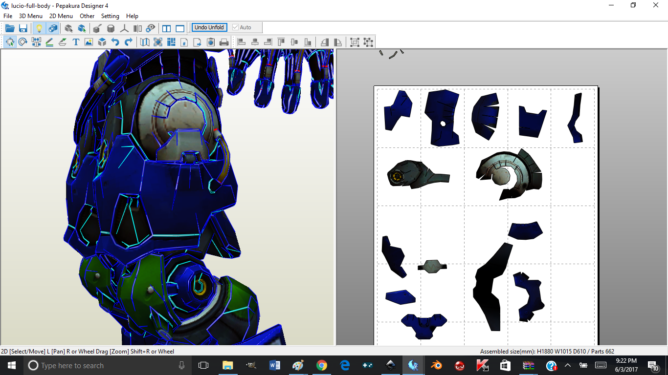

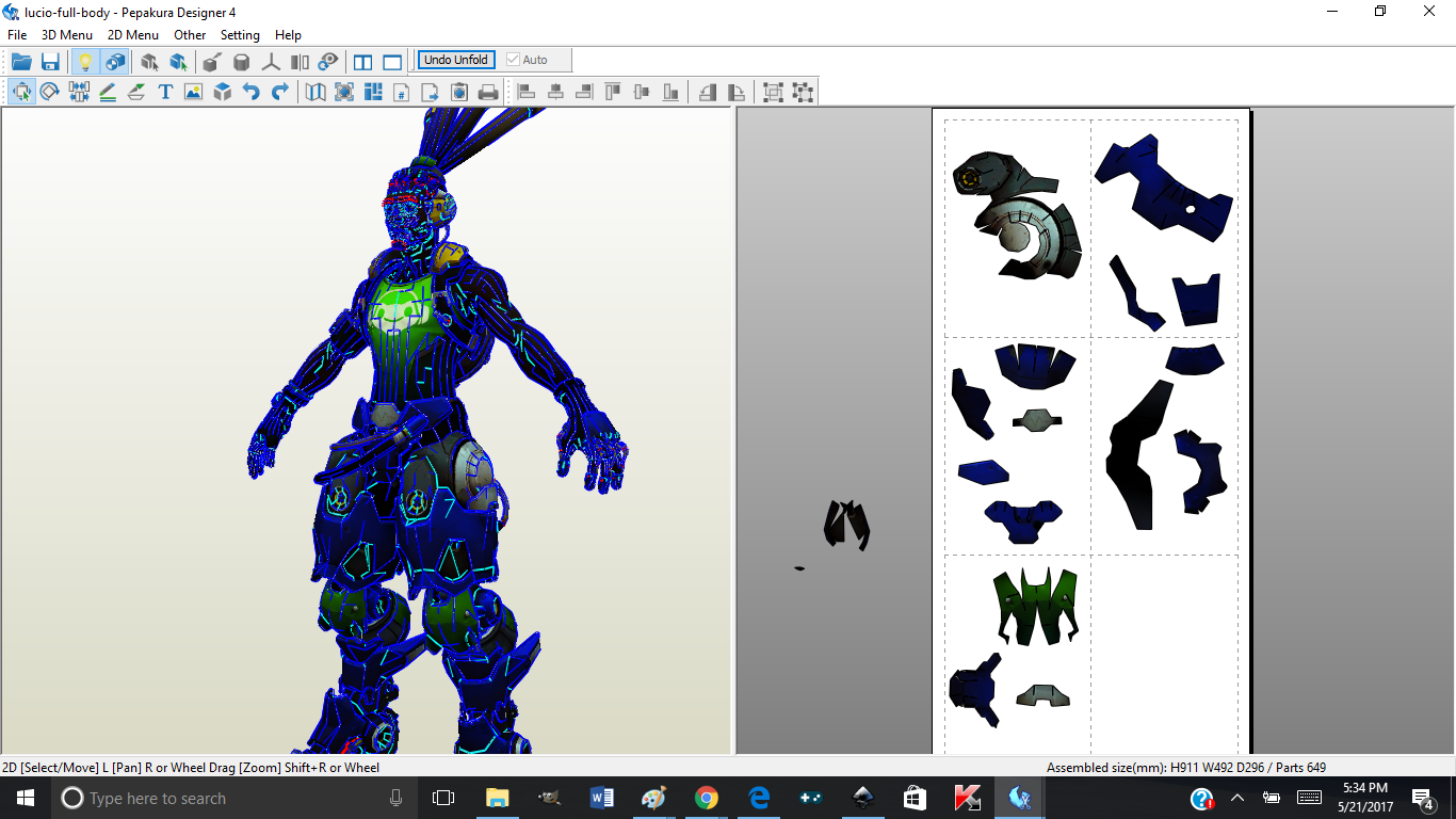

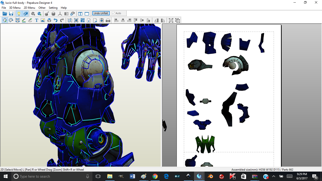

Well this is what I got when I put my full height to (First image, 6"2 in mm) it. I also measured from my hip to my knees for the upper leg piece and put in those as well (Second image, 14 inches in mm), but they came out really small. Is there something I'm doing wrong?
Not necessarily.As I recently have found out (I was already warned about this), complete models that originate from video games are not always realistically shaped.I have completed a chest that turned out two inches too wide at the shoulders and 80mm too short in depth at the waist...and I did scale it to match my height.
So here you would either have to make small changes as you use your height for reference,or scale each piece separately.You'll have to find out which solution fits your needs most
