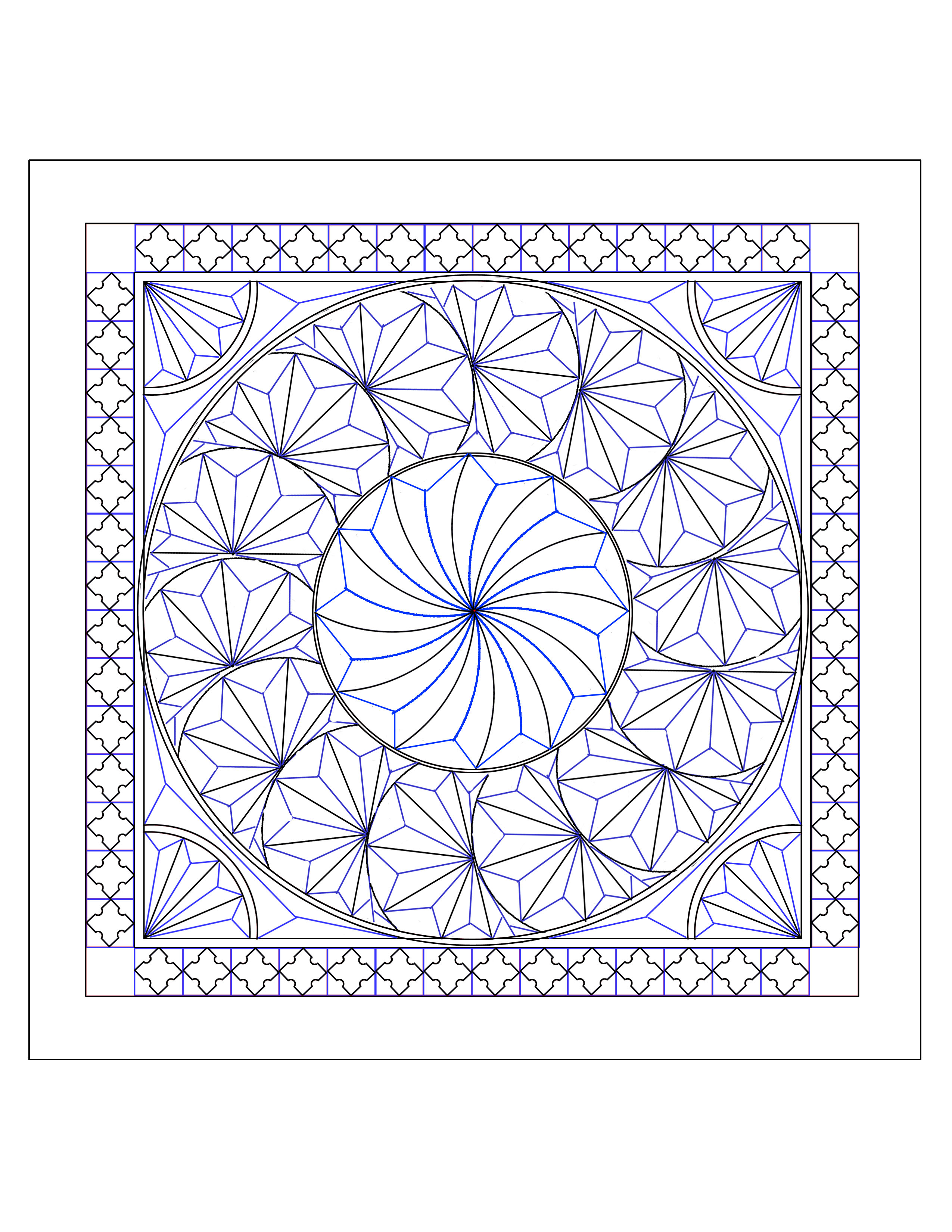

i drew up this pattern
the doted lines are relief cuts
no real complex carving but would be very time intensive to hand carve it all.

updated pattern its not quite perfect so i would do a practice carving on some scrap before doing the final just to make sure all the chip cuts work
all blue lines are recessed cuts all black lines are raised edges

Beautiful. I'm going to guess it was easier to draw than to carve. ;)
i ran it through Photoshop and the bottom is 3 inches the lid is 1 1/4 the bottom is 1 3/4
Okay, the bottom is 1 3/4. So, the Artminds box I recommended above, would work.
the drawing in Photoshop only took about a hour while i was catching up on podcasts it looks complex but relay it just 5 parts and alot of copy/pasting. i was considering using it as a practice in 123d but it keep crashing my crappy laptop so...
