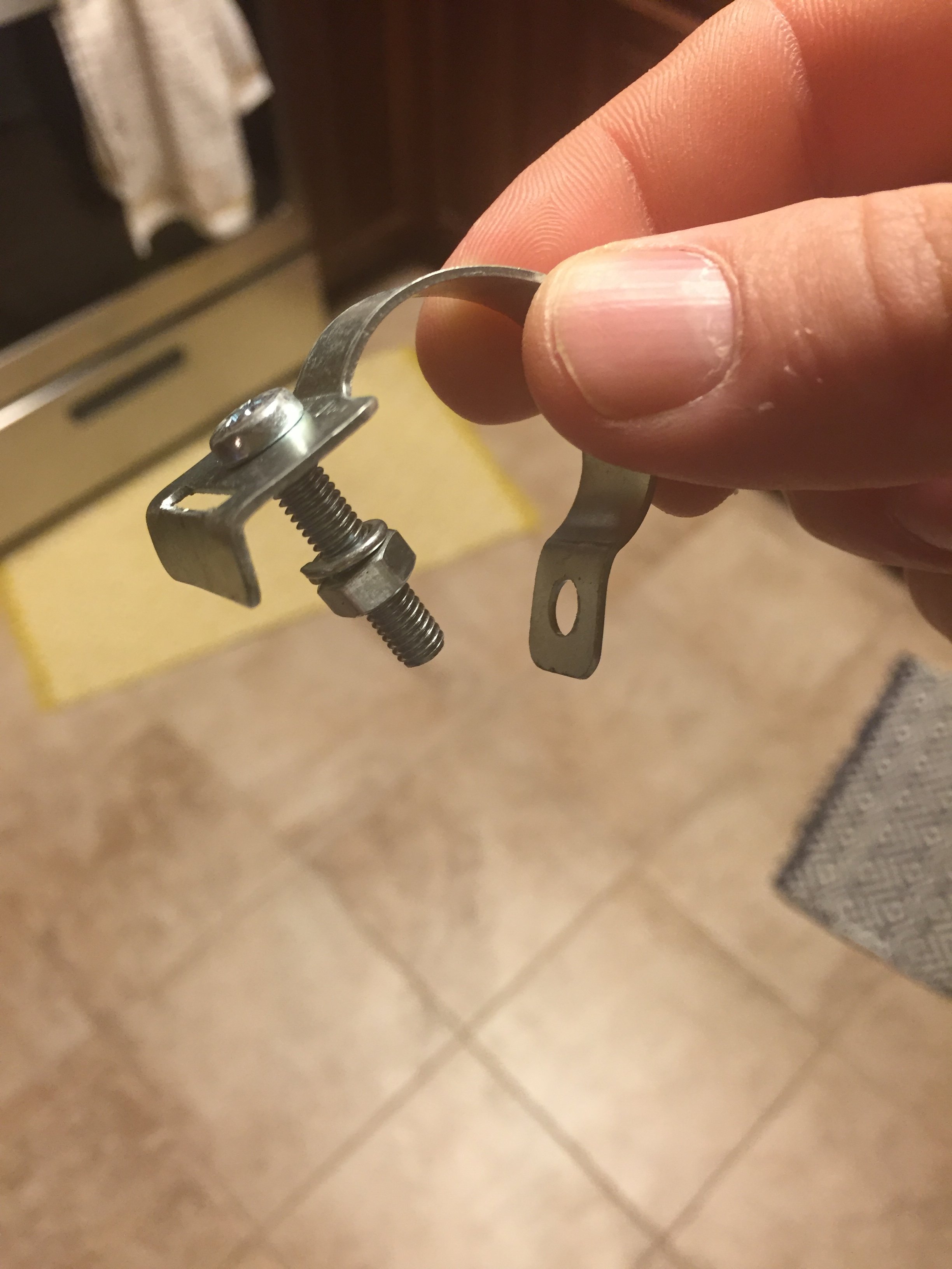

Has anyone been able to make more of these? They hold the microphone for the Tiger Super Siren. I would love to have a few more.

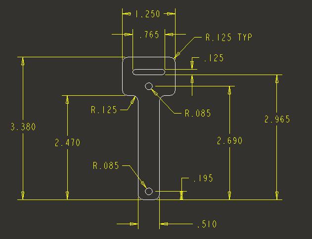

I have been meaning to try and make some of these. They should be easy to cutout using waterjet. I don't personally own one of them, but I do have a drawing that I made using images posted by others. I can upload the drawing tonight, and if you can check some of the dimensions, that would be great. I can then look into what the cost would be. I'm thinking it should be pretty inexpensive.
See below pic for a drawing of the microphone bracket (prior to bending). I believe the measurements are close, but if someone could check a few, that would be great. Material thickness would be great to know as well (1/32" ?). The screw appears to be 1" in length, possibly #8-32.
You're close, PWF, my bracket is a 1/16" bigger on all the measurements you posted.
I mic'd mine and it is 0.040" thick metal
The bolt is #10 x 1"
if you're going to have some made up, I would suggest making the strap part a little longer to fit the bigger handle bars, they were meant for a kids bike and they are are kinda of a tight fit, at least they were on my bike.
I increased my dimensions by 1/16" as suggested and made it a little longer. I cut one out to scale and tried it on my bike handles.
It looked pretty good!
