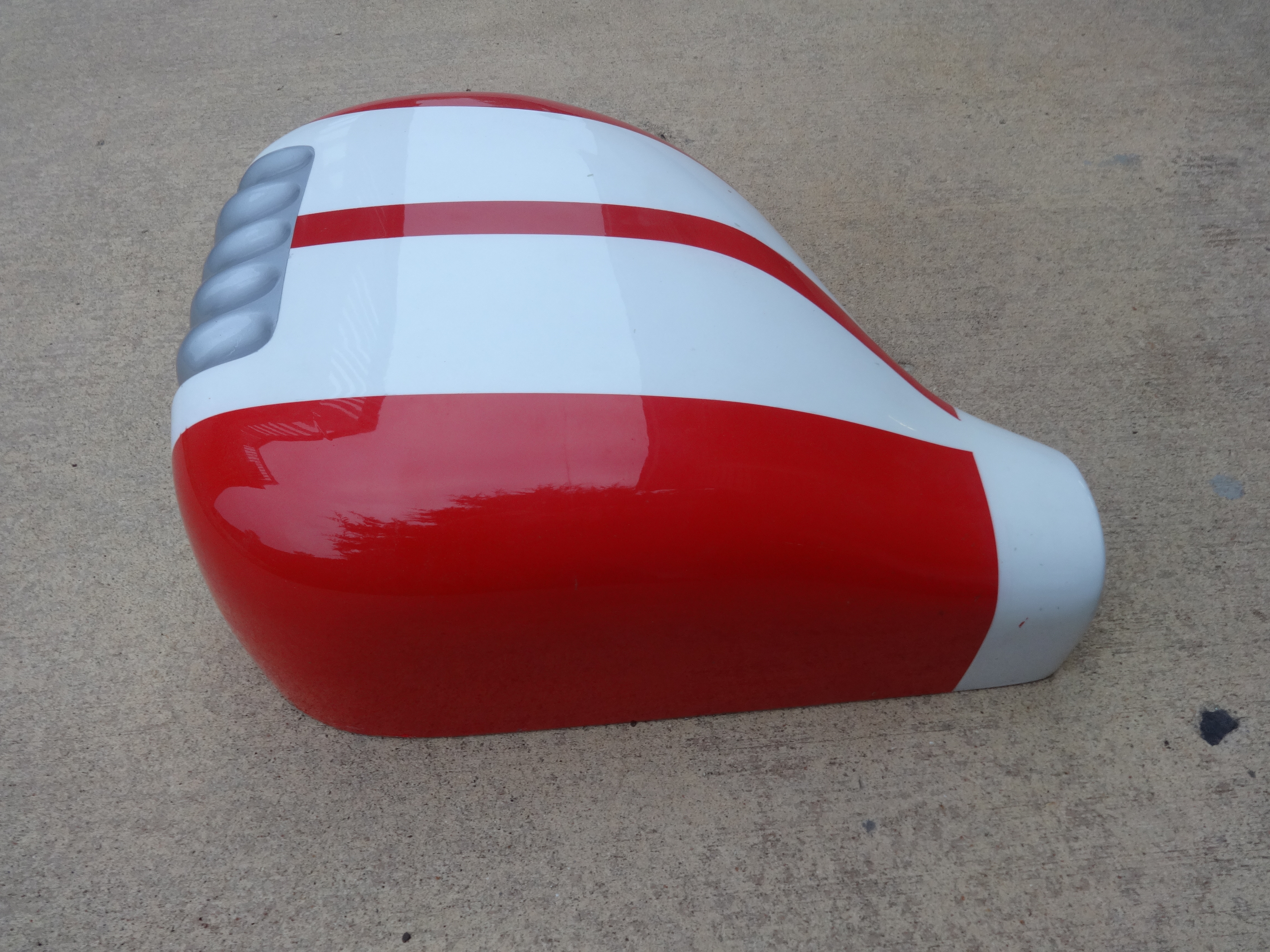

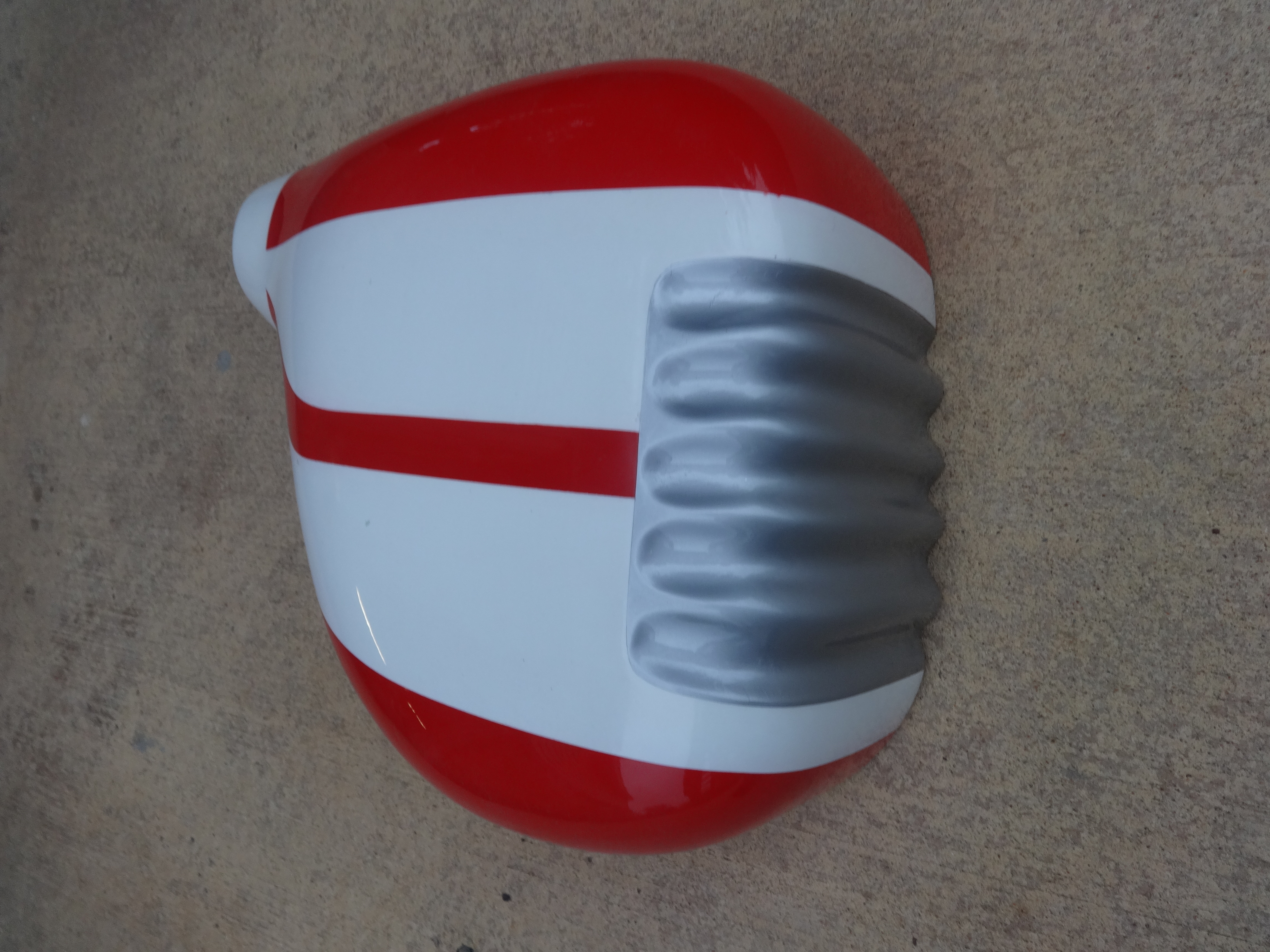

You can make a fiberglass mold without destroying the plug if done correctly, our first plugs were totally ruined because we didn't know what we were doing, here's the new plug after de-molding:
