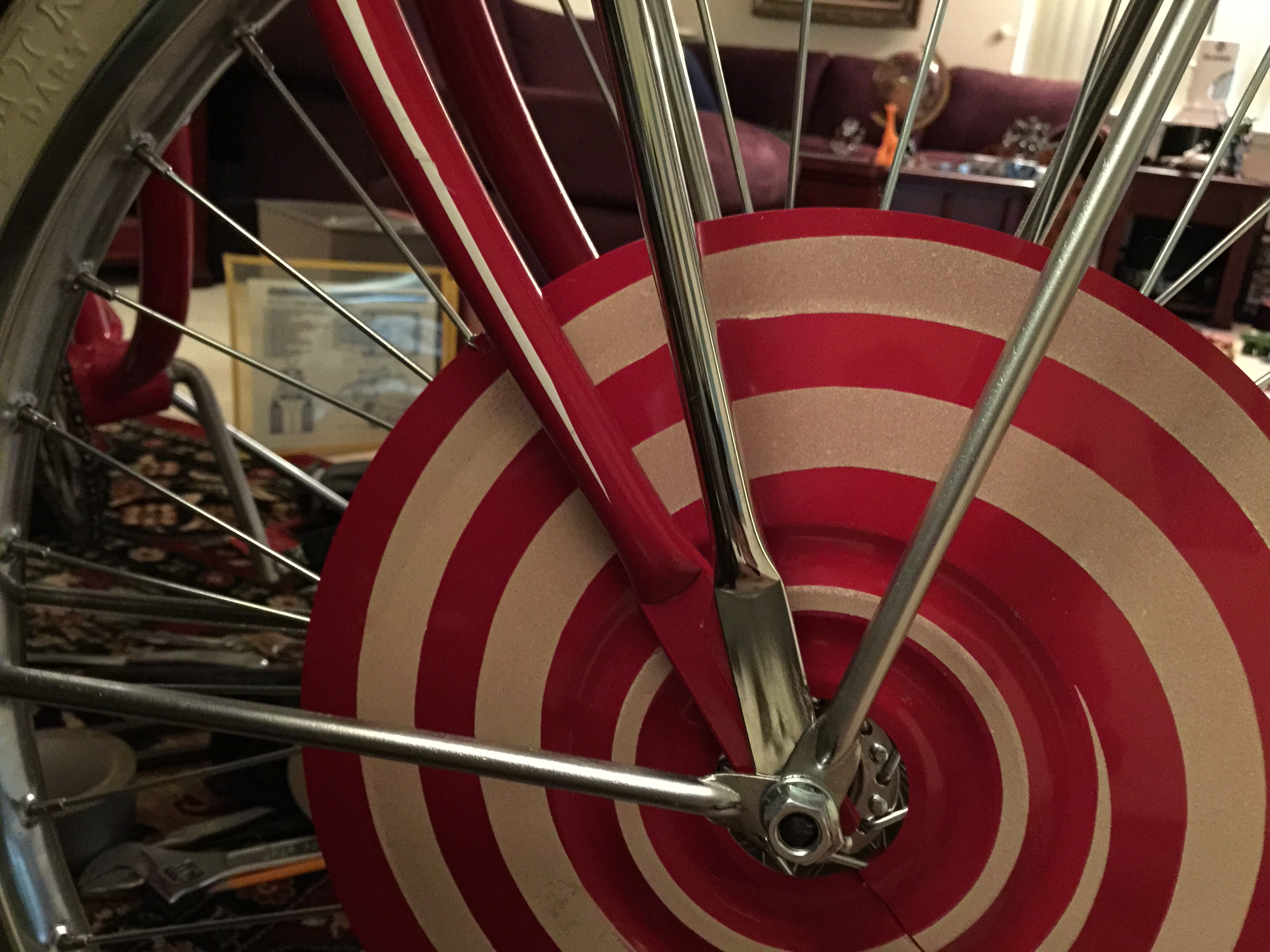

Hey everyone, found this chrome spray paint. Works pretty good! The chrome post in the middle is factory chrome and the two posts on either side of it are chrome paint. The starting surface wasn't as smooth as it could have been, so you see pitting but overall it looks good. Can't really tell unless you REALLY look at it. Don't think it'll work for saddle bags but for little nuts and bolts or misc items its fine!
Alright! Glad they made it there safely. About that chrome paint, in my experience most metallic and chrome paints especially dont hold up to wear. They usually turn dull grey if you use a clear coat as well. It will be interesting to see how it holds up over time.

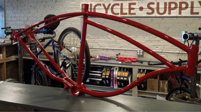

kev, that frame looks gorgeous.
