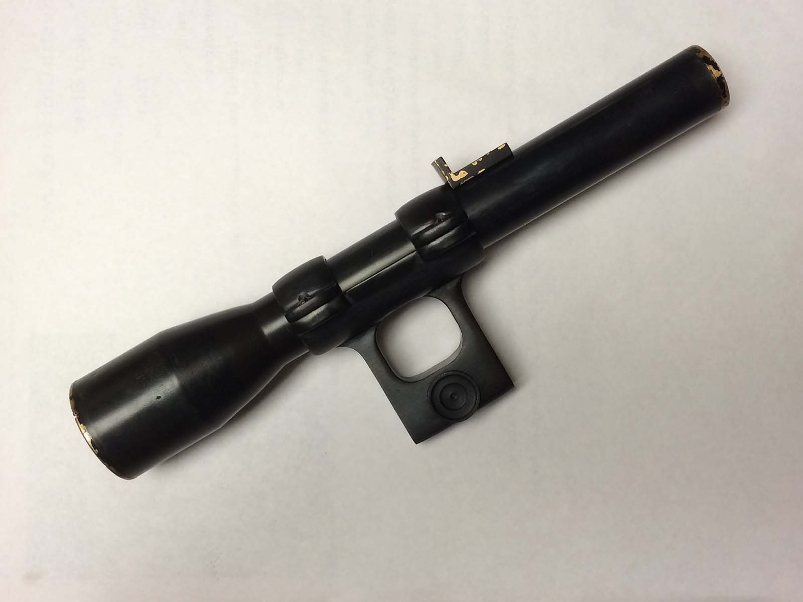

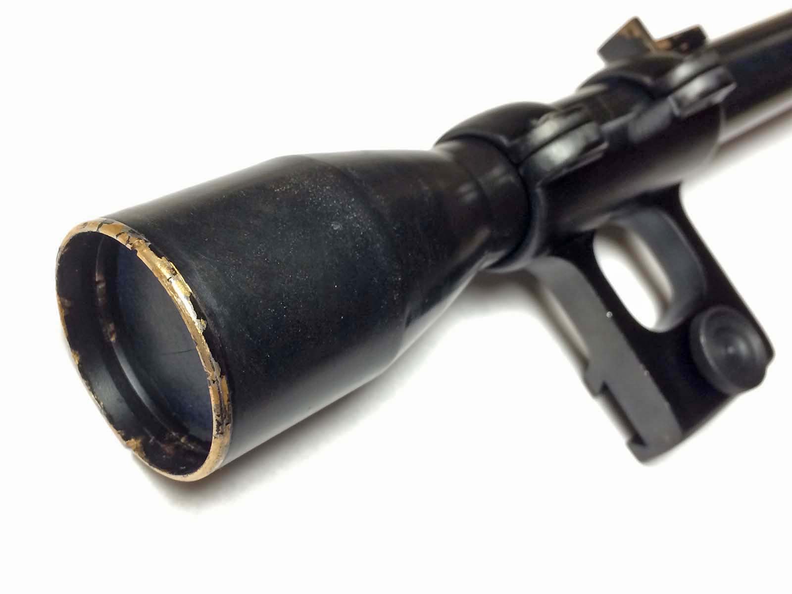

The scope is pretty much done! Well, pretty much. ;) I still need to finish the adjustment knob, waiting for screws in the mail (DEC confirmed the #4-40 slotted oval screw size). I'll probably re-do the paint on the knob base, I think I went too far with the paint chipping. I was pleased to find that it fits the Todd's mount almost perfectly, with a little masking tape inside the mounts for a tighter fit. The scope has been waxed with clear Kiwi shoe wax (2 coats), which really shined it up. I haven't tried renaissance wax but the Kiwi seems to work great, I'll use it on the rest of the blaster as well unless someone can convince me that renwax is that much better. Here are the pics!

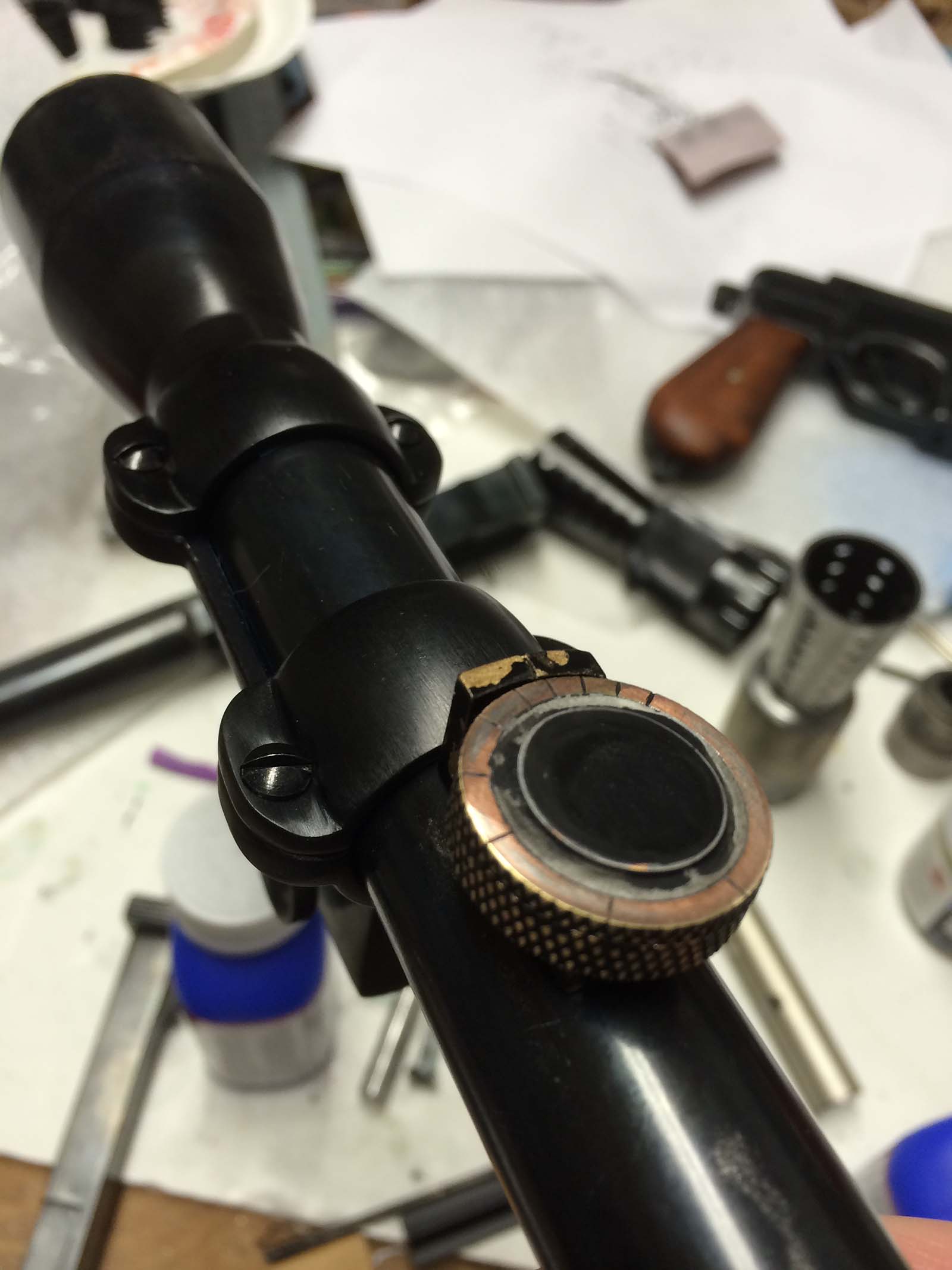

I scribed some lines in the top of the knob to get it closer to the look of the real one (will forgo the numbers as I can't think of a good way to add them). Just needs paint.
Upon attaching the mounting bracket the difference in proportion of the scope bell became clearer, at first I thought maybe I had the knob base in the wrong place, but it measures ok. The bell is a little closer to the rear bracket than the real thing, changing the look a bit, but I'm ok with it, and it certainly has the look of a real scope!

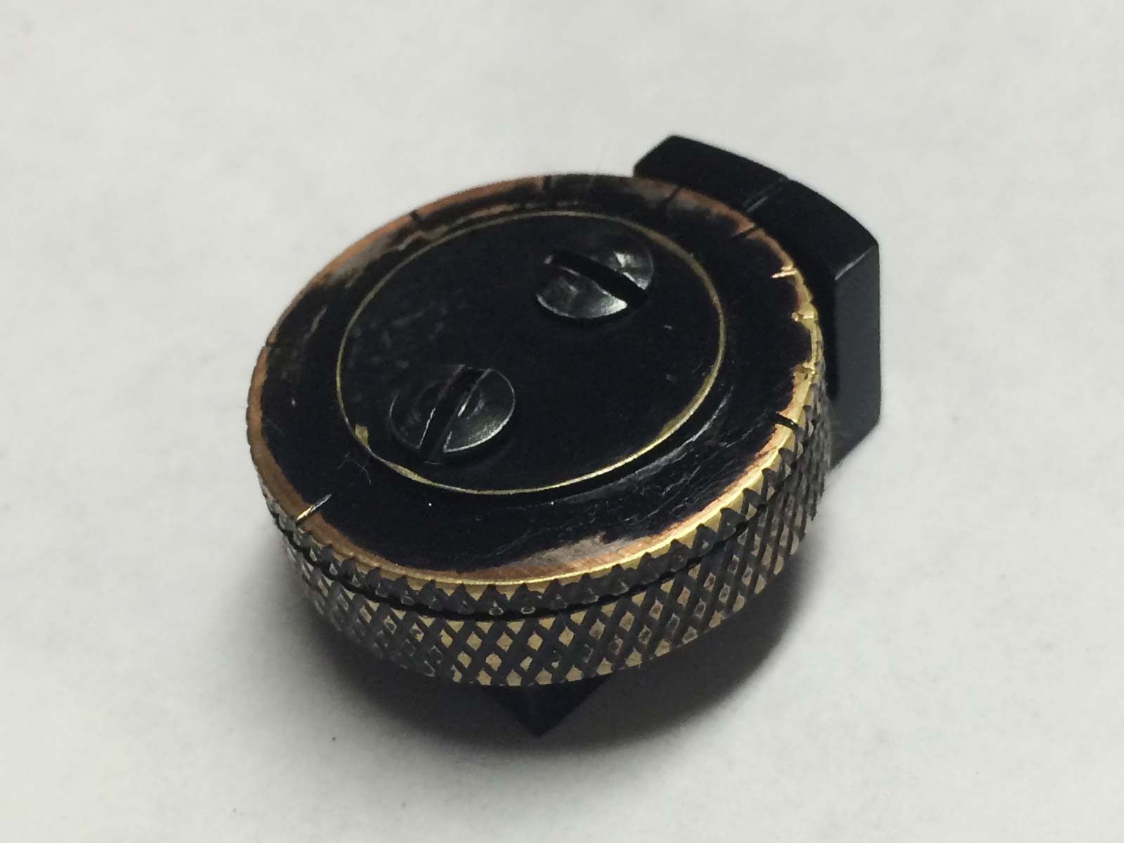

After sorting out finding the right screws I finished up the scope knob. I had to buy 100 screws and only needed 2, anyone need some? I also scribed some lines for the setting marks, lacking any good method to make the numbers this will have to do. I drilled holes for the screws, sprayed the whole thing satin black, and used lacquer thinner to weather. All the exposed metal is real brass so it looks very authentic. I'm very pleased with this!

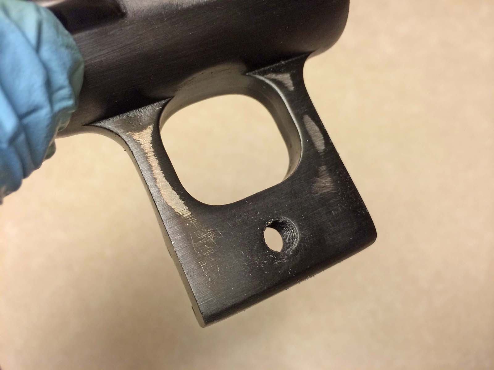

The lower bracket is also less than flat on the face, there are some machining marks and slight curves on the surface of the U shape, seen here:
Fixed with some elbow grease and files. I also sanded and sharpened up the rest of the scope mount (machining marks, especially bad on the cross bar).

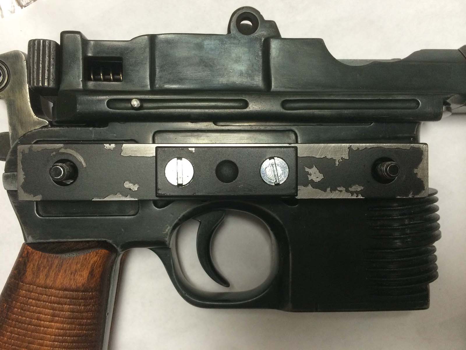

For the mounting bar and thumbnuts I wanted to accurately replicate the paint scratches on the hero prop after filming, ala kpax amazing build. I traced photos of the scratches and cut masks from self adhesive vinyl using my Silhouette cutter. These were stuck to bare metal before spraying with satin black. Here are the masks for the thumbnuts (didn't get pics of the cross bar, I was to excited to spray!), compared with a 1/1 print of the well known prop photo.
Mounting bar after spraying and removing masks:
After the paint was mostly dry but still a bit soft I added some tiny scratches with screwdrivers and such. I also tried to match the more notable weathering marks on the scope bell, and tossed it around in my toolbox for some more random dings. The center thumbscrew is as finished by Todd's and sanded to remove some of the black finish. The scope mount bracket parts received a beating with various metal objects and some steel wool to weather the edges. Here's the mount and scope, also very pleased with how this turned out!

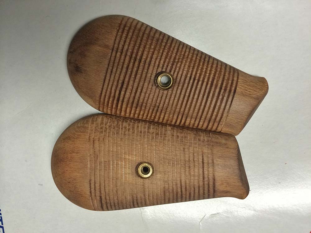

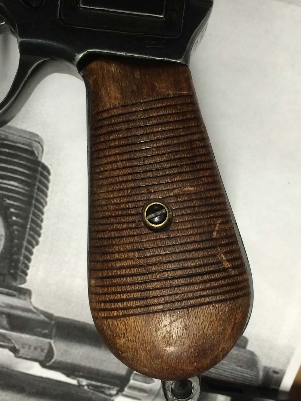

Like I said, I haven't had a lot of project time lately, but have been trying to finish this baby up. For the time being I'm sticking with the Denix wood grips, though I'd like to replace them with something more accurate. They don't have a particularly nice finish, so I sanded them smooth and cleaned up the engraved lines, many of which were kind of faint. I also added brass escutcheons, which aren't as accurate as I'd like but that's what I could find! Here's how they look after sanding.
I guess they're pine or some other fairly soft wood. I stained them with some dark stain I had laying around, then a satin varnish. Much better looking, though still not quite the right color I think.

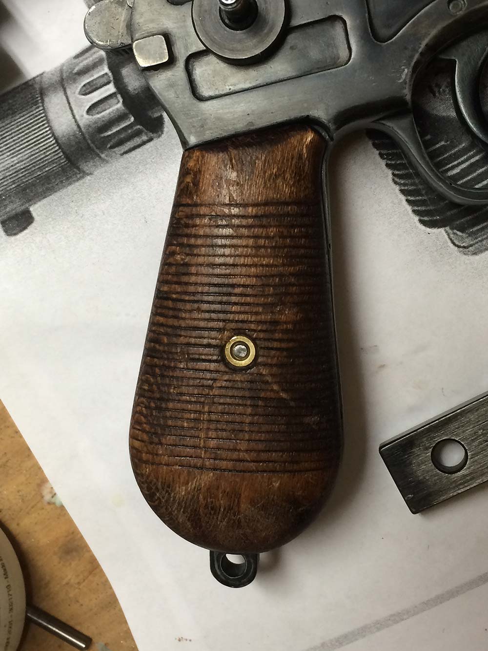

These were actually pretty beautiful at this point (I love finishing wood!) so I was hesitant to proceed with beating the heck out of them! But since I'm doing accurate to the scratch weathering on the rest of the gun I worked up the nerve to do the same to the grips. This was pretty much beating on them and scratching them with a screwdriver, trying to get all the major scratches visible in the classic black and white photos of the weapon. Turns out to be a lot of fun! Hope I didn't go to far. :) They look a little more natural in real life, the iPhone doesn't seem to handle photographing wood grain very well. Anyway, here they are after weathering. I need to work on the sheen, the whole grip needs a more even matte look I think.
