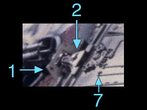

1. "Shield" in front of the upper Quad Laser Turret
2. Detail piece just forward of that "Shield"

7. Detail piece at the end of one of the long straight pipes on the middle section. (It's the same as the piece at the end of the second pipe.)

Ok guys please help ...I only need part #1,#8 and #9 to finish my mr replicas falcon, If someone knows what model this came from it would be very appreaciated....if you want to keep it a secret you can pm me and i will keep it to myself.
looks like it, but is it part of the flat piece behind it, or glued to a piece of styrene? could be used though!
any idea on part #1?
thanks
Monsieurtox
I think it's glued on a styrene strip or on another kitpart... Looks like 2 separate parts to me !
I have no idea about the part 1, sorry...
bump for this part....it is the only part left to put on my falcon......#1 The Plate in front of the quad guns......need help on this one, I think we are all still looking, if not please help.
Thanks to all who have contributed to finding these parts
Mark
Shape wise it reminds me of the front of a panther turret, but I've never seen one with the 2 holes at the top.
