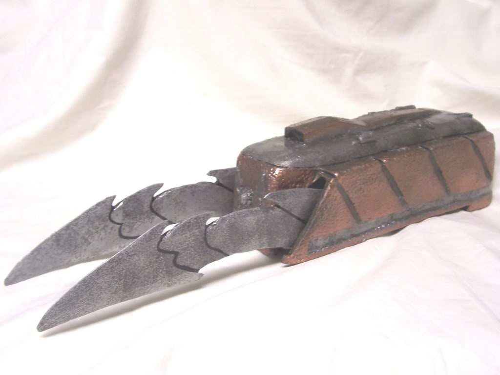

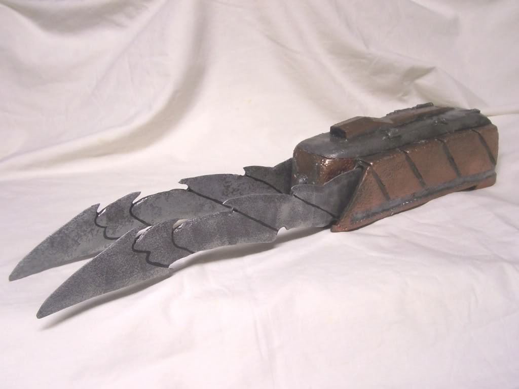

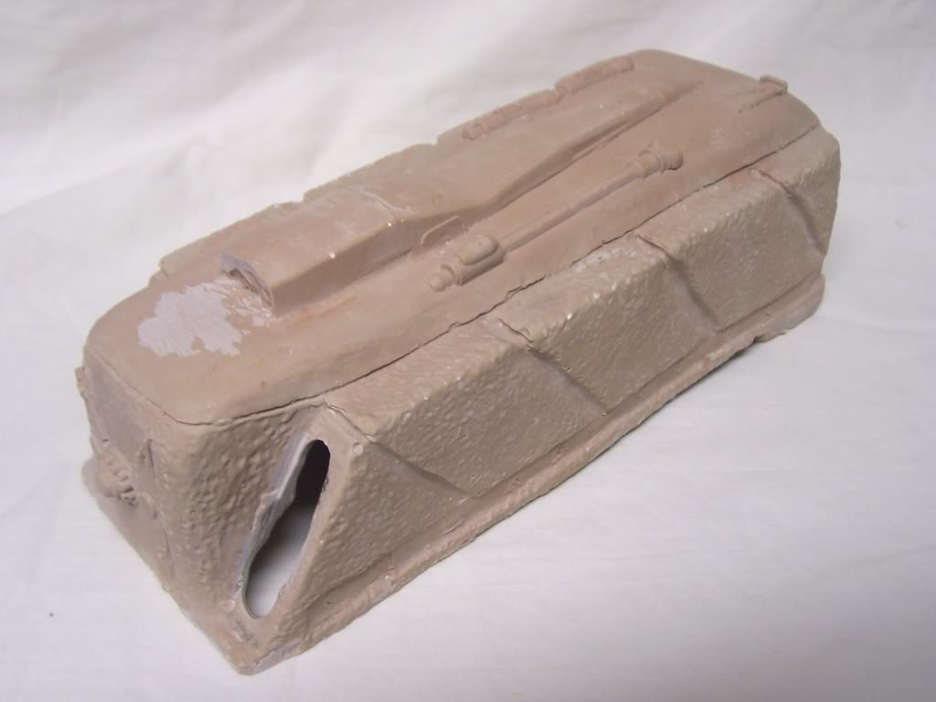

Here's where I am currently.
Gaunt lowers and Comp top previously purchased from Mr Fett
Blade top sculpted, molded and casted.

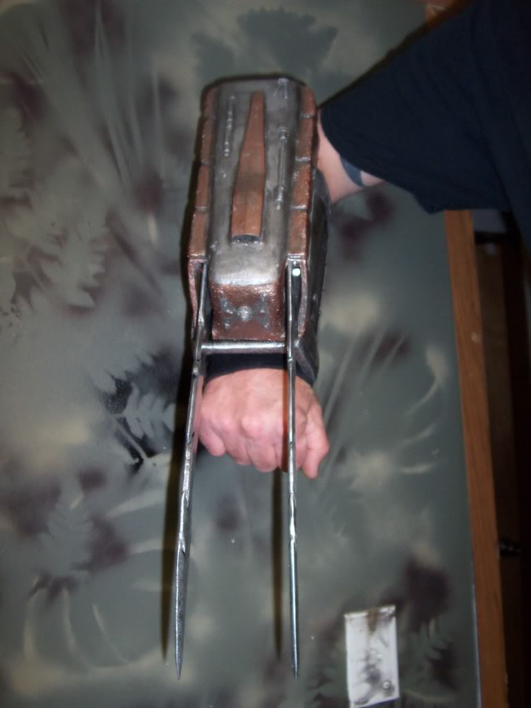

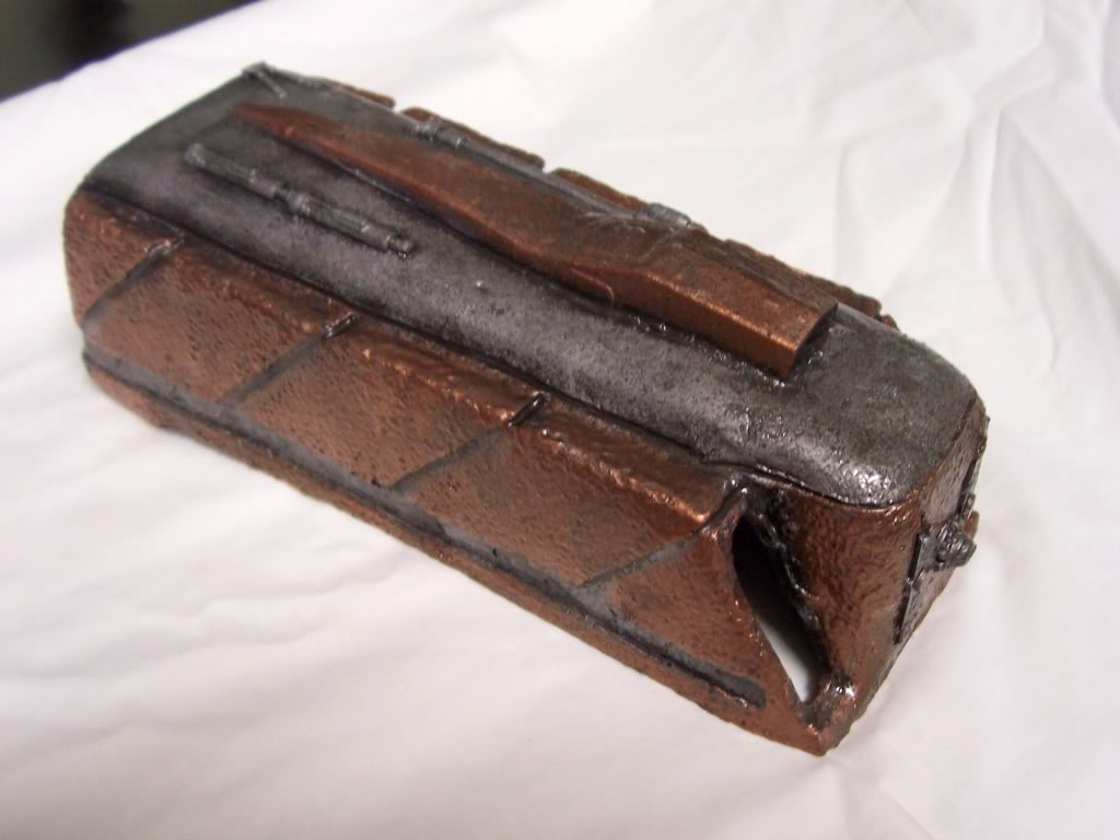

Painted

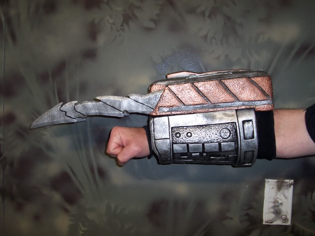

Locked, I made the blades from Lexan then painted them.
Loaded
Gaunt lowers painted

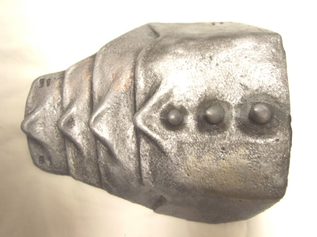

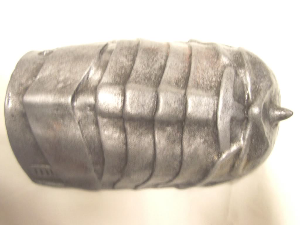

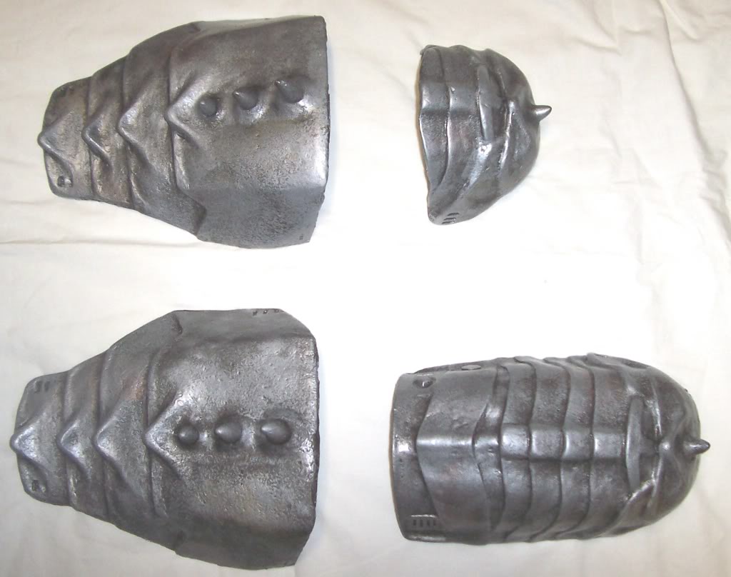

Armor parts from Mr Fett, paint by me
Long shoulder up close
Hip armor up close

Love the spikes on the armour. Blade gauntlet looks well now that its finished. Good luck with the rest of the build

Awesome work man! The whip is fantastic! Love the gaunt too and the bio looks great. I've got a Ram bio but dont have a head that fits it yet. Nice to see some people wearing them though.
:) Many humble thanx for kind compliments, really means alot to have my Yautja peers dig it!

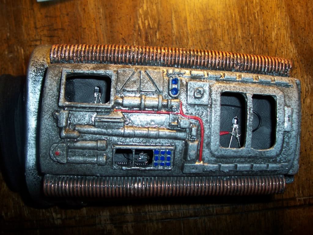

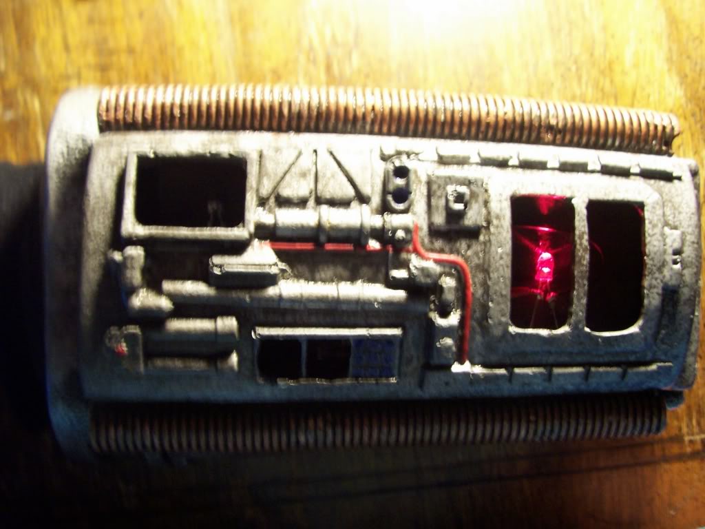

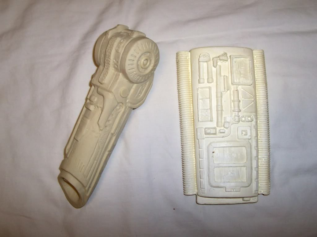

Ok, I cut, sanded and painted my comp top and with the help of the mighty Eiluj,
hooked up the electronics as well! SWEET! Lenses to cover the LEDs w/ Pred glyphs
tomorrow.
With flash to see paint detail
w/out flash to see the LEDs, trying to catch em' on "the blink" for a pic is a
pain the ass! Thank God for digital cameras, otherwise I probably would've
wasted three rolls of film! :) Thanx for lookin!
Lookin' good! I'm loving the fact you're making a light up bomb gauntlet lid. Might have to hire you to make one for my own new suit. :)
